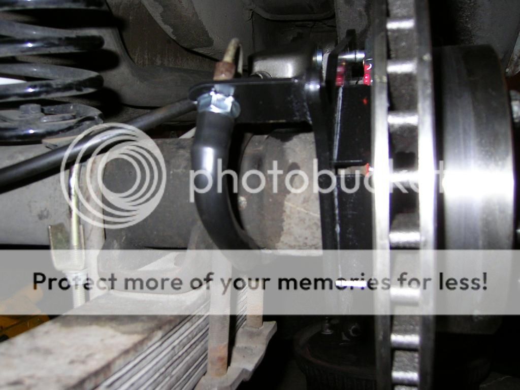

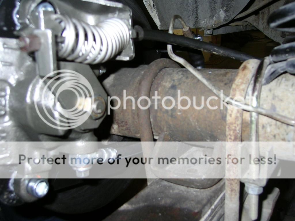

The only thing I really didn't like about the set-up is the flex line. In my opinion it is was too short. Needs about another inch of more in length.
And due to the sharp turn out of th ebracket I moved the big rubber end around on the flex lines.
But other then that it is all done. Just need to dial in the adjustable proportioning valve.

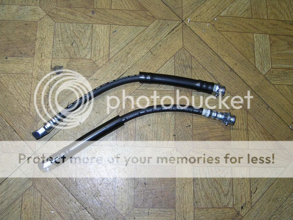

I would have your local hydraulic hose shop make a couple of hoses at the length you want. You could give them those hoses in the picture and they can use your original ends/fittings and make those hoses to the length you want.

Why do they ALWAYS do that????:rant:
I haven't followed too many rear disc upgrades...so this is a common complaint I take it?
That is a good idea. Didn't know they could re-use the end fittings. But I might end up changing the orientation next year to so meting that does not require you having to totally drain the caliper of brake fluid every time you want it off.
