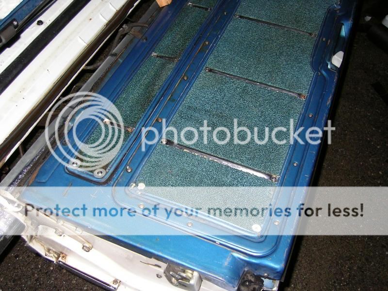

I noticed too that the tailgate carpet was getting wet...especially the small lower piece. It was completely soaked through. So I decided to pull everything and see what was going on.
Once I got it open I could kind of see why it was getting wet. The original tape was rotted out and allowing water to splash up and be soaked up by the fiber board backing. So I cleaned off all the old tape and residue...had to use lots of water and SOS pads.
Once it was clean I noticed some scale rust around a couple of the holes where the screws went through. Cleaned it up and I have a little rust out!! This is the only rust I've found so far on the entire car...little sad but should be an easy fix.
Once everything was clean and dry I used some aluminum tape to cover and seal up the holes. And put some plumber caulk around the big openings on the upper panel as well.
I then cut out a couple pieces of tar paper for a backing on the lower panel...just a little added water prevention.
And all sealed back up. I had to pound almost every screw hole flat again...they had been over tightened many times by the looks of things. I also put a little grease on each one since there was a little light rust around them as well....until I can clean them up properly and prime and paint.
