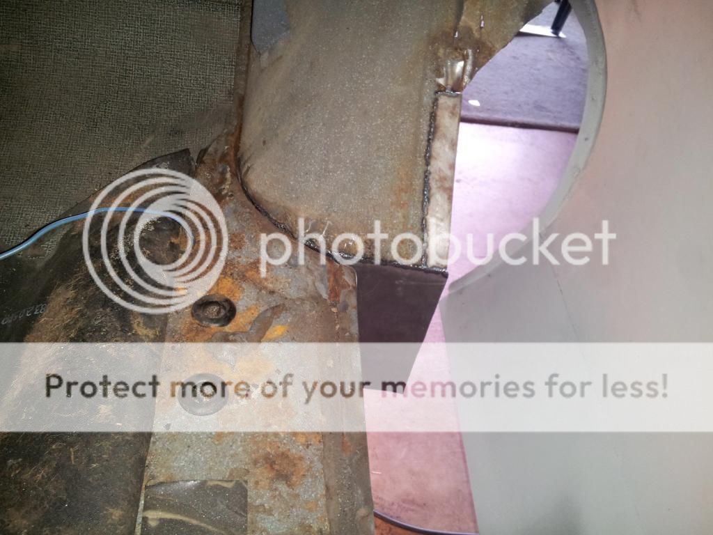

This spot was a bit of a pain in the ***! Hard to get to all the welds with the grinder. But its done. Coming along....
Thanks guys.

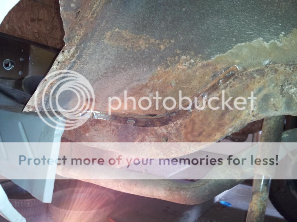

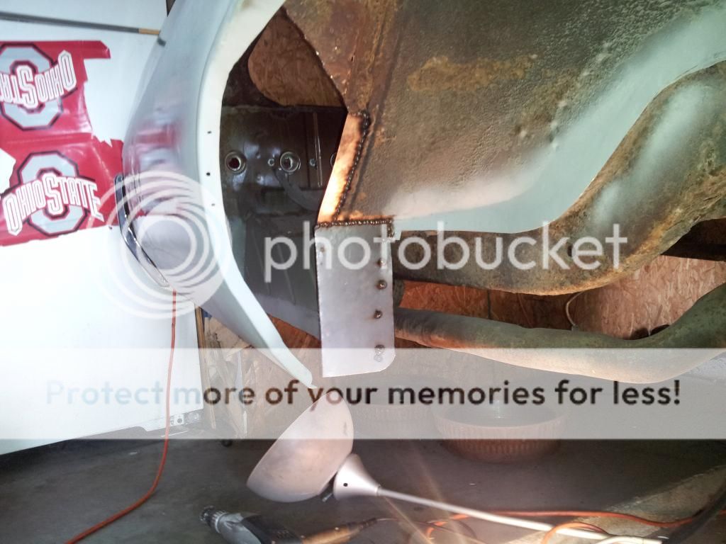

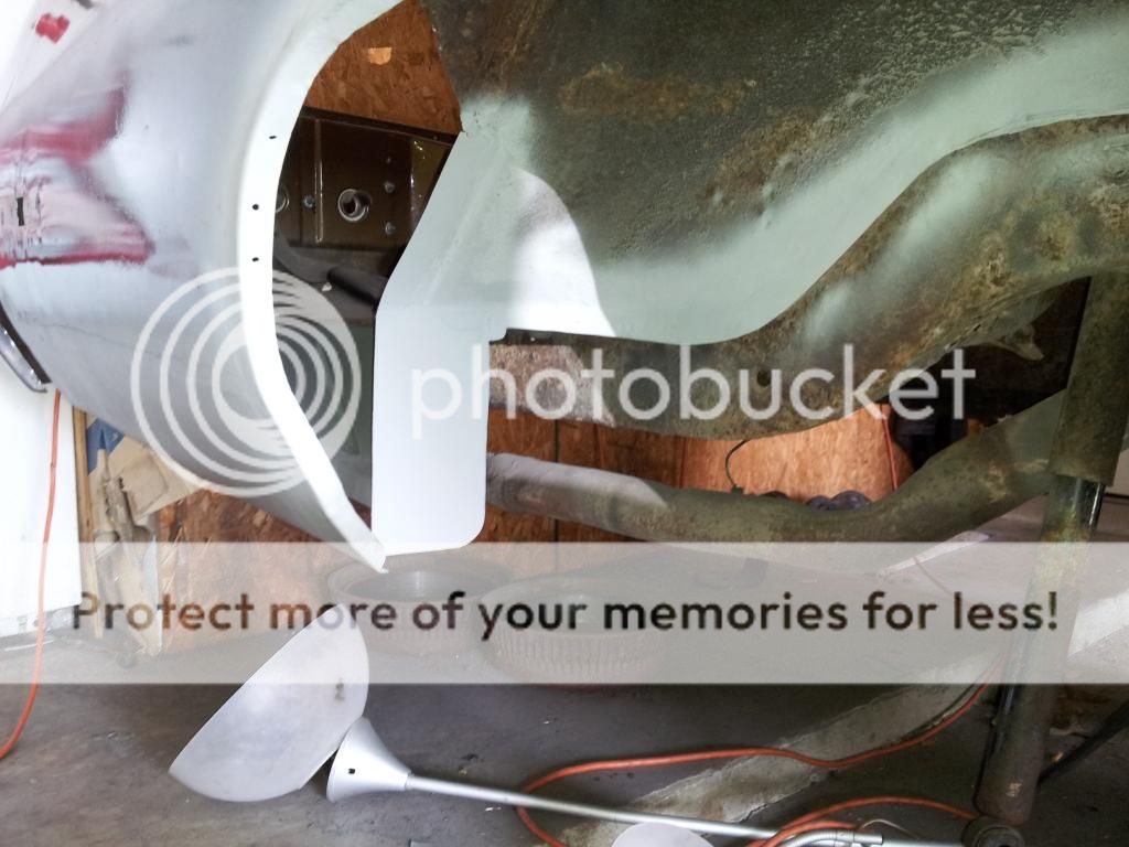

Macgyvered this panel in, this afternoon.. Not sure how happy I am with it. Kinda sucks not having most of the original metal to go by. The driver side is pretty ate up too.

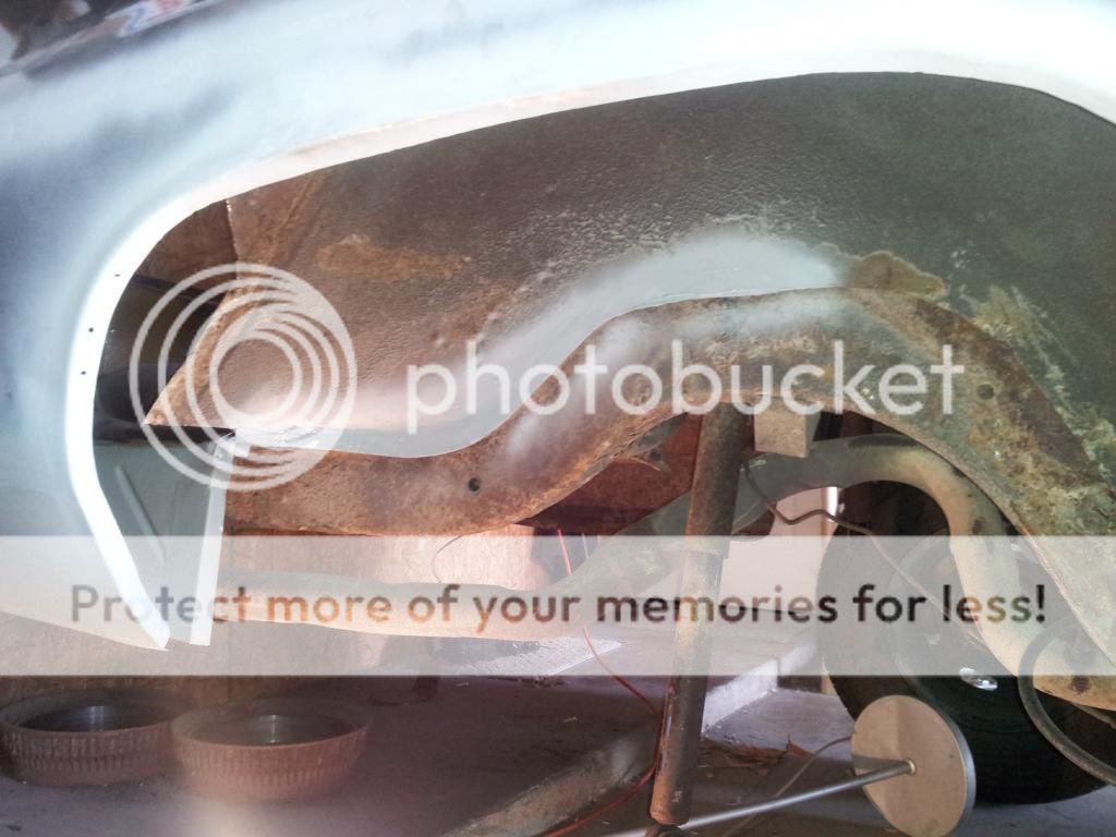

Some more accomplished. Finished the rear of the wheel well up.

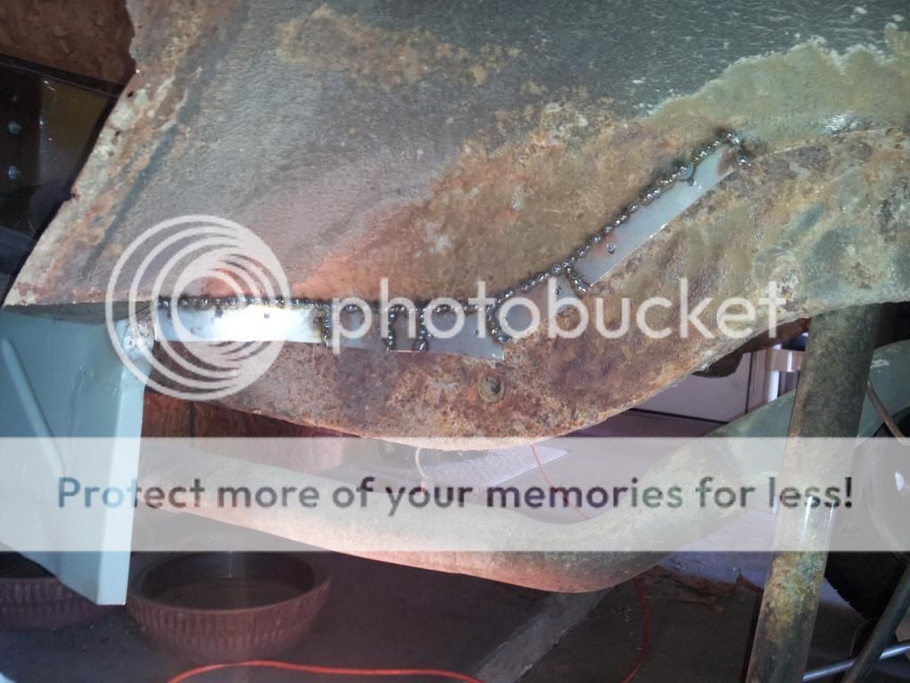

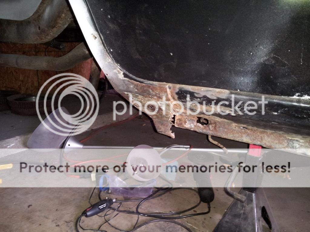

Now I'm working on this nasty mess.. I tried to replicate the lower dog leg, like cm23 said a few pages back. Take the new metal, clamp it over the old metal, and form it as the new panel, but this did not go over so well.. I'm gonna try and save the rear portion of the lower dog leg, as it is still pretty solid, except for the wheel lip (i'll replace that the same as the rest of the lip) and form the new metal to fit in the front, to replace whats needed.

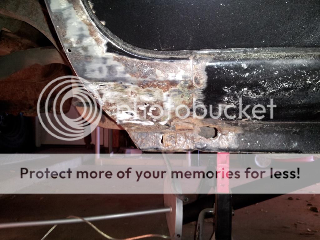

Drilled out the spot welds, and peeled the panel back, to access the rocker panel. Also removed the nastyness of the inner rocker panel. Still have some clean up to do back there. Once the outer rocker panel is worked, add the new metal to the inner rocker panel, then finish with the dog leg. Thank you salt!!!
