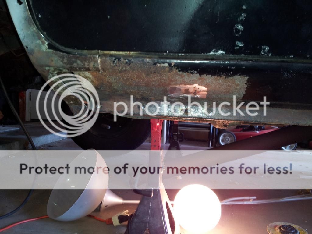

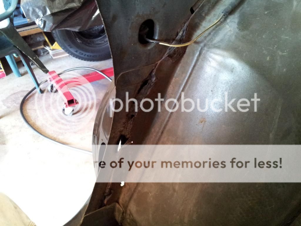

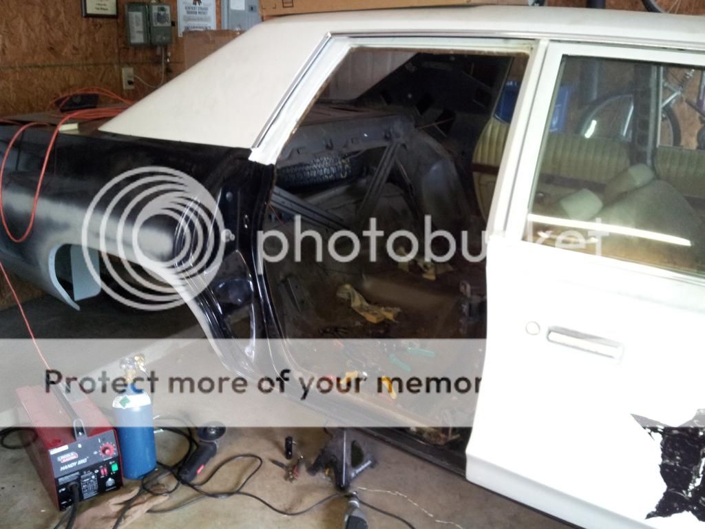

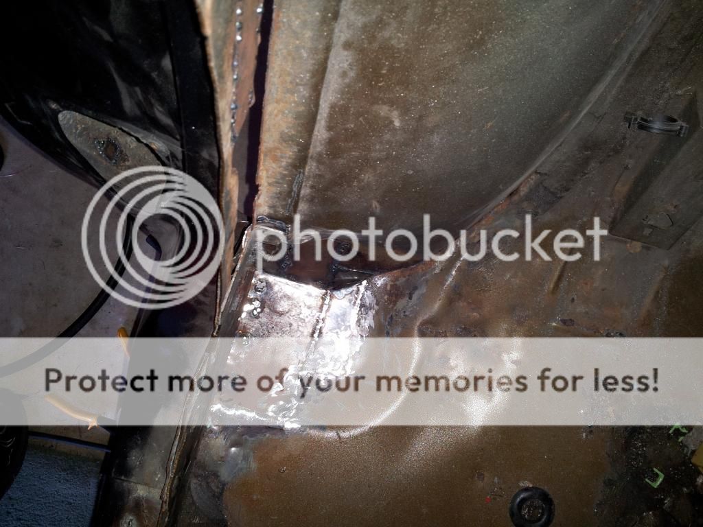

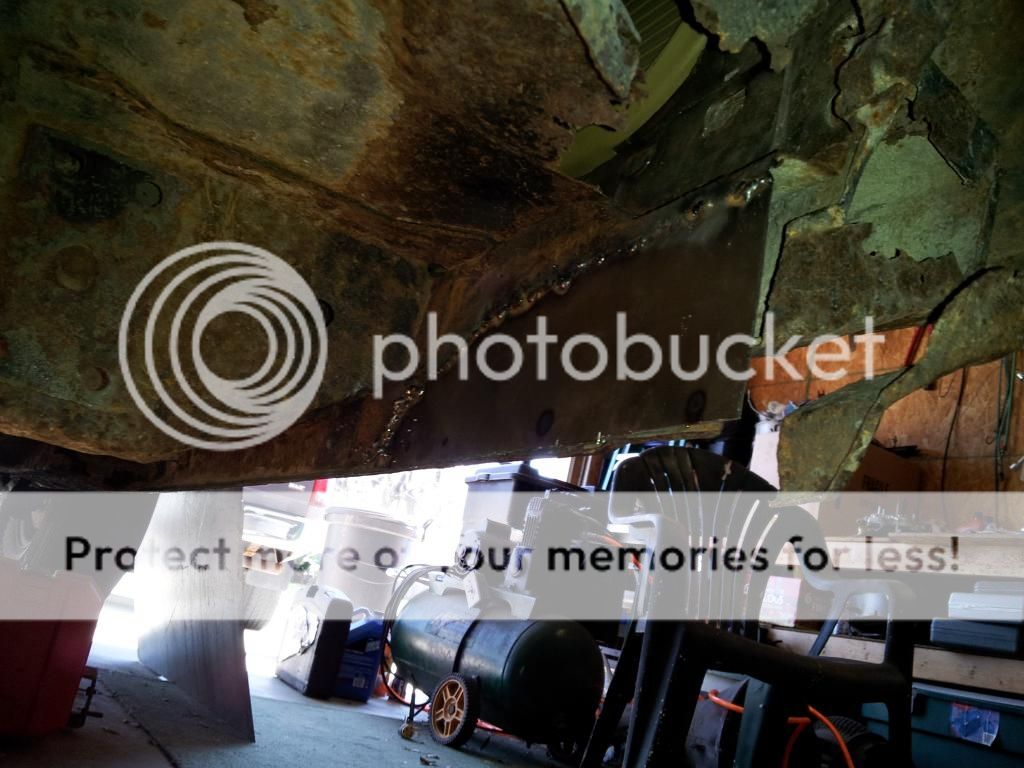

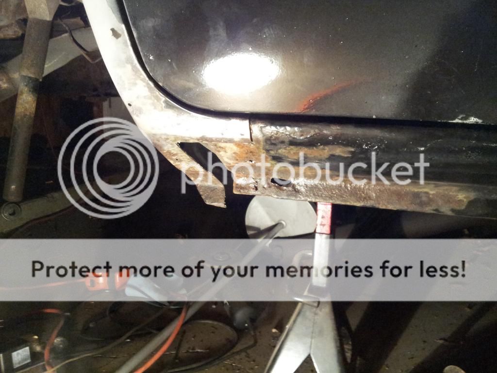

Almost done with the rocker.. The inner rocker is being a pain. A lot of weak, rusty metal. Especially around the leaf spring mount. The middle mount actually rotted away completly from the rocker.. Some thick metal to just disapear! Gonna have to fab up a new one, but I'm not cutting all the mounts out! So gotta find the little bit of strong metal left around them to weld to.

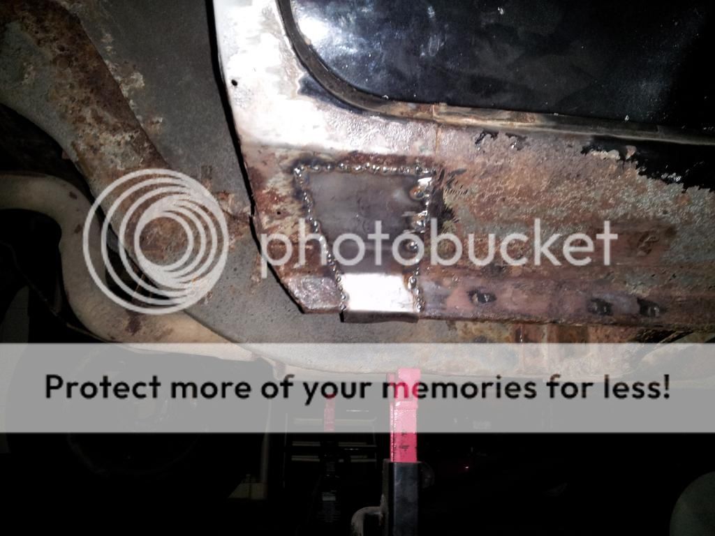

I had to turn the heat down on the welder, to fill in a few big gaps between the new panel, and old... The outer rocker came out pretty good! Made 3 patches on it. My grinder finally took a dump. Down and out till I get another one. I'm using 16GA metal on the rockers. Seems to match the orginal metal perfect.

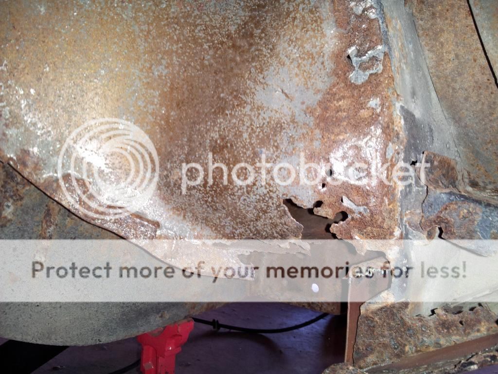

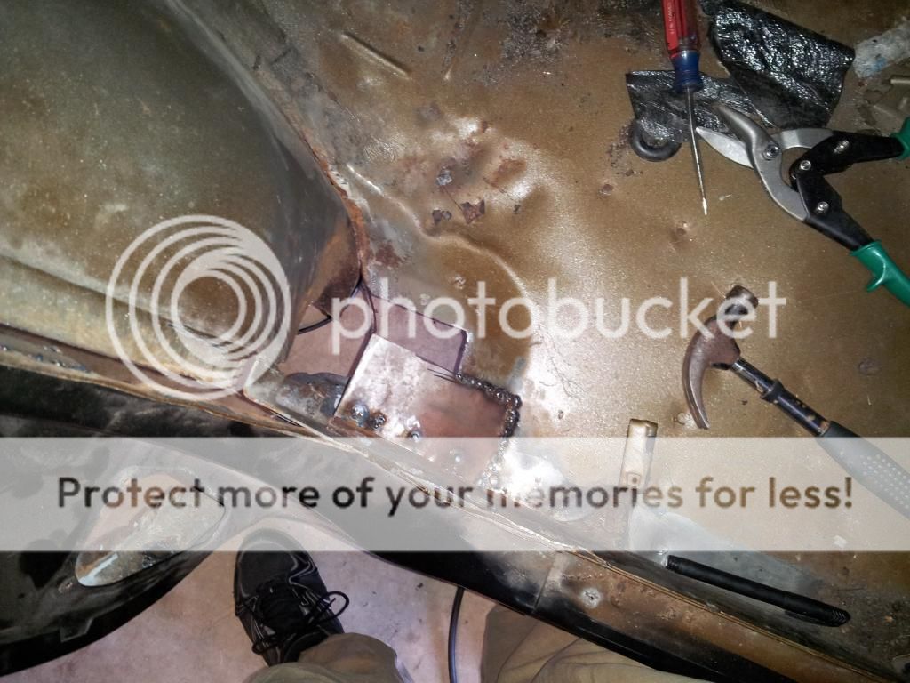

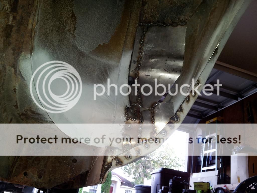

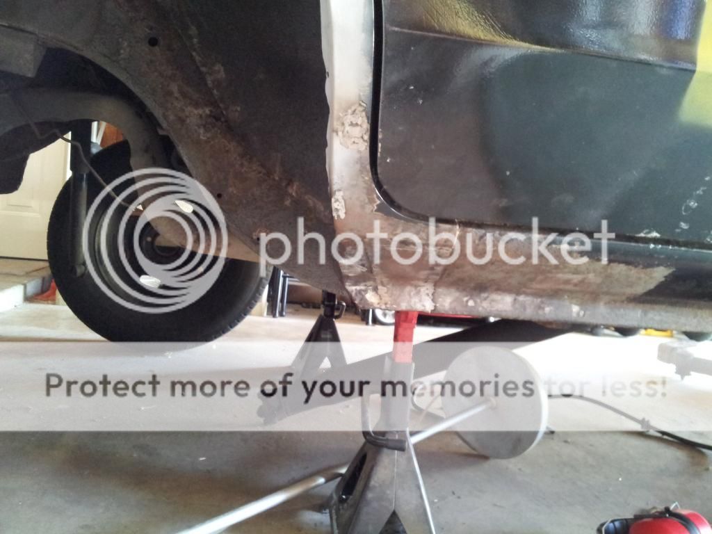

Finally finishing up this lower dog leg! Put in severl hours the last couple days.
Now on to the inside...
Got to use my new needle scaler! Eats right through the undercoating, and rust!

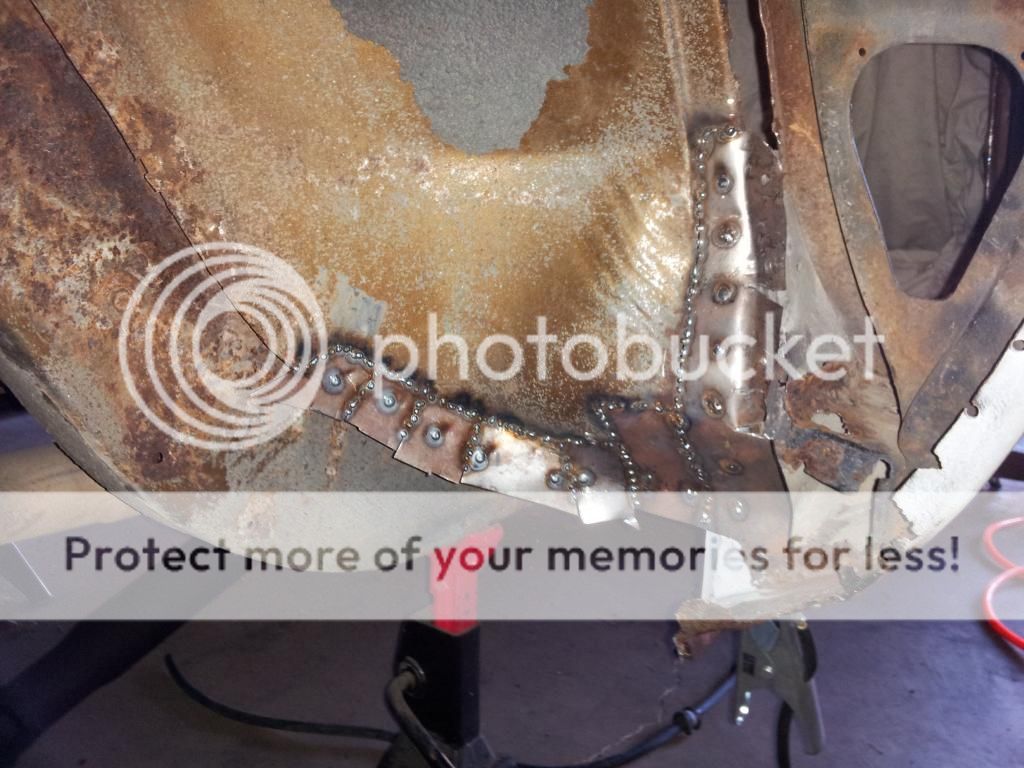

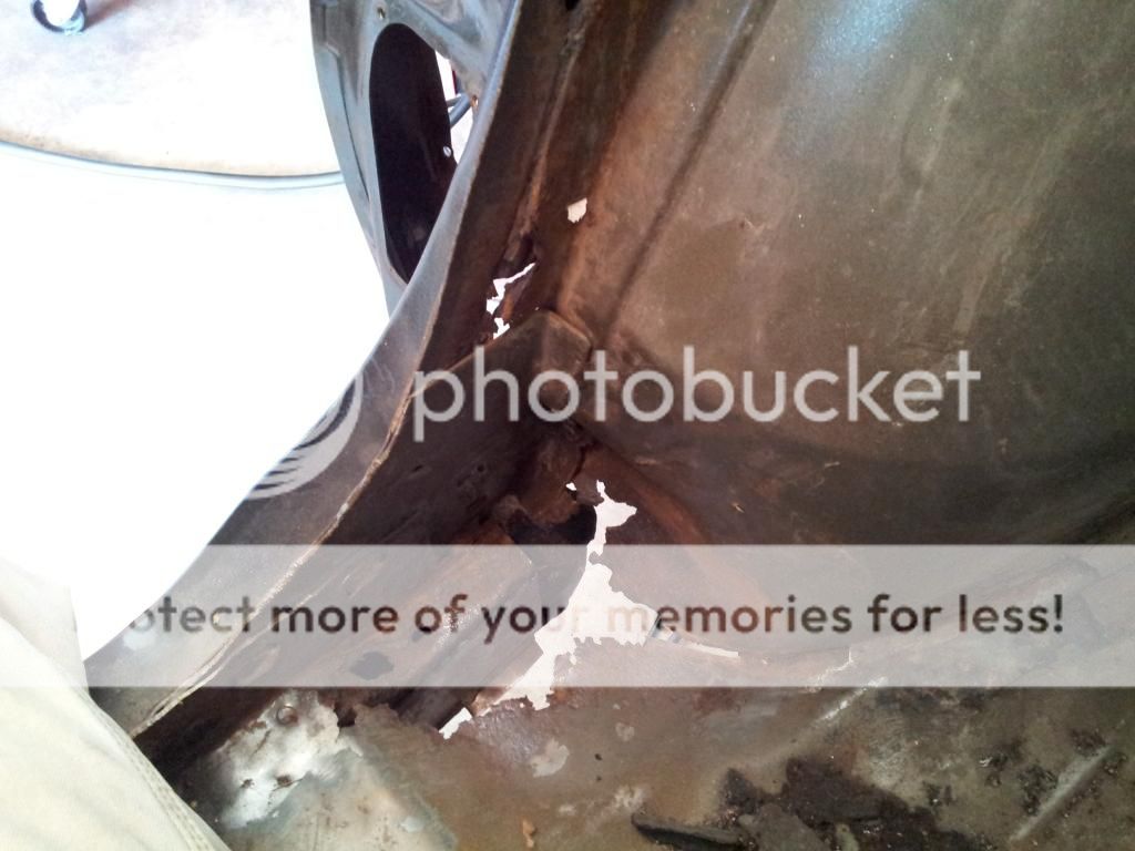

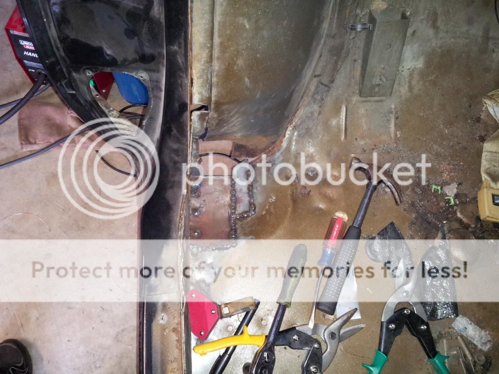

Got most of the bad cut out. Now on to forming, and welding in the new patches. Got a couple small patches done today. Called her a day, and having a drink...

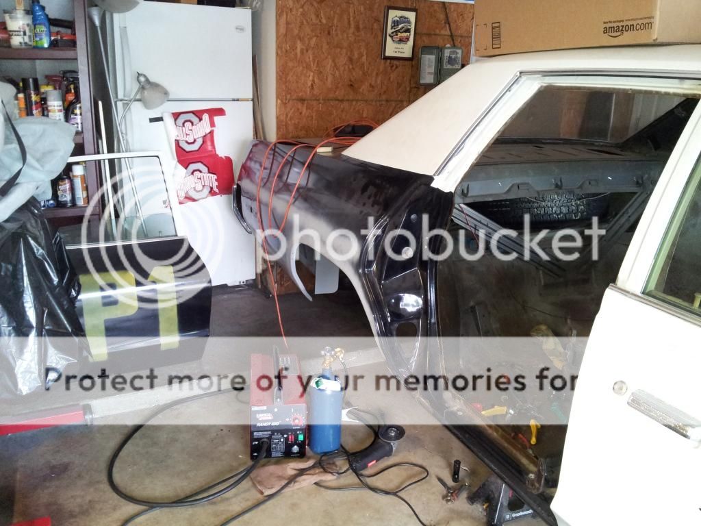

Some more progress. The door had to come off today. Couldn't weld with it on anymore! Floor is coming together though...

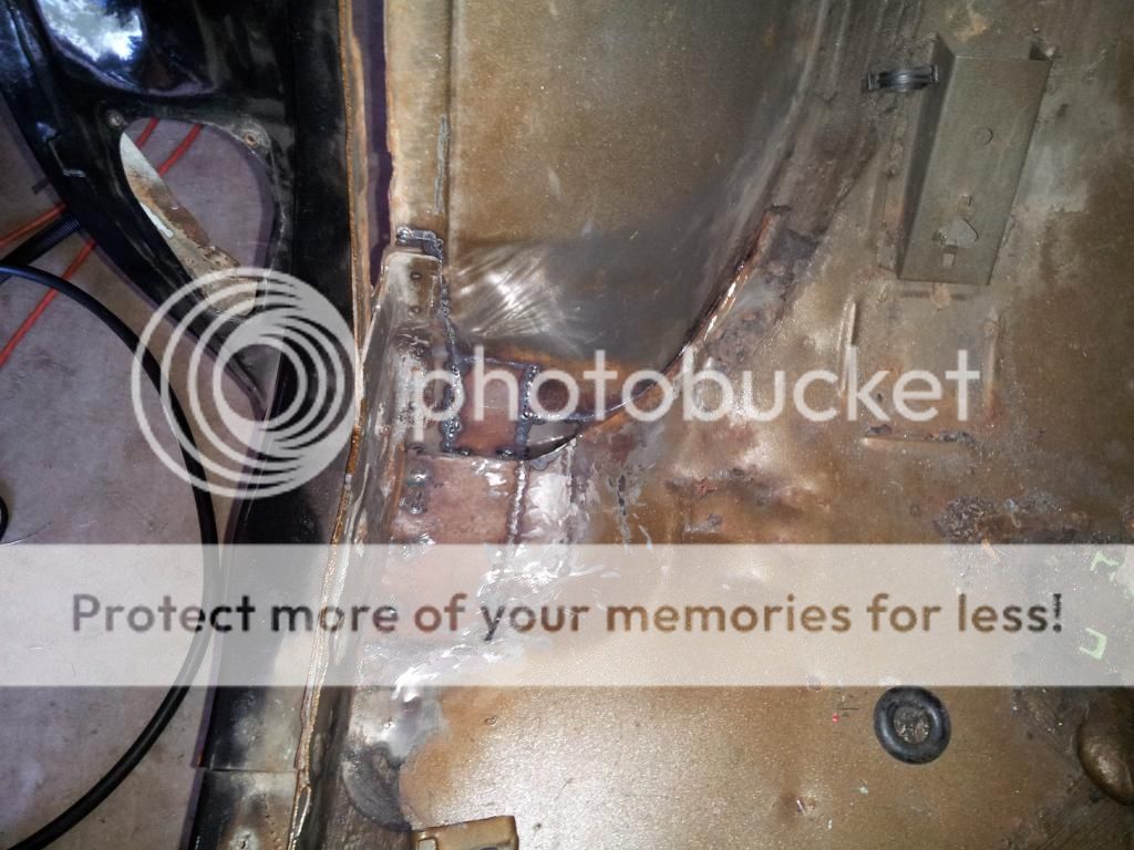

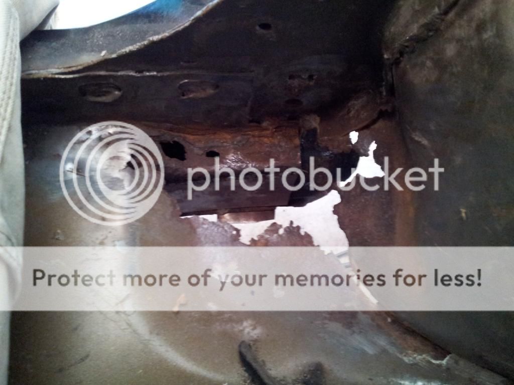

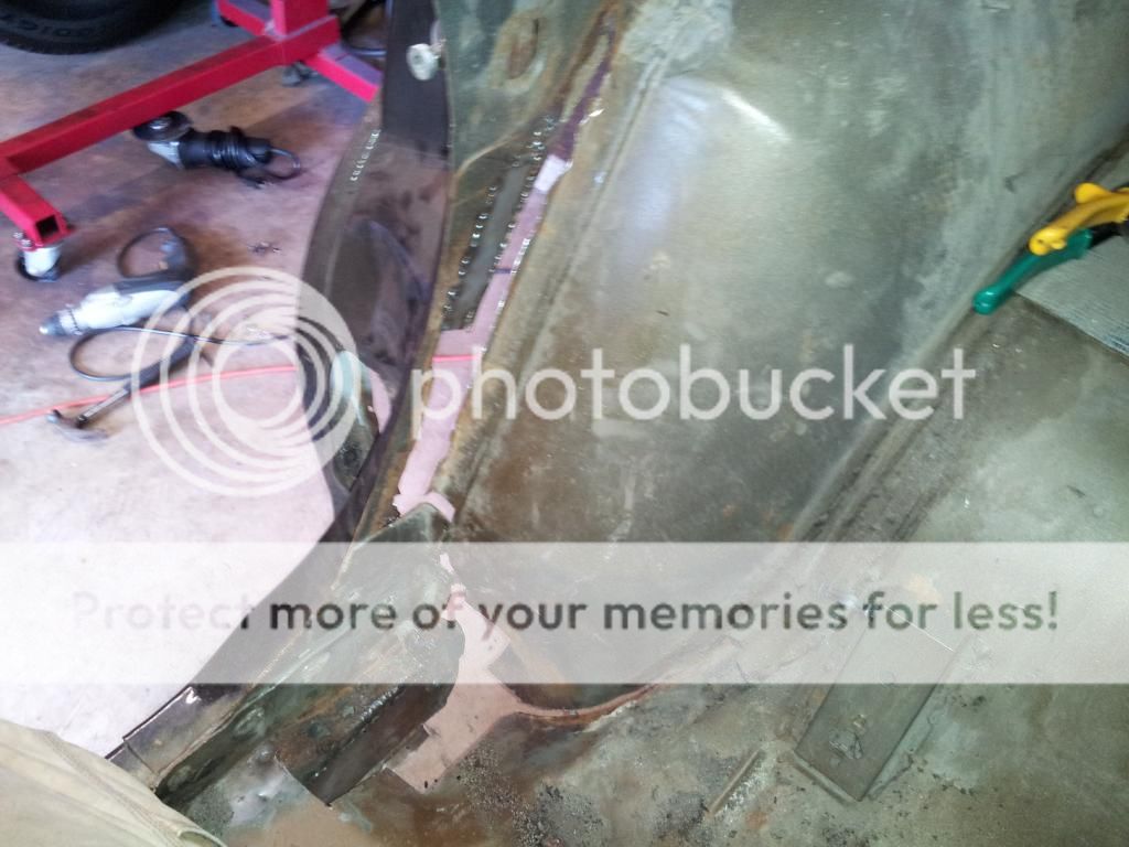

Shes got a floor in the rear again! Woo! Still some work to do, and clean up. But I'm happy this part is coming together. Was not looklng forward to it. Will still be interesting when time comes to fab the outer wheel well to it though...
No metal goes unused. The little scrap pieces come in real handy in these spots.

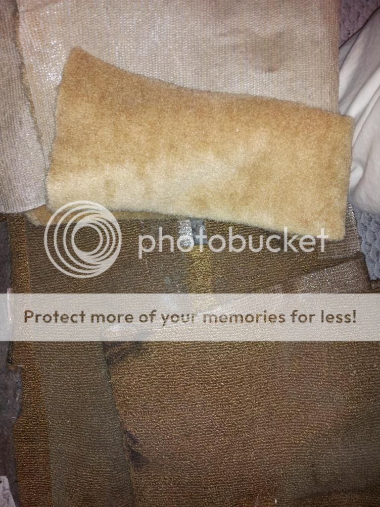

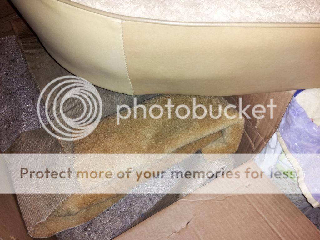

The carpet arrived the other day. I was a little dissapointed at first. But, its starting to grow on me. Obviously the color is a lot lighter. Also there is no texture to it, like the original had. But it does match pretty good with the seats/rest of the interior. So I'm not gonna ***** too much.

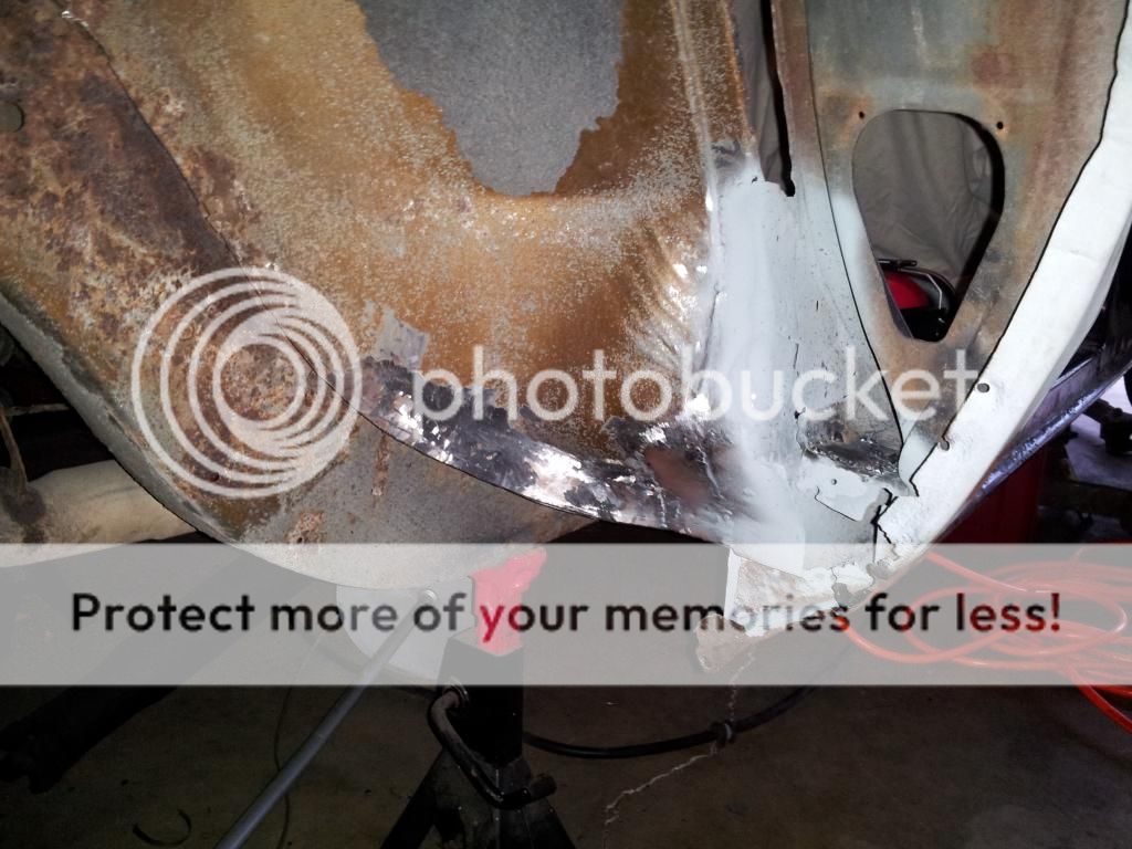

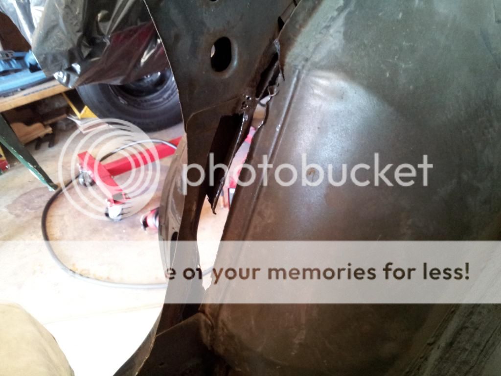

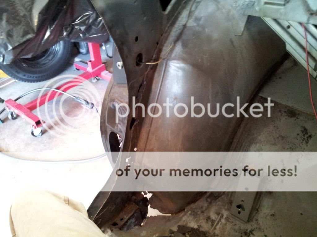

Fabbed up a new wheel lip, now the outer wheel well is going in... Not the happiest with it. But Its not coming back out. Gonna be fun grinding some of these welds!
