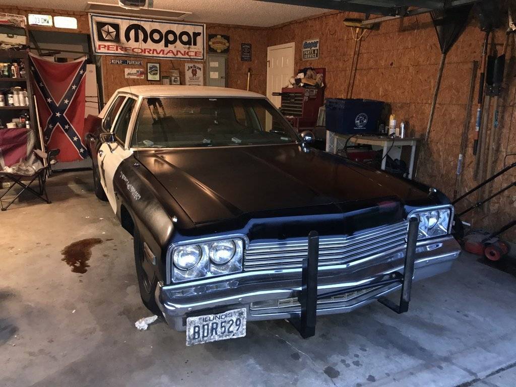

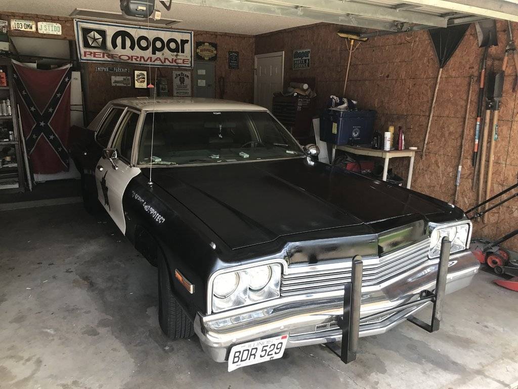

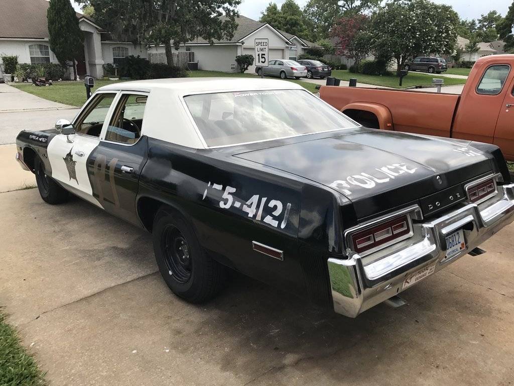

My plates finally came in today. They look great! I bent up some 1/8" from work for a new front plate holder. Can't wait to get em on!
Also backed the timing down a bit. She was pining pretty good under full throttle. She seemed to like it a lot too. Can really feel her lunge now from a stop if you get on it. If only the PS pump would quite whining now lol

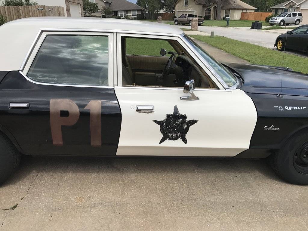

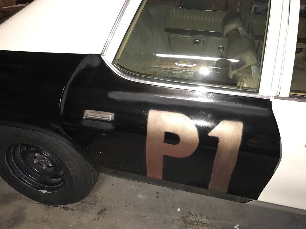

Been going around the car wet sanding, and buffing spots here, and there. Also been taking a scotch bright pad here , and there. Weathering paint, and making it look natural isn't all that easy. Hopefully it'll look better once I get some dirt on her.

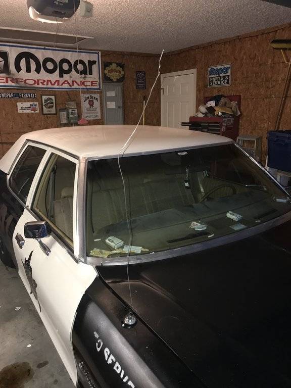

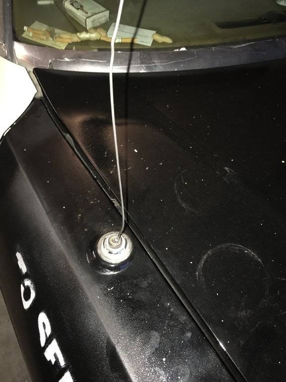

Got the new plate, and bracket on! Also can step back in time, and be movie correct with the new wire hanger antenna. This was actually needed as well. The original antenna stud broke years ago. Idk how the antenna never flew away...
Drilled a new hole in the stud still in the base. Cut a screw in half, and welded the hanger onto it. It's actually attached.

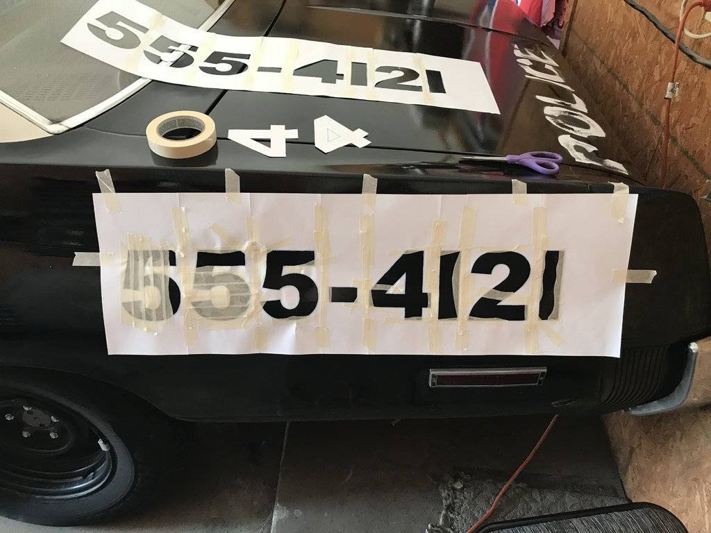

Phone numbers going on the quarter tomorrow.
View attachment 131839 View attachment 131840 View attachment 131841 View attachment 131842 View attachment 131843

This "weathering" is kicking my *** though.. not as happy with the outcome so far.

Phone numbers are on. Also some more weathering with the scotch bright pad.
