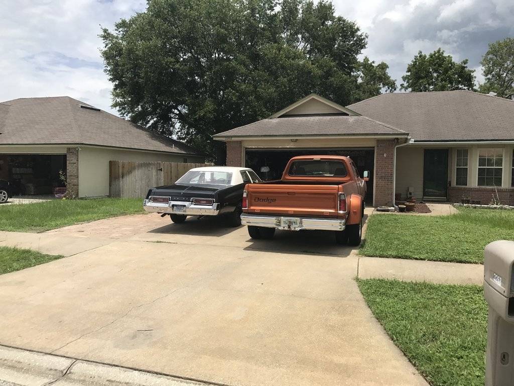

The driveway looks good!!View attachment 128332View attachment 128333 View attachment 128334
Something familiar about that last pic!
Damn you've come a long way with your projects... Makes the house look great:thumbsup:
