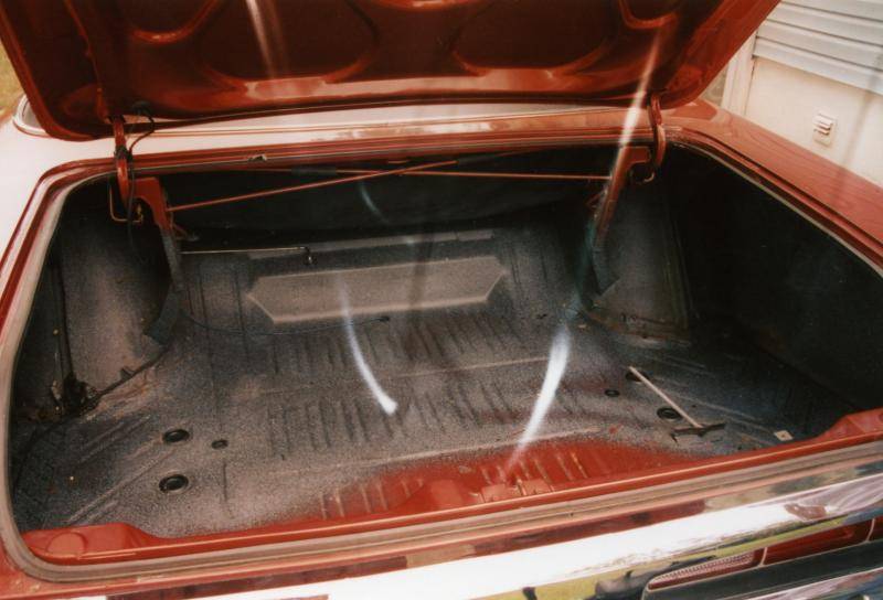

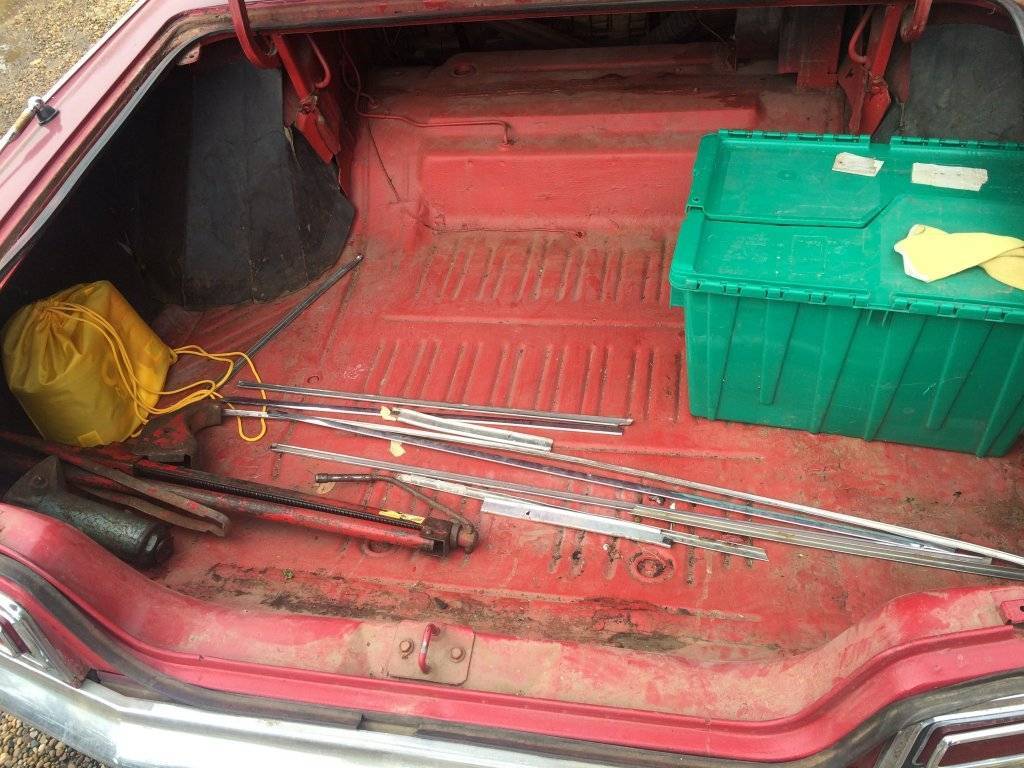

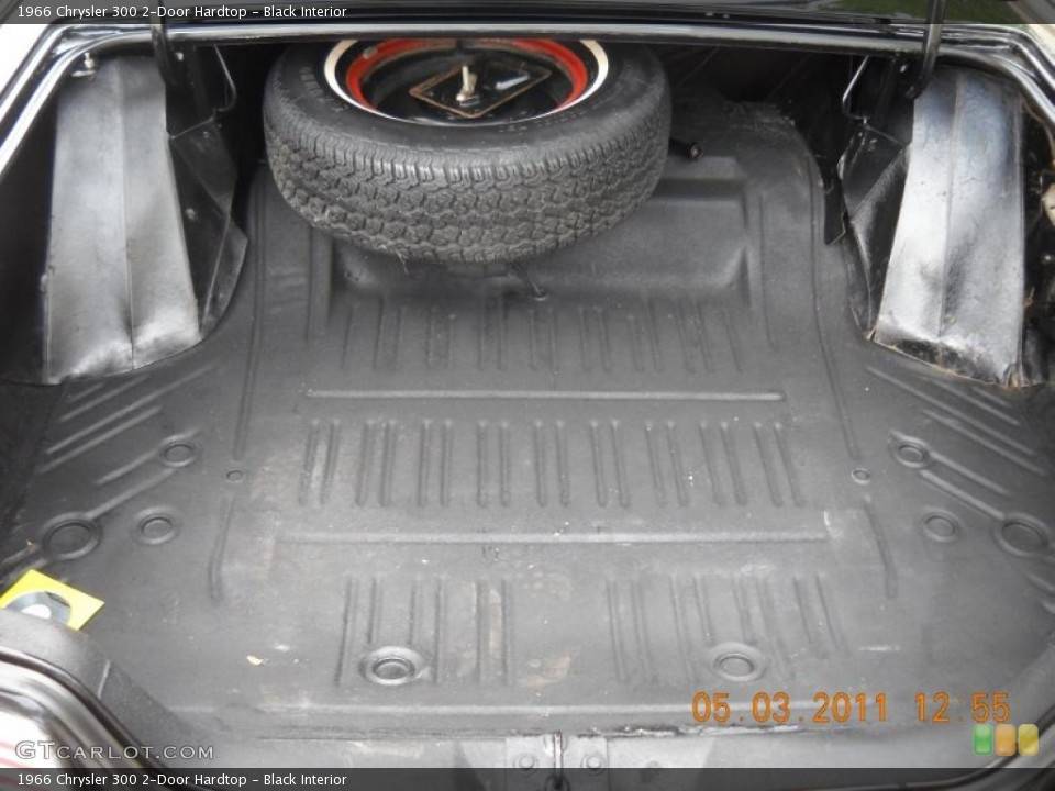

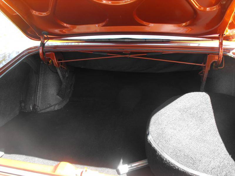

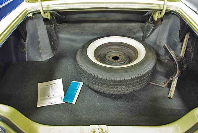

Out of curiosity where is the spare supposed to mount on these cars if there is no bracket and hook location in the trunk? My 66 300 2dr HT has nothing in the trunk to mount a spare so it sits loose. Does your 66 vert have a trunk mount? Mine is the Canadian version so the trunk is a Newport style.
What mine would be like
Versus what I think it should be
Most likely, the bracket for the tire mount is missing off the floor. Mine was gone and it seems to be a common issue.
Lift up the mat on the right side and look for signs of where it was.
Here's Dave's 70 trunk (because it was easiest to find) You can just see the bracket. You can buy the bracket on Ebay. I just MIG welded my new one to the floor.

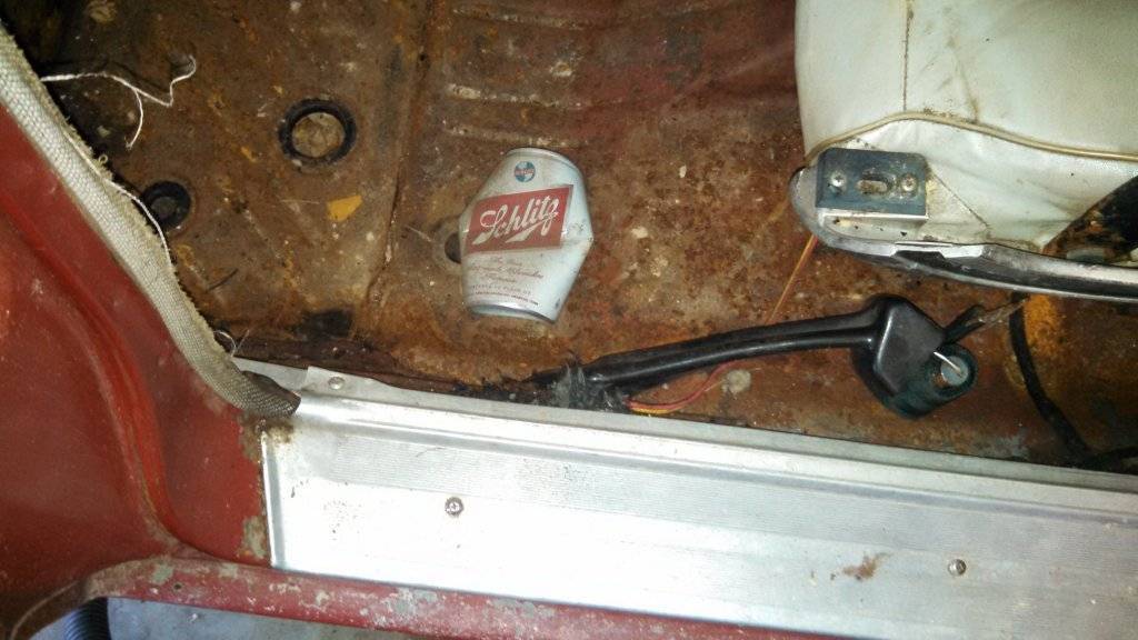

And. . . Look what Earl found under the front passenger seat:

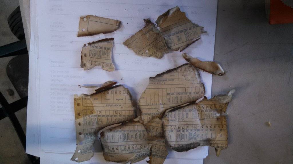

Also spent some time vacuuming out the trunk and under the front and back seats. Some rusty scale and a lot of other debri was present. I pulled the back seat bottom out of the car, and look what Earl found stuffed into the seat springs:
The broadcast sheet is almost totally disintegrated. I managed to carefully remove it from the seat springs and lay it out like a puzzle. Here is what it looks like now:
Fortunately, most of the codes can be determined; however, I sure wish the sheet was in better shape. Anybody got any ideas on how to restore / preserve this important original document ?
I have never tried it on a broadcast sheet but you could iron the pieces and reassemble it like a puzzle and laminate it. I don't want to steer you wrong so I hope others will weigh in on this also

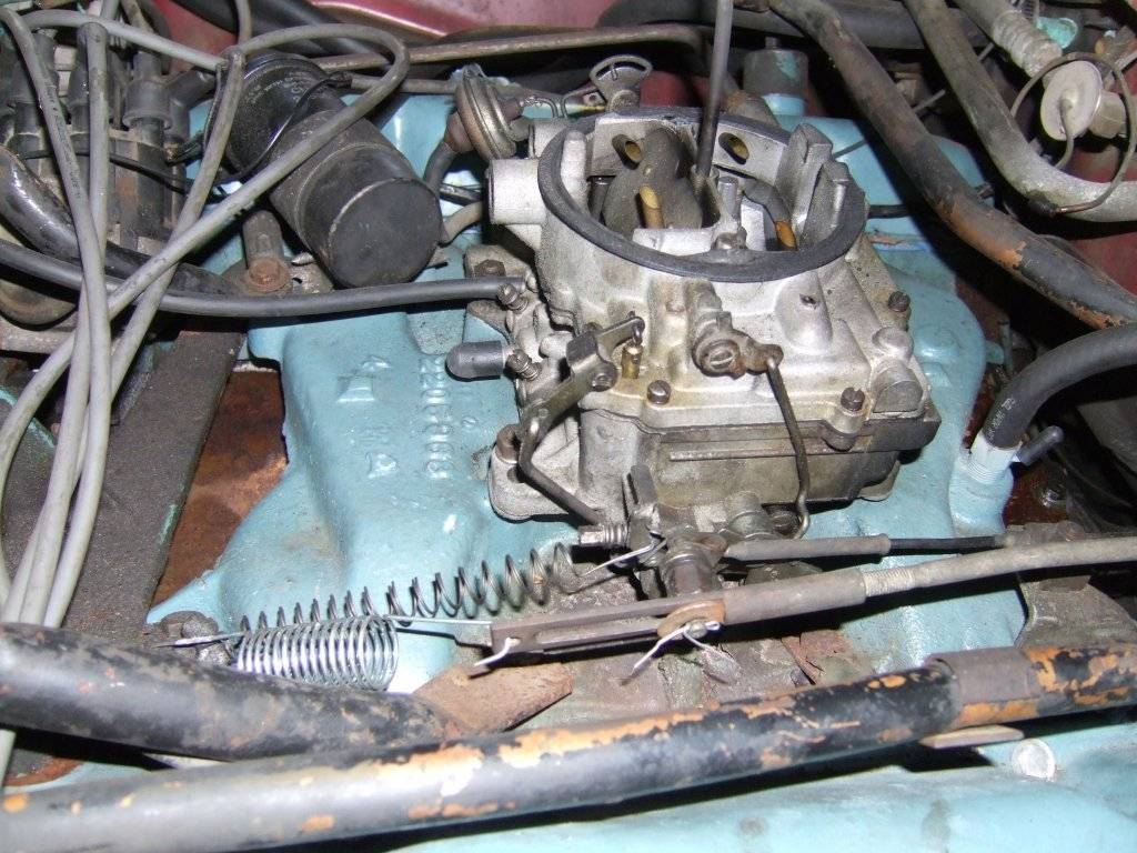

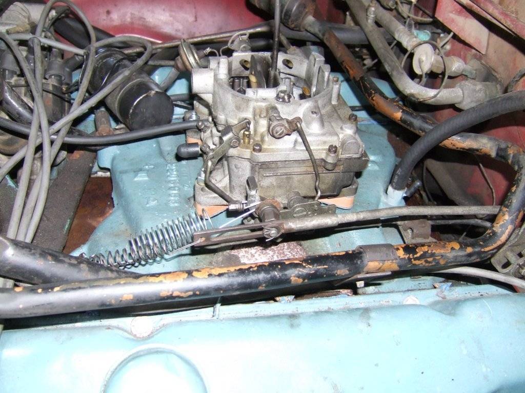

First stab at installing the carburetor spacer was a fail. The spacer I got off E-Pay was for a Holley - not an AFB.
Here is the carb after I installed the spacer. A subsequent long test drive proved the spacer did its job well. No more engine dying like I experienced before upon stopping or in right or left turns. All that nonsense went away. The only issue that remains is that since the spacer is a half inch high, the linkage for the choke is now too short, which keeps the choke wide open all the time. I'm not sure what to do about this. . . The engine is a little hard to start when cold, but once it warms up a little, it starts just fine.

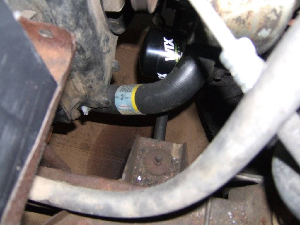

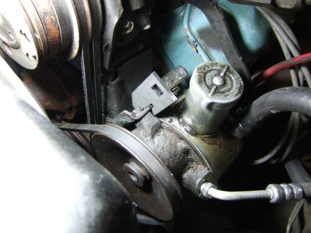

The next repair involved the leaking power steering pump reservoir. In the photo below, you can just barely see the leaked power steering fluid on the lower radiator hose just above the word: "WIX." From what I've read, this wet lower radiator hose is the hallmark of a bad reservoir-to-pump O-ring.

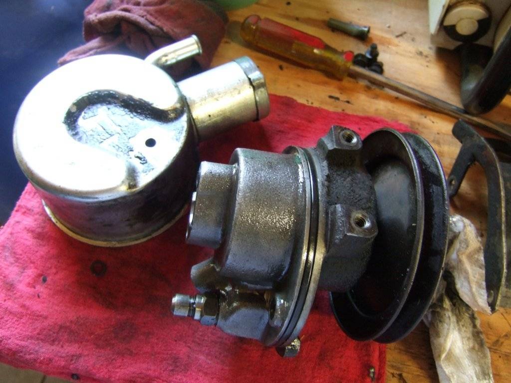

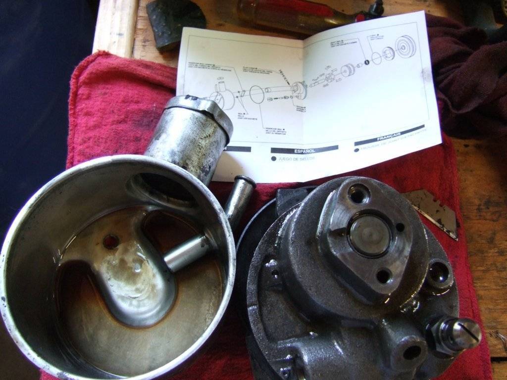

Here is the pump with the reservoir removed and the diagram from the pump rebuild kit. Thankfully, all I needed in the kit was the big O-ring seal. I'm told these pumps are pretty much bullet-proof and will last a long time - unless they are run low / without fluid.
The installation of the new seal is really a piece of cake. Here it is installed:

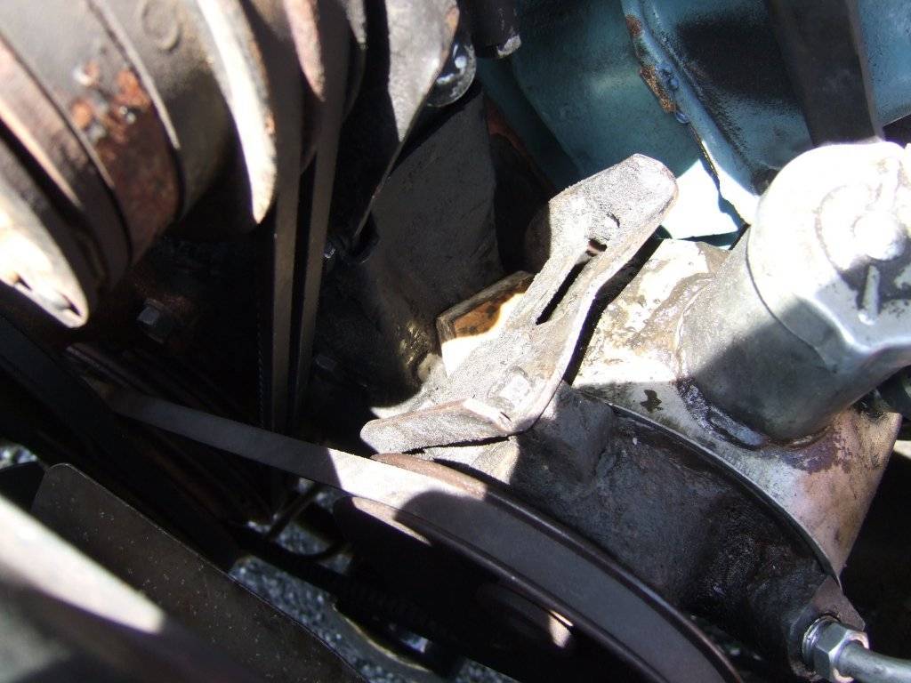

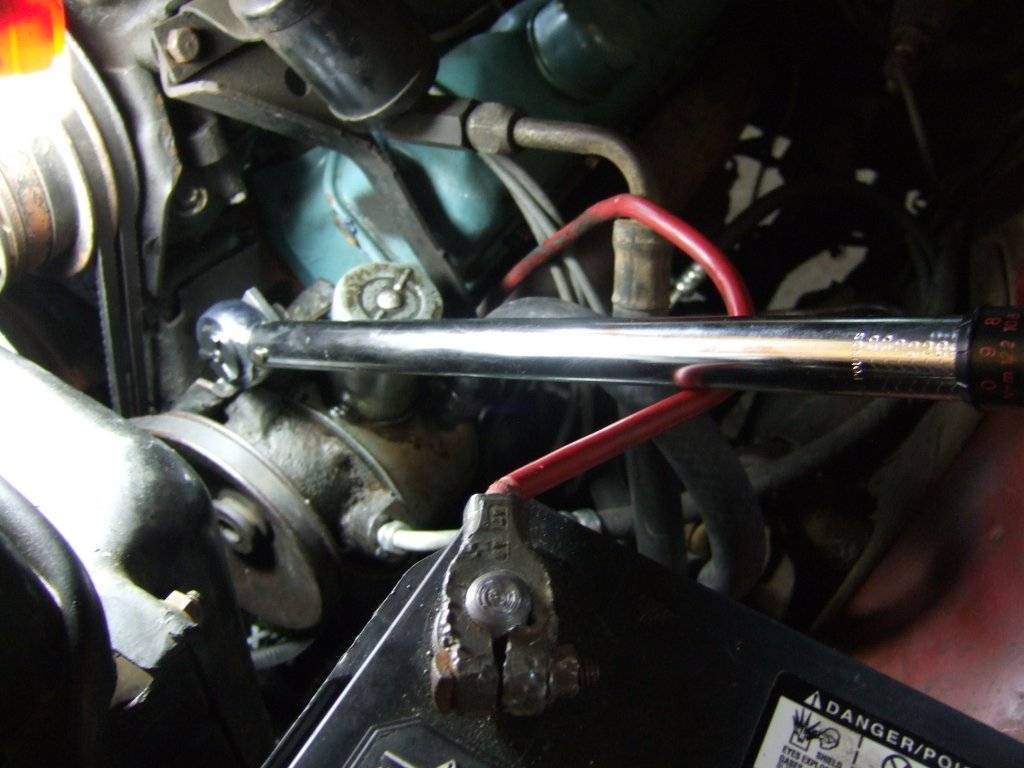

After I got the new seal installed and the pump put back together, I really had to wrestle with getting the pump mounted and the belt adjusted correctly. I purchased a special tool from Bob Merritt (300 Club, Intl.) and I used it to adjust the belt tension and the pump mount.
The tool shown above allows you to get hold of the power steering pump bracket and and adjust the bracket tension with a torque wrench as shown below:
BUT. . . What nobody tells you (and its not clear in the FSM), the adjustment procedure is a two-step process. First, you gotta adjust the position of the pump on the bracket, so the belt is tight, and then you adjust / torque the the position of the bracket. And there is one more thing: There should be a rubber bumper positioned between the pump housing and the bracket to which the pump mounts. My little rubber bumper was long gone. . . Without the bumper / spacer, the position of the pump on the bracket is incorrect, and it prevents the ability to properly tighten the belt AND also the bracket to which it is mounted. Since I didn't have a replacement rubber spacer, I picked up a little piece of 3/8" plywood and stuck it between the pump and the mounting bracket:
