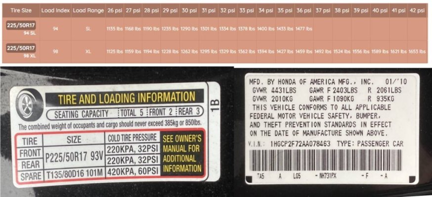

I did something I never did before: I consulted both the Tire & Load, and Certification placards on on my 2010 Accord driver door pillar, and tire load inflation tables on tirepressure dot org. My uploaded image shows all three items consulted. The 'Certification' is the label with gross weights and build date on it.
I took the gross axle weight rating(GAWR) for each axle, and divided it in two - as in - per tire. (remember: 'Gross' = curb weight PLUS five passengers PLUS full tank of gas PLUS full trunk of luggage. ...
PLUS the family dog.)
Basically, the max load plus curb.
Then, I consulted the aforementioned table to see if Honda did their homework when selecting cold tire pressures for that year's Accord.
At 32psi cold, the OEM tire size for my car supports 110.9(111!) percent of front gross axle weight, and 129 percent of rear gross axle. In total, about 139 percent of Gross Veh weight.
A ten percent safety margin per axle is generally considered industry minimum, with 20 percent over, the average.
So in theory, at least, there is no acceptable or rational excuse to exceed the vehicle placard tire pressures at all, on passenger vehicles at least . Aside from higher shipping and storage pressures, to prevent flat spotting or cargo shift in transit. Some car makers, particularly certain German and Italian ones, provide a set of slightly higher cold pressures explicitly for sustained high speed (100-plus mph) operation.
In fact, I could run my rear tires 1-2psi cold lower than in the fronts, and still far exceed gross axle capacity back there.
