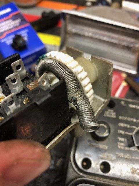

I appreciate everyone's input. Found the actual turn signal flasher, and that was indeed the culprit. I ended up replacing the headlight switch yesterday as well...dimmer for dash lights was touch and go, and would make a grinding type noise when I would turn it. Half the spring was not seated properly...was just hanging loose, and all sorts of ashy debris fell out of the thing. Anyway, got the new one all hooked up, and now I don't have any damn dash lights, and the dome light isn't working. Fun stuff. Probably a separate thread for another day.

Got it from NAPA - Part NO HL6571. Messed with the old one a bit, but as you can see that spring is just too funky to sit properly. If I recall correctly the wheel was in fact plastic, but all good now. Was a blown fuse so I am back in action. Electrical is definitely not my bag man. Stumbling through with all your help. Thanks again!

Suspected a blown fuse. Yeah, that old switch is scrap. I saved my original, for the '66, and have a spare original for the '68, along w the spare instrument panel it came in. I try to buy NOS electrical switches whenever I see one pop up, or NORS. Scored a Filko for my '83 D150 last year.

OK, that one is shot. I have a plastic one too, but then restored the original w some good contact cleaning spray. You can sometimes score an NOS or NORS switch on eBay. I did, for my truck, but its the same one! Mopar used that switch a LOOOONG time. My 68 uses the thumbwheel stuff, so I HAVE TO repair that. Thanks to the Lord, the vendor threw in an extra instrument panel when I bought the car.
