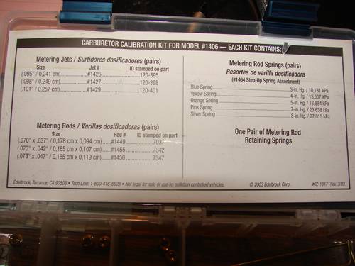

I got the needle things out and they say 7547 on them and the step up springs are bare metal, no color at all and measure about 1.25".
According to the 1406 owners manual, these are the stock needles and primary jets. Not sure on the springs though.

Since my springs aren't colored does that mean they are the Plain 8"Hg? And I need the yellows? Or does that paint wear off? I got the floats adjusted better. Jets and needles are the correct stock size.
