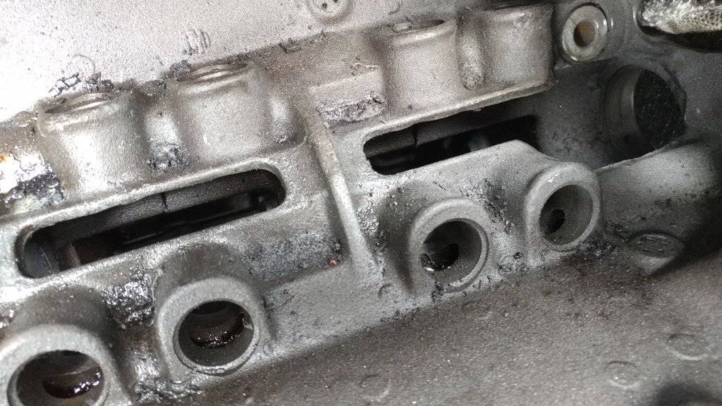

This block also has the thicker main saddle supports. Very nice.

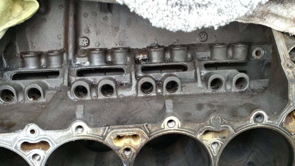

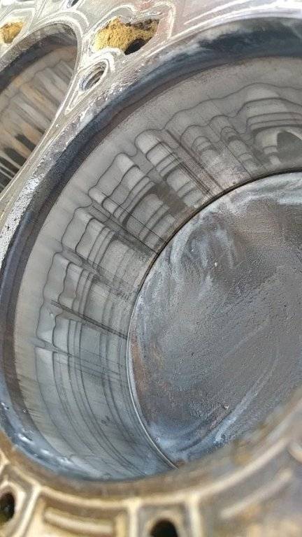

Fortunately, that's just a lithium grease, oil, and dirt drag pattern left from when I was stuttering the crank around by hand. It wiped right off. We did find what seemed to be a previously broken ring. The broken ring may have happened when we poked the pistons out past a barely existent (<.002"?) ridge, but, the bores look great. In fact, the whole block looks surprisingly good. Of course, Murphy may have a trick up his sleeve yet.
The next step is to gently grind away any really rogue casting flash to mitigate potential stress risers. The drain openings in the valley are particularly rough. They will be smoothed and slightly radiused.

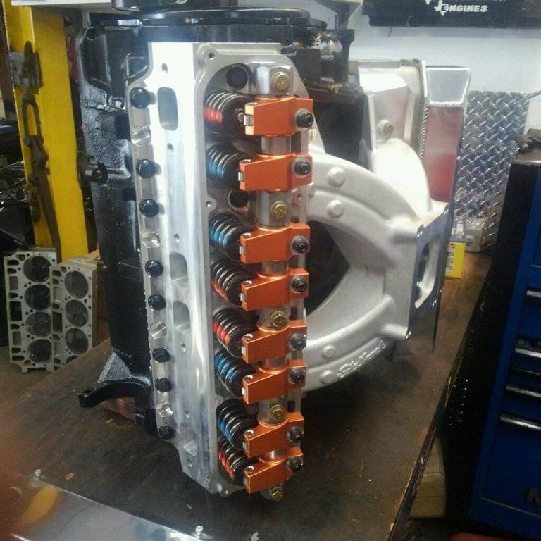

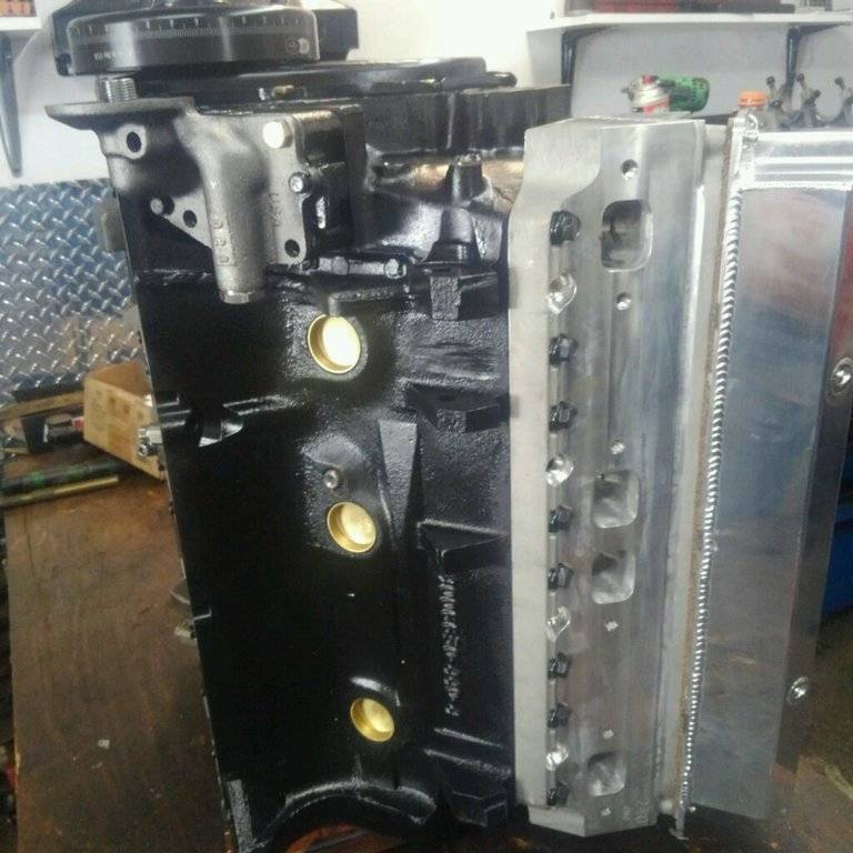

The 440 is finally in a machine shop and should be finished shortly. I spent the day at City Machine (NOT City Motors- do not go there) with Cruz and Damon. They are awesome guys and it was a pleasure to meet them.
Before taking the block there I did a little work on it by grinding off any casting flash or sharp edges.
I can post engine specs later, but for now I'm driving the Challenger to Galveston.

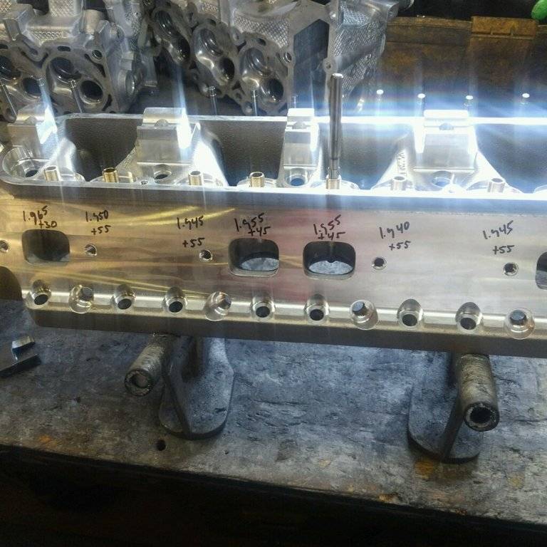

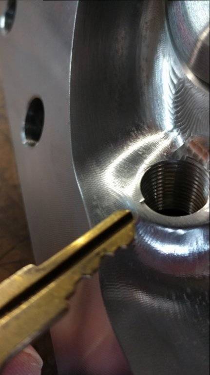

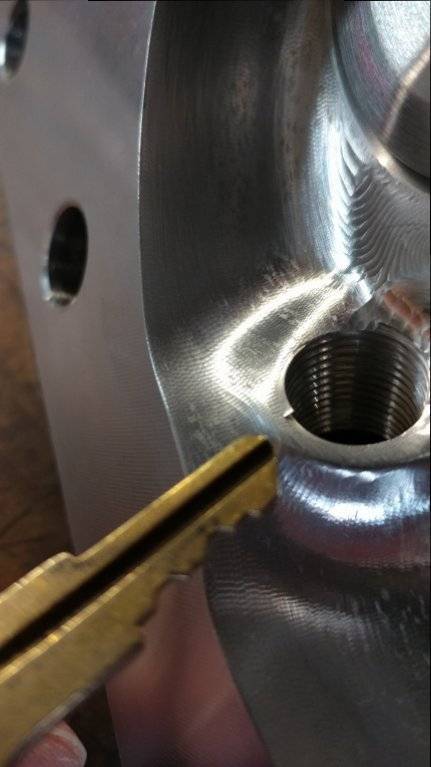

Some flaws on the Trick Flow heads:

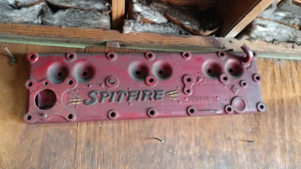

We picked this up for my Uncle's birthday. It may go in a swivel frame Power Wagon.
