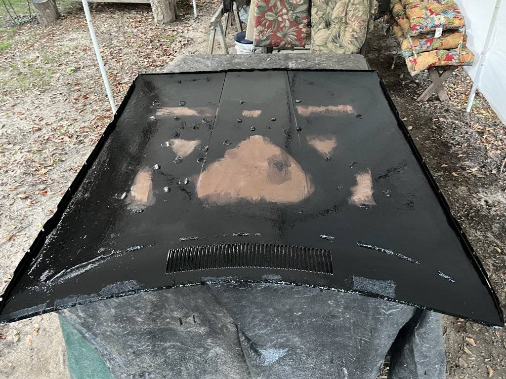

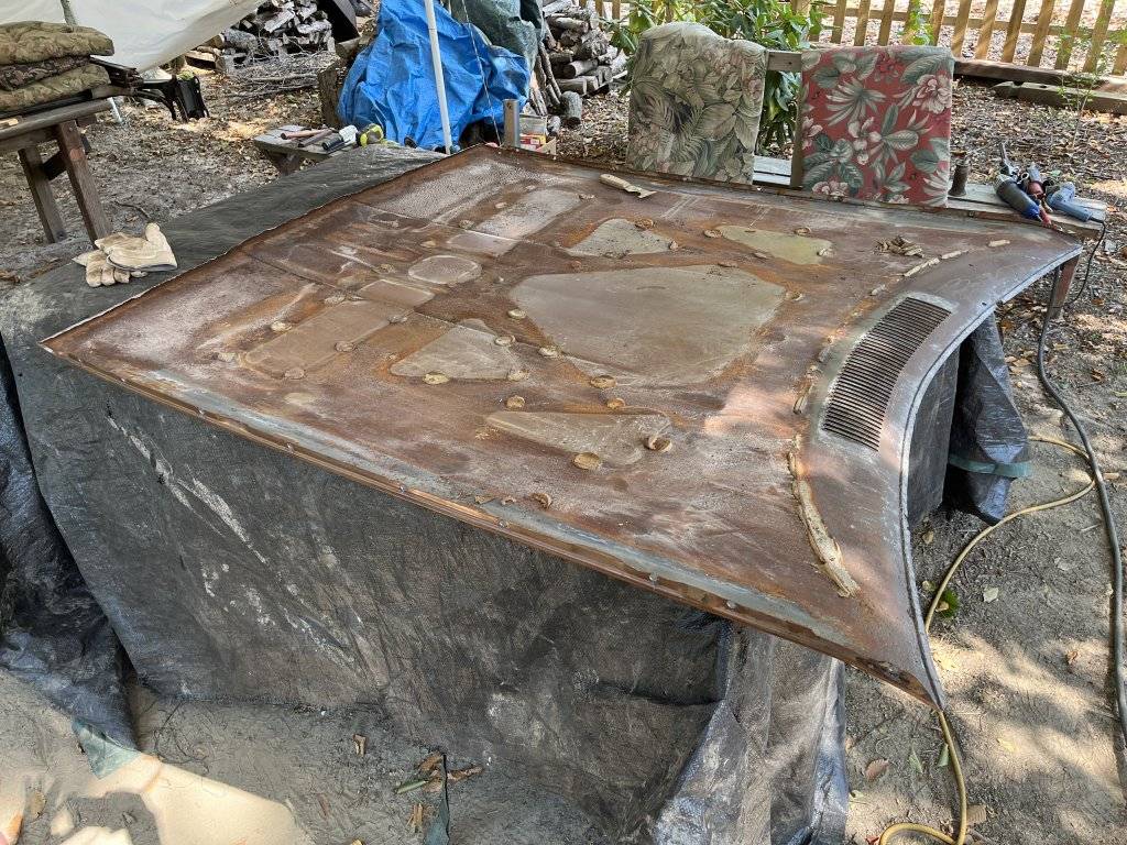

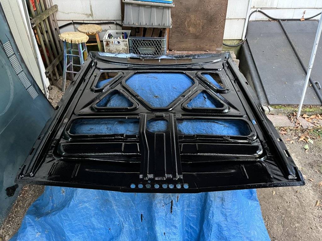

Jeeze. . . I didn't know you could even get a hood apart like that. Way-ta-go! Is that the final color, or are you going to paint it body-color?
Yeah, second time was easier than the first. It’s all of 20 spot welds and it splits like a clam. Currently it’s in rust converter black, once it goes back together I will paint it body color.

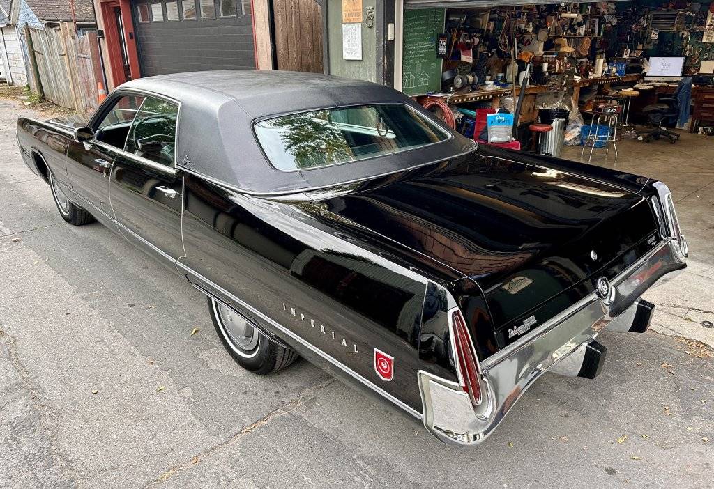

I drove the Imperial to the Hot Rod 100 run yesterday (Saturday), and had a great time. The car drove smooth and cool with the 93 octane gas I poured in the tank! I drove up with the top down going to the destination, which was Hajek Performance in Ames, Oklahoma - a 113-mile one way drive up state highways and county roads (232 miles total) The trip up was great. Until I got out of the car. I felt like I was gonna pass out, and almost straight away, started to puke. Felt like wrung-out dog **** for a few minutes! So, I got some hydration going, put the top up, and relaxed for a few before calling it a day and heading home. Pics follow of part of the amazing Hajek race car collection. His is predominantly Ford, but has a couple of Mopars and four GM cars. So impressive! I wasn't feeling like taking a bunch of pictures, unfortunately. The HRH had 135 cars participate this year!
BTW, the Imperial got just shy of 16 mpg trip average. Not bad for 5,580# with gas.

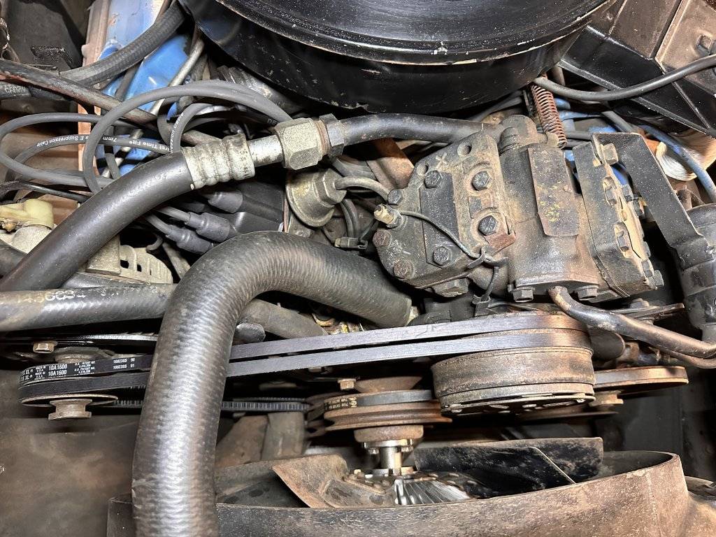

Molly and I swapped out belts and fan clutch on TB Imperial. Also did a vacuum test of heater core, we are happy to say vacuum held.
