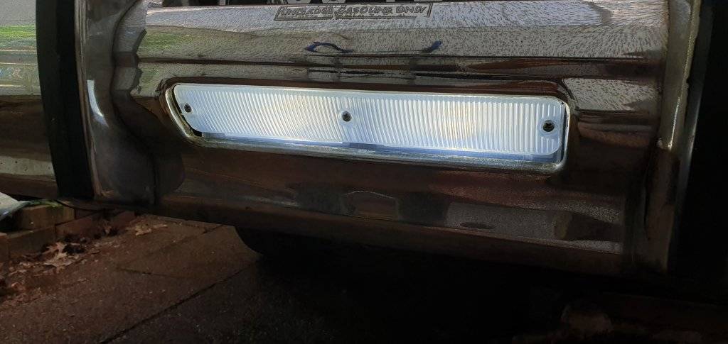

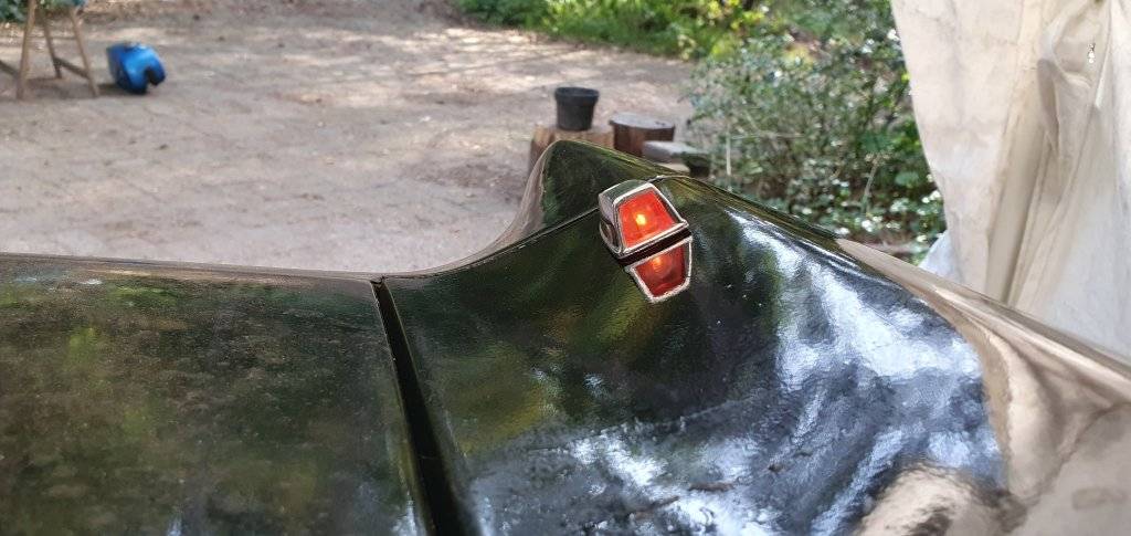

Oh and I added some fender mounted turn signals. Drilling those holes was kind of scary though.
Measurements courtesy of @75LandYacht, thanks John!

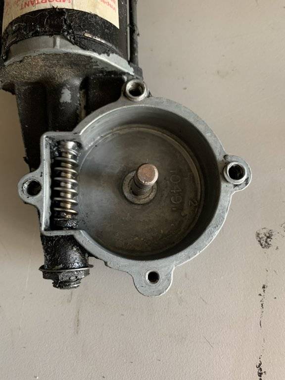

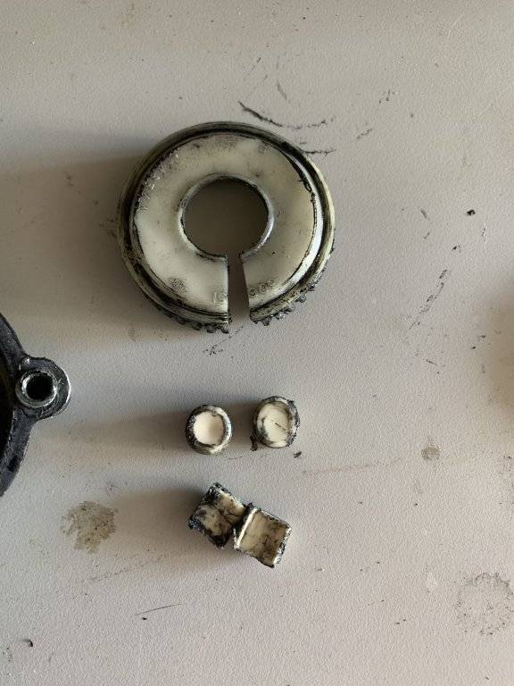

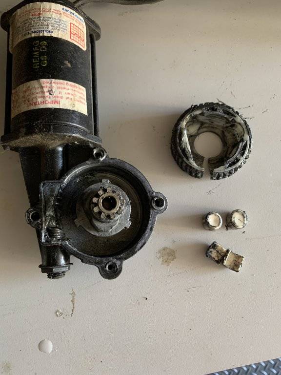

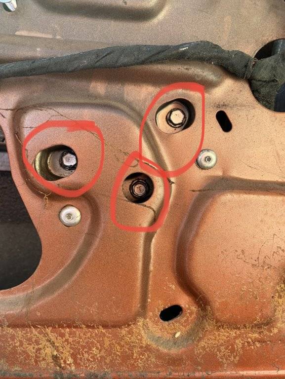

Replaced rear drivers door window motor gears. Plastic was destroyed as you would expect. Having never replaced the rear before, I’ve got to say it was extremely easy compared to the front doors. To replace the front motor gears, the window regulator and everything had to come out. On the rear, three bolts, and just the motor came out easy Peezy. The hardest part of the job was popping the door panels for access. Used can of brake cleaner to get rid of the old grease, packed with supplied grease and maybe a little extra I had, and back in it went. Works great, nice and smooth.

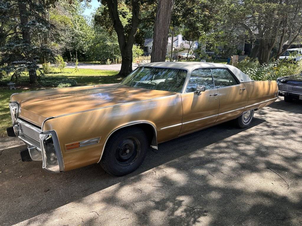

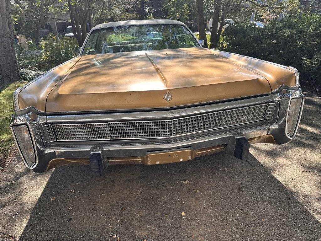

On Sunday I went for a drive to check out a western Canada 73 Imperial. This Imperial belongs to @Chris RB. Very solid unmolested all original low options Imperial. The sent when I sat in the cloth seats brought back so many memories of my dealership days.
Needs some sorting out but he is well on his way to bringing it back to the road.
This is a good link for helping restore the original paint. The Secret to Removing Oxidation and Restoring a Show Car Finish to Antique Single Stage Paints
I want to get this Imperial polished up.
