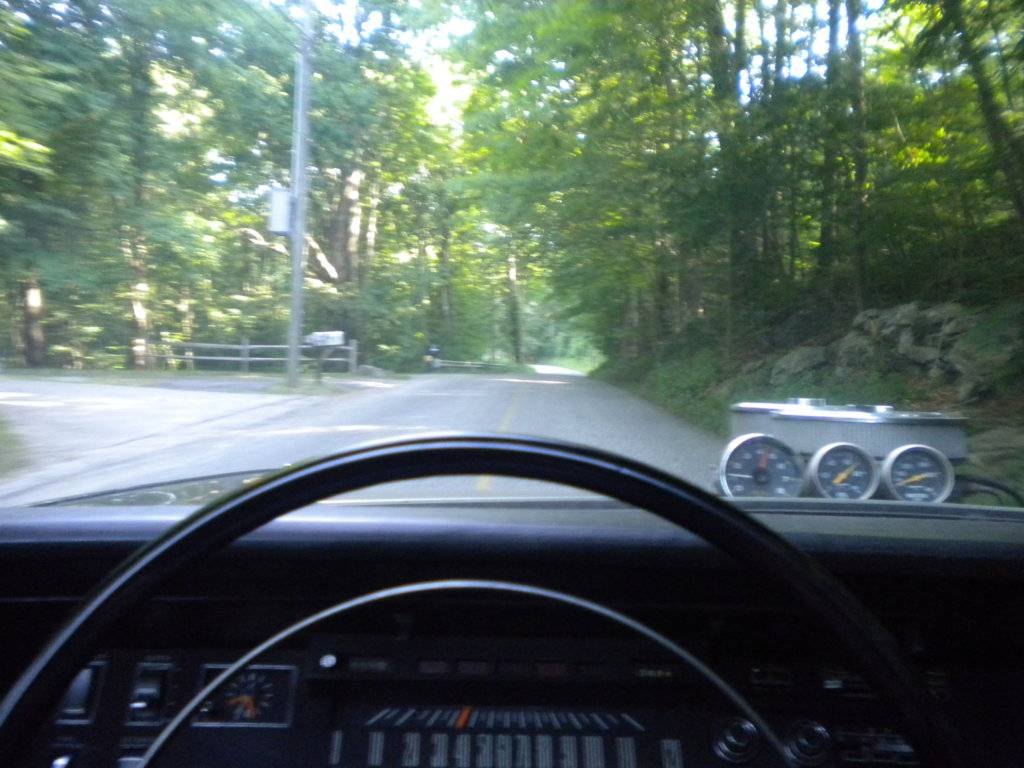

Drove it home in the rain from getting the new windshield put in.
" I can see clearly now........."

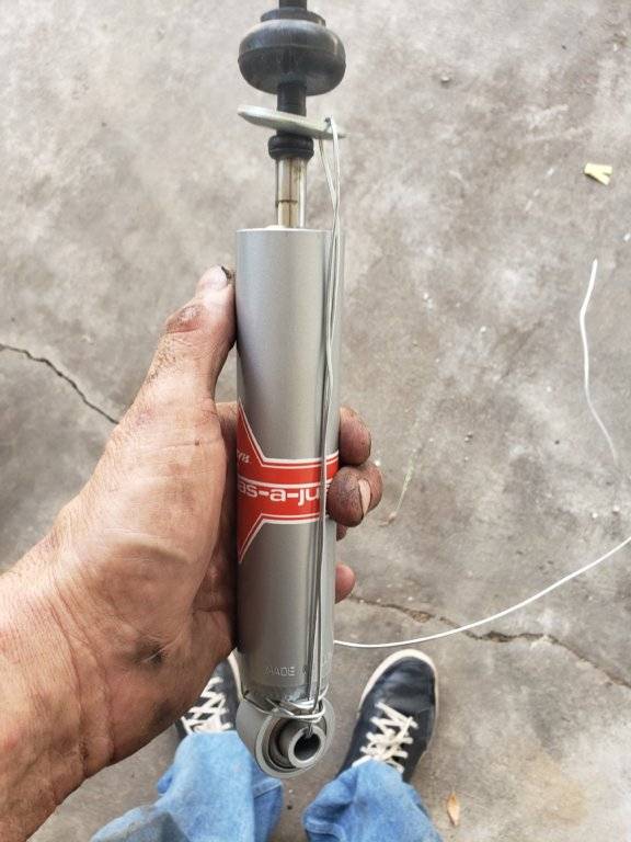

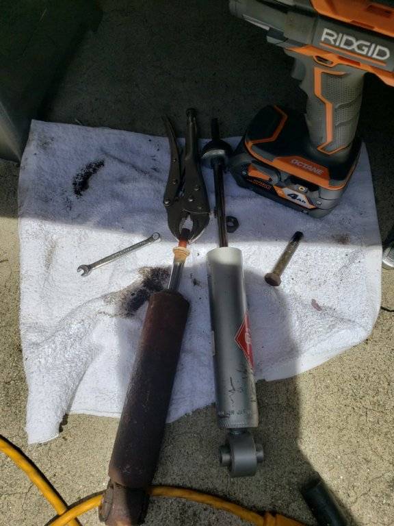

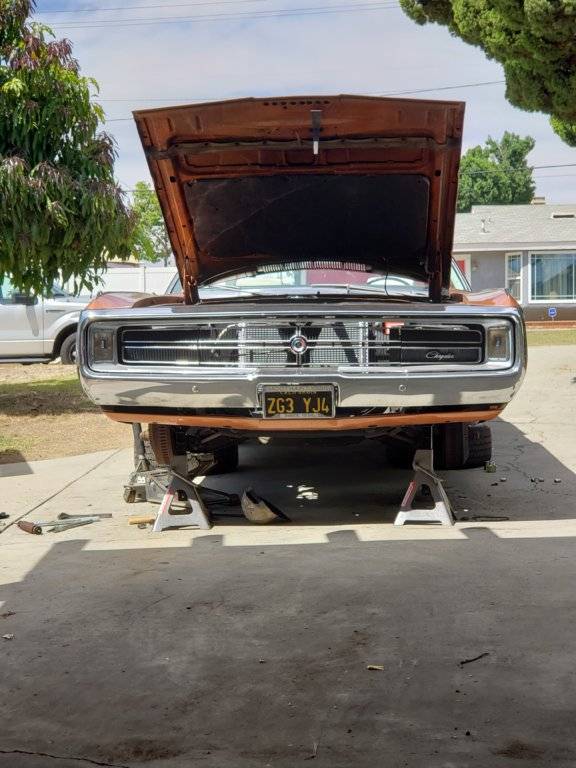

New front shocks. What a PITA!! Old ones were Sears heavy duty from what I could read. Had to use the angle grinder/cutter to cut tips off old shocks. Compressed old shock....no rebound. Had to drop axle to get in. Compressed new shocks, but couldn't get them in, so dropped axle. That's the easiest way I found. Was going to do rear but I'm beat lol.

I was looking at those gas-a-just shocks at Rock Auto. Could you let us know how well they work?
Congratulations on the job you did.

I just recently installed a full set of KYB gas adjust shocks on my 69 Fury. I got the rears in no problem but took the car to my buddies lift for help for the fronts..
I love the shocks ride. Firmed it up but not rough. The rears had air shocks and the front were crap of some recent kind. It felt like I added a rear away bar. Everything is so much better. I recommend them. With a discount special I got all 4 for 120 bucks or so at Rock Auto.
Good to have confirmation KYBs are good. I think I read on here was a good option. Just did right rear, just the left rear to do, then done. I also hit the drums with a wire wheel and some flat black Rustoleum.

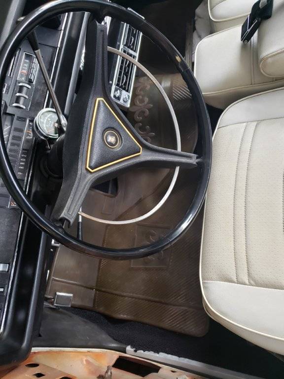

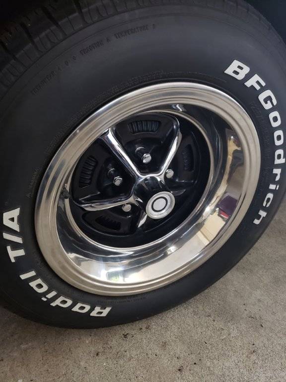

Shocks all done front and rear. Long *** day! Also replaced all the lug nuts. PO had all locks and no key! Front left was LH thread, left rear was RH. Thought left would of been all LH thread. That added time to the day. And new/old floor mats!! Period correct I think.
Wheels are 15x8 all around. Thought they were 15x7s all this time.
Went on a 10 minute drive or so, tried to find some dips etc in the road. Night and day! Very controlled, no wandering or fluffiness. I like it!! Couple more pics...

How do you like the KYB's???
