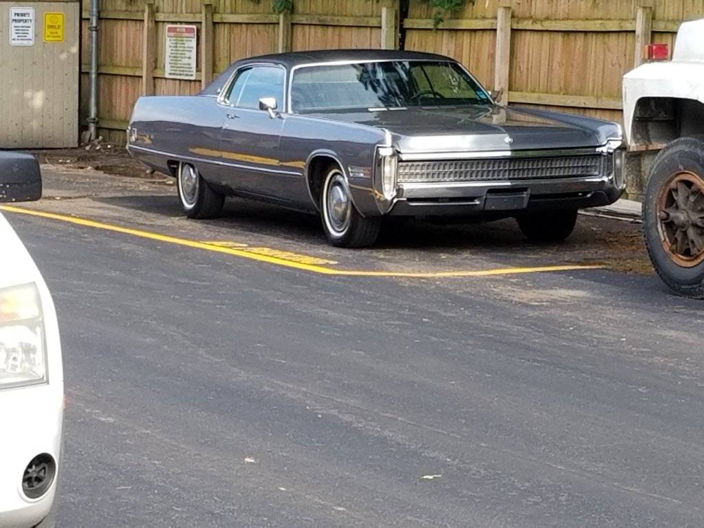

The old ones are ready for Volo. Only need to put the skirts back on the Imperial, and wash them.

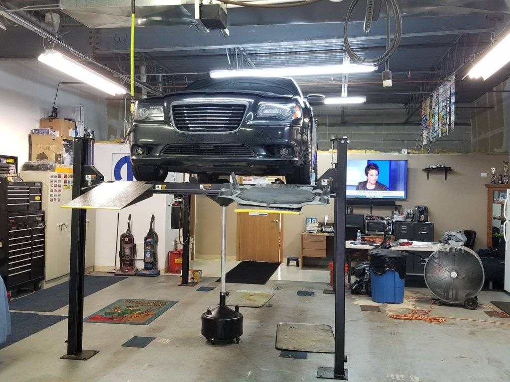

Just been paying attention to old cars lately, but realized, I can't neglect the servicing the new one.

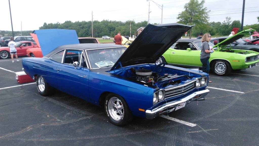

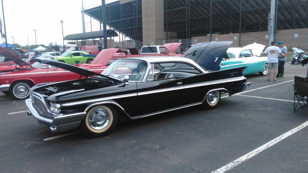

Took ours to a car show

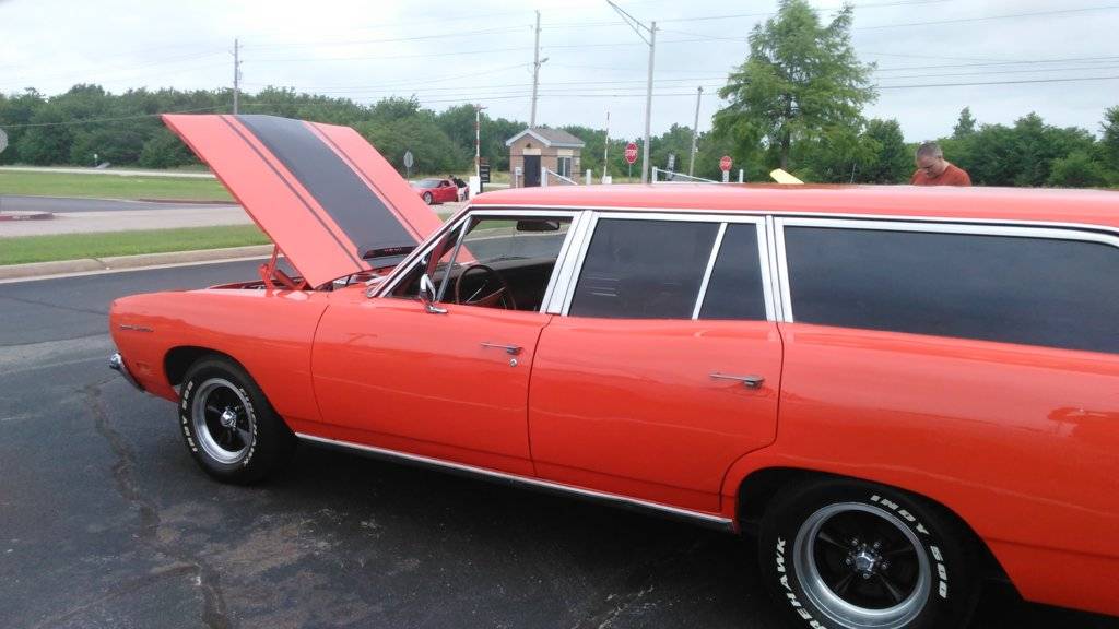

Got to hang out with some friends...

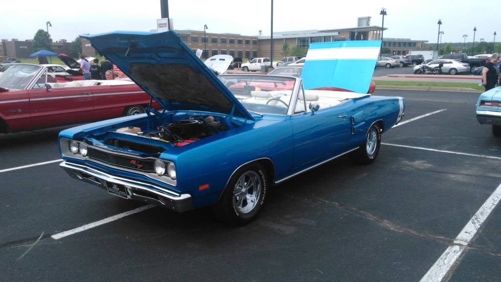

And a couple of older relatives I hardly ever see.
It was a good day!

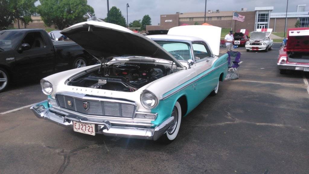

If that Desoto had the chrome on the roof, if swear it was the one I sold back in the early '80s.
And you're right...it's sweet!
I believe it and the New Yorker are works of automotive art.
I've never really seen examples of these up close before.

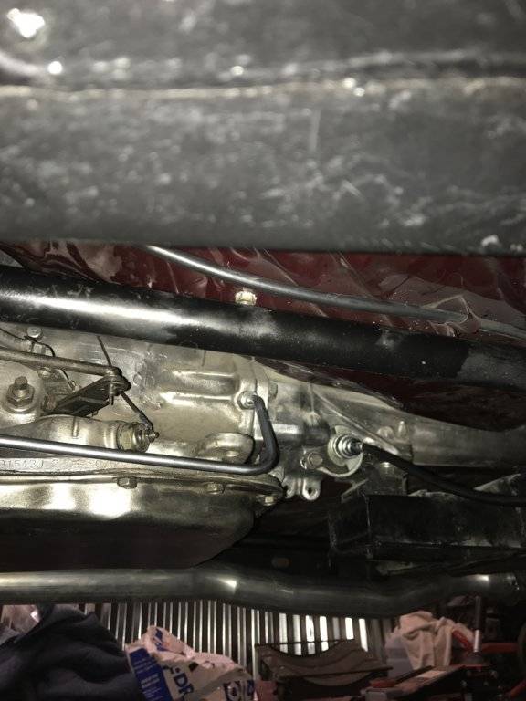

Came home from vacation to a little transmission seepage on the floor. Transmission pan gasket seeping a little and my speedometer pinion seal is leaking. Re torqued the pan, I probably got about 1-2 turns out of every bolt. A little thermal expansion must have compressed the gaskets a little. I had to order a seal for my speedometer pinion. Hopefully have it by Friday. Also decided to check my valve cover torque, it was even looser but not leaking yet. It is amazing at how much a little heat expands things and contracts when cool.
Fixed my speedometer pinion seal on Thursday evening. First attempt was putting in with it installed. Not much room to work. It was much easier and faster to pull the whole pinion out.
