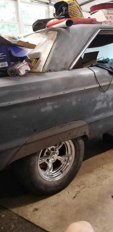

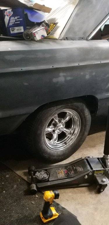

Test fit a wheel today just to see if it would clear. 275 60 15 on a 15x8 wheel. Now the next question is skirts or no skirts hmmm I do like my women without their skirt but there's something I just like about her having them on. So what are yalls thoughts. Skirts or no skirts?
I like the skirts on goes with the era of the car. The good thing is you can put them on and off whenever you want.

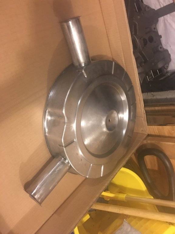

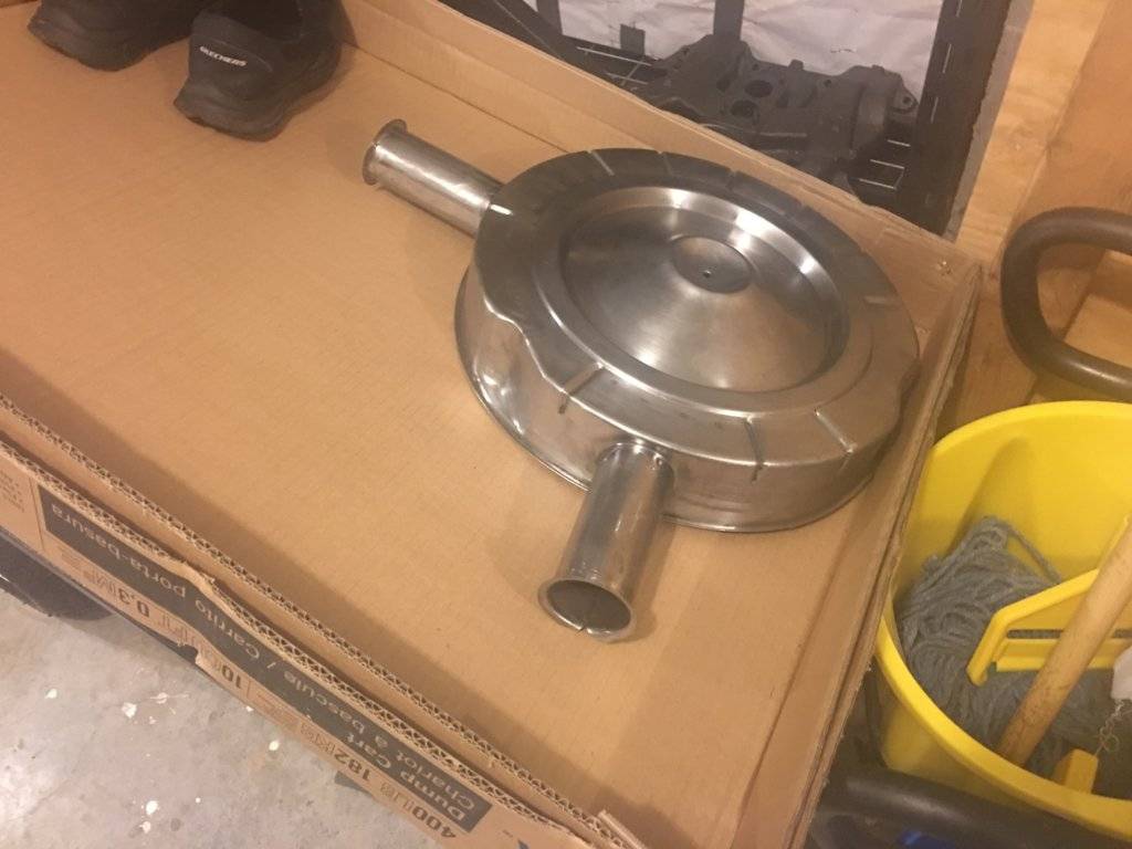

Started preparing the dual snorkel for prime and paint.

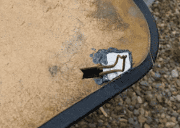

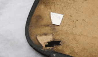

Installed a vapor barrier (which was missing) and sprayed undercoating over some spots where the factory stuff was cracking away. Also repaired two spots on the door panel where the clips pulled out by JB welding in some thin pieces of aluminum.

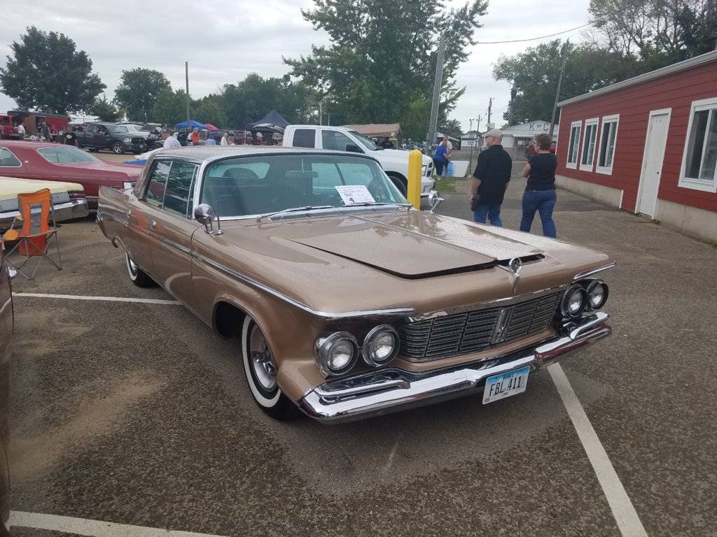

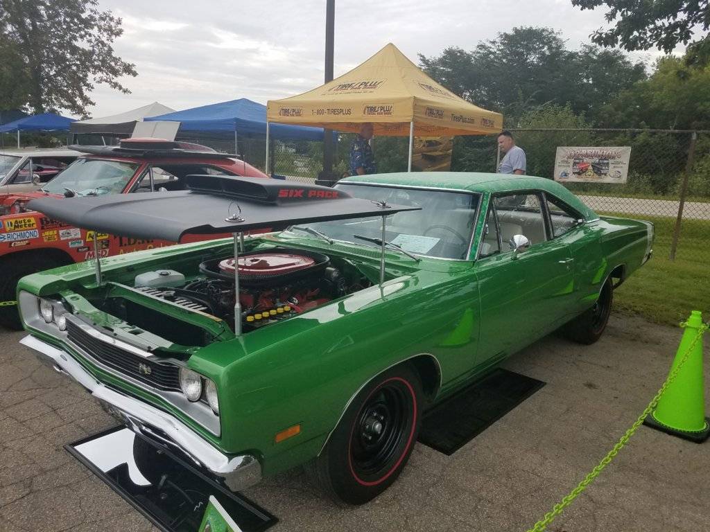

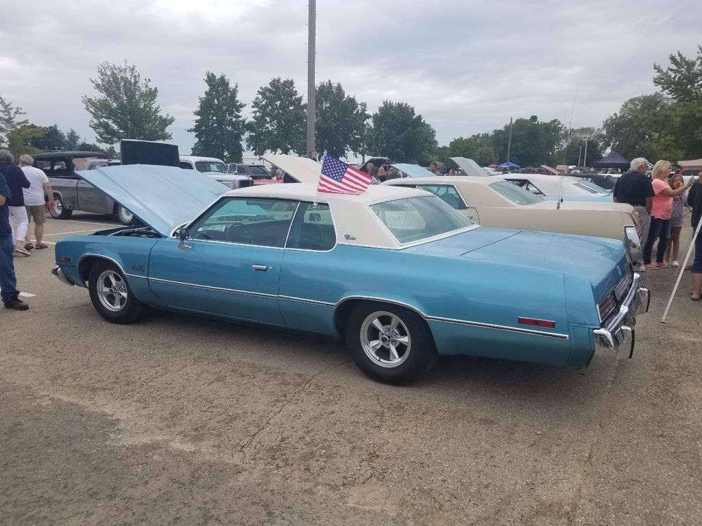

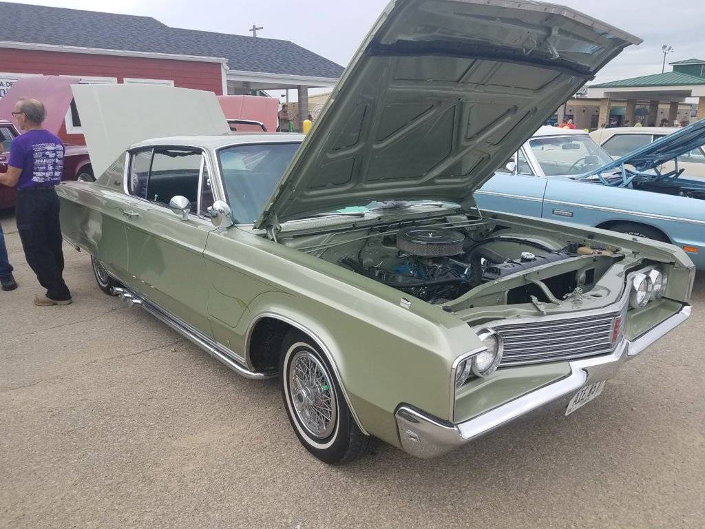

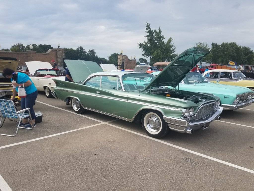

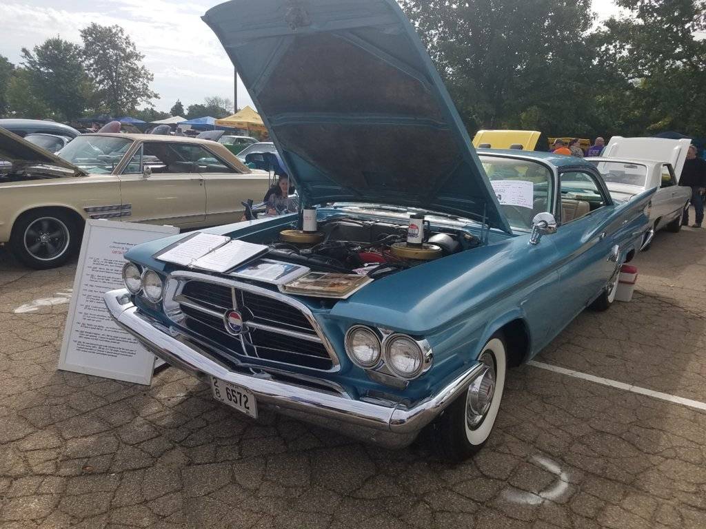

Attended MoPars on the Mississippi in Dubuque, Iowa. Almost 300 cars were there. Julie and I got 3rd in class with the '62. The Polar blue 300F was stunning. 2nd went to a survivor '66 300 which was almost immaculate.

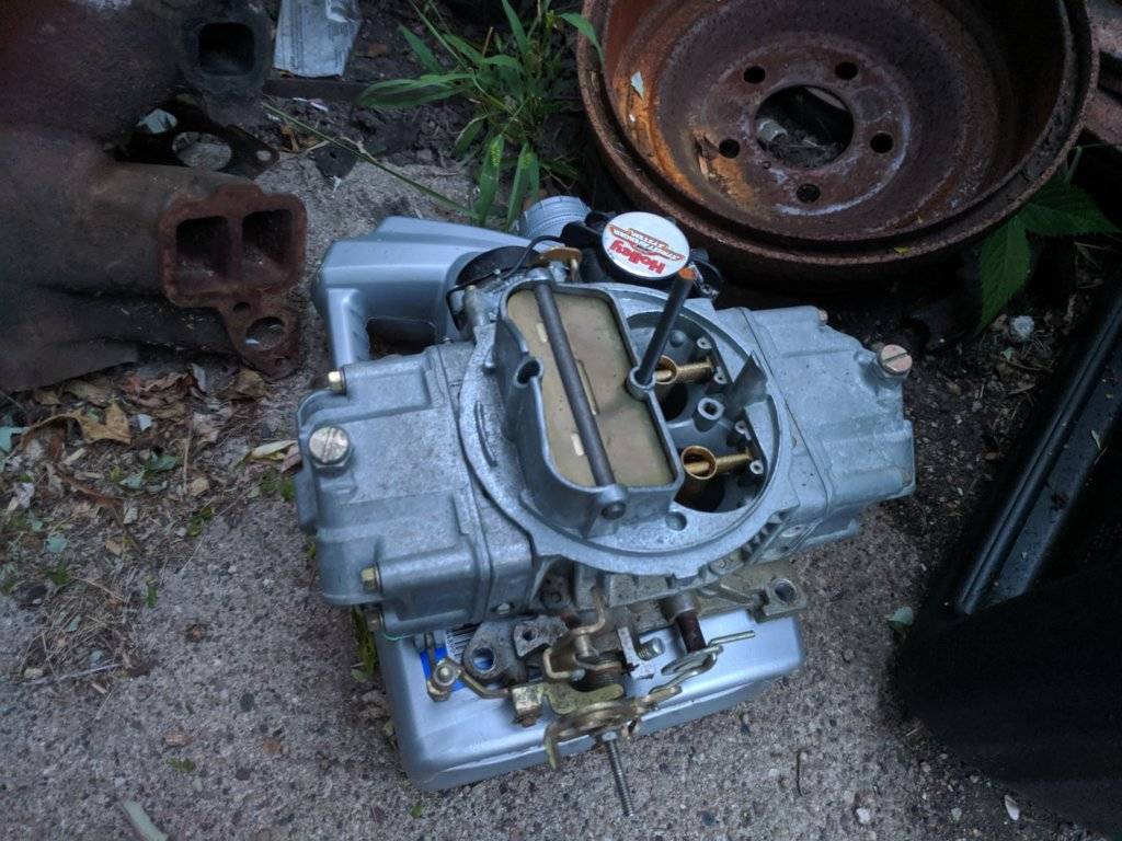

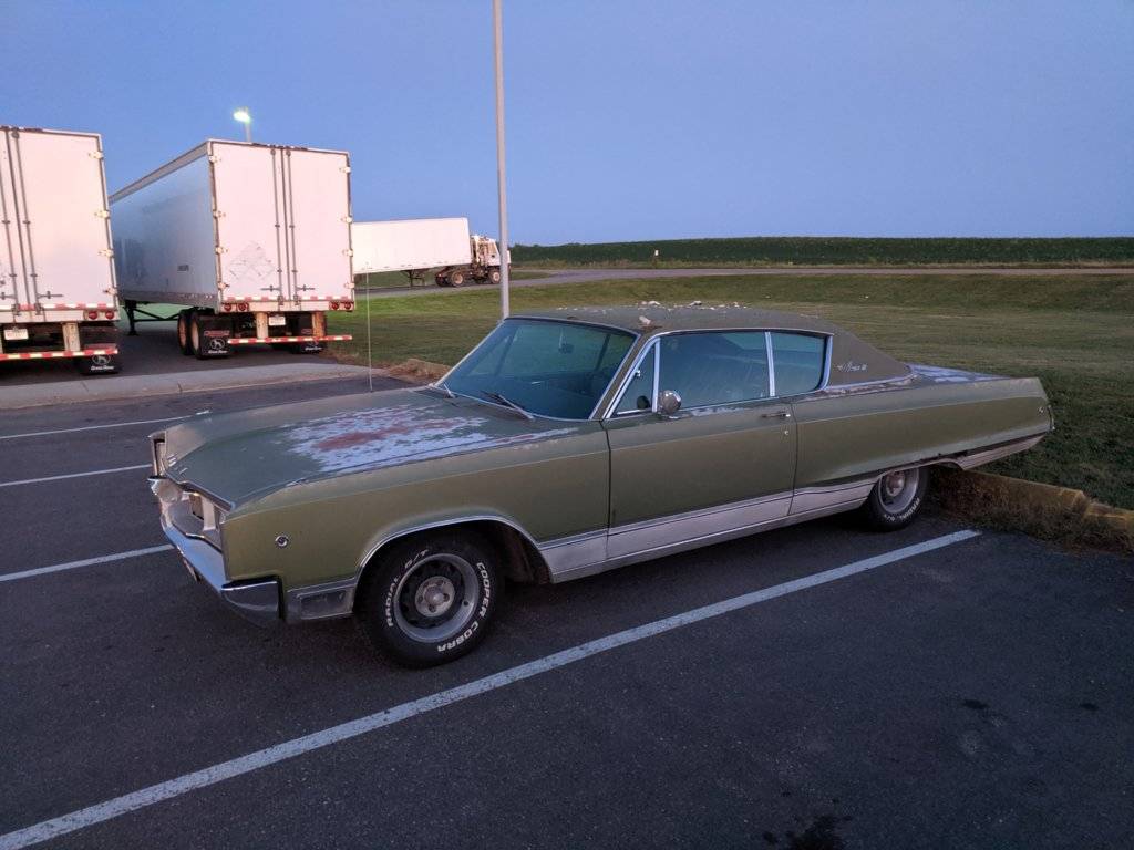

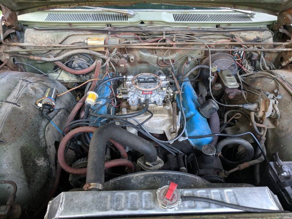

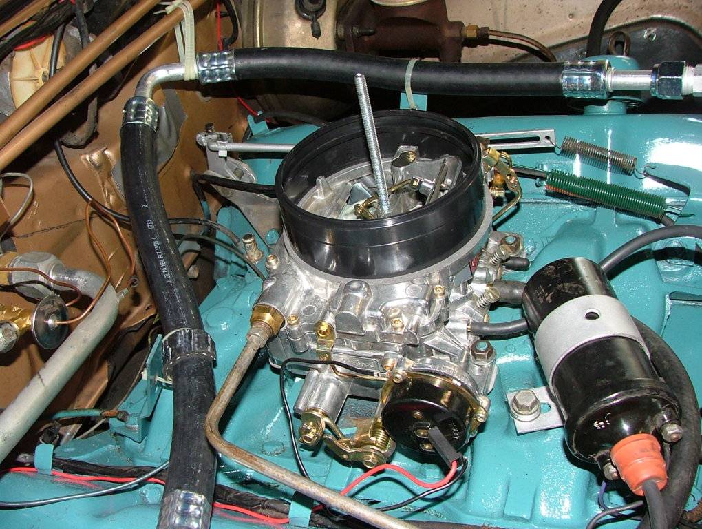

Swapped carbs on the '68 Monaco 500, went to an Edelbrock 1407 from a Holley 670 Avenger. Just cleaned it with carb cleaner and wiped the dirty spots as much as I could. New (Chinese) gasket for the top and squirters, reused old plunger and seal as the Chinese stuff was not the same. Plopped it on the intake, added a clear filter and fired it up. 17" of vacuum so I went for a test drive. Not set correctly, it still was the best performing six miles I've driven with the car! It has a large stumble when you hit it, does it three times as I'm letting off the pedal, and then just sails! I hammered on it good, got the car up to 95 on the speedo, and came home to regroup. It's not even right and I'm ecstatic! I needed this to work, and it did and helped pull me out of my funk I've been in this year car wise. It goes like a scalded chicken, and I can't wait to get it turned a little better. As @71Polara383 would say, "burnout ready" is what I'm aiming for. :thumbsup:
Getting ready for the 2020 National Tour.
The Edelbrock was the best thing I did on my 383, just wish I wouldn't have wasted time and money on two afb rebuilds...
Drove it to work. Still need to fine tune the wot stumble, shucks.

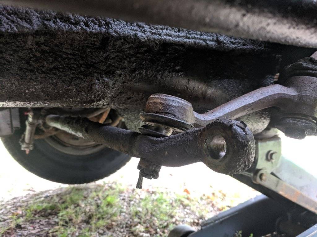

Took off passenger side tie rods and found a worn out idler arm. Summit Racing to the rescue. Will have it on Wednesday.

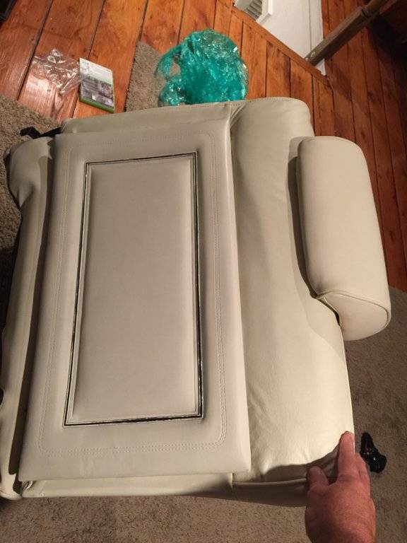

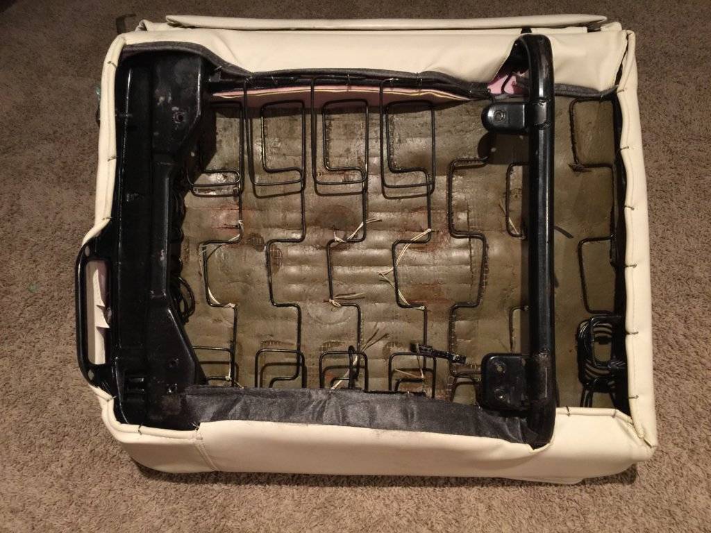

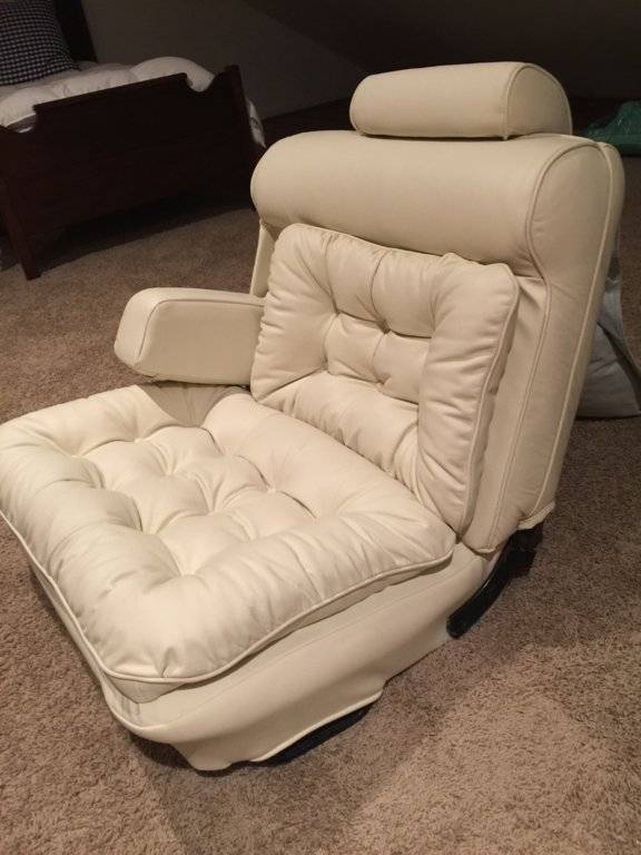

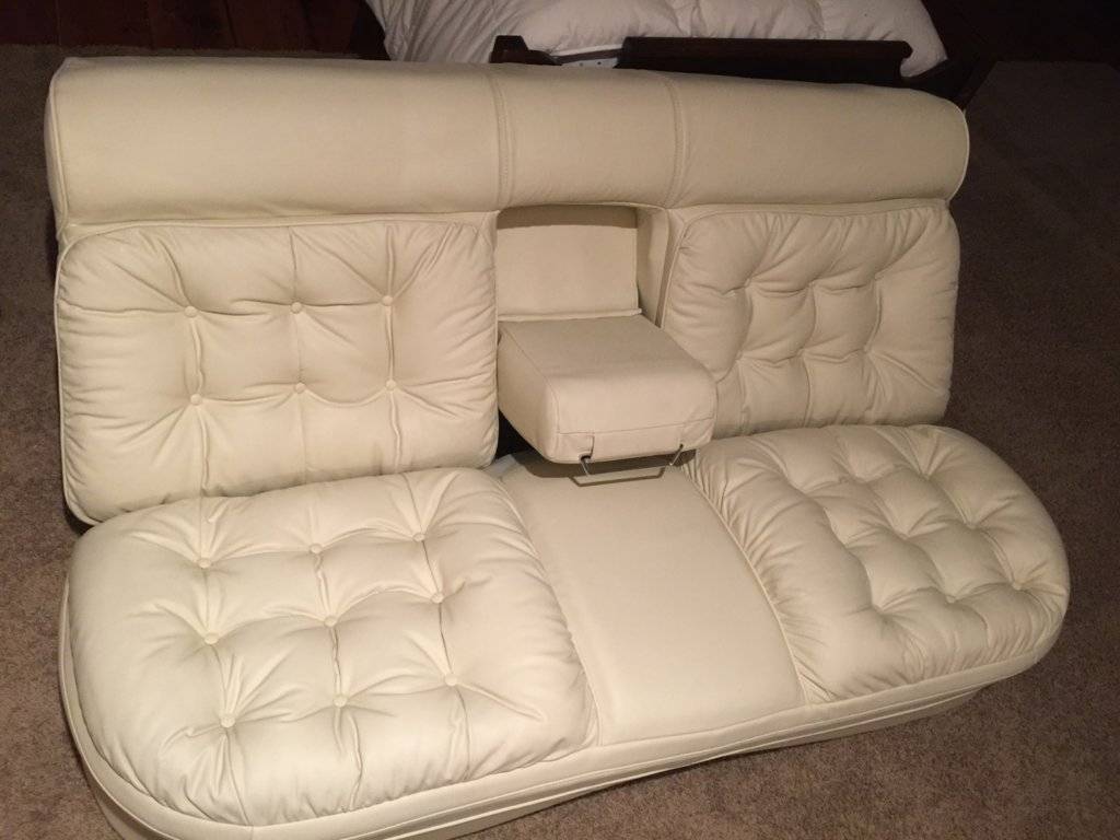

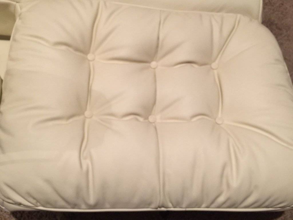

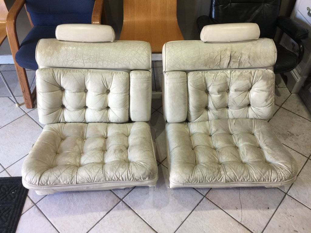

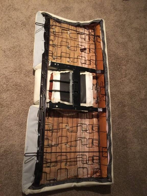

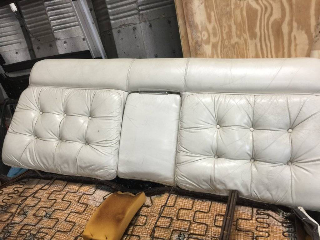

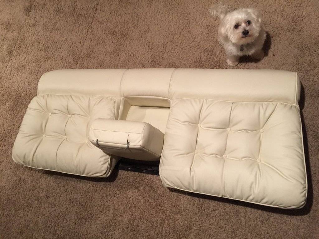

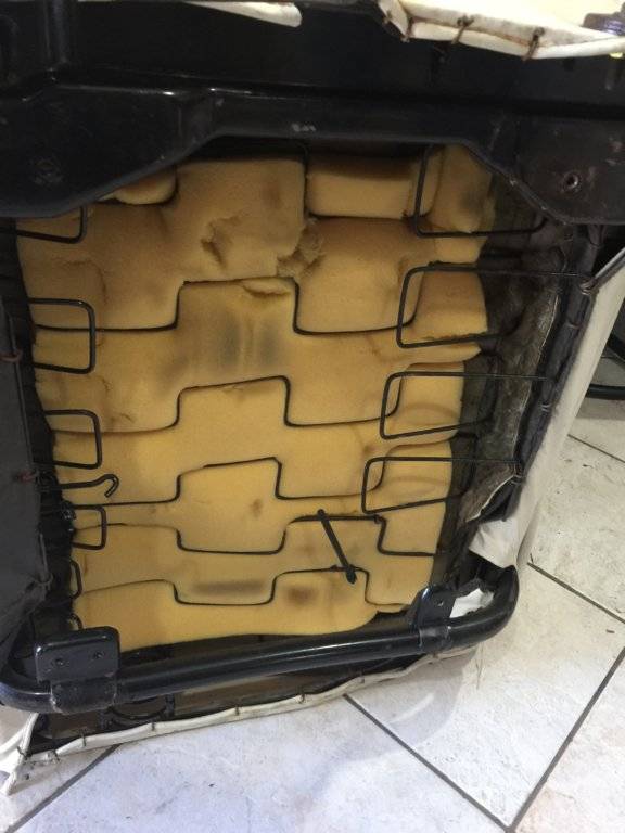

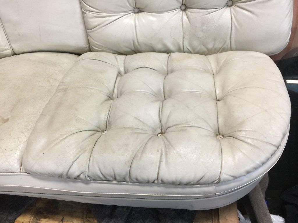

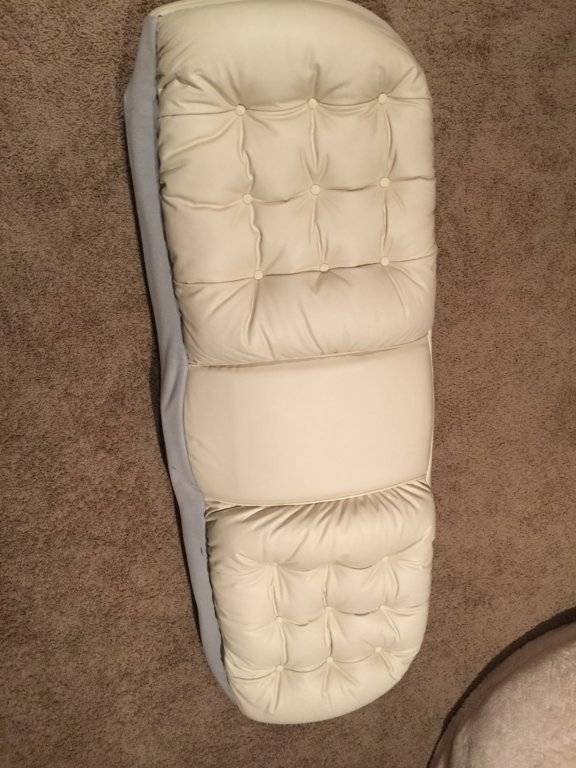

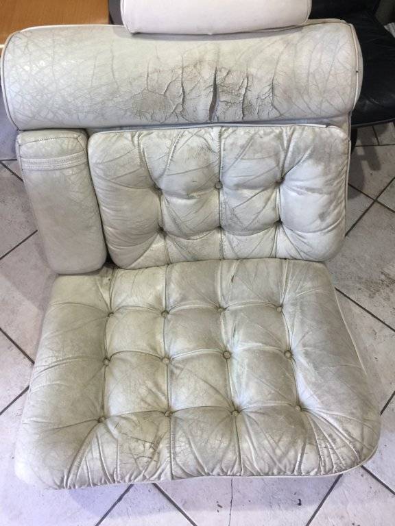

WELL fella’s my wait is finally over, I went and picked up the seats today for my 77 sunroof NYB.. very excited to say the least. I’ll store them in the house until I’m able to get the rest of the interior ready for installation. Sorry for the So-So pictures, but you get the idea. It feels absolutely amazing. And they smell even better. LOL. it’s all wrapped in leather. I’ll gather the “before” pictures and post them next..
