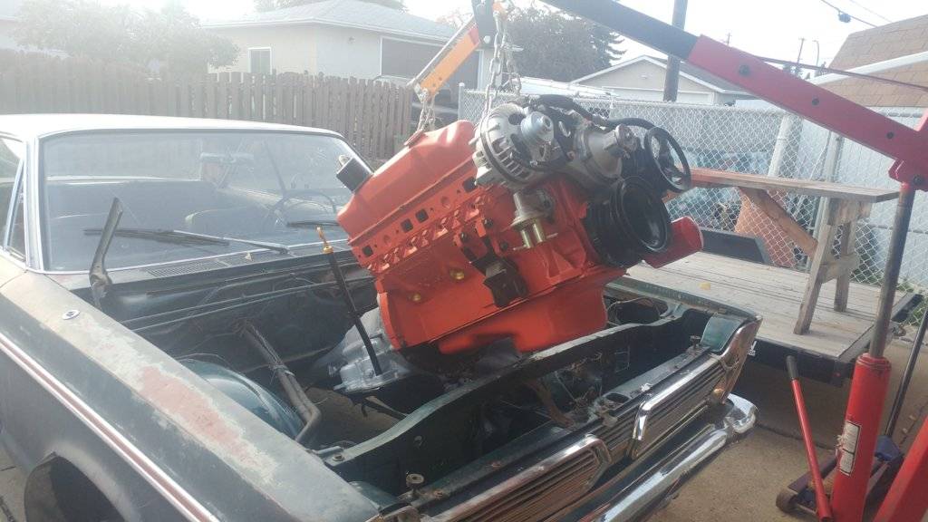

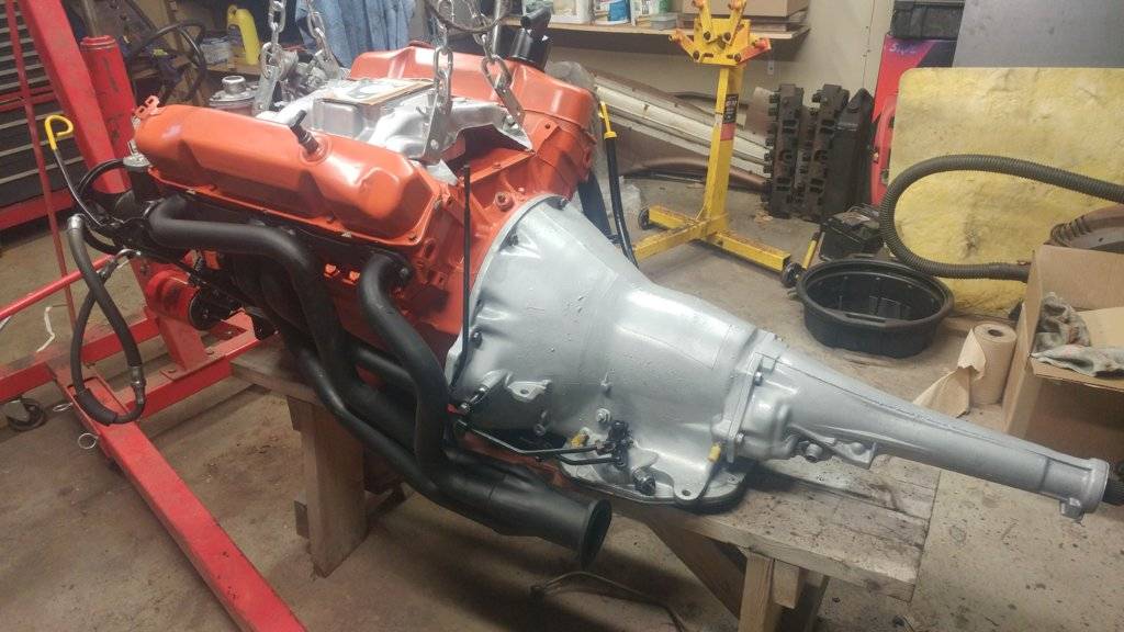

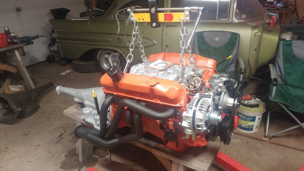

Finished up the rattle can rebuild of the 383/727 going into my '66 Fury barn find. It came with the car, 69 date code on the side. Dunno if it was a magnum, or just a 4 barrel engine. It was allegedly a good runner, but man it was filthy. I stripped all the mid 70's front dress off of it, then took it down to the short block for a close inspection and cleaning. The timing set was junk, really sloppy and still had the nylon gear. I swapped in a double roller set, then replaced every seal and gasket plus all the freeze plugs. I added most of the front dress stuff from 440 source. I probably would have painted it turqoise, except I couldn't find it here anywhere...so hemi orange it was. When I cleaned it initially the only paint I could find on the block was orange anyways.
I had to work early today, but was feeling frisky enough to drop this into it's new home before it got dark.
Success, and tucked into the garage again. I didn't like having it outside...

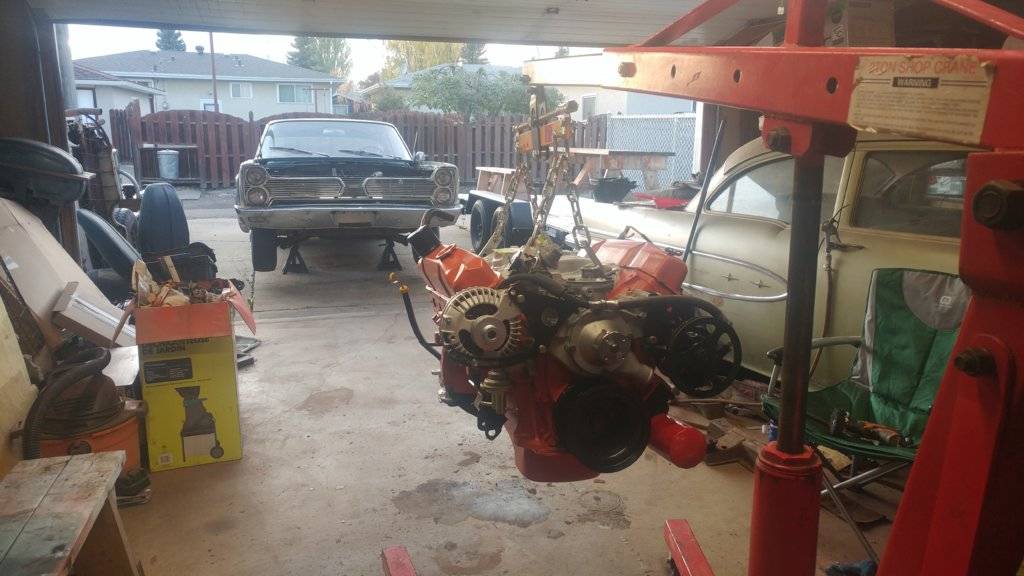

Tomorrow more details, linkages, etc. Try to see how the headers fit. I went with some "B"/ "E" body Summit headers. Gonna be tight, but I think they're going to be OK. Kinda sucky the collectors end up inboard of the torsion bars.
I'm just happy to have this milestone behind me before our weather turns to crap and the car is sitting outside in the snow. We've had snow by mid October before, not that uncommon...so I was feeling a little antsy to get to this point.
Beer time!
View attachment 321362 View attachment 321363
Beer time!

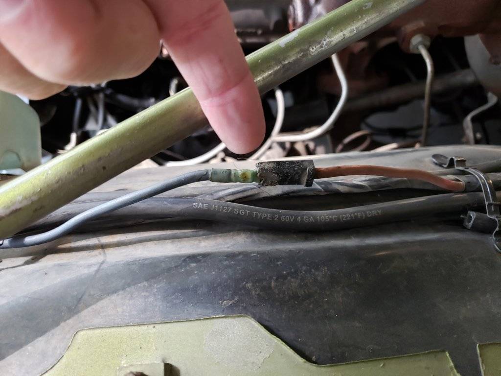

Took my Newport to Awana last night at my Church. Afterwards, my wife said we needed chips for the BLTs she was making, so I went to the store before going home. On the way to Raleys I noticed my lights flickered every time I put on my brakes. Never seen that before, been 16 years! They also flickered when I hit the turn signal. Hmmm....
Went into the store, bought some chips and sodas, went back to the car an noticed a problem immediately: my interior lights did not come on. Uh oh! Sure enough, no turning of the starter; I had no electricity at all! A friend happened to be there; tried to jump it. Nothing. Called AAA.
Don't know what the problem is; I looked at all the usual suspects. Doing a brake job on a church member's pickup this afternoon. Hoping to have time after to check the Newport.
In the meantime, driving the Gremlin!
View attachment 320559 View attachment 320560
You can see the potato chips in the back seat!
Problem solved!!! Today I finally had the time to look at my car since this happened two Tuesdays ago. (day off.) It did turn out it be a very simple thing; in fact it's a second-time offender. The wire in the picture has a bad connector on it that I need to replace. The tape I pout on it a few years back failed and it separated again. No power! I plugged it back together and viola! Instant lights in the interior. Had to put my charger on the battery though as it was drained; wire must have been loose for some time, which is probably why my lights were flashing.
Also found the cause of my PS leak: looks like both the pressure and return hoses on my pump are bad. Since the car was parked backwards in my garage I was able to see the amount of PS fluid that had drained. Whoa! Hitting Rockauto next!
