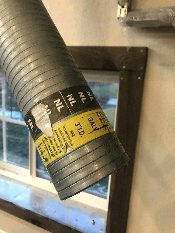

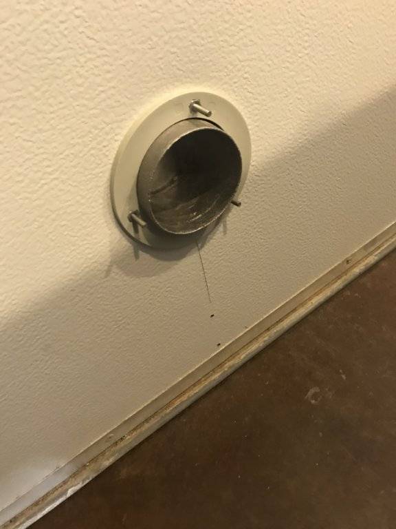

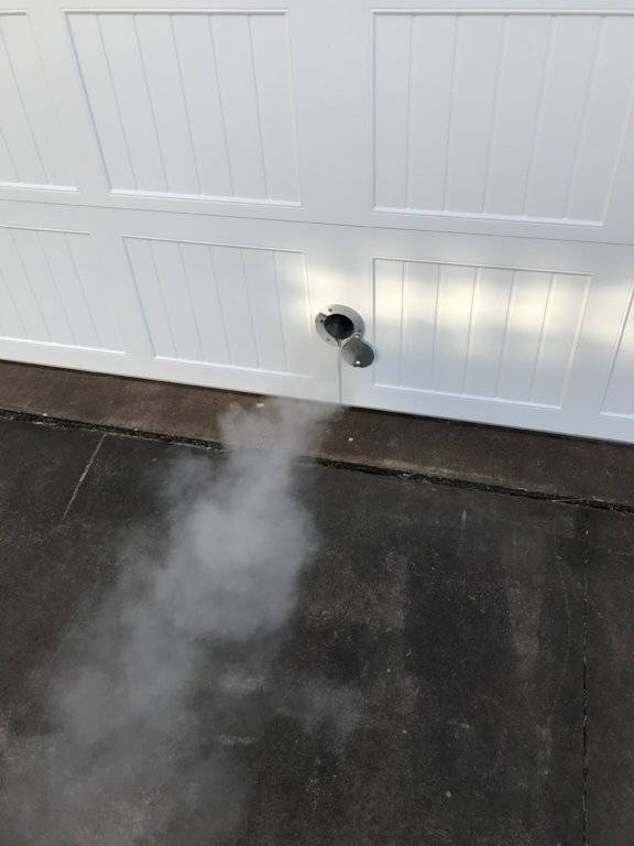

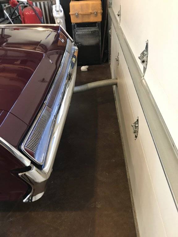

Hooked up my exhaust extension so I can do some tuning this winter without opening my garage door.
It also seems to bring my garage up to temperature pretty quickly.
I may need some venting, but pretty good so far. At least I am not getting sleepy yet.
First started, choke on, hi idle step. When warm it is clear.

Very neat idea....more info and pics please of that system.

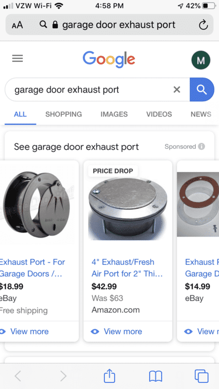

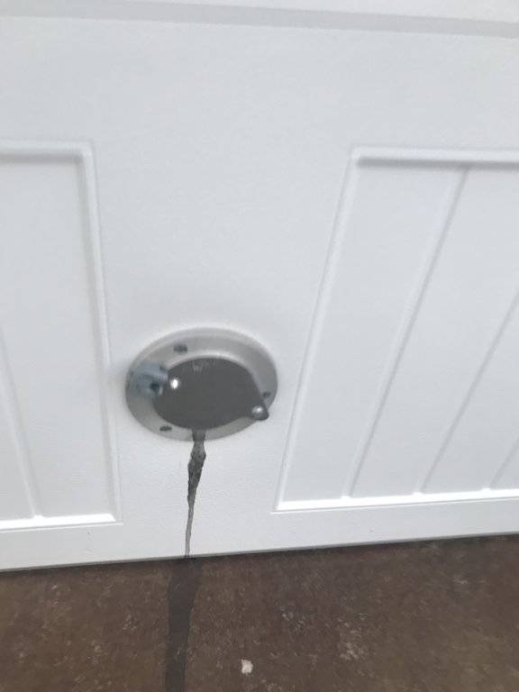

I used a 3” exhaust port. Basically need a large hole saw to cut a hole into your door and bolt it in. I am using a 3” flex pipe that fits tightly inside. I may try a 2–1/2” flex that goes all the way through. As you can see I get a black drip from the condensation. My doors are insulated so I put an insulation plug on the inside when not in use.

Cool Rig.. does the carbon come off the door post tune?
It does wipe off. But a pipe all the way through would be better.

So how, or what do you use to attach to your exhaust pipe?
I had one that used a rubber hose that fit over the exhaust pipe and had a foam gasket to help seal it to the pipe. Didn't work so well on duals so had to buy a wye hose setup. Have since moved and didn't take the thru door setup.
