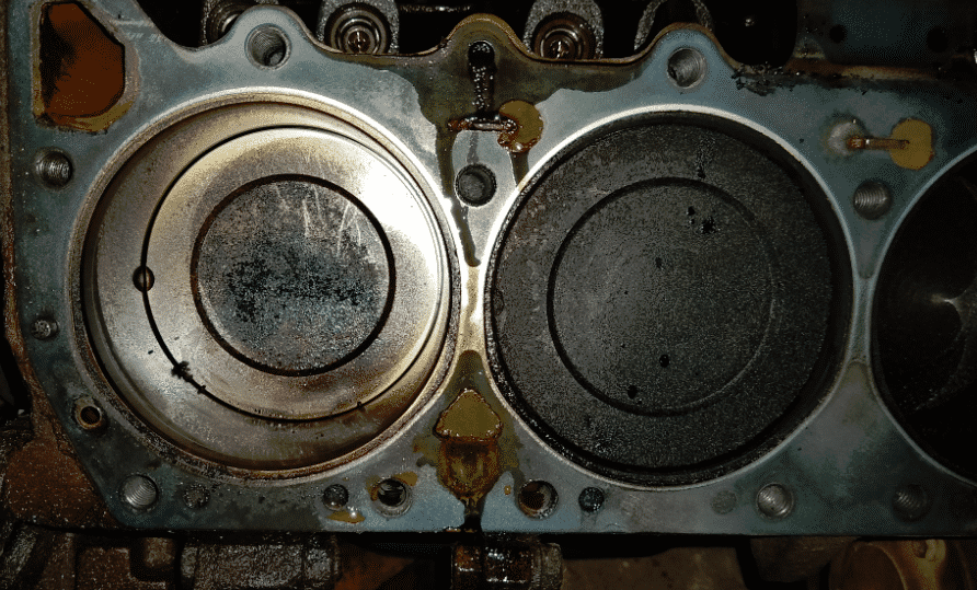

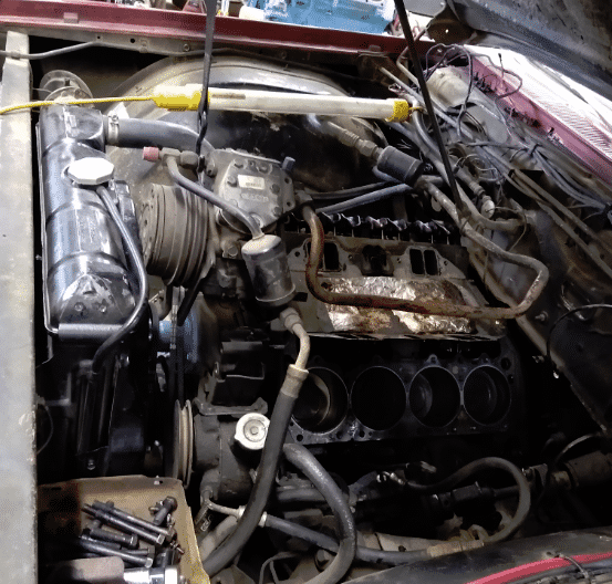

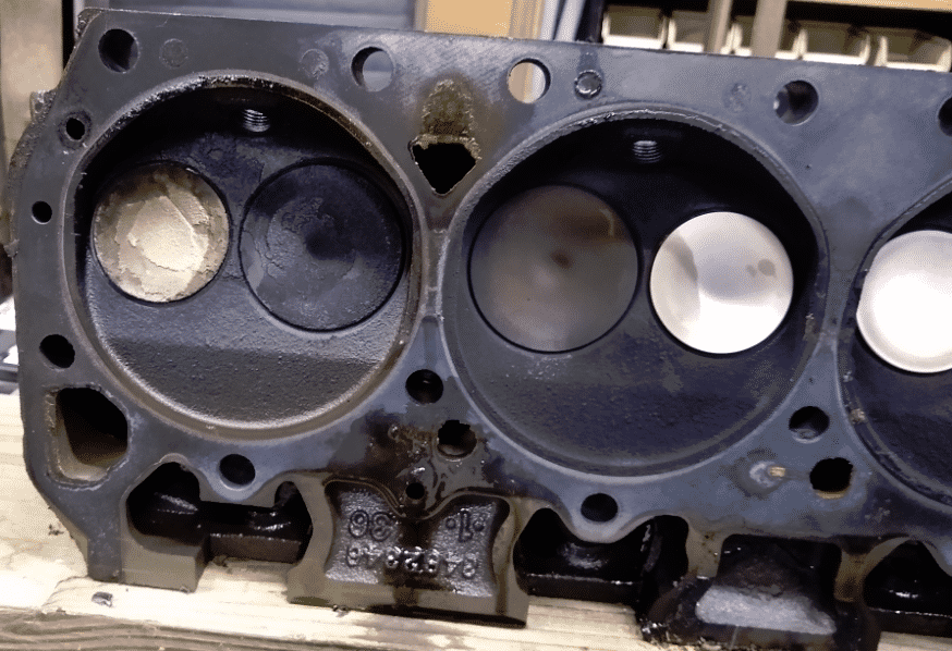

Looks like a head gasket leak. May be slight and effected by temp. A little coolant in the hole will decarbon a piston real well.Started looking for the fouling on #1. Nothing obvious yet.
A little extra carbon on the valves for #1, funny thing is the top of the piston is way cleaner than the others. I am curious about the darker patch on the front outside corner of the head.

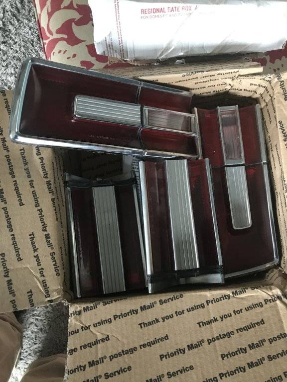

Now for the Rear BumperFound a complete set for $167.
old set in pic on car. Pretty sad shape. New ones go on if the rain stops.
