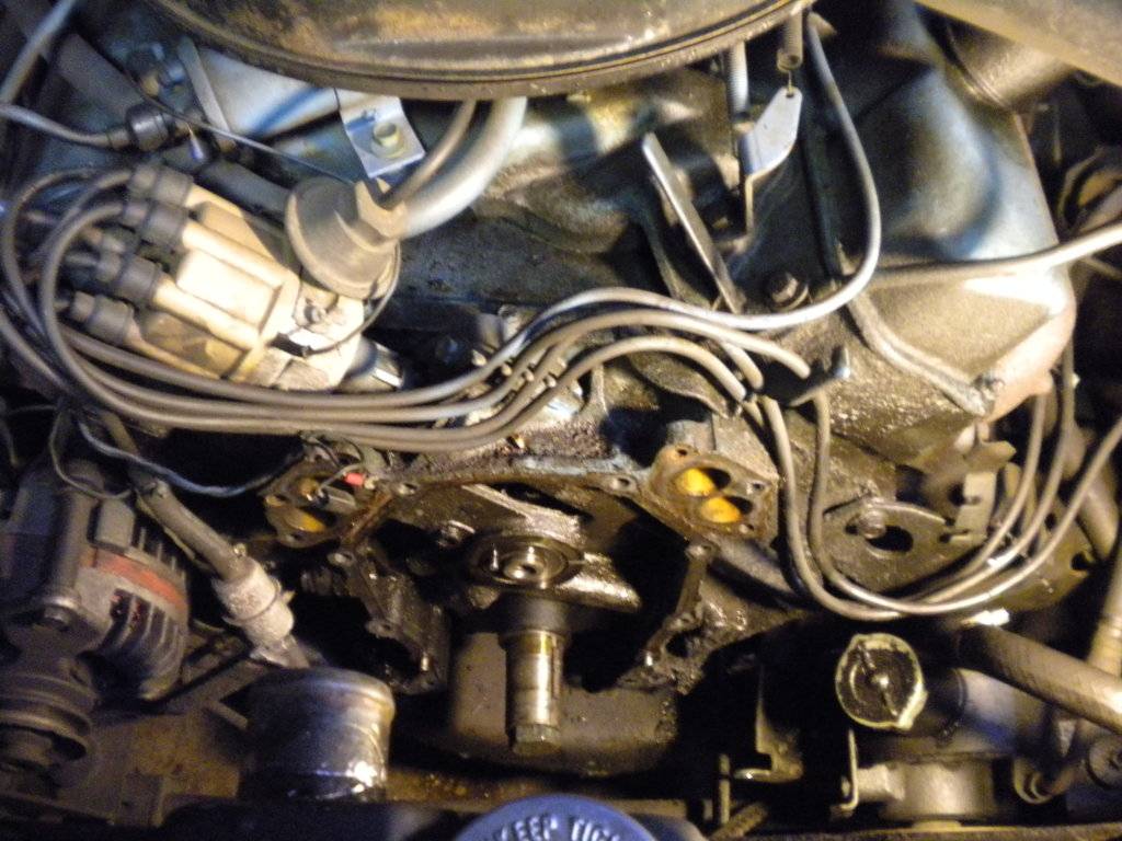

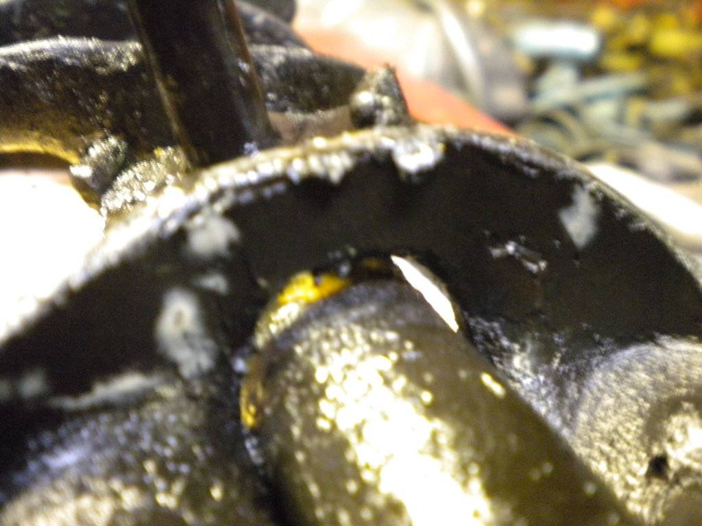

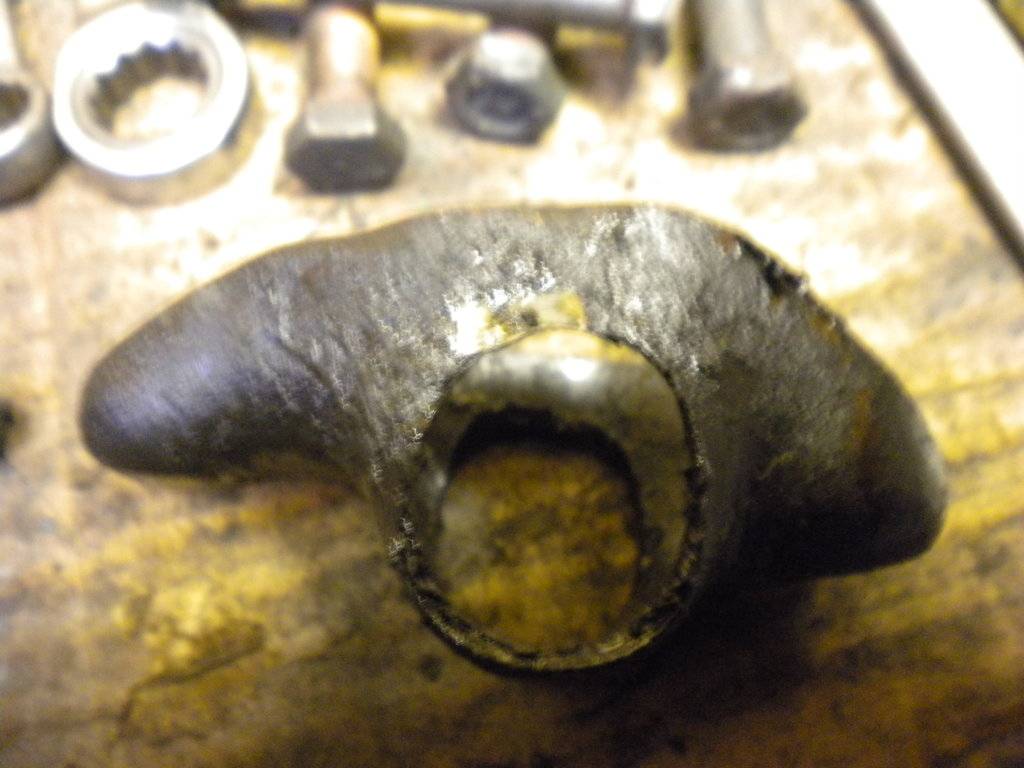

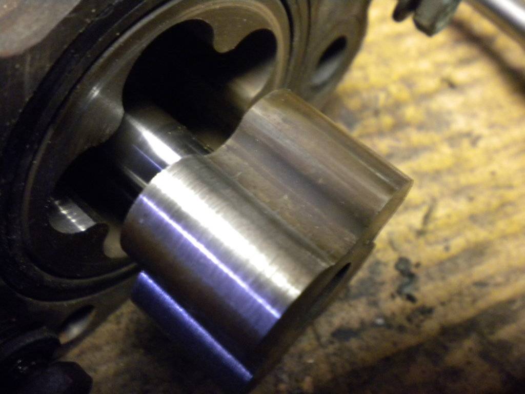

didnn't to me. picture didn't come close to showing how badly scored it is. oil light was flashing when hot at idle. probably should pull a bearing cap, but i'm too damn lazy.That oil pump looks pretty good to me....

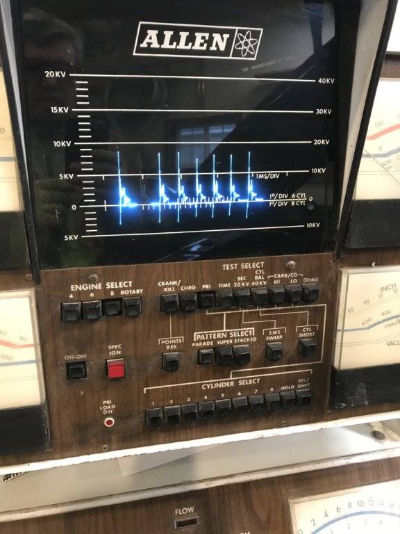

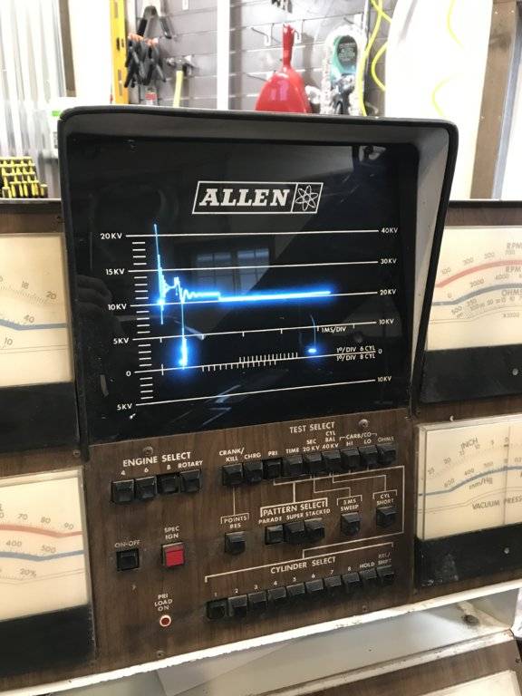

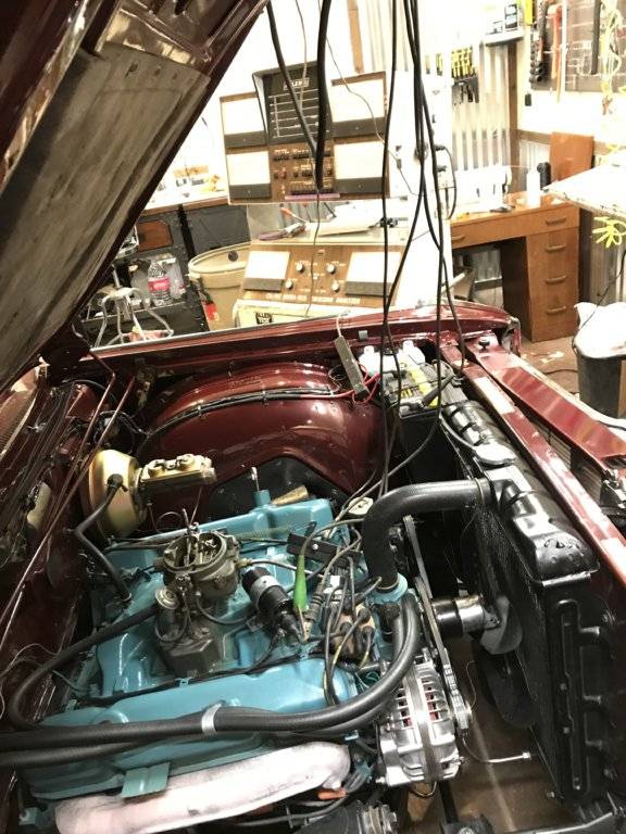

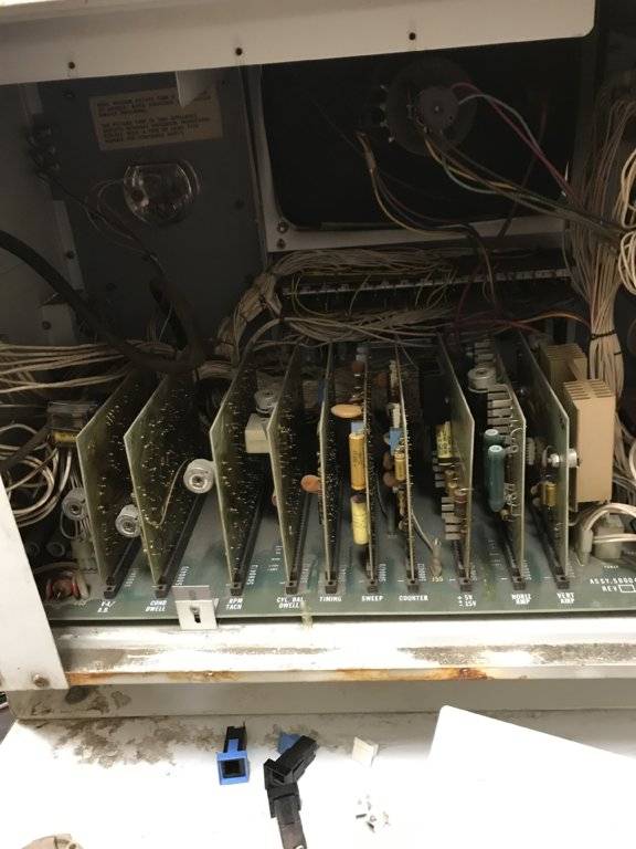

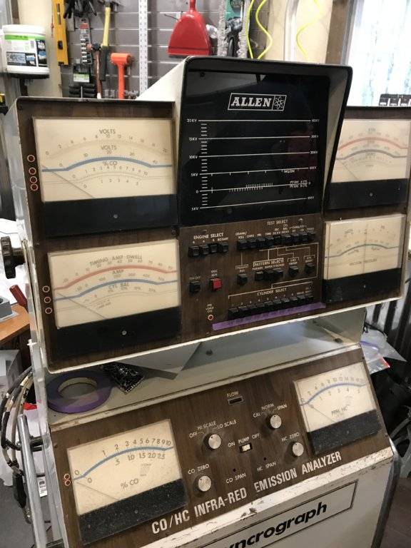

Messed around with some tuning today learning how to use my Allen test stand. Non of the meters work, I need to figure that out. The indicator lights by the meters work, so maybe some windings are bad. I need to figure out how to test them.
Anyway the oscilloscope works, so wanted to learn how to use it to diagnose. I learned how to use one in college 30 some years ago, but too long for me to remember.
Coil , points and condenser are good. Learning to read squiggly lines can be difficult. Next step is to use it to check the cylinder balance. I should be able to kill all the cylinders the left side of the carburetor feeds and compare the rpm drop to the right side carburetor feed. If the rpm drop for each side is pretty close then I won’t have to unseal my mixture limiters to balance.
It is difficult to get a picture of a moving signal.
View attachment 364974 View attachment 364975 View attachment 364976

that is the coolest thing. i can only wish that i had room enough for one of them in my shop. hope you can get the exhaust gas analyser working.Messed around with some tuning today learning how to use my Allen test stand.
I need to figure out how the get the multi meters working. The lights beside them light up properly based on the mode. And I know the Rpm one is getting a signal as the needle will sweep when it switches from low to high rpm. I really need an electrical schematic and guidance on how to properly test the meters. First step is to understand if they really are getting the signal. If they are , they probably need re wound.that is the coolest thing. i can only wish that i had room enough for one of them in my shop. hope you can get the exhaust gas analyser working.
no way those meters are bad unless somebody did something terribly wrong with it internally. more likely dirty contacts in those mechanical switches.I really need an electrical schematic and guidance on how to properly test the meters.
Try here. Sounds like something in common with the gauges went Fuse maybe? Not versed on the Allen machines just the Suns.Very cool! Ya might check with @halifaxhops about what to do with your analyzer. He has / sells a bunch of that stuff.
