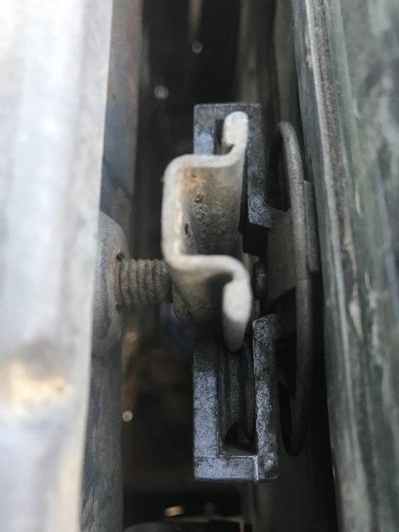

Maybe I just don’t have enough a$$. I will try again.Push down, push back, lift up.

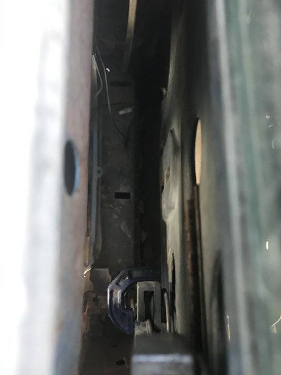

There's one of these on each side. Ignore the trash on the floor.Maybe I just don’t have enough a$$. I will try again.

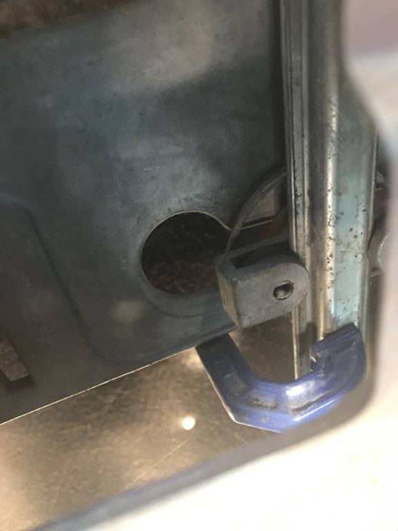

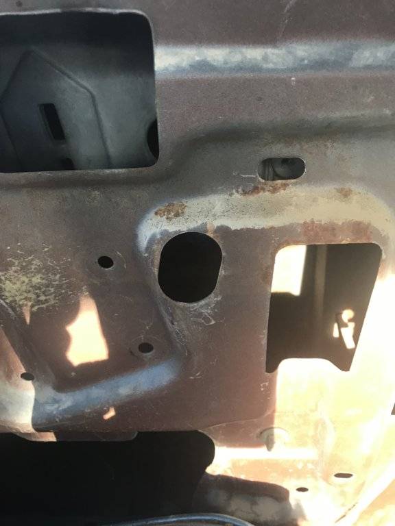

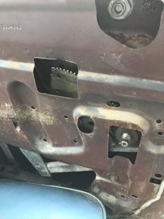

value added. three free c clamps. good ones too, irwins.3 c clamps are holding glass up by previous owner.

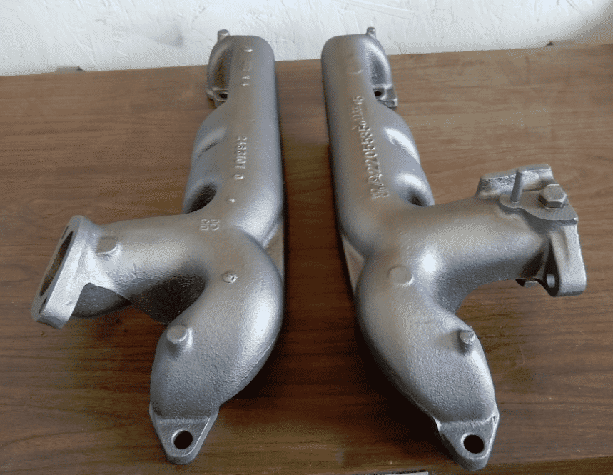

They turned out looking better than what came off.Worked on prettying up exhaust manifolds for when I get my heads back from the shop. Dug out a flywheel to get it surfaced so I'm ready when the new clutch gets here. Just your basic putzing.
I sandblasted them then painted them with VHT Hi Temp Ceramic Paint, then did the heat cycles per instruction so hopefully they'll stay looking good for a couple days or so. Luckily I have an old oven in the shop cause Wife would raised hell from the stink when I was curing them.Are those just cleaned up or treated with something?

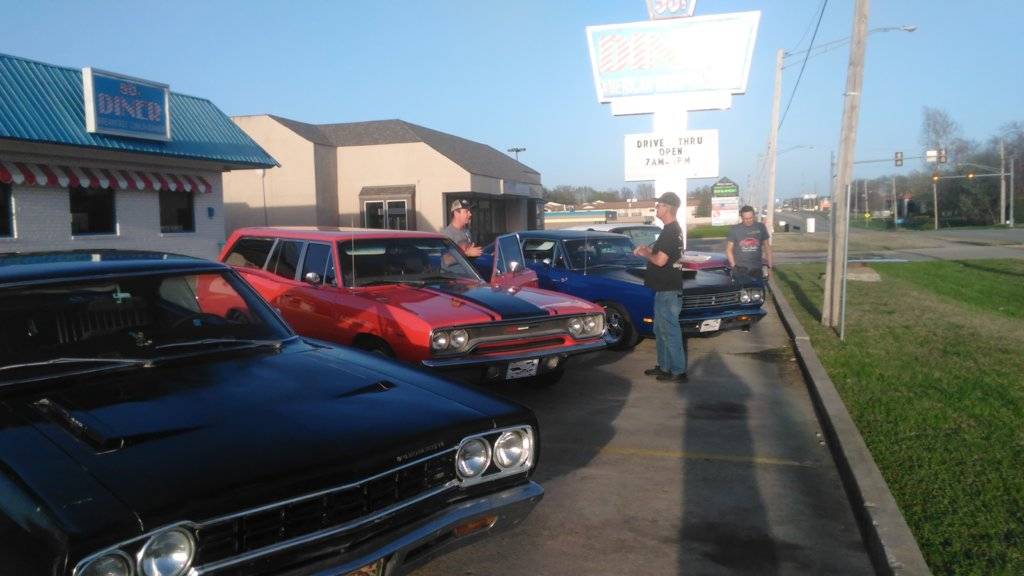

We took the Polara on a short cruise last night. Following current social protocol, we limited group size and kept our personal distance. It feels inhuman not to shake hands with friends and stand 6 feet apart.
None of the people pictured are me.
Since all cruises, car shows, races, and such have been cancelled, it may be a good time to pull the convertible in the garage and do some work.
You're in that picture alright... you're either a phallic symbol or a KKK member, "only the Shadow knows"
On a serious note your Polara convertible is looking great and I'm digging your bud's Satellite wagon!
