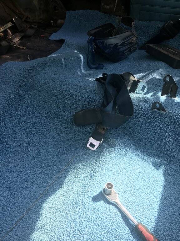

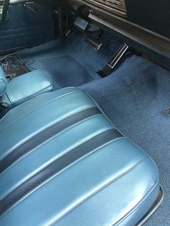

Doing carpet. Completed floor repairs. Seat belt nut on passenger side came out due to rust. Found a weld in plate at seatbeltsplus site with 7/16-20 threads. Worked perfectly.

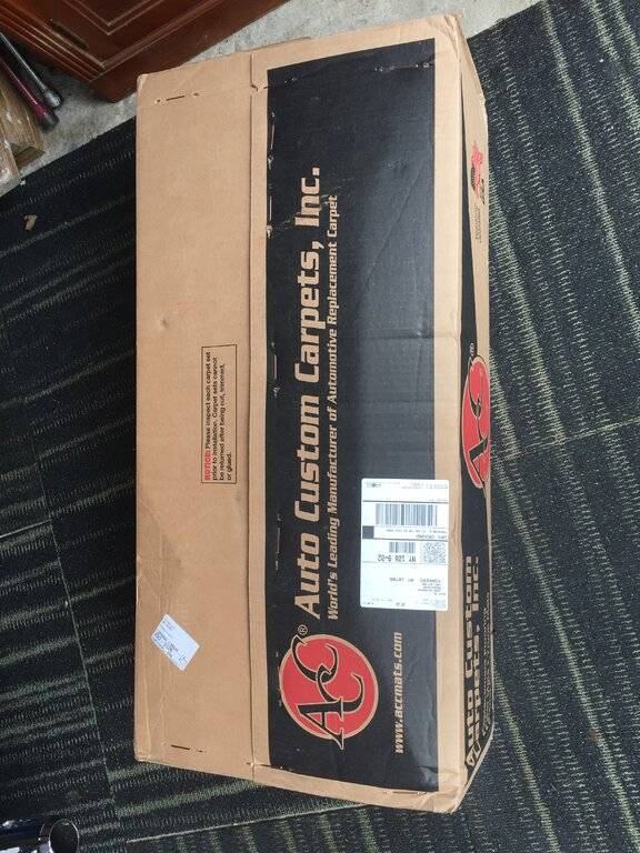

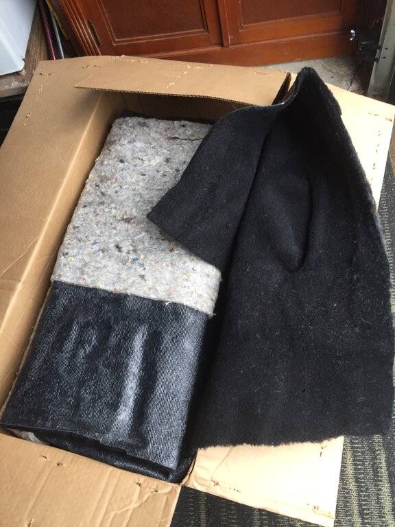

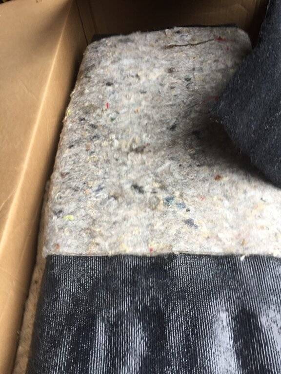

Got my New Molded carpet for the 77 NYB from SMS through ACC yesterday.. excited! If y’all know the thick plush shag style carpets from Chrysler back the day, it’ll be only a memory as the don’t make it anymore.. :( so I got as close as I could to the OE style.. it’ll look nice when I’m ready install.

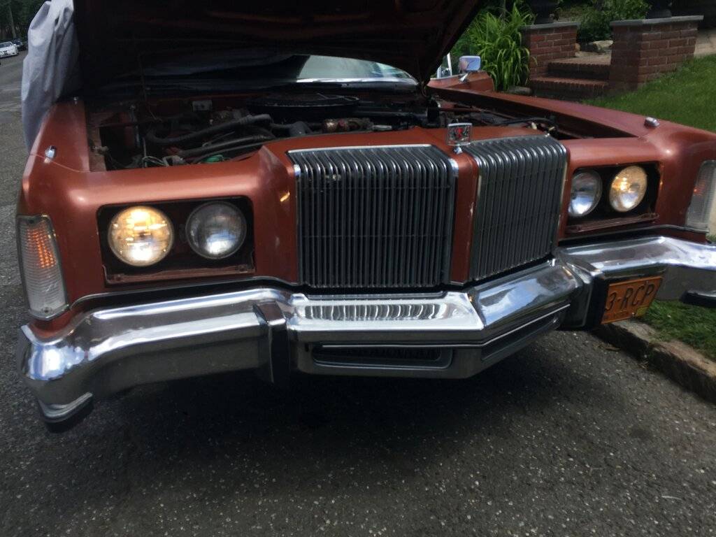

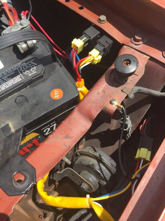

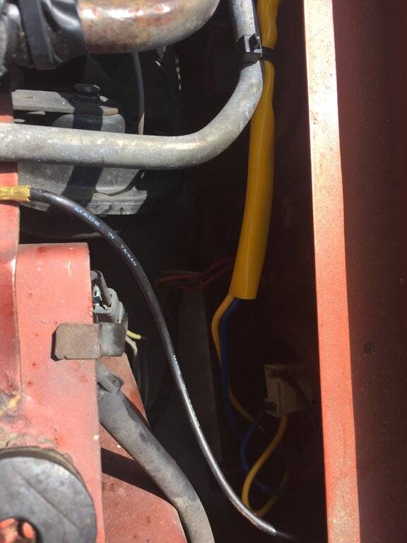

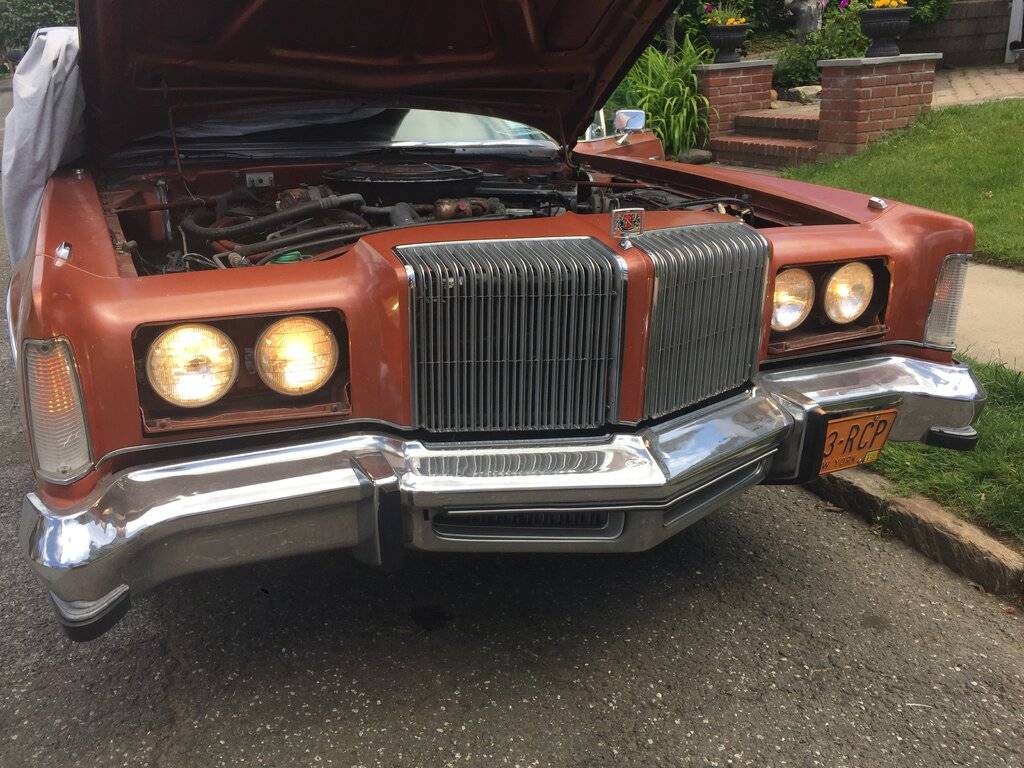

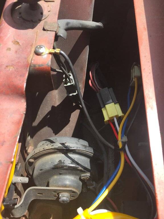

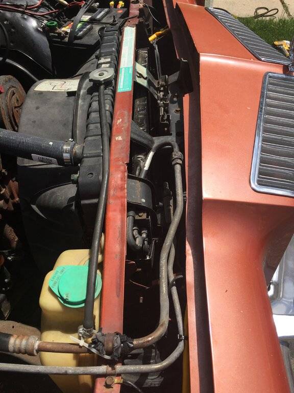

I got inspired by Cbarge installing his upgraded headlight wiring harness on Maggie. I Purchased the same harness he did A couple years back with intentions of installing on my 75 NYB, but since she is now sold it’s going on the 77 NYB. super easy install to say the least. All said and done took me less than an hour. And most of the time we spent just tucking The harness in where I wanted it to live.. But essentially it’s plug-and-play. I am having a bit of an issue though with the headlight doors not closing once they lights are turned off at the switch. I’ve PM’d Cbarge for his advice. But other than that I’m very happy with the results..

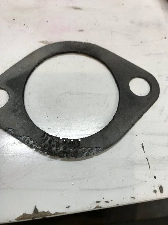

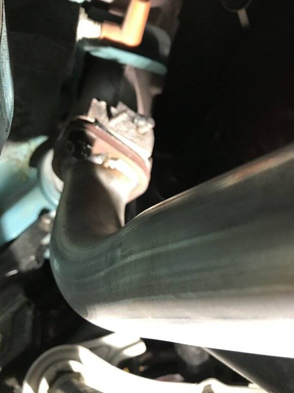

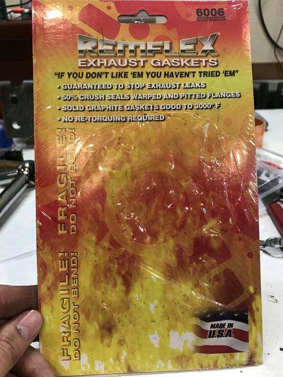

I changed my exhaust Y pipe gaskets again. When I had my starter out last month to rebuild, I replaced my flange gaskets. I ordered some Remflex graphite gaskets, but they were not here yet. So I went to O’reiliey’s and got 2 for a couple of bucks each. One package was taped up and then gasket was shiny silver and the other the basic “cardboard” covered steel. I installed them and The cardboard one started ticking already so I decided to go ahead and put the Remflex ones on.
Less than 200 miles. Yes it was on the heat riser side.
The Remflex looks to be much better quality.

Thanks for posting this. I had same problem on the same side. Muffler guy said the pipes were not squared and suggested stacking two but it’s leaking again.
They are about double thickness of the regular ones, but say they crush to 1/8”. They only recommend torquing to 20 ft Lbs. Good for 3000 degrees.
Will see how they do.
That's exactly what the old guy in town did on my Monaco, and they blew out after letting off the gas when I got to 70 when I hit the 40mph zone.
Funny thing is, the car runs better with the exhaust leak. Still haven't chased my lifter issue, though.
I tried all kinds of those head pipe gaskets decades ago and never found any that would last more then a year. I finally decided to stop wasting my money on those gaskets and just slather the flanges with high temp RTV and tighten them up. Very rarely have I ever had a leak at the head pipes since starting to do this, the wagon just started leaking on one side but that is after 10 years and close to 10K miles.
