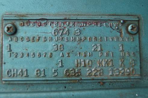

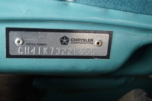

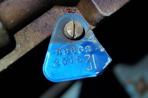

I'd like to know what I actually have in my '67 New Yorker other than a 440. I've attached the fender tag and the VIN number. According to my 1967 service manual I have a "Special Order 8". How can I figure out what the HP and torque ratings are? The carb tag and base number is 4966S which I'm finding is a Carter AVS (Adjustable Vacuum Secondaries) I saw somewhere this is a 750 cfm carb. Is that correct? View attachment 180274 View attachment 180275 View attachment 180276 View attachment 180277 View attachment 180278

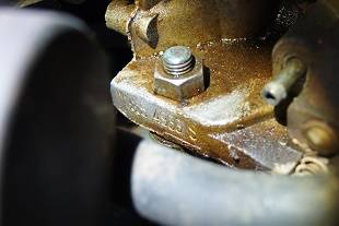

The date code on the carb tag of 2515 indicates 251st day of 1975. What are the characters to the left of 4966 on the carb base?
Does your BS show 51 under CARBURETOR?
I can't read the other markings on the base. I'll have to remove the carb to read those.

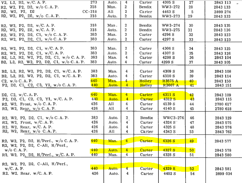

First, This isn't the original carb for your car. The 4966 doesn't seem to be offered on any 67 440 according to the parts book.
The two or three digits to the left of the 4966S stamp are a date code which will be a letter and number. My guess is that it will be J5 for September 1975, this would match the Date Code on the tag.
The tag doesn't seem to match the BS.
Top number is carb number 4966S
Date Code beneath 2515, as stated, 251st day of 1975
31 is last two digits of the Mopar Part number
Long story short, the carb isn't going to tell you anything about your engine, you'll have to check the engine stamping.

The first year for the Carter AVS was '68, not '67. A '67 New Yorker 440/350 would have had a Holley 4160 4bbl on it. Parts book shows Carter when car had CAP. Is that an error?
