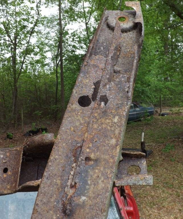

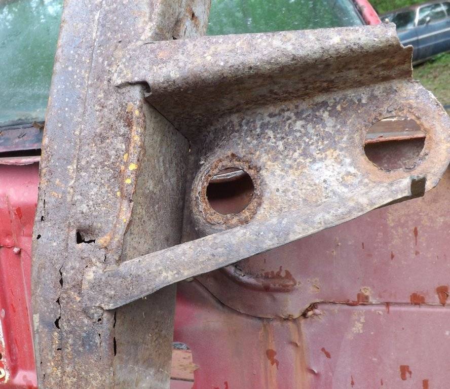

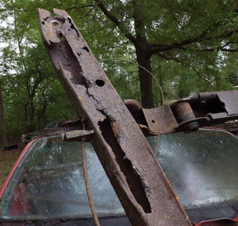

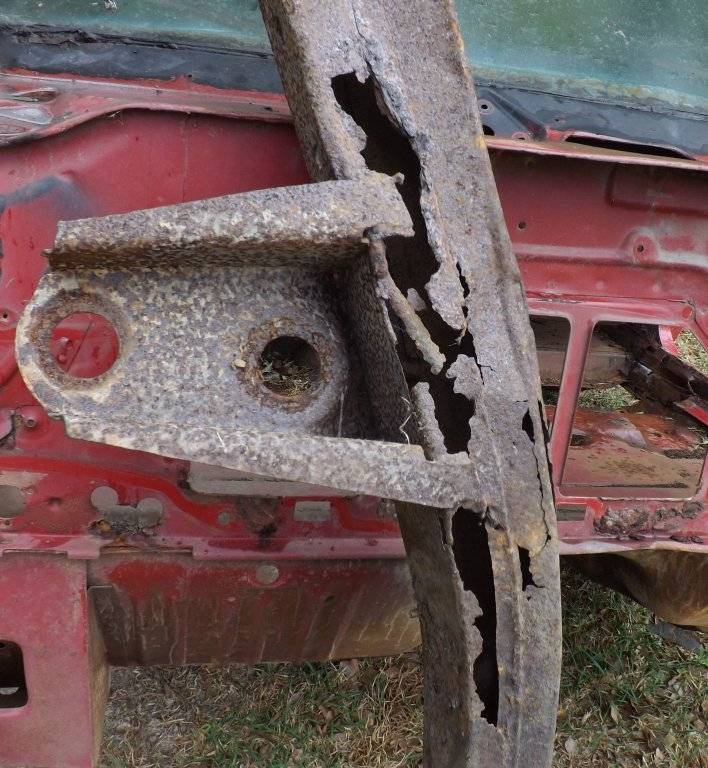

Alright, here are the pics of the subframe from underneath, as you can see the rust is extensive and I have decided it isn't worth the trouble. I found that the two extensions on the end basically aren't doing their job anymore and this may have lead to something I found on the front guards. Each front guard just back of the top of the wheel arch has a slight kink in the side. The only thing that I can think of that may have caused this is the chassis flexing while the car was being transported? It's not the transporters fault mind you, I wouldn't have thought of it myself, but as a cautionary tale if anyone is transporting a car with this sort of frame in it that is rusty it would be a good idea to support the body underneath with a couple of wide tires to minimize flex up and down.

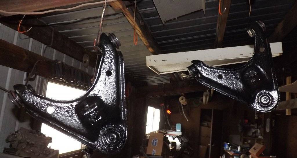

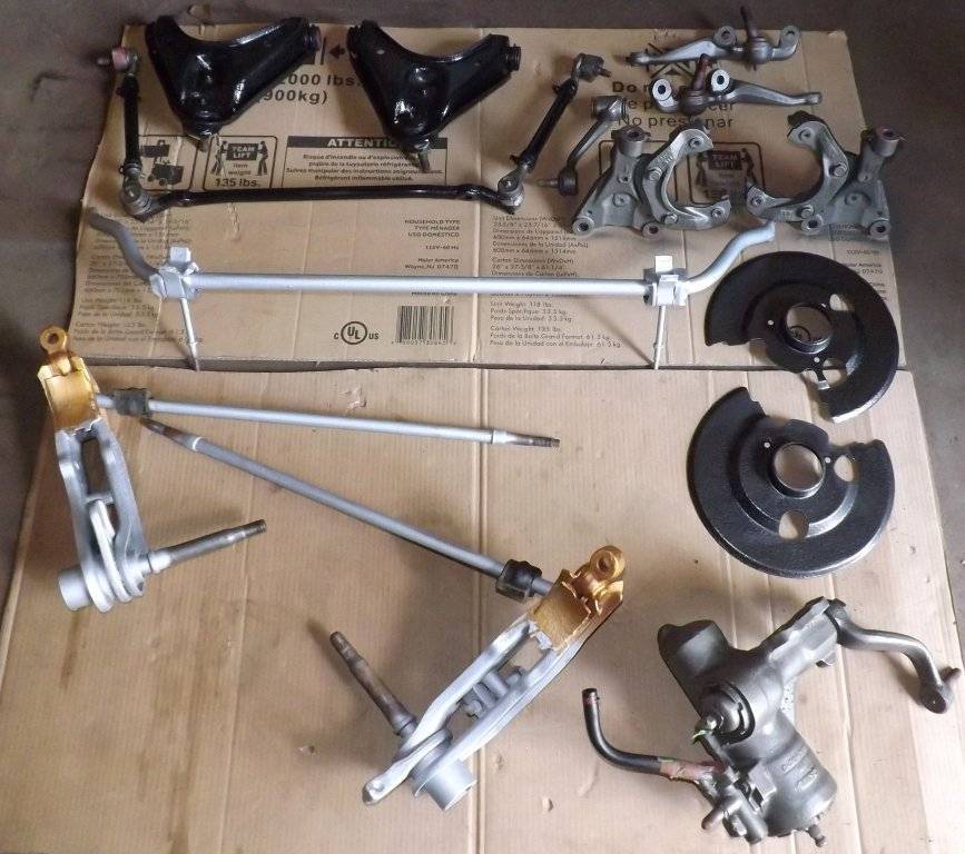

Got some more work done today, stripped cleaned, primed and painted some front end parts, plus I made up a new gas line for the body.
You have some mad bending skills, looks great. I never can get it that close.

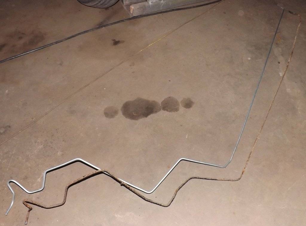

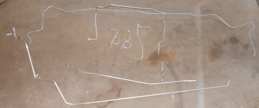

Here is a bit of an update, while waiting to go pick up the other car I have been tinkering on parts in preparation. I made up all the new brake lines and also gas lines too. Front suspension is almost done.
