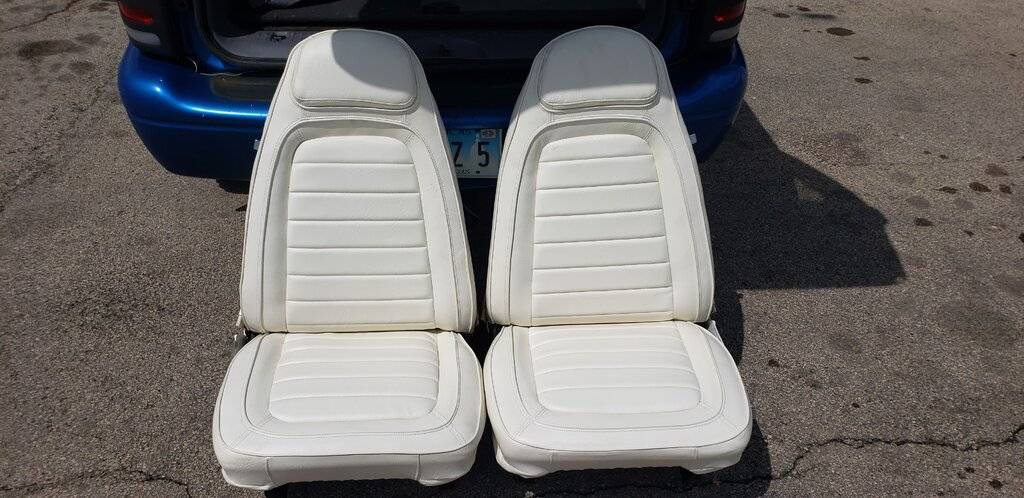

Tim found these white buckets locally and figured they would match the vinyl top better then the gold seats. Had me go pick them up today!:poke::rofl:
Nice zero mile car seats.

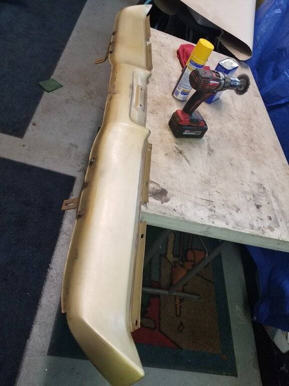

The hood is done and the bumper went back on last night.

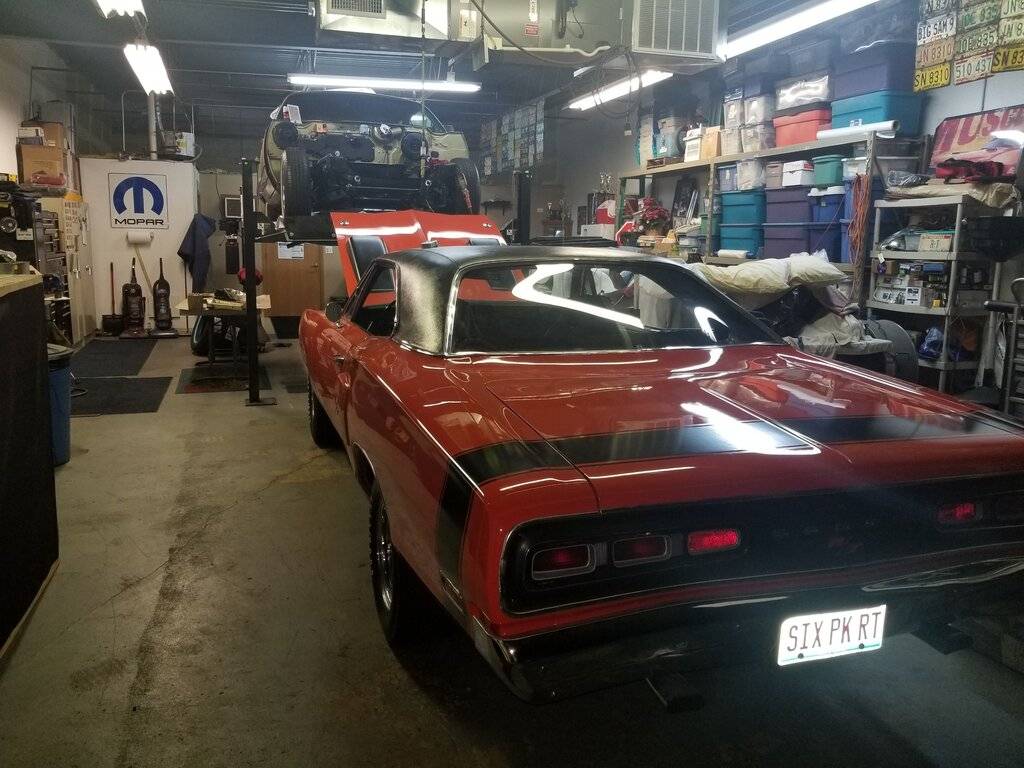

Moved some stuff around to make room in the shop to get the R/T out for a spin for the first time after 7 months of hibernation.

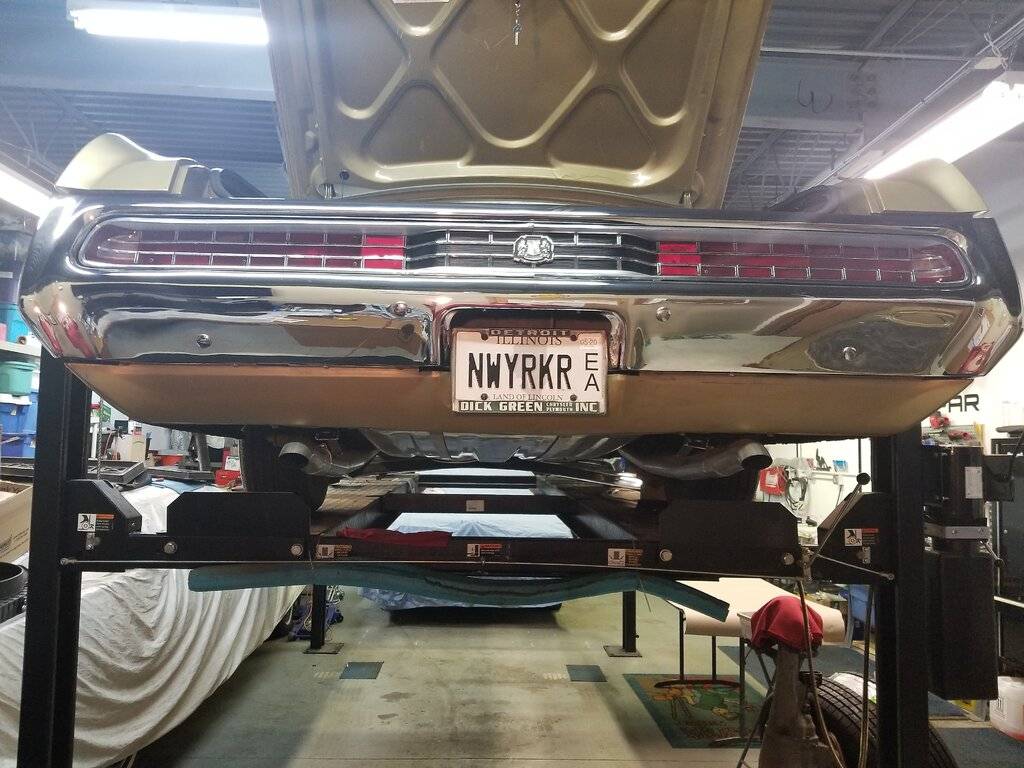

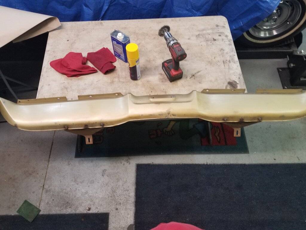

The rear valance had a few dings in it and some black carbon marking from the exhaust, that just needed a good scrubbing to remove the marks.
I pounded out the ding and straightened the rear valance with the use of a couple block of wood, sandwiching the dented areas until the hammering straightened it out enough for my liking.

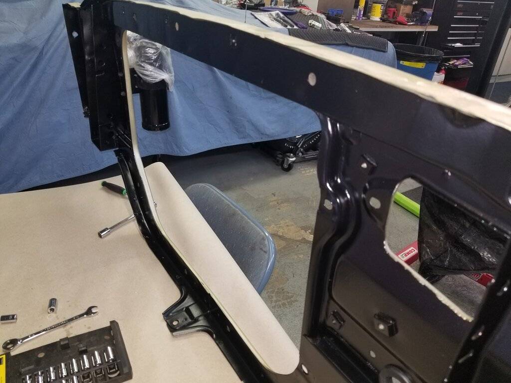

The core support came out nice with the new condenser and dryer from AC Global, and after taking @davidhill recommendation of painting the front of the core support black, the look is way better and more original than if I had left everything painted Crystal Dawn metallic.

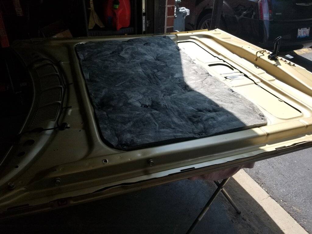

The hood cleaned up nice too once treated with zinc chromate, primer and the finish paint. The dust shield had years of road grime, but after applying a little elbow grease, it now looks new next to the updated under hood insulation.

Great work and great pics! Where did you buy the under-hood insulation?

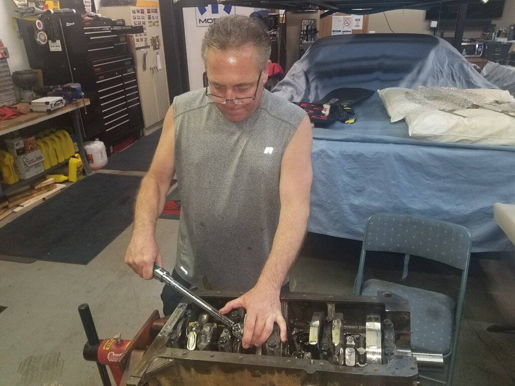

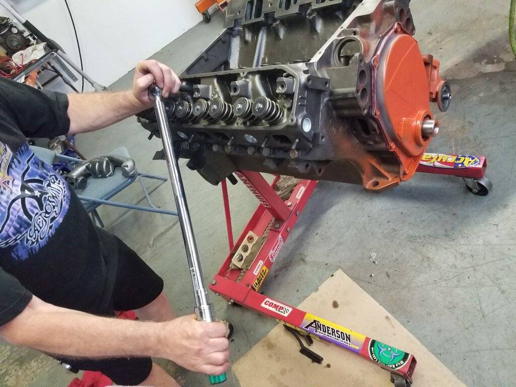

As mentioned a couple posts back, @Xenon has made the engine build experience for me, my favorite part of this build, and has made memories that'll last a lifetime.

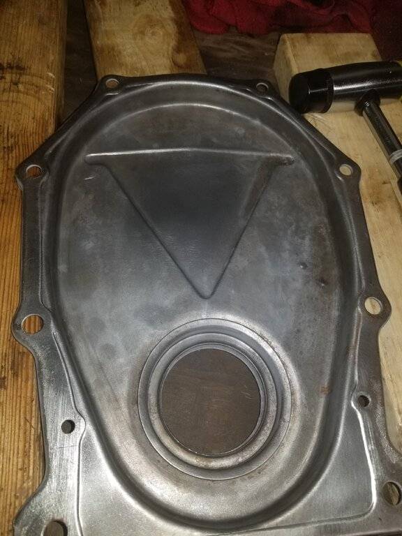

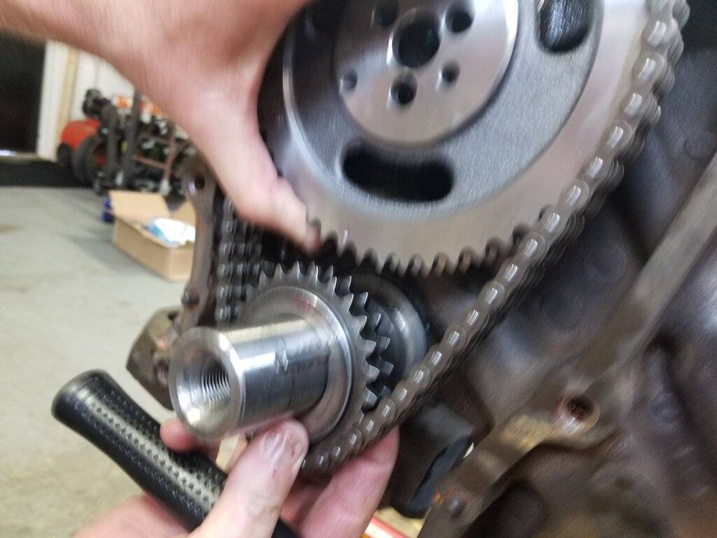

Torqueing the connecting rods to FSM specs and installation of the cam went as planned, however the 3 ARP bolts for the cam from 440 Source required some needed finessing to the timing chain cover so they would no long rub. Once seeing where the marks were being made, after a few taps with a hammer, and refitted for clearance, the problem was solved.
I usually don't like being in these pics, but yeah that's me, gold chain & all..:poke:

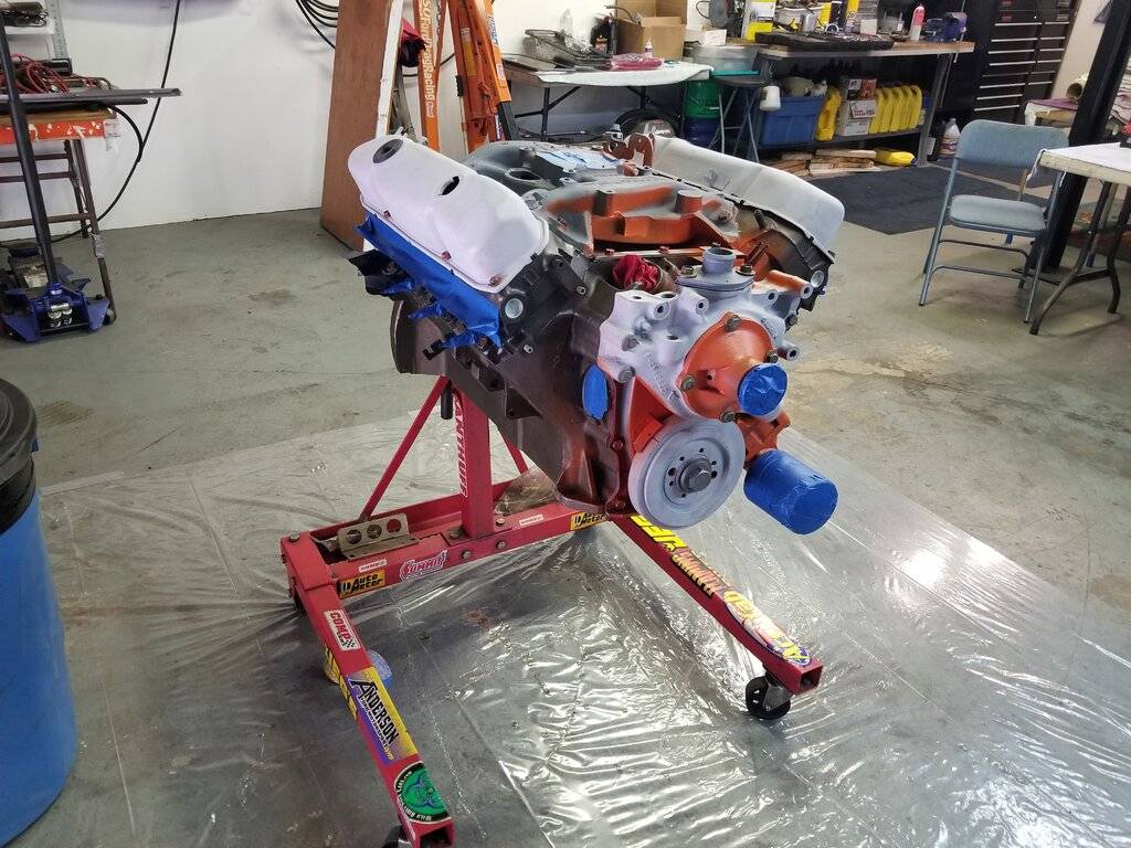

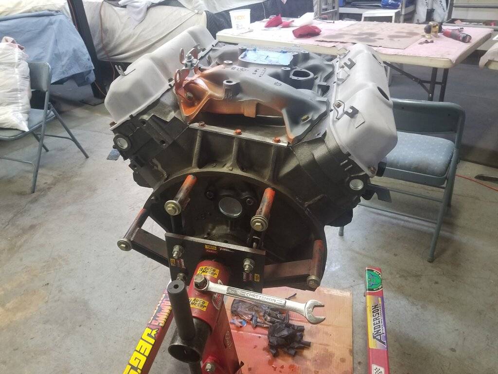

Next, getting the heads and rocker control shaft's on.

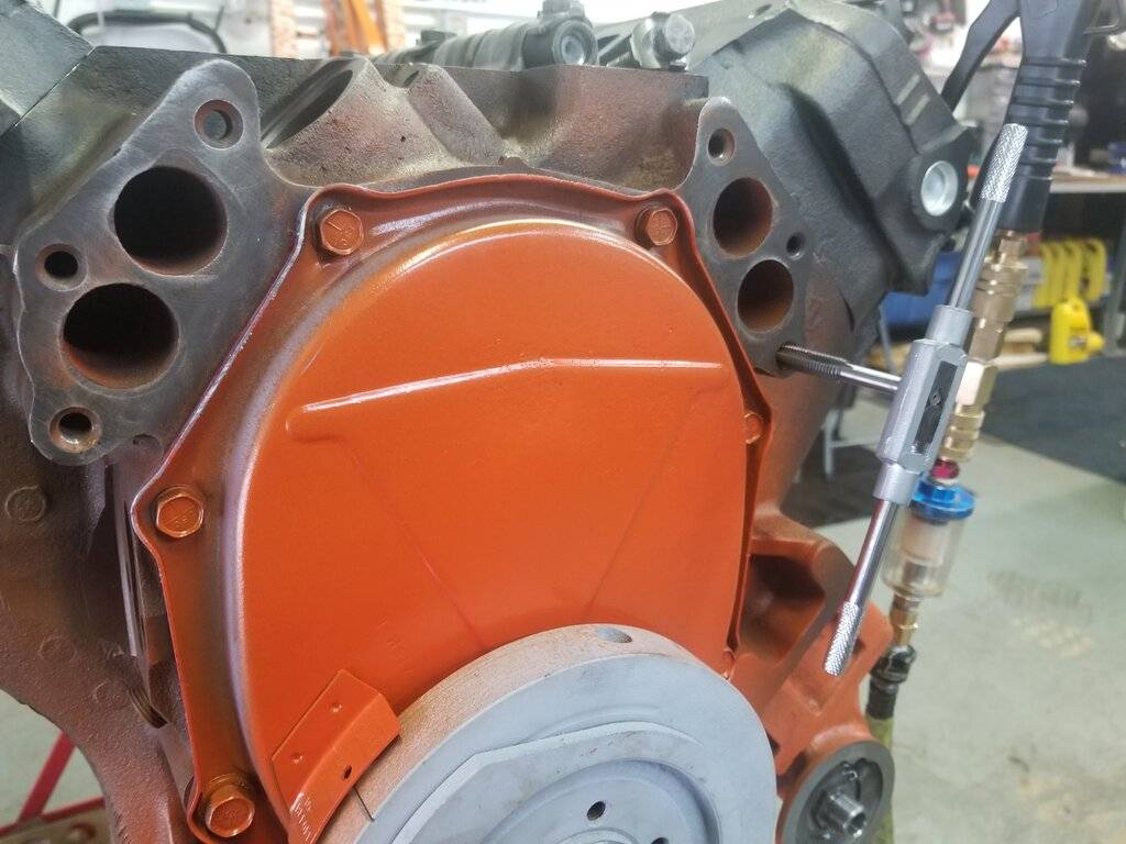

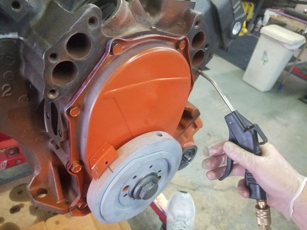

I had these heads machined a very reputable machine shop, and have used them before. When trying to tighten down the rockers, the bolts would not seat enough to secure the shaft. After we looked into it, we found the machine shop must not have blew out the bolt holes after they were hot tanked. Rather than breaking off a bolt in one of the heads, all holes on the heads and on the engine were chased and blown out to remove any debris.

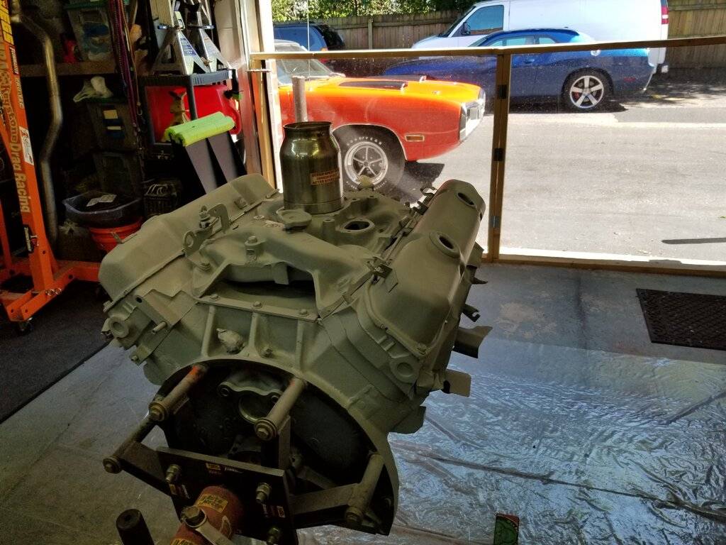

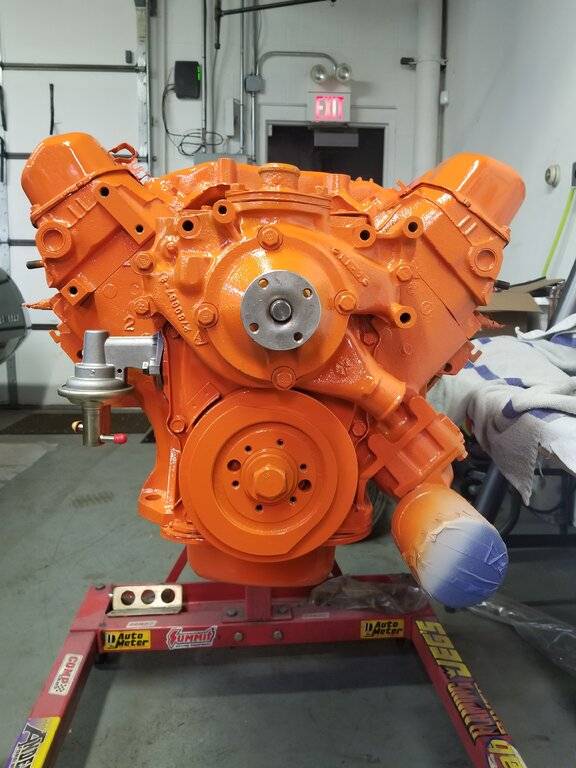

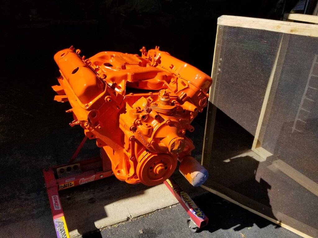

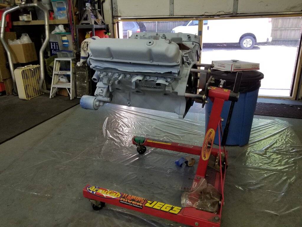

Once the heads, valley pan, intake manifold, water pump housing were on, it was time to prep for the hemi orange paint.
After thoroughly cleaning the block and all surfaces with lacquer thinner, I taped off the sections for where the HP exhaust manifolds would go, and put some old spark plugs in where they would go, to keep the paint out. I even taped the plugs since I plan on using them of the break in.
Taped off, on went the primer.....
Someone with a sharp eye will notice I bolted up the water pump in the wrong position,:BangHead: as Xenon pointed out. After the hemi orange was sprayed (using a paint sprayer this time....no rattle can), I clocked the water pump to the correct position.

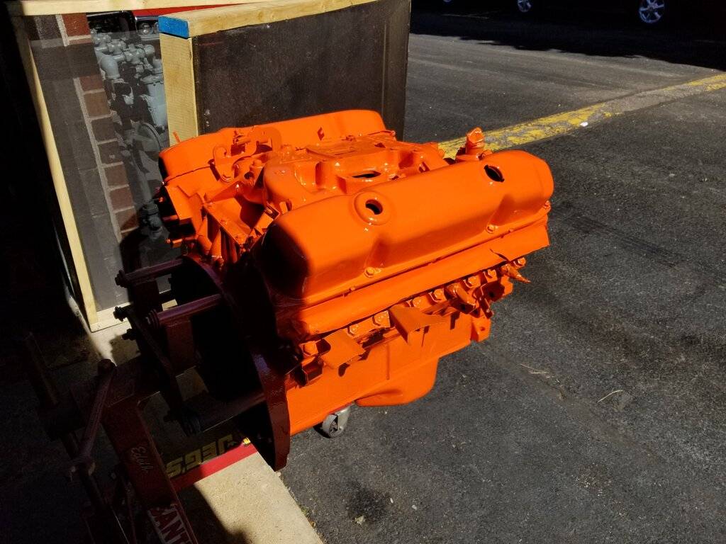

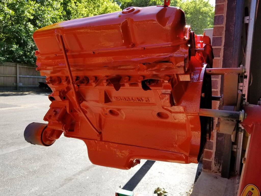

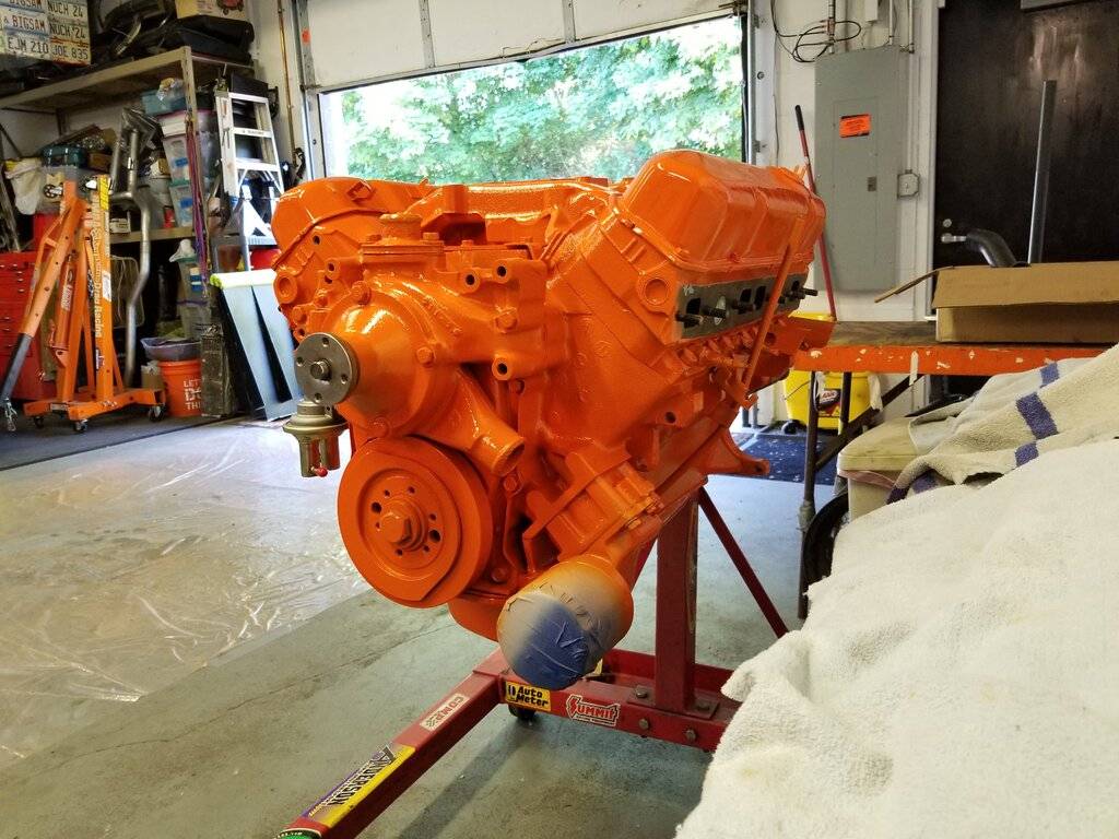

Yeah baby....there's nothing like a hemi orange engine...
Painted with Eastwood's high temp ceramic engine paint and a 4 to 1 mixture with their activator.
The last pic above shows the water pump in the right position.

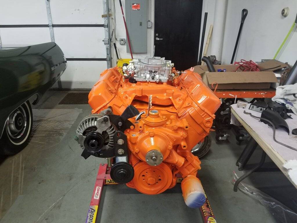

Started adding some brackets and fuel pump after the motor mounts were placed once painted.
Just to have a first look with the freshly built Carter AVS from @Dana. She's not bolted up, but will be soon.
Good work and I saw the weep hole 90 degrees off.
