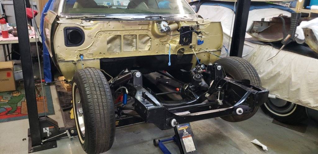

Wyatt convinced me to destroy my 71...

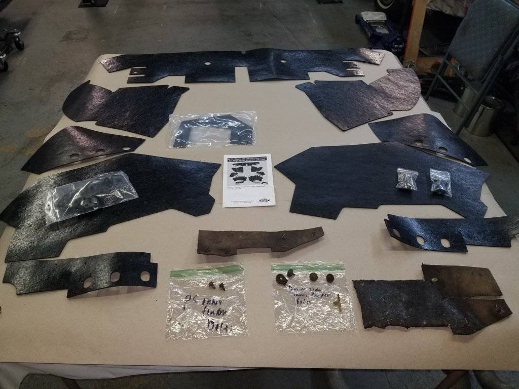

After looking over the splash shield kit from Detroit Muscle Technologies, the shields are a good match to the originals, but what was noticed there are 2 shields that aren't in their 69-71 Chrysler kit. The picture below includes the 2 old splash shields. If I recall, they go just behind the bumper mounted to the stub frame, protecting the strut rods. (one of the old pieces is missing 1/2 of the shield & the piece in the lower right corner is what it should look like)
Was wondering where to buy this material, and if anyone else here who replaced their splash shield, ran into the same issue?
I'd get hold of Jim and let him know of the discrepancy and see what you can work out with him. I've always found him extremely accommodating.

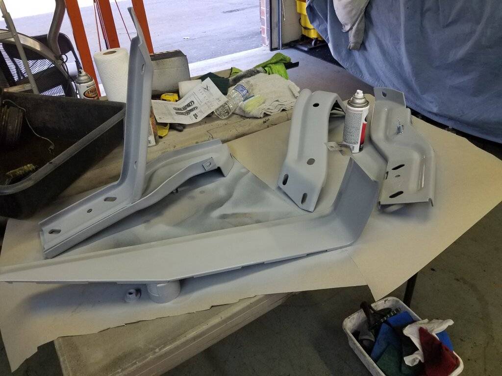

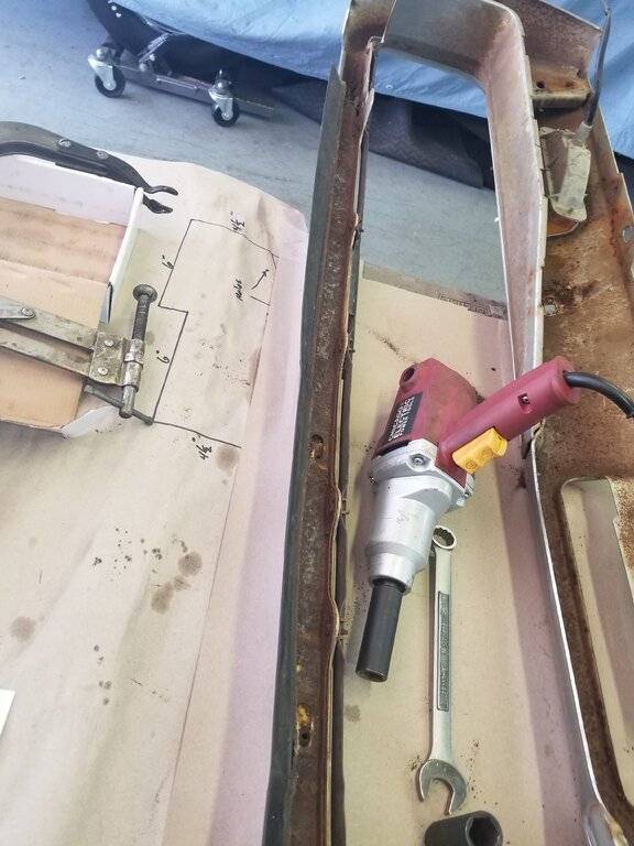

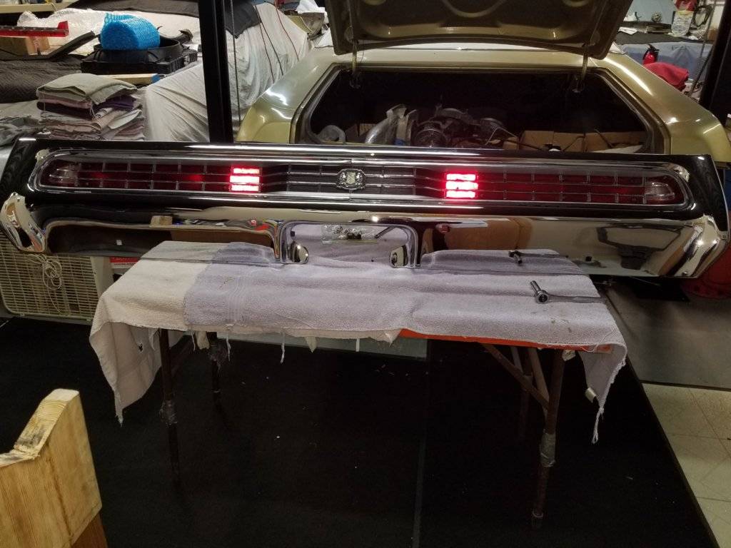

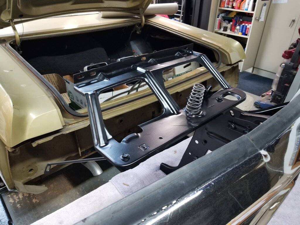

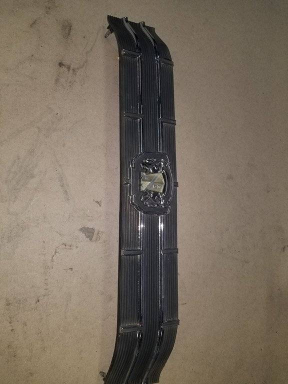

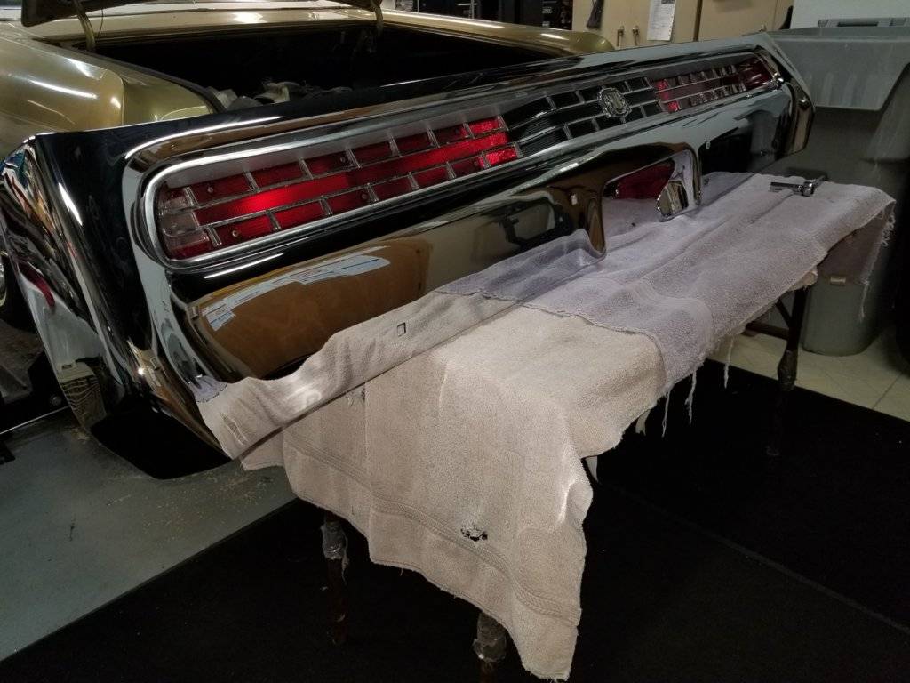

Took half the day prepping the rear bumper surrounds, clean up the surface rust, then later priming and spraying it back to looking presentable again.
The last pic is how it looked when I got the car.
One more thing is off my list now.
I sure hope you are not going to put those ridiculous bumper guards back on, are you?? The factory bump strip was just a long rubber strip just below the tail lights.
The bumper guard will not be going on.
PM me If anyone wants them they're free.
I'll ship them to you, but you pay the postage.

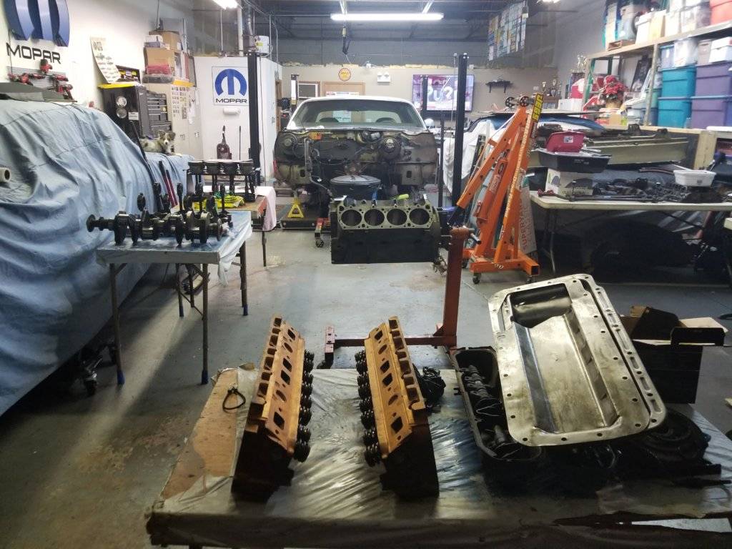

When with Wyatt last Friday we got to talking about the pact we made on getting our cars ready for Carlisle, and getting them road worthy for the trip.
Knowing the shop Wyatt has is not currently heated and with the cold temps we have around here, I suggested we go get his 440, and bring it over to my shop and we'll get them both done at the same time.
Once we got it here and disassembled and sorted out, we will both be staying on track, keeping our builds going.
Where we are today, with Wyatt's 440.....Even my little shop dog was looking on as we went to work Friday night.
Our good friend Xenon will be guiding us two rookies, giving direction during the builds on our 440's, including making some modifications we will be doing, to increase performance and reliability. Having friendships like this are invaluable.

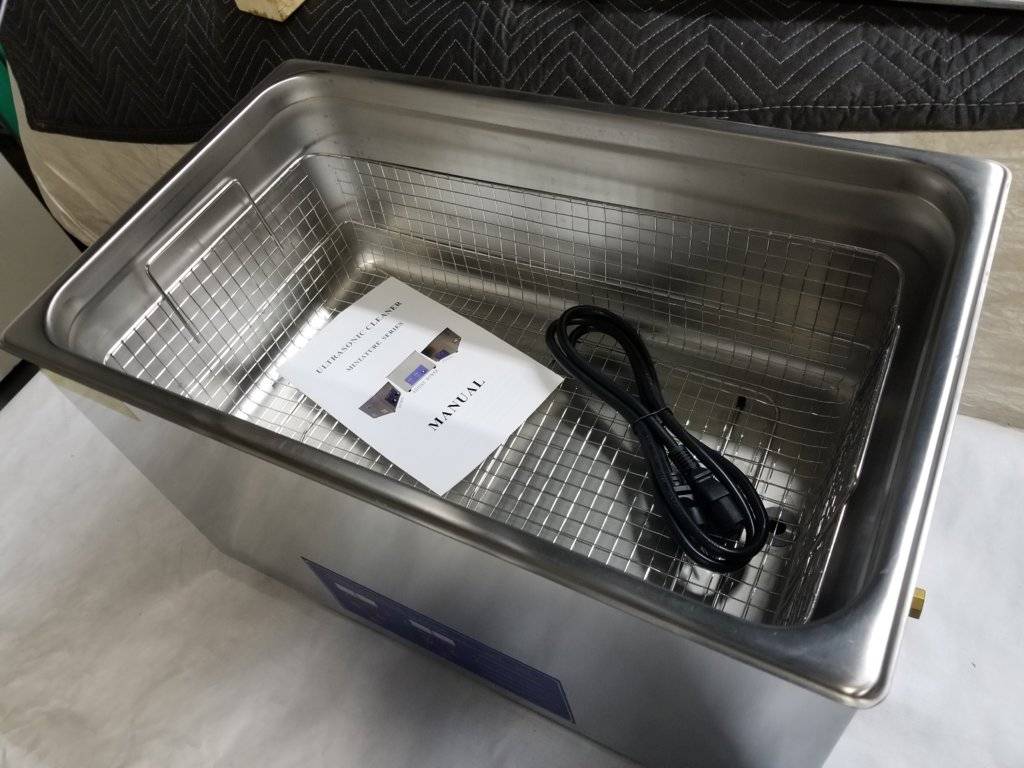

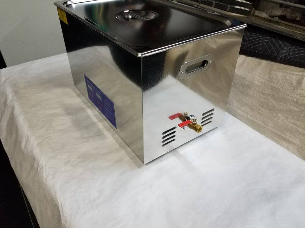

Last time Xenon and I discussed the rebuild and cleaning of parts, he suggested having some of the parts cleaned through an ultrasonic cleaning process.
We got online and looked up a reasonably low cost ultrasonic cleaner, and found them to be lower in cost than I had previously thought they would be.
I went with the 30 litre cleaner. Wyatt and I will be giving this new toy a work out over the next several weeks, cleaning our parts.
View attachment 345226 View attachment 345227
Seems pretty straight forward. Depending on how the parts turn out once cleaned, I'll go out on a ledge here to say, I'm optimistic this was a good investment.
I am interested in additional information regarding the ultrasonic cleaner you procured. I believe that I found it, but wanted to confirm the size...
Did you get the 10 liter or 30 liter or ?
New Stainless Steel 10L Industry Heated Ultrasonic Cleaner Heater w/Timer | eBay

The ultrasonic cleaner that was purchased was a 30L unit. The 10L was just too small. The link in your post is the same maker of the one I have and it was on eBay too.
I continue to use it as recently as yesterday and it really does a nice job.

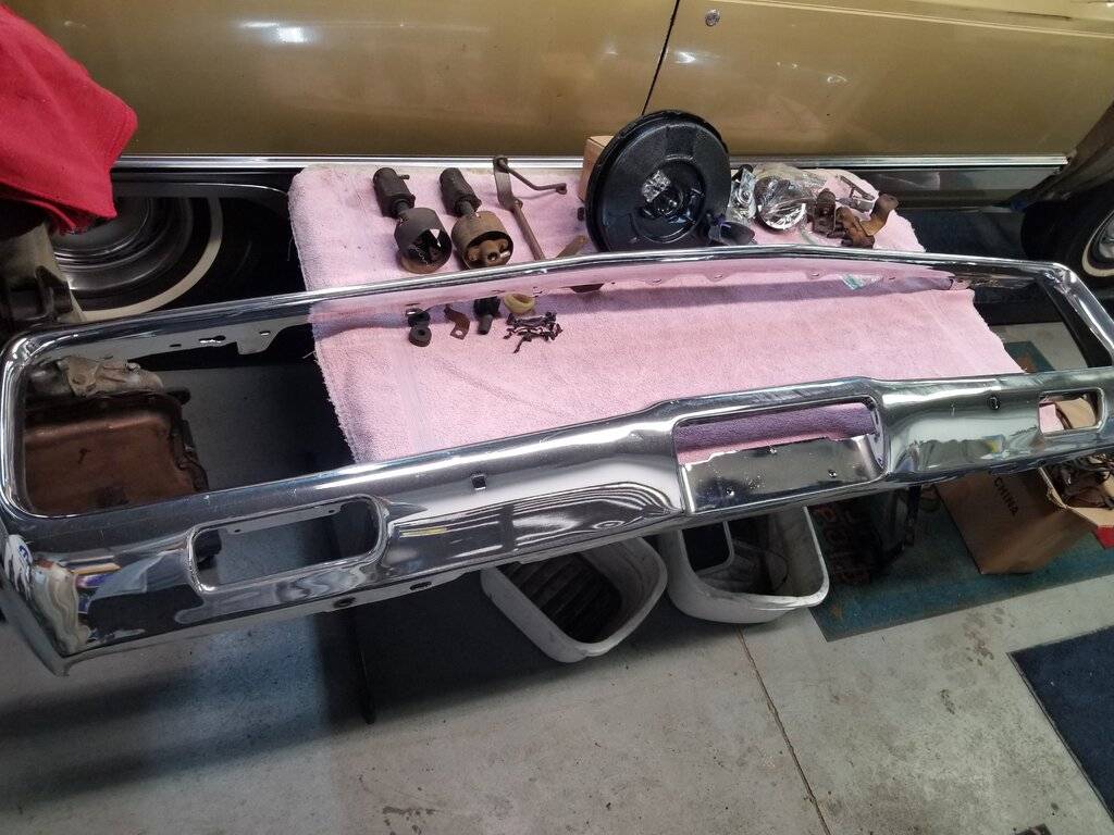

Trying to keep on track with the progress on the New Yorker as the car show season approaches, especially with the 4th Annual C Body Show and Chryslers at Carlisle shows both nearing the drop dead time frame to get everything finished.

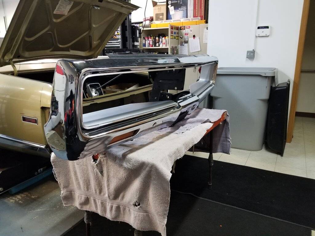

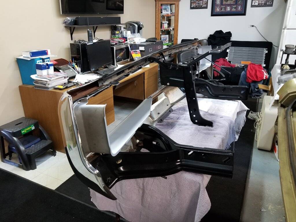

I finished up the front bumper over the weekend, after sourcing another one from a junkyard. Once back here, I took it apart and reused some of the bumper surround chrome trim pieces from it which was in better condition than my original pieces. Later on after cleaning up the surround inserts and painting them, the front bumper brackets were treated to a good cleaning too before putting everything back together.

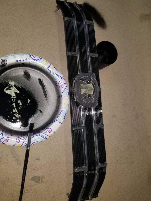

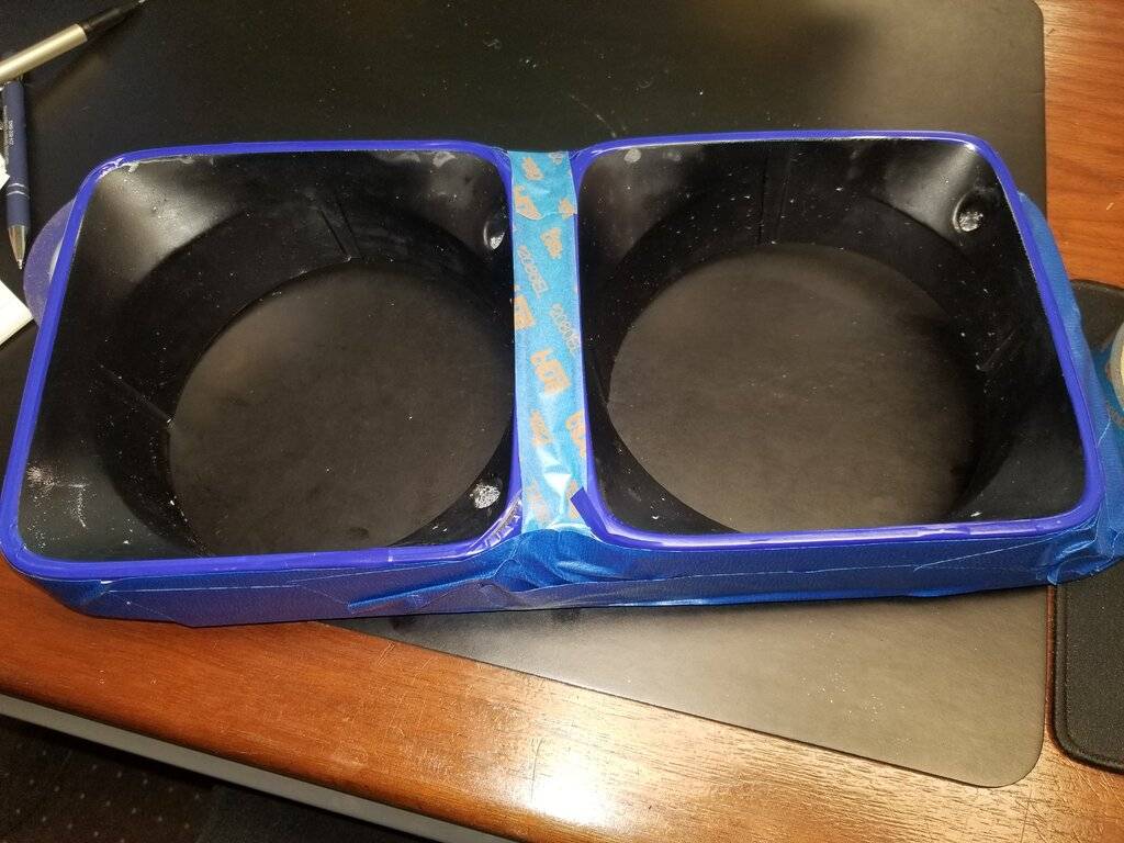

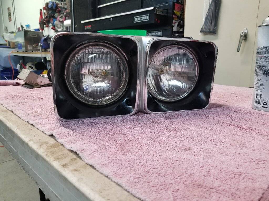

After looking at the headlight bezels, I knew these couldn't go on without being cleaned up and painted too. I put the new headlights in only to get a better look of how they'll look.
