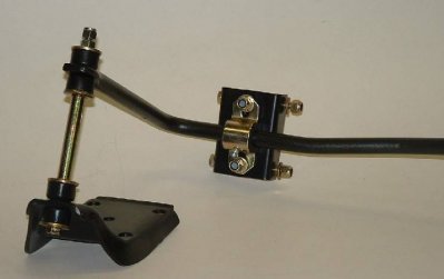

As a matter of fact, Yes I did contact Firm Feel via email sending it directly to the tech support person I had spoken to about the Tubular Control Arms. In the email I even suggested using bolts instead of the 5/16" screws they provided. Needless to say I never got a response. I happened to go back to Firm Feels site and SAW that in their advertising photo that the sway bar IS pictured WITH "Bolts" AND NOT "Screws". I came to the conclusion they're supplying the 4 screws rather than 4-bolts, 8-washers and 4-nylon locking nuts due to cost.
Here's the photo from their web-site - The photo shows bolts, however they provide screws & their instructions indicate to use them as well.

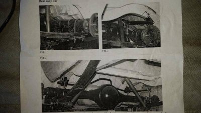

Here's the instructions they provide -
If you look carefully at the first photo of the instructions you will see that it shows the shock un-mounted. The 1st photo shows the shock un-mounted. BEWARE: DON'T DO THIS!!

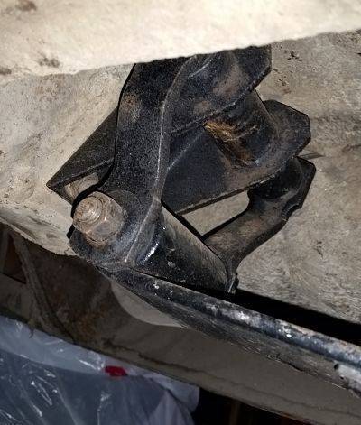

If you do the leafs rear shackle will shift forward and lodge itself against the under carriage of the body like this next photo -

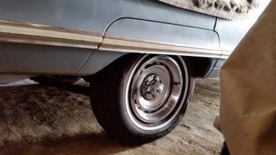

As a result the body will end up sitting 5" higher than it was such as this...
Compared to the normal height like this...

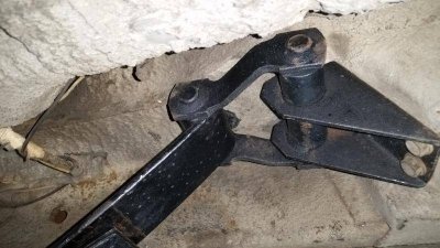

I didn't notice this next photo until I let the car down and saw the body sitting higher than before.

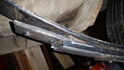

Due to the shackle shifting forward the leaf will end up bowing like this when the weight of the body is on the suspension.
With the shackle moved back to its proper position as shown, everything returned to normal :yaayy:

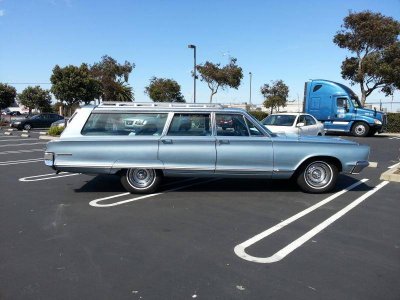

I never did give that update. A month ago My wife and I went up to the finger lakes region of New York ( thanks for the advice Big John) it was about 900 miles including all the sight seeing . The car handled very well, I could get into the curves harder and come out flat on the other side. The Bilstein shocks did hurt the ride as she has no cushion BUT they help keep her level and reduce the float to almost nothing.
I recommend the sway bar to anyone doing a non stock / Non factory correct car.
Only to offer the proof of our drive .........
Only to offer the proof of our drive .........View attachment 131419
View attachment 131417 View attachment 131418
