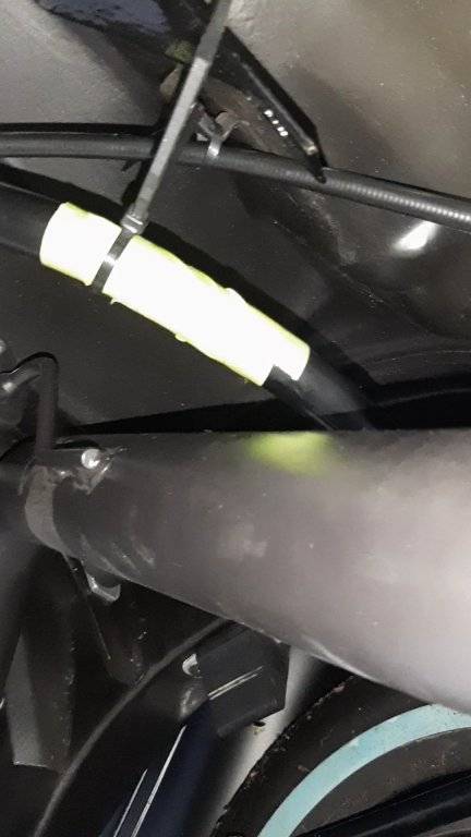

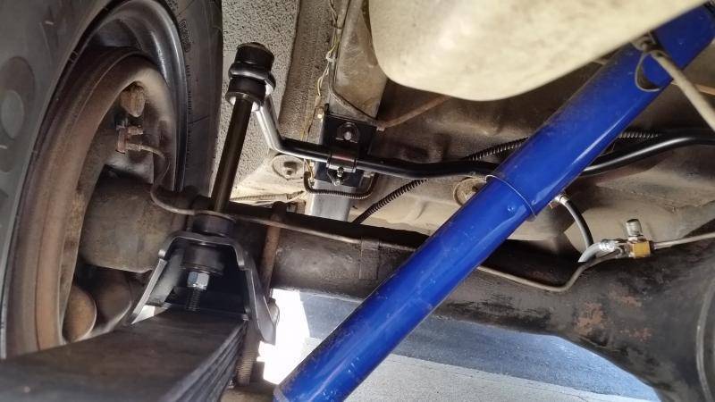

UPDATE. Very happy, just installed my sway bar AND tailpipes. They appear to fit just fine. Photos to come later today to show fitment and clearances.Just ordered my FF rear sway bar today. It'll take a while to get here, but I'll update with photos of how the TTI tailpipes and rear bar fit on my '71 Fury. Either way, I'm going to make it work

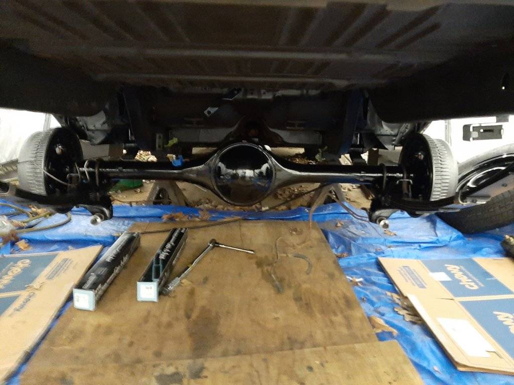

Just finished rebuilding the rear suspension of my police pursuit special...

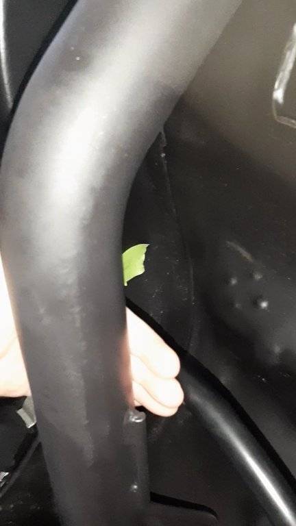

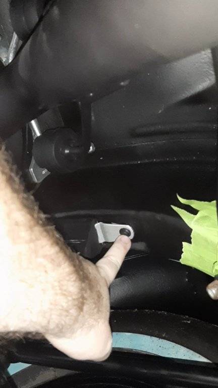

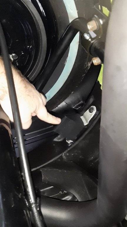

Checked, there is plenty of clearance even if car bottoms out on rear bumpstops.Here are some photos of the tailpipes bolted in snug and rear sway bar mocked up. 1971 Plymouth Fury III 4 door sedan.
The bar ends ALMOST parallel with the leafs and end links perpendicular to their corresponding leaf brackets. Instructions say run the frame rail brackets as far up as possible so they are tight, approximately 5" from the forward bumpstop bolt, which is where these are. There's enough room to fit my chubby mitts between the tailpipe and sway bar, on BOTH sides.
Only thing i have to check now is if there's any interference between the bar and pipes when the rear axle hits the bumpstops. I don't think I'll have an issue, but will check to make sure.
Also, with the gas tank out, i was able to fish the tails into place fairly easily. NOTE this is all with the car's full weight on it's tires.
Hope this helps others out there
