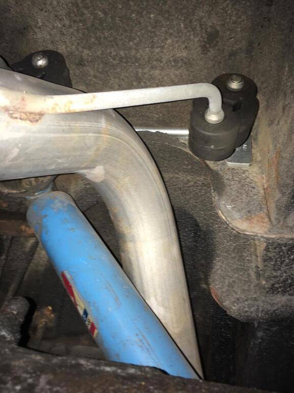

Just looked at mine and they are mounting brackets to the shock cross member. I remembered it wrong. Pics will follow later.
Pictures as promised.
Mounting brackets

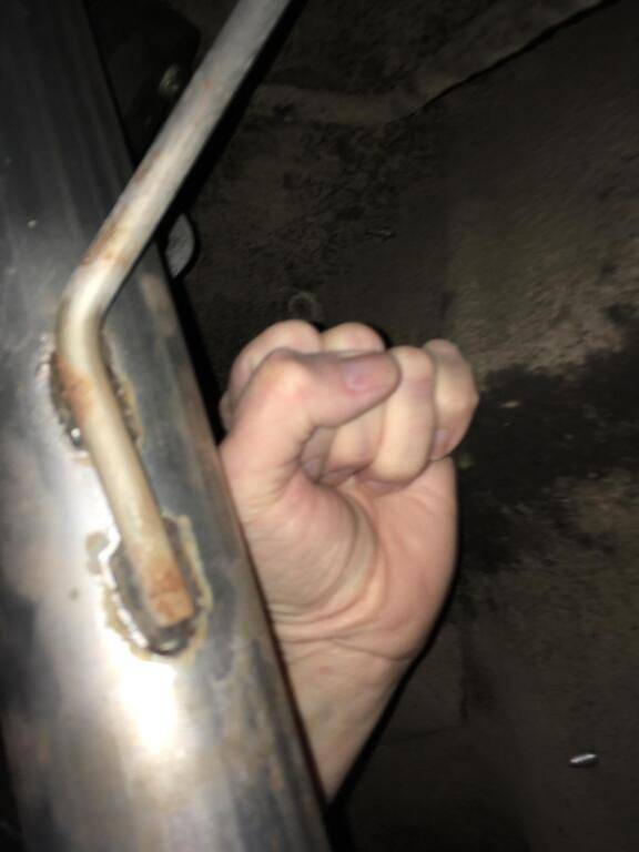

Clearance between floor and pipe, just above seat belt anchor.

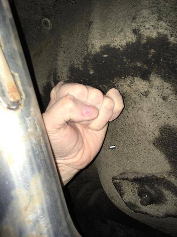

A little farther up the pipe.
Like I said, I talked on the phone with both Fiirm Feel and TTI.
Made me somewhat nervous. I didnt want to mount the sway bar only to not have the tail pipes clear.
I installed the exhaust first and could not feed the sway bar into place. At this point I boxed up the sway bar and brackets.
In hindsight I figure I should have c clamped the sway bar brackets in place and seen how the tail pipes fitted. I had been working on this car all winter and was in a panic to get it on the road.
If someone can conferm that firm feel and tti can co exist on a 66 c body I would lower the tail pipes and install sway bar
