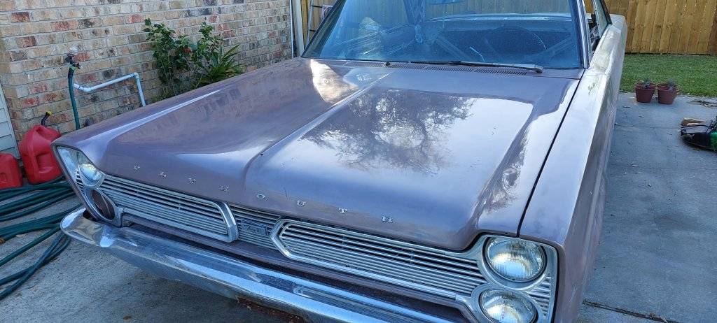

It's still pretty terrible but at least there's a reflection in the hood now.

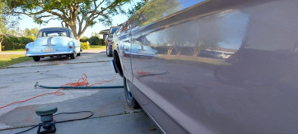

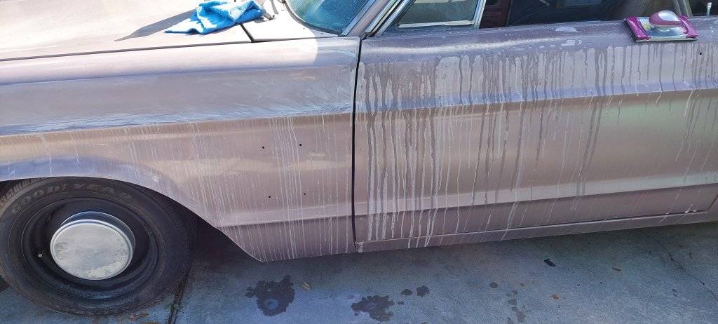

I hate sanding.
Was beginning to lose the will to live, sanding this paint sucks- by the time you smooth out the orange peel, you've taken all the paint off.
All scratches and hazy. Meh.
Still, looks better from the street.

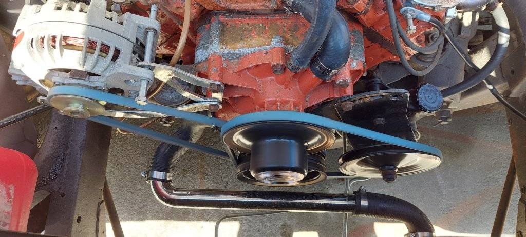

Made up ⅝" with some washers and a ½" spacer. Belt now rides and doesn't try to fly off.
Also it'll idle until it's warm. It goes backwards and forwards too, which is a neat party trick.
