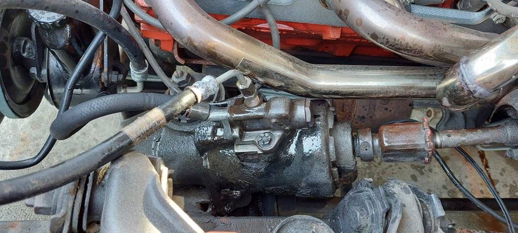

Power steering regulator arrived; hydraulic fitting was damaged in transit and is also the wrong size for the hose I have (3/8" vs 1/4"). Trying to find a way to make that work.

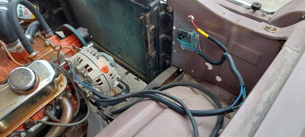

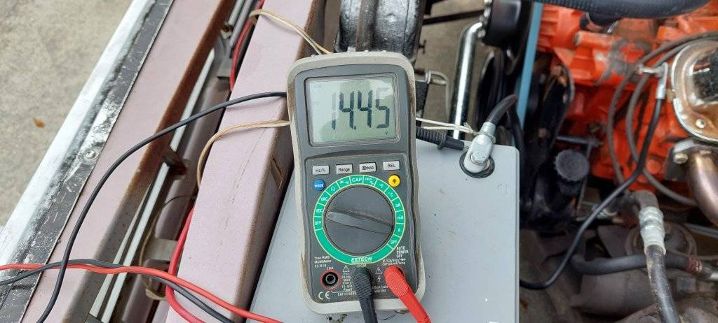

Alternator regulator and pigtail is here so I can play about with finding a place to mount that at the weekend, get it wired up and see if it'll charge.
Lot going on in parallel here right now.
Threw some wires at the car at lunch time.
Where would the original regulator have been fitted? I'm sure not on the slam panel here.
Correct place or not it does prove the principle though. That'll work.

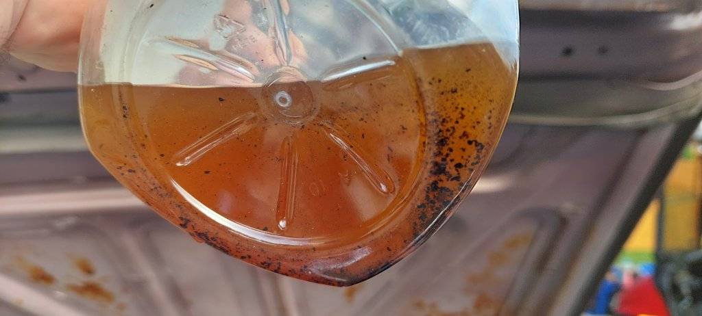

Pump spat that out. I'm going to flush it through a bit more.
Phil
Ended up accidentally flushing it through into the driveway. That was great.
Need some new o-rings. Found a connector that's halfway right.

My voltage regulator on my '66 is over by the bulkhead connector. Not sure if that is what you are asking about or not . . .

Are you talking about the part on top of the steering gear, with the nipple coming out at about a 45° angle? I have a spare one you can have if you need it.
Yeah, the pressure regulator. Bought one on eBay.
Need to find a 1/2-20 ring seal to an-3 adapter, seems that's popular for oil pressure gauges on Harley Davidson engines.
With a nearly right fitting, far too much pipe tape and some new o-rings, the pressure regulator is fitted.
I've got the correct fitting on order.
But, it works well enough to test. I indeed do have power steering.
