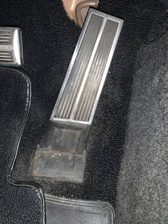

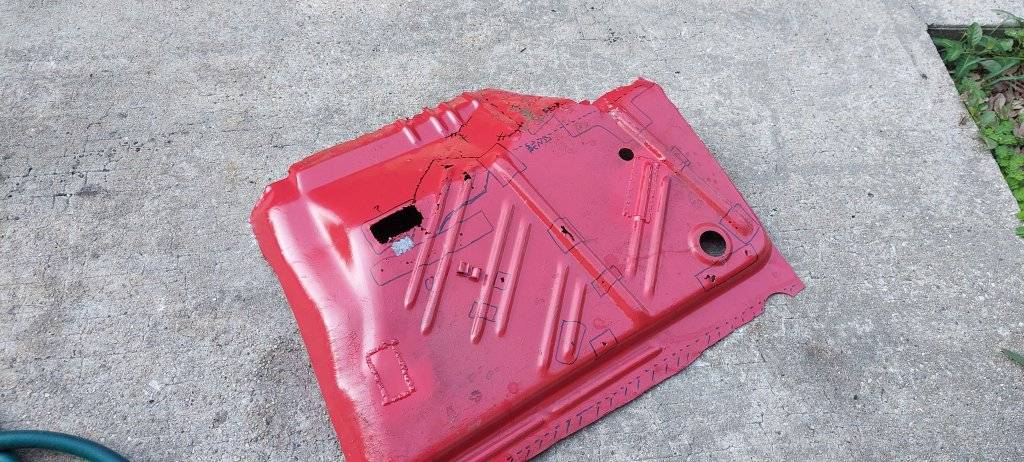

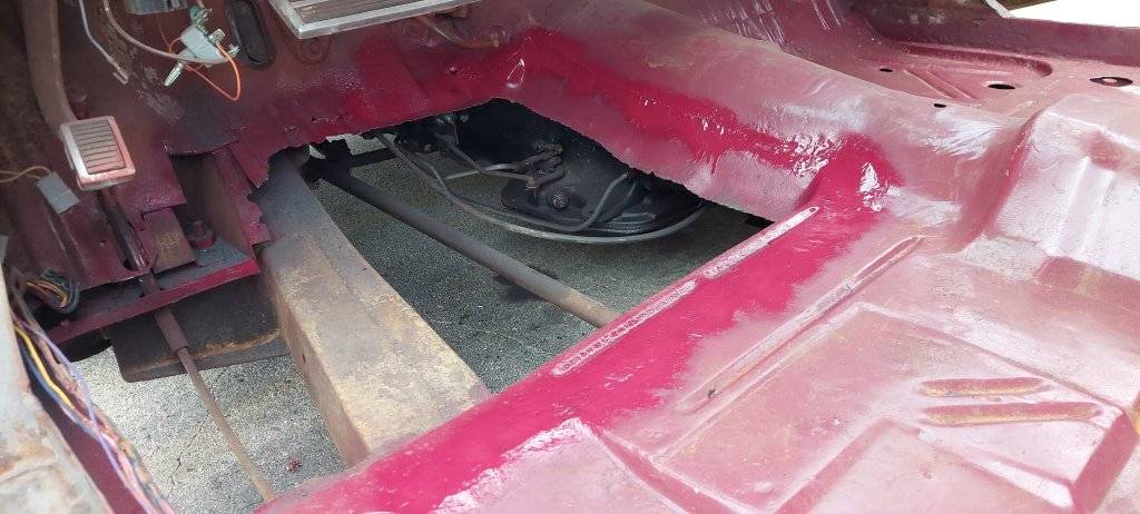

I think I'll make a little indentation to house it then. I don't want the base of it above the carpet, it's ugly.
That would make it like the pedal in the 300; then a slot cut in the carpet with the pedal poking through.
That makes it tidier, given that the rubber has all gone bad on the base of mine and I can hide it that way.

Here is what it looks like installed.
Yeah, I think I'll just find the middle ground there.

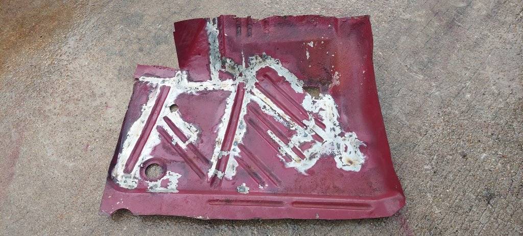

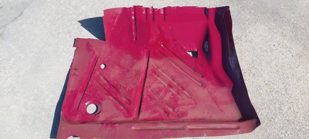

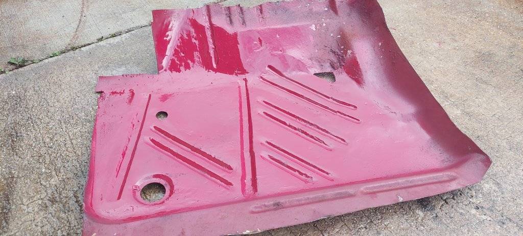

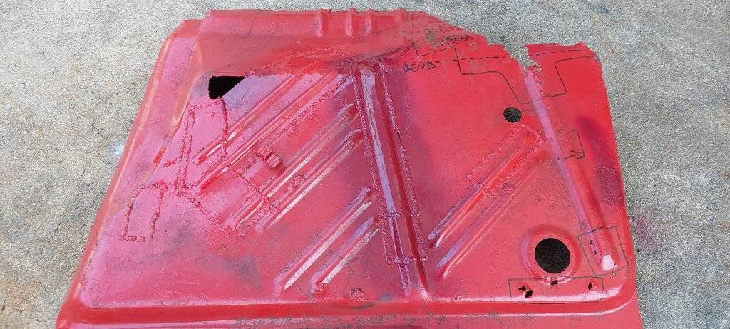

Beat the old pan back to what I think the shape should look like in the bottom left corner, too.
That is thin and needs to come out.

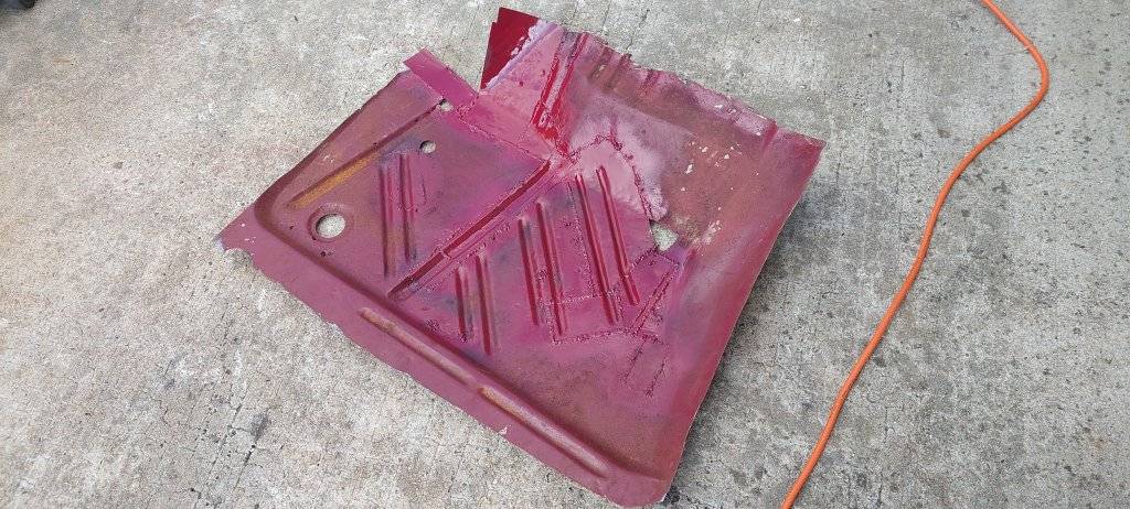

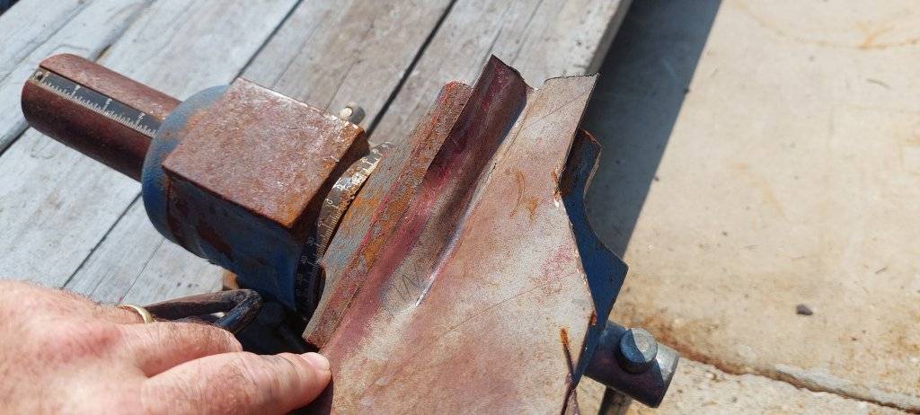

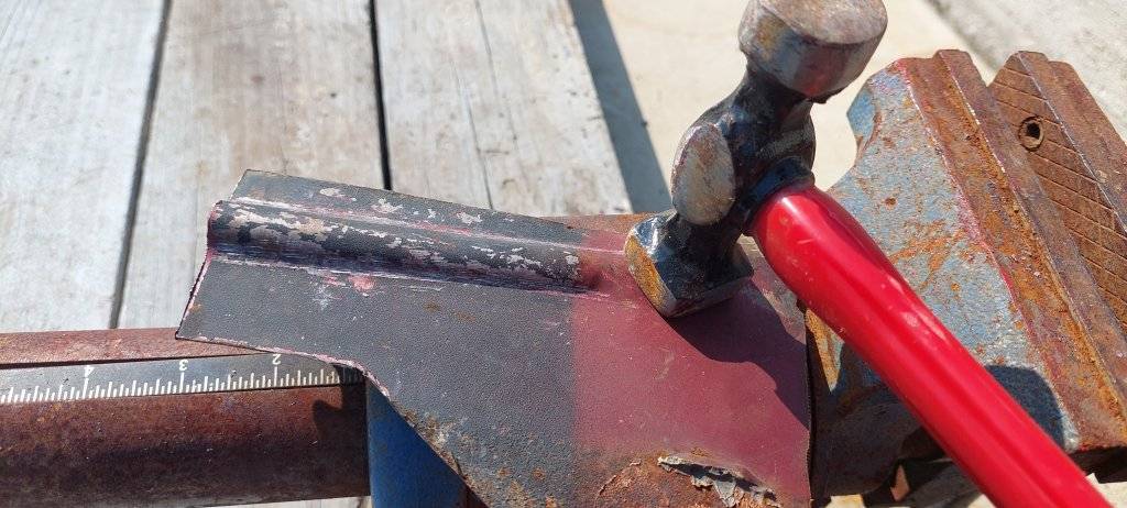

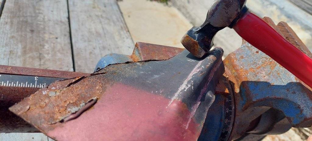

Continuing to make new sections for the floor.

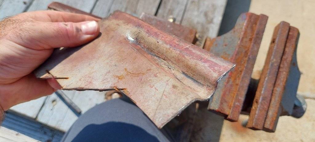

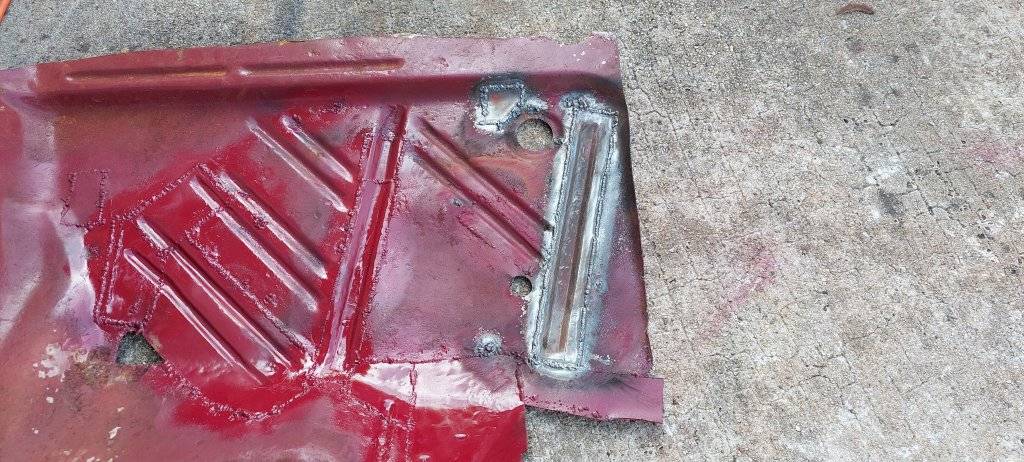

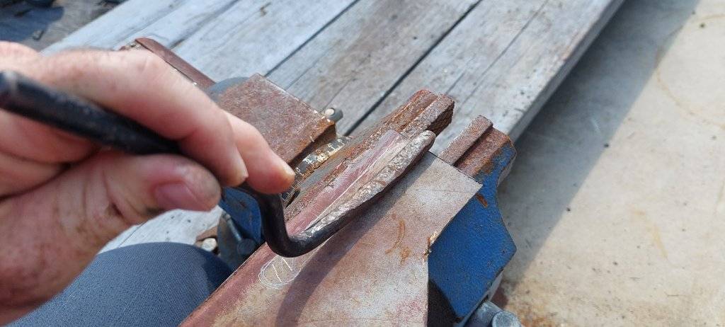

I start with a flat sheet, vice jaws open just a bit wider than the indent to make, and a steel bar slightly undersized.
Apply liberal amounts of hammer and create a divot, the sides all pucker and fold up.
Turn the piece over and on a flat surface, use the corner of a flat panel beating hammer, hitting in toward the crease to flatten the sides out.
Similarly, shape the end where the vanish occurs.
Shape wrinkles and tweak until the correct shape is achieved, using the piece removed as a template; they should neatly stack together if you're doing it right.
Trim to size and weld in.

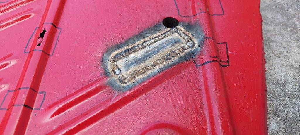

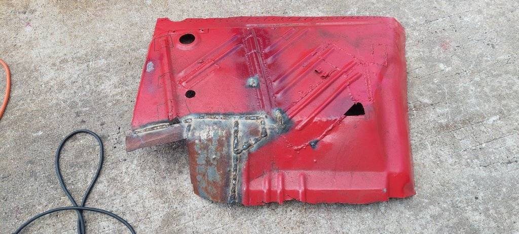

Put two patches in this evening before running out of time before dinner.

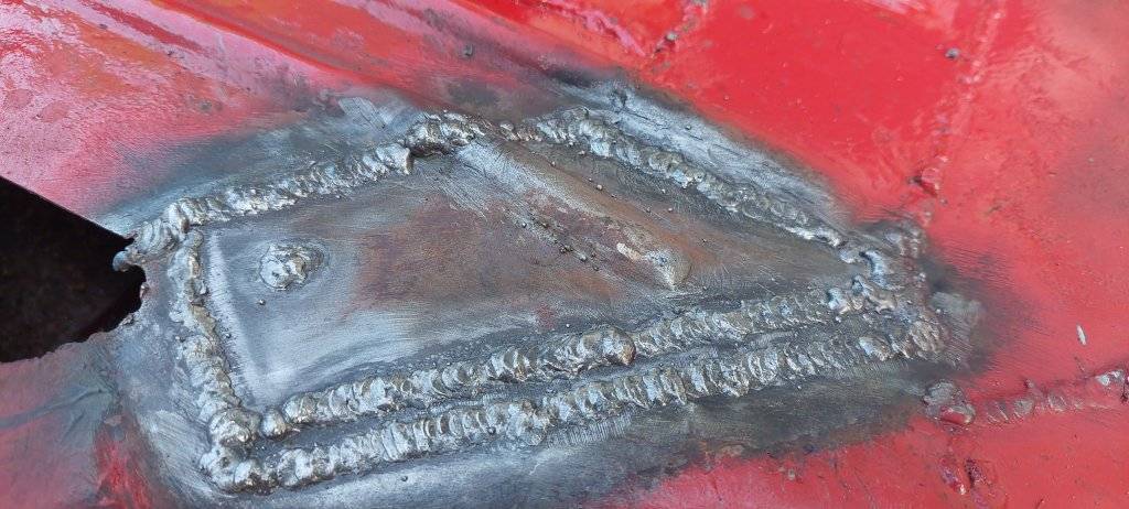

I don't think that's too bad for gasless mig outside in the breeze.
That's a couple more patches in, at least.

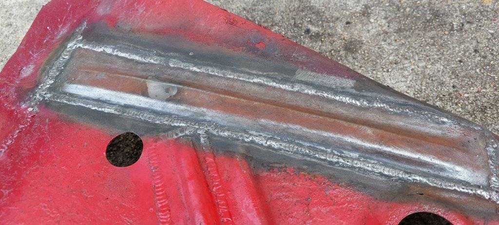

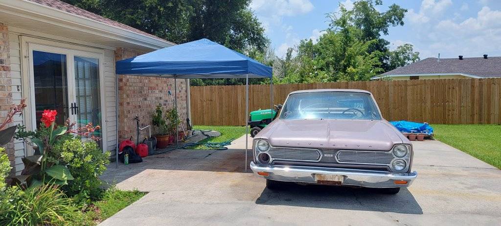

Took the time to put the portable canopy up today, and I'm glad I did. Made working outside much easier.
Got this far adding the large central rib in and ran out of mig wire.
I'll buy more tomorrow but the weather forecast doesn't look good.

Coming together now. Stabilized the left side.
Need to remake the big rib on the left, and create a new lip for it to mount to the rocker.

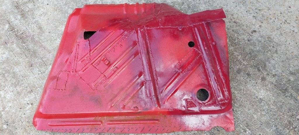

Nothing but rain today. A brief break in the weather after work meant I could grind the welds flush.
Smartens it up a touch, at least.

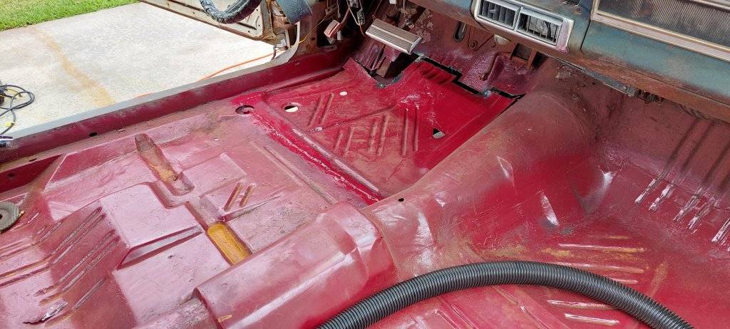

Cleaned the rest of the footwell up. Better now to see if it's good or not.

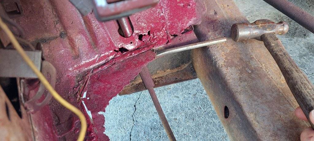

Started to look at the car, breaking off the spot weld.
That's the corner prepped. I'll build that down to the brace and that'll set it well to have the pan put back in.
