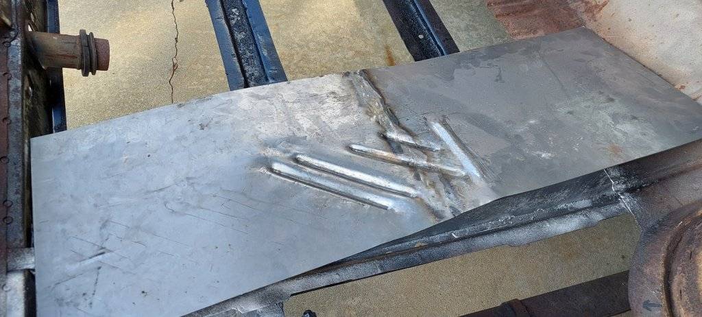

Welded two sheets of metal together to make a sheet big enough. Welding machine was having a fit and was feeding the wire about three times too fast. Not sure why.
Still, started to rough in the strengthening ribs, got a blister and ran out of time.
Maybe continue tomorrow.

Spent a hot afternoon hammering this. Doesn't look like much for the effort.
Need to trim it down but it ate my last cutting discs up, 18ga is generally awkward to work with.

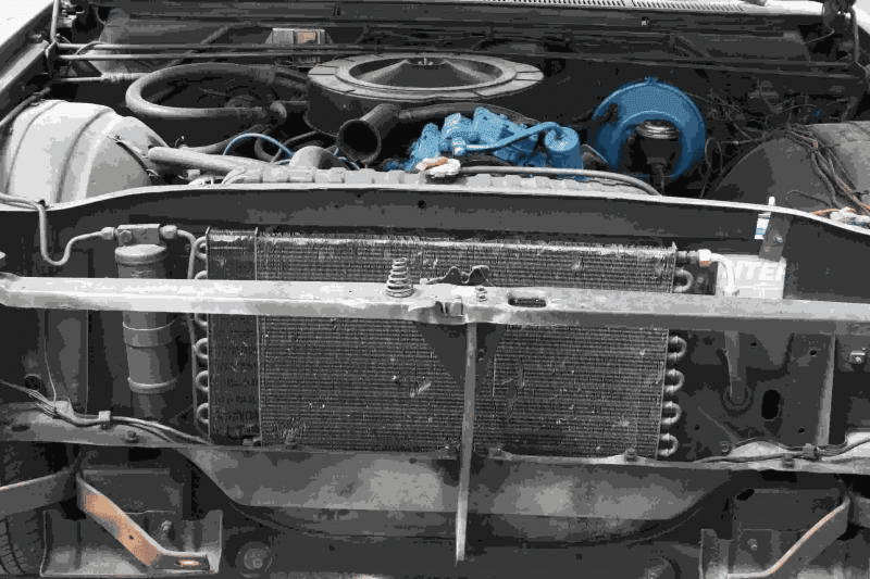

Question: re factory aircon
Where the condenser is from the factory? There's not a huge amount of space on the front side of the slam panel.
Looking to be putting aftermarket air in.
Phil

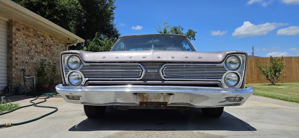

Can someone take a couple detail shots (front, back) of their '66 hood ornament as it sits on the hood please?
I need to make me a plinth for mine and need to see how it looks. Found a few photos on Google but the only close ones tend to avoid the base.
Thanks
