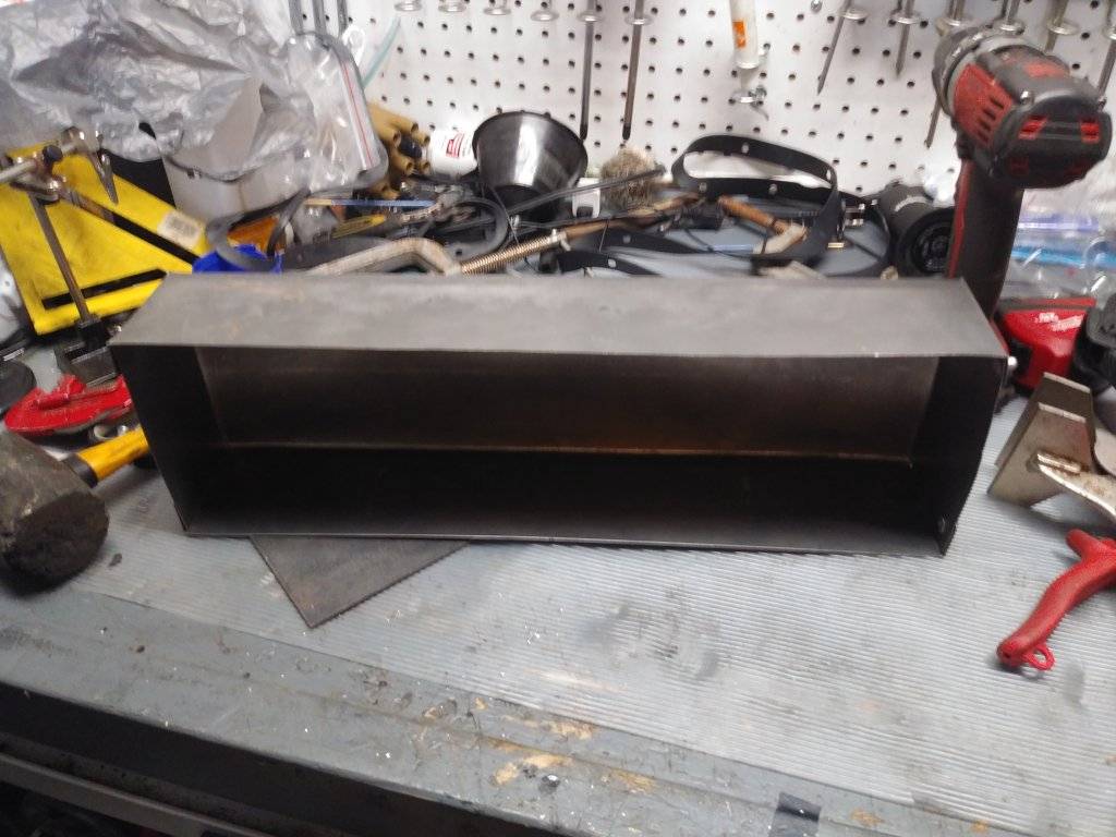

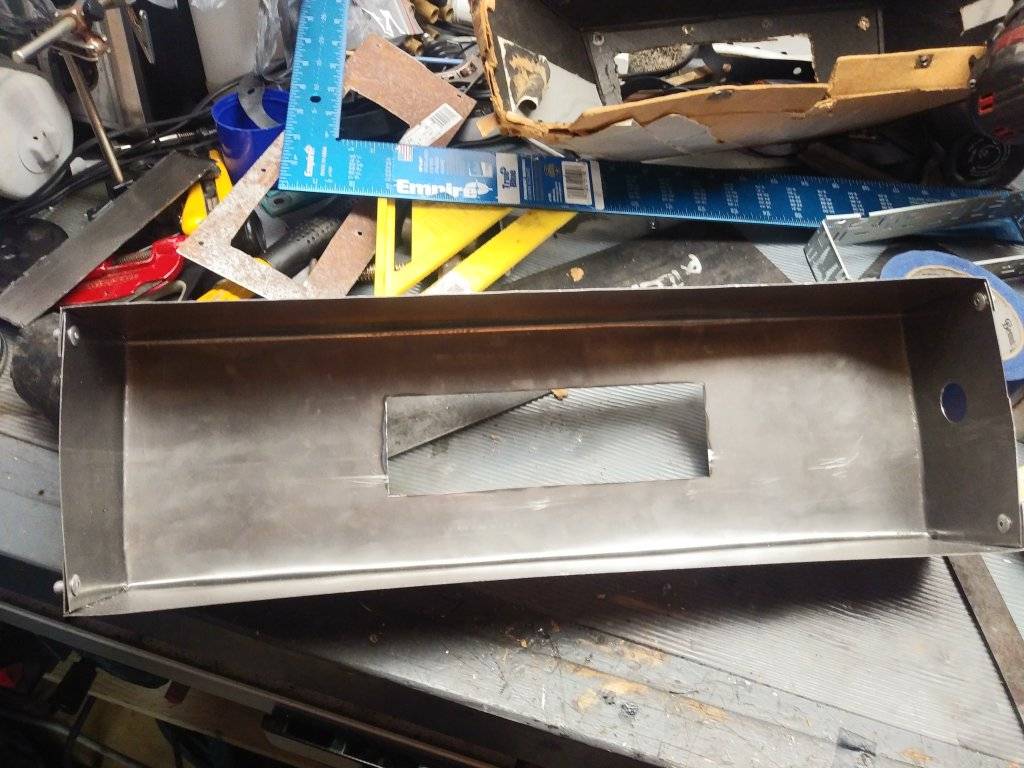

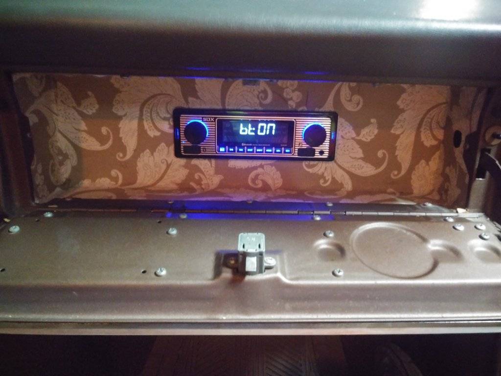

With that, I bought the cheapest Bluetooth radio I could find and went about making a new glovebox insert to mount the radio.
I thought about painting the inside with a hammertone paint, but decided it would be best if the inside were upholstered. Here are the results:
I'm happy with how it turned out, and it looks a lot better than the old decaying liner.

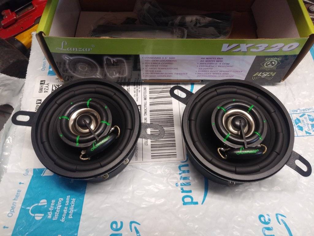

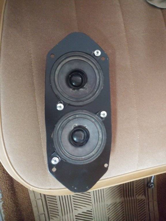

I decided the old speakers had to go. One would crackle every now and again, and that just won't do. To rectify that, I did the right thing and bought the best $40 speakers that had 1 day shipping Amazon had available.

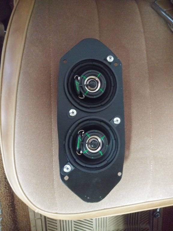

Pictured below are photos of the speaker plate that I didn't include in the last post, as well as the new ones.
Lanzar VX320: When *Quality* Matters.
The sound quality is actually not terrible. Good, in fact. 80 watts peak each, the old Pioneers were only 40. Hopefully they last. If not, I won't be heart broken. I have less than $100 into this stereo setup.

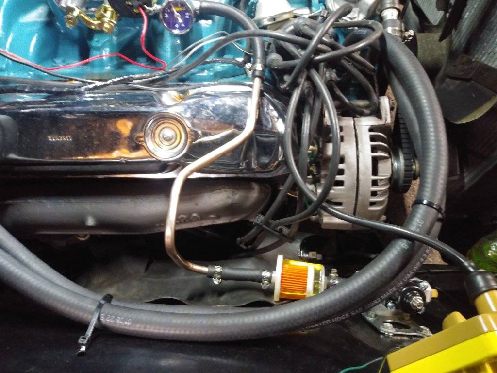

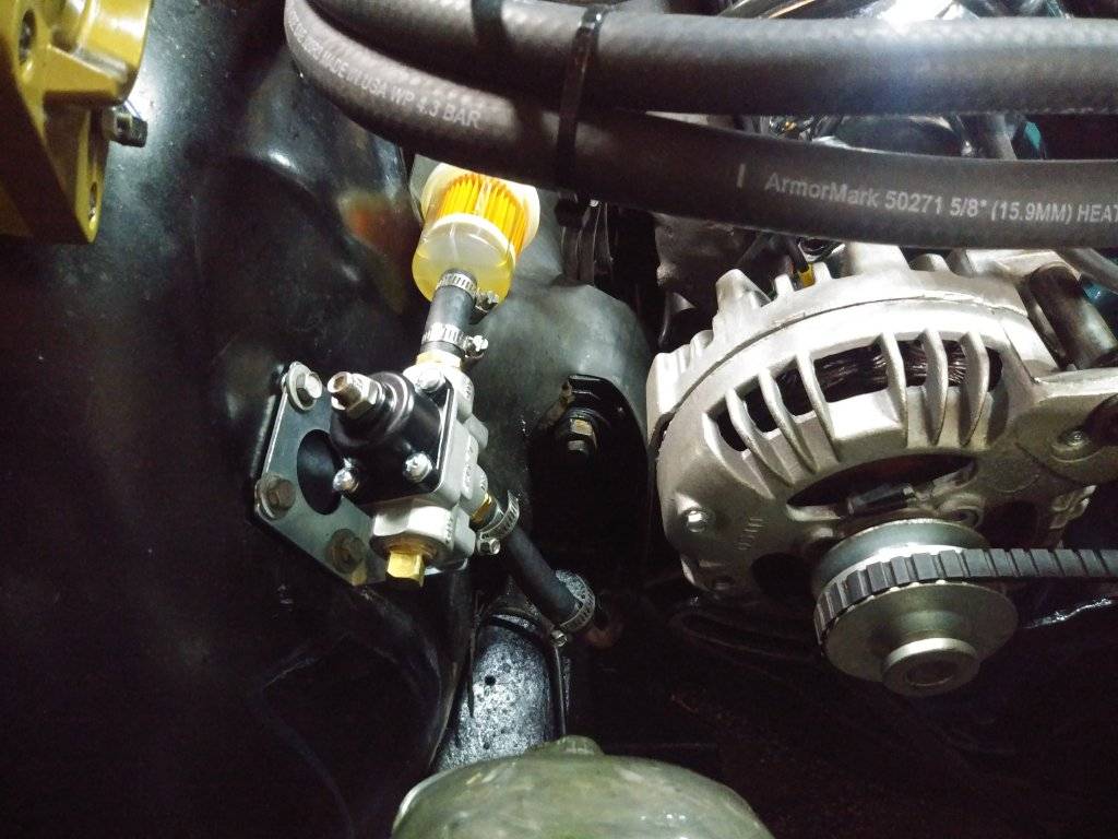

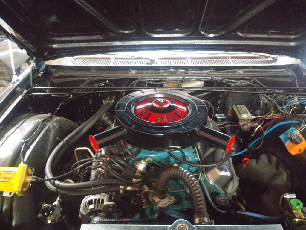

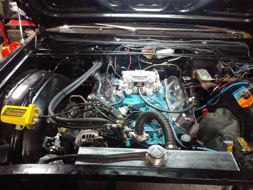

Wow, has it really been 8 months since the last update? Well, yeah. Not much has happened, really. The only notable updates are the additions of a new AVS2 800 cfm carburetor, a pressure regulator, and I also rerouted the fuel lines to keep them farther away from the engine.
Also, took the time to add a bumper sticker. I'm generally not a fan of them, but on this car, it seems right.
The only political endorsement I'll ever make. :lol:
Here's the latest:
It's just about where I like it. There's a few things left I'd like to do, such as gears & a posi, an electric fan, and maybe a shift kit.

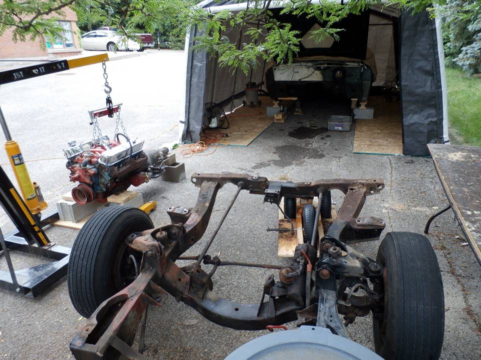

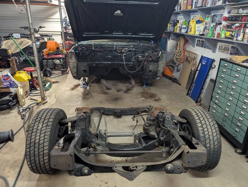

This update has been a long time coming. Honestly, I haven't done anything to the car since my last post other than drive it and enjoy it for the past year and a half. I've put thousands of trouble-free miles on the odometer, but now it's time to do something about the stub frame.
It's been repaired in the past, and has been showing signs of corrosion around the torsion bar mounts since I bought it. I purchased a mint stub frame this summer, so now the tear-down begins.

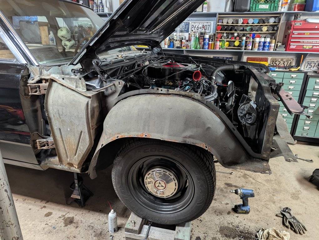

I was somewhat dreading what I would find underneath, being a southern Ontario car, but the only surprise to greet me was solid, original steel. The inner fenders were the only signs of past butchery, as they were welded and seam-sealed together. Other than minor rot inside the driver's fender, and a bit of bubbling on the bottom of the passenger side fender, they are perfectly fine.

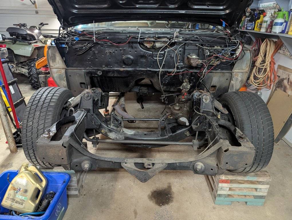

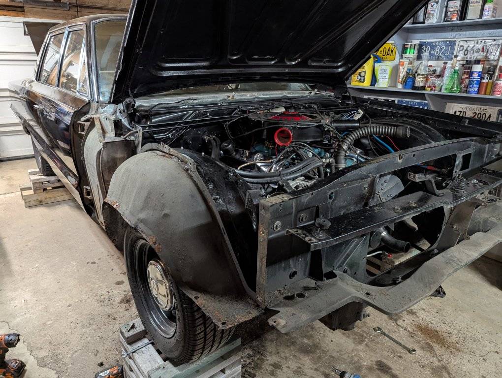

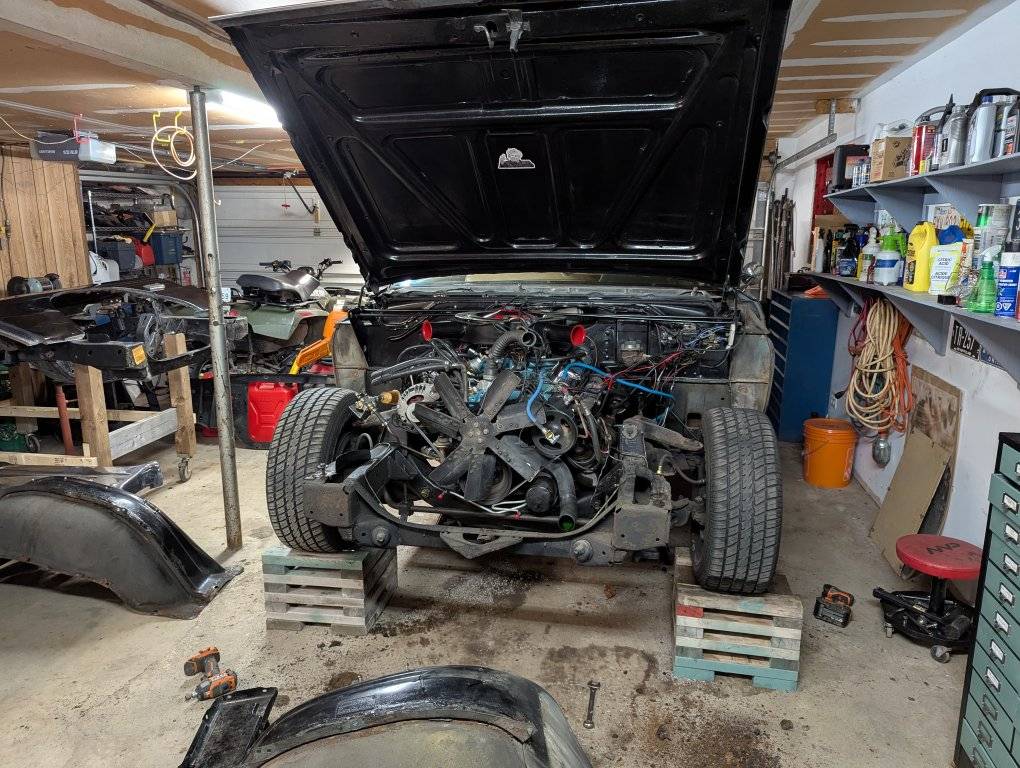

Here's where I'm at, currently. Engine and trans is out, everything else underneath is unhooked, save for the frame itself. What I'm wondering is should I remove the torsion bars now, or after the frame is out? Your input, as normal, is appreciated.
Take the tension off the torsion bars if not done already.
I prefer pulling the bars after the stub is removed but othets may prefer before hand.
You're swapping this stub out - yes? So you're going to have to support the body. When I started I jacked my '67 Monaco front up and set blocks under the front rocker rails in front of the doors and a block under the engine cross-member and rested the car on those. I did not use cribbing. I eventually rolled out the stub with engine and trans still mounted, but I backed off the torsion tension quite a bit before I did that because the wheels weren't supporting the car any more, just the engine.
You really can't do anything with the torsion bars while the full weight of the car is still on the tires. So you've got to block-up the body, put a block under engine cross member and get rid of the cribbing. Then you can dial back the tension on the torsion bars pretty much all the way. If the wheels are in the air, put something under them, planks or what-ever. I used cinder blocks under the body and engine cross member, but never in direct contact with the car or the ground (always used a thin piece of plywood). The blocks can crack easily unless protected by some wood. When you support the body, you have to do it in a way that does not get in the way of when you drop and pull the stub forward.
Before you do anything, fully disconnect the steering shaft. You'll have to drop the column and move if forward, it has to come off the steering gear.
Thanks for the advice. It lines up with the plans I had, so thanks for confirming I'm on the right track. And yes, I am swapping stubs. In fact, the stub that's going in used to belong to you.
Yea, I remember, good to see you working on it! Here's how I put blocks under the car, right under where the door is. I later put another set behind these. Those notched pieces are what I had, not ideal.

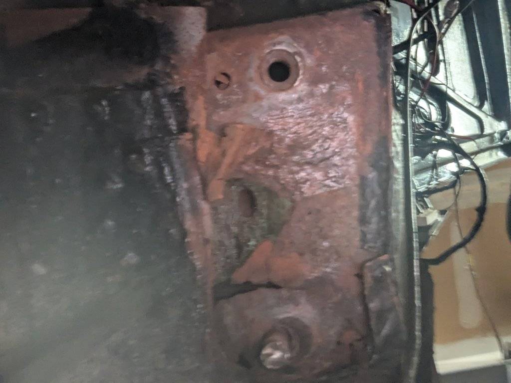

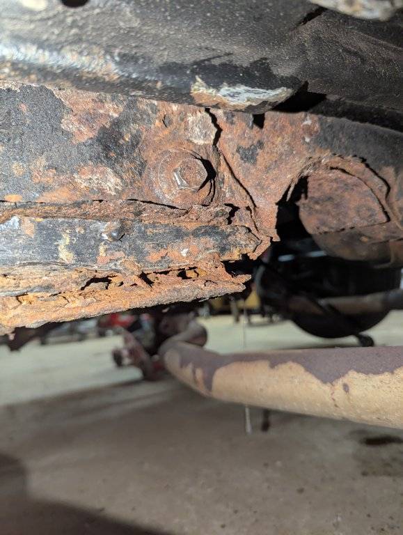

It would appear as though rust has fused the frame and the body together on the driver's side. Those rear bolts aren't going to budge easily. I'm thinking I may need to remove the torsion bars and cut that part of the frame apart from the body. Should be fun.

No, don't do that. The bolt you're showing is one of 8 bolts (no, actually 10) that connect the transmission crossmember to the stub. No need to wrestle with those while the stub is still under the car. And - your cross member may not be usable anyways. I was able to re-use mine, but it did show a lot of rust erosion on the inside, and I cut the lower panel off of it and welded a new 3/16 plate.
When working the actual bolts that connect the stub to the body, where I could reach them I used a small wire cup on the heads first to clean the rust scale off them. Some of those bolts you can see the end of the bolt and have access with a cut-off wheel to cut the end of the bolt off if it's really badly rusted. Spray actual real penetrating oil at the bolts, and work them back and forth (I did all that by hand, no air or power tools). Working a rusted bolt back and forth (and using the oil spray) means you have less chance to break it. Also, some metric socket sizes might be a better fit because of rust erosion of the heads. Always use 6-point sockets (not 12).
This portion is fortunately not the transmission cross member. The cross member is in decent shape. This is the portion next to the rocker panel. I have been soaking them for awhile, to no avail. I will likely cut the heads off the bolts, after further reflection.
Great job. when you get a spare moment, take some black electrical tape and tape all your wires at the bulk head to look professional, looks like blind lady trying to knit.
Blind lady. I like that. I'm definitely rerouting the wires when everything goes back together. I prioritized enjoying the car before and only cared that it was running and driving. The spaghetti factory has been eating away at me.
Ah ok. The nut behind that bolt is welded inside the stub. It's one of 3 bolts on each side that need to come off. One of which you access from inside the car on the floor, under a plug. The third bolt I had to go to Princess Auto and buy the ratchet extension set (3 extension bars, I think $17, between 2 and 3 ft long) to get to that bolt.

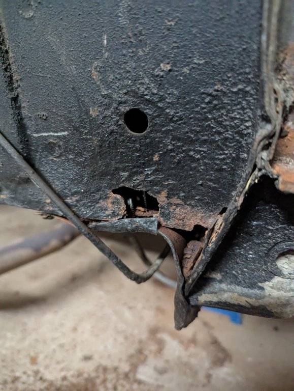

But. It's free. Just about every bolt on the driver side had to be cut out. The only one that didn't was the vertical bolt accessed in the cab. The floors have been patched in the past, and the previous guy patched right over the access holes. So new holes had to be cut in the floor.
Everything on the driver side is pretty crusty.
There is some rot, but it could have been worse. All the sheet metal on the passenger side seems to be good, and all the bolts on that side came out without issue. 6/10 ain't too bad.

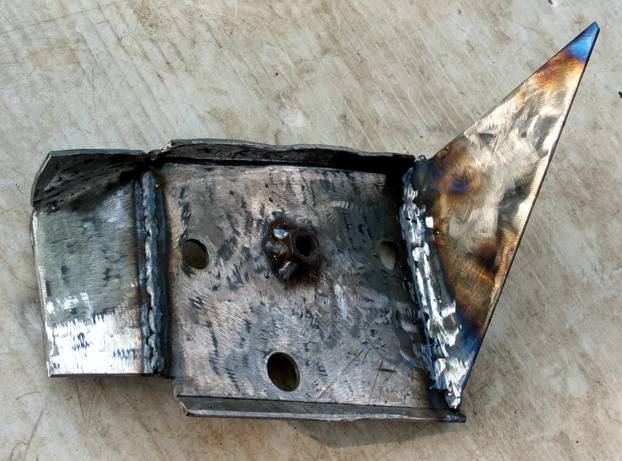

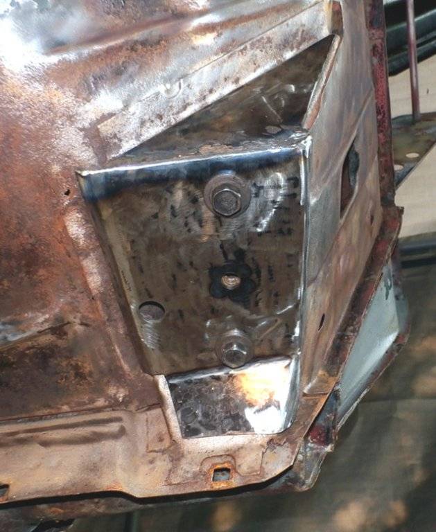

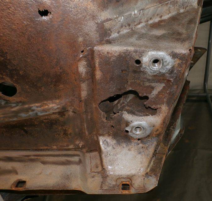

That's too bad that you couldn't work those bolts out, especially that 1 bolt for the front driver strut. Here's what mine looked like in that area:
The shim plates had rusted and expanded badly in that area between the bolts, but the area where the nuts are was still pretty solid. I doubled up that entire area with a plate arrangement:
With a third nut welded to it, and welded it in place:
It took the place of one of the shim plates, so no problems there. Yes, the passenger side was better, still a bit of a hole there, but I didn't put a plate like this on that side.
