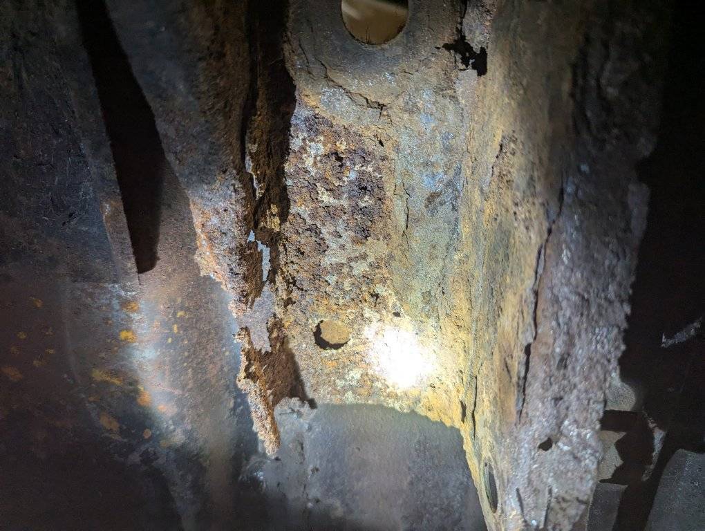

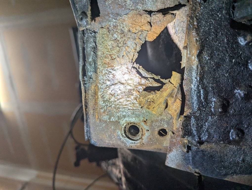

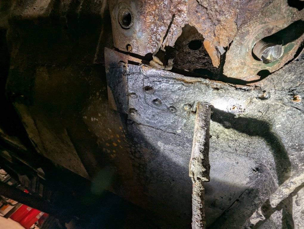

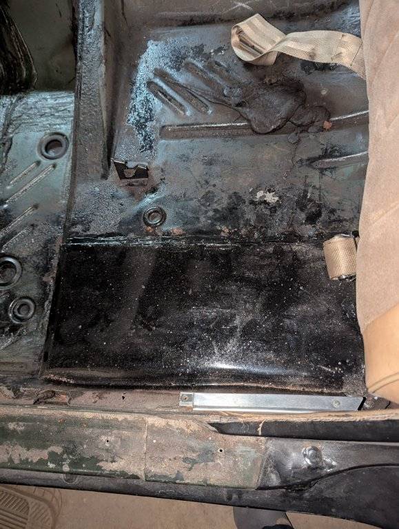

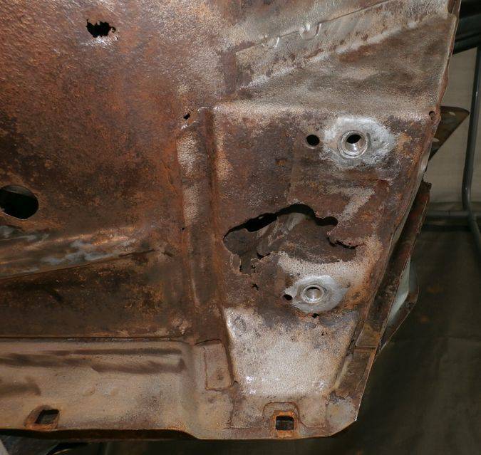

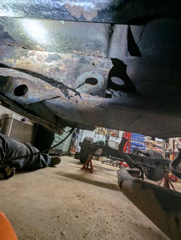

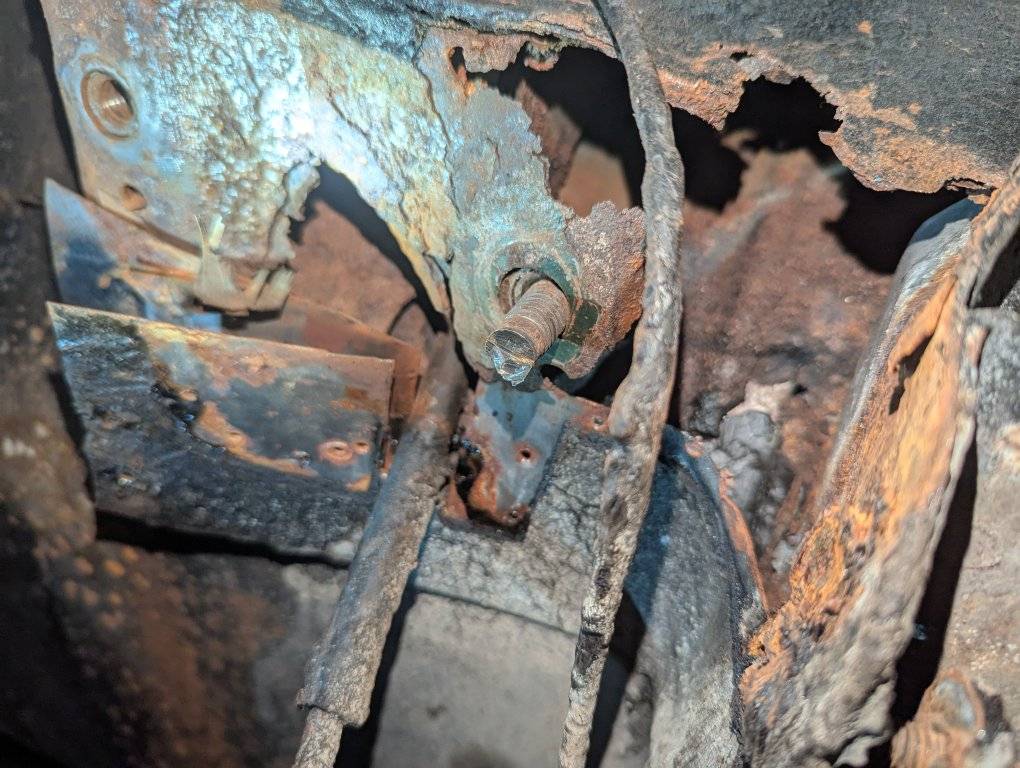

That's too bad that you couldn't work those bolts out, especially that 1 bolt for the front driver strut. Here's what mine looked like in that area:

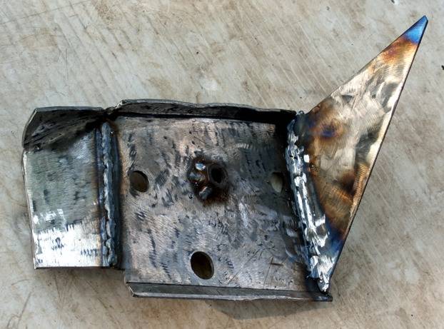

The shim plates had rusted and expanded badly in that area between the bolts, but the area where the nuts are was still pretty solid. I doubled up that entire area with a plate arrangement:

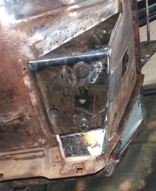

With a third nut welded to it, and welded it in place:
It took the place of one of the shim plates, so no problems there. Yes, the passenger side was better, still a bit of a hole there, but I didn't put a plate like this on that side.

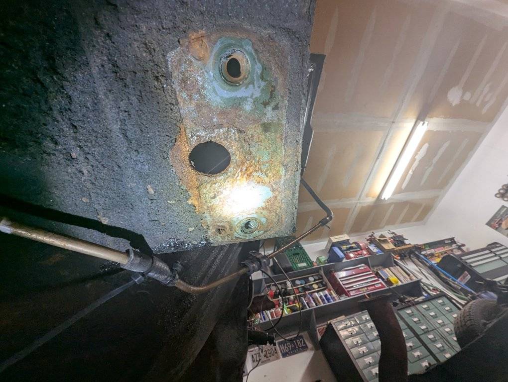

Similar to what mine looks like. I had to cut one of those strut bolts out unfortunately, as the captured nut inside separated from the inside. The other one came out fine.

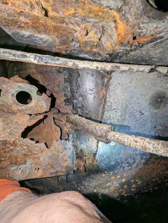

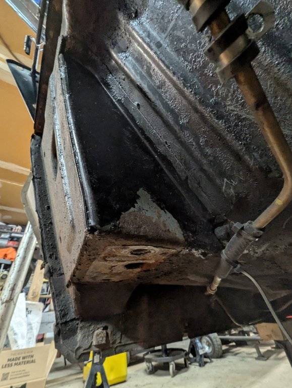

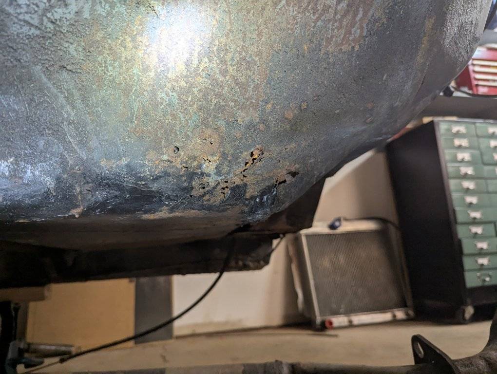

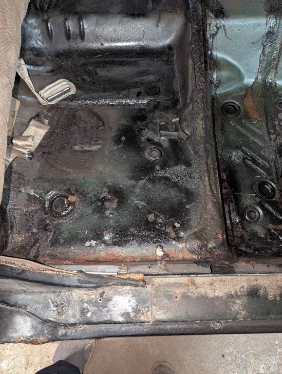

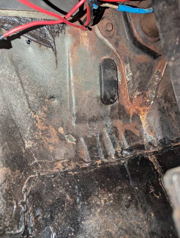

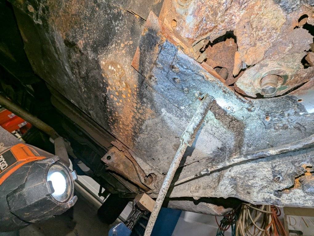

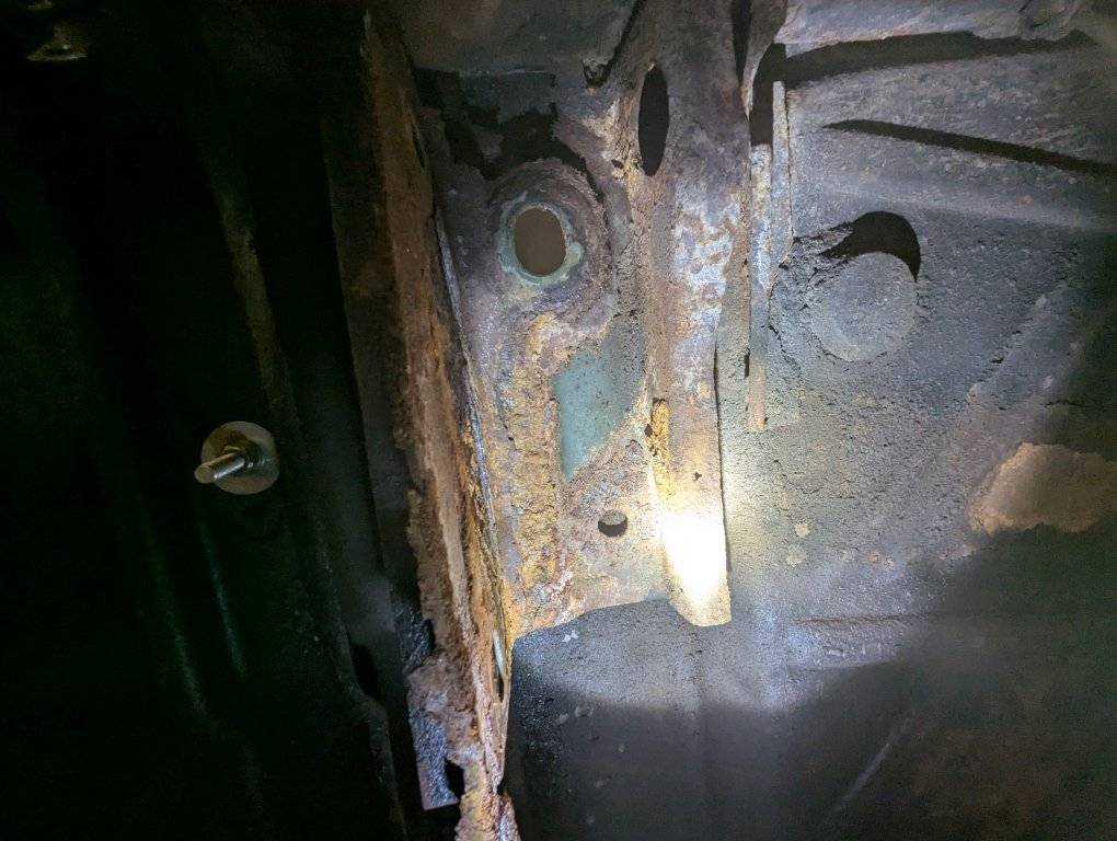

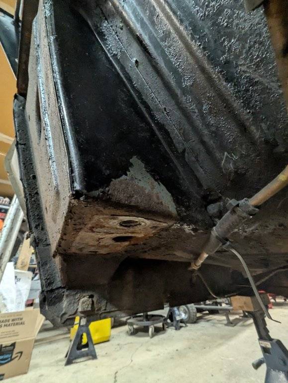

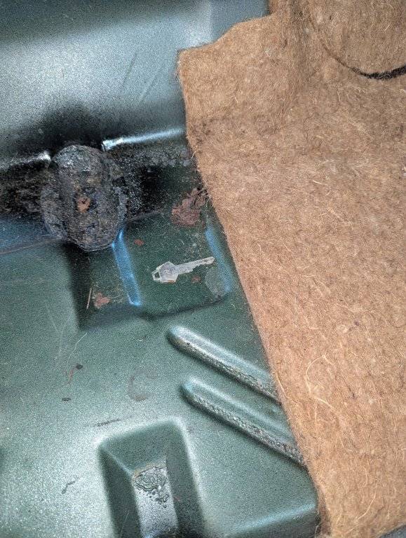

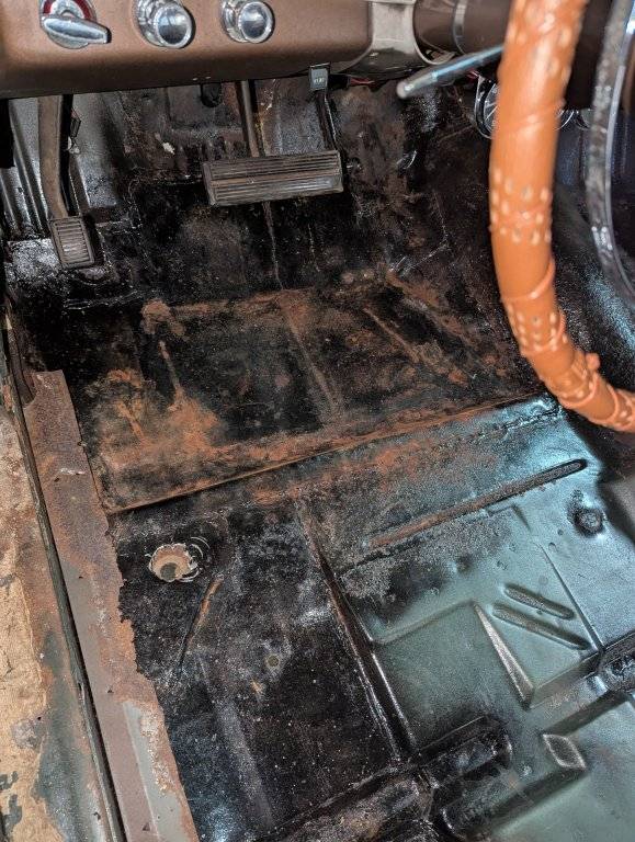

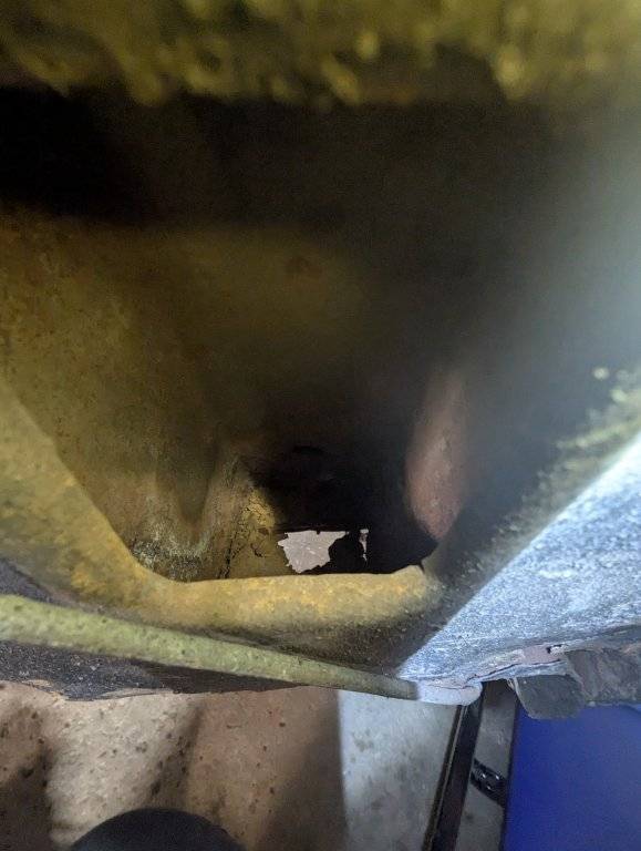

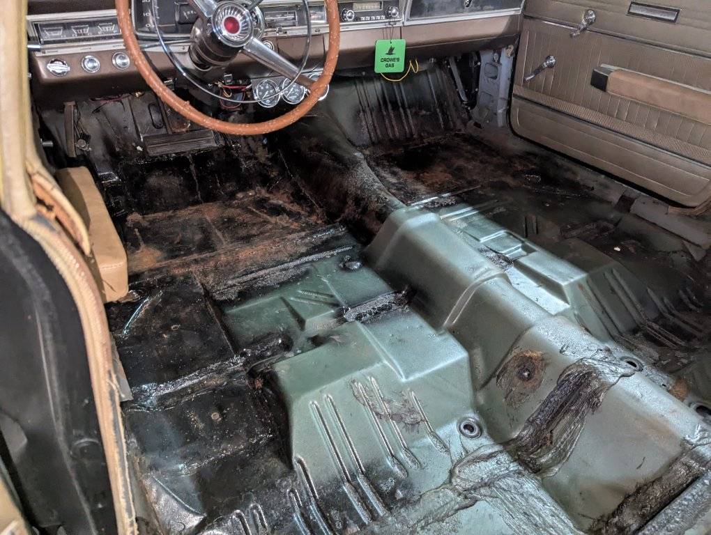

More pics of the underbody:
Driver's side
Trans tunnel, driver's side

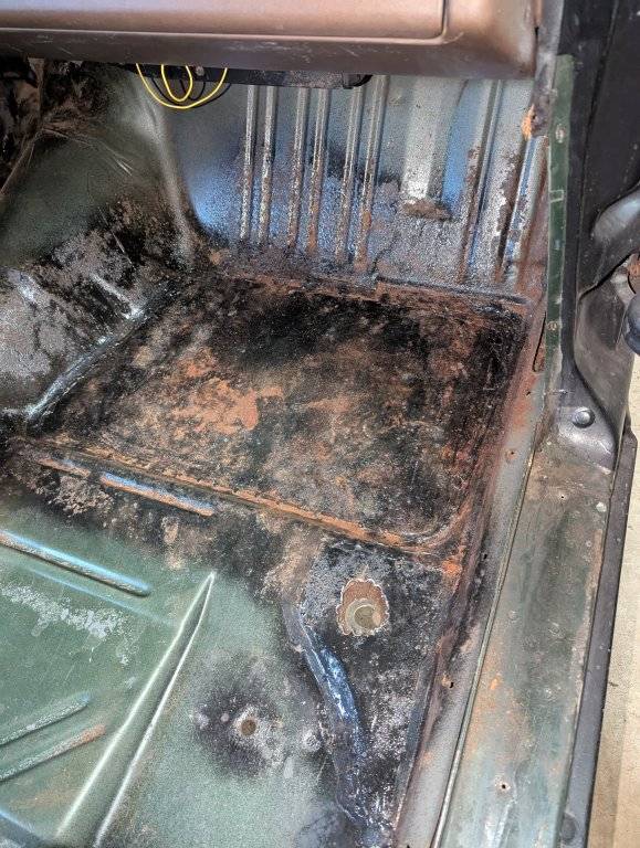

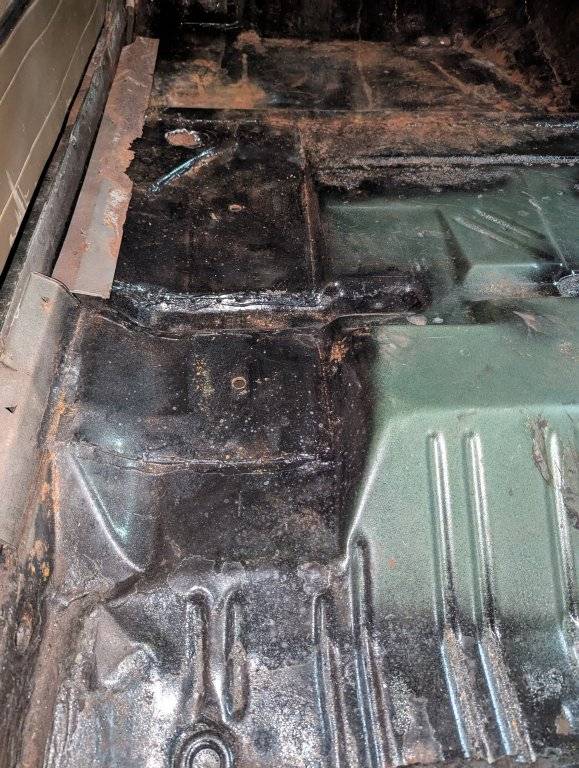

I would have naturally preferred less corrosion, but all in all, it looks pretty minimal.

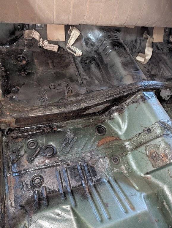

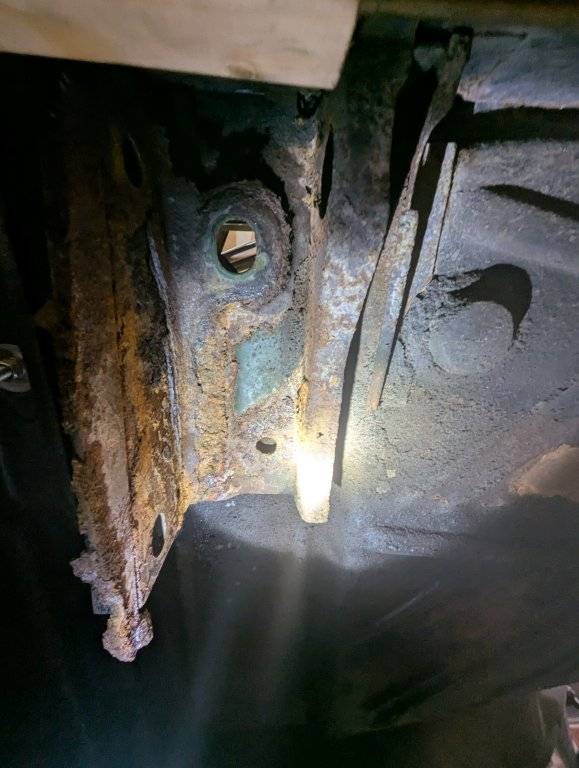

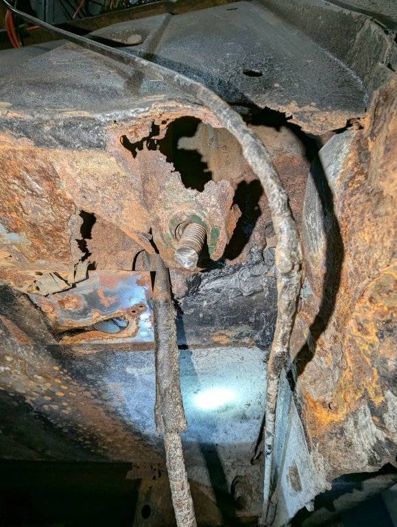

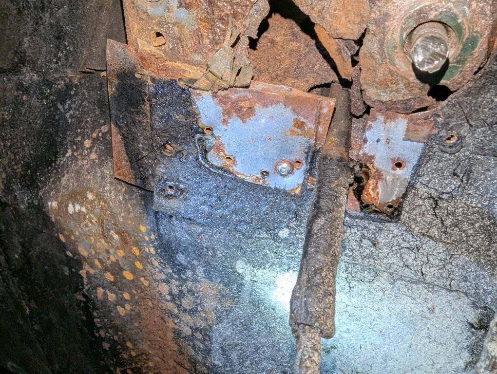

But wait- - there's more!

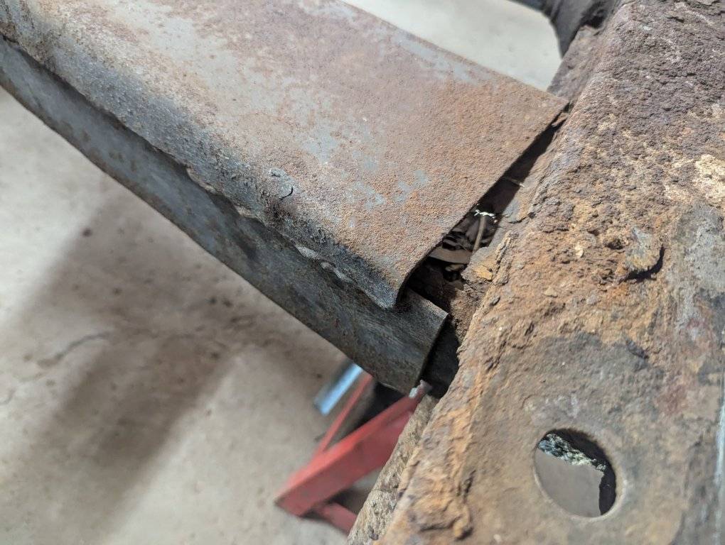

I can tell at least two pros worked on this previously, as this repair was held together with scraps of sheet metal, self tappers, tar, AND hopes & prayers. It's rather disturbing to think this was all that was holding this car together.
The rest of the car appears to be pretty sound. * I hope that statement doesn't come back to bite me in the ****

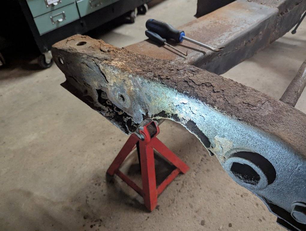

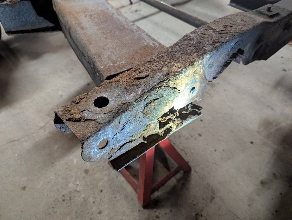

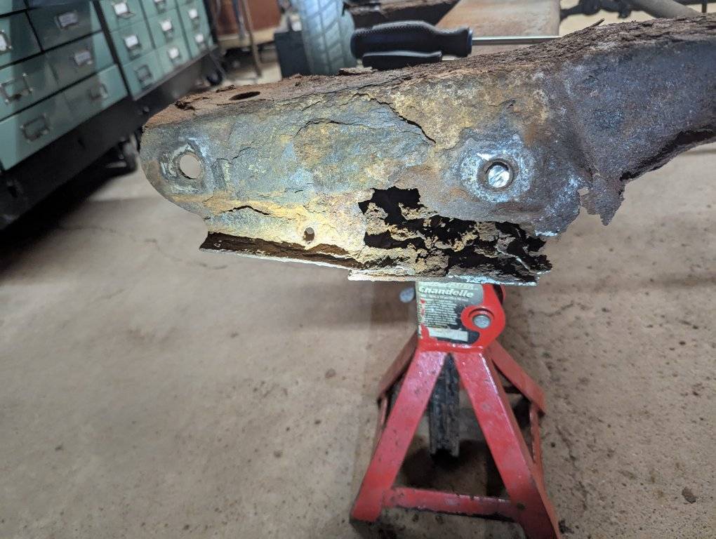

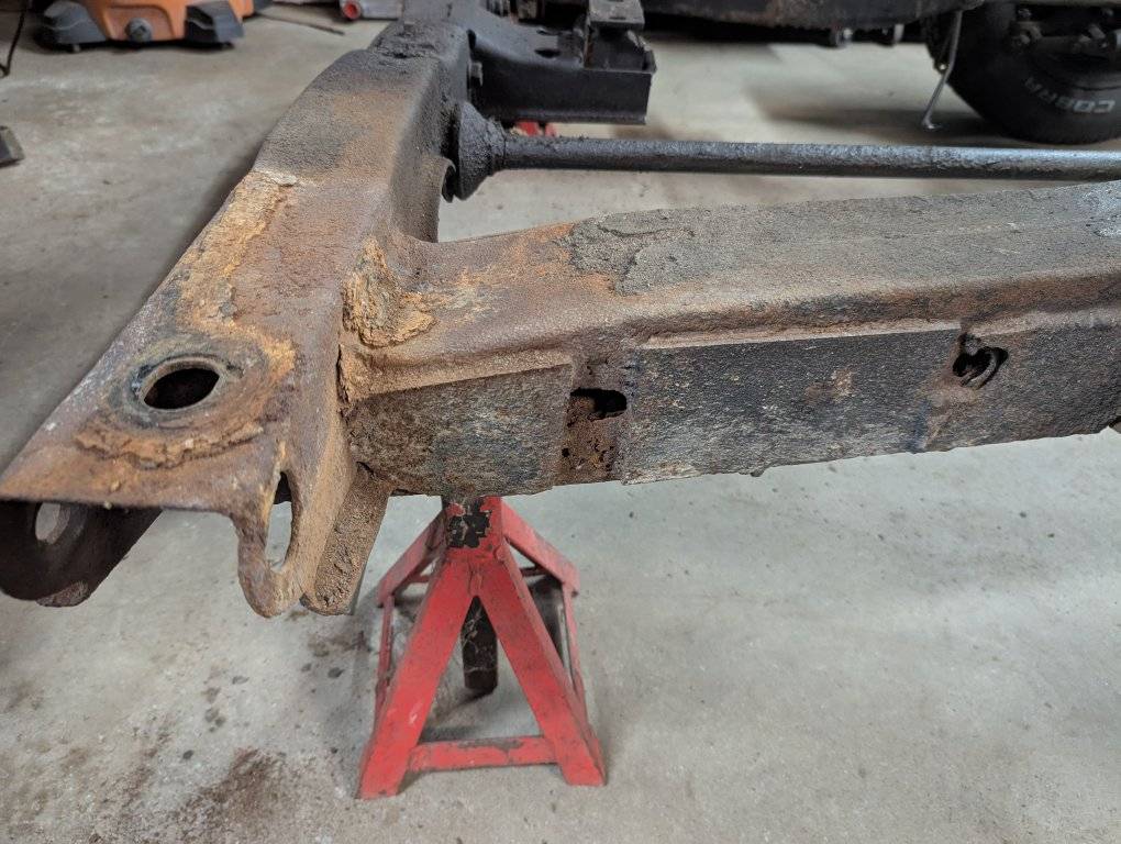

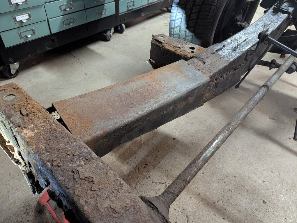

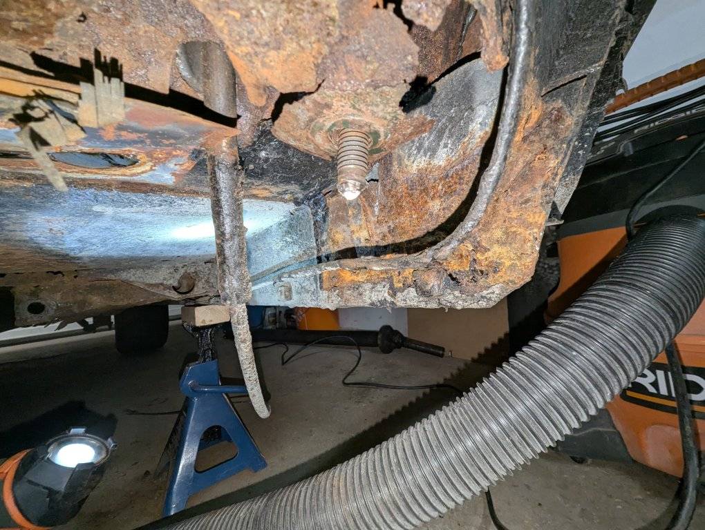

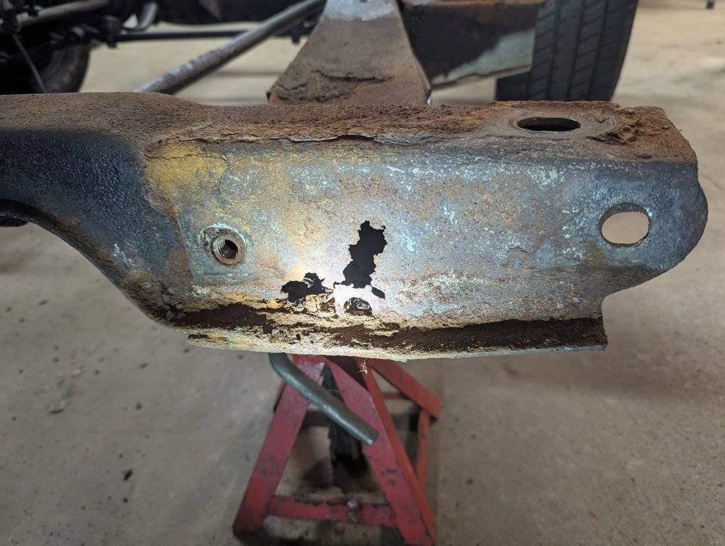

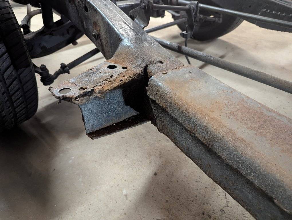

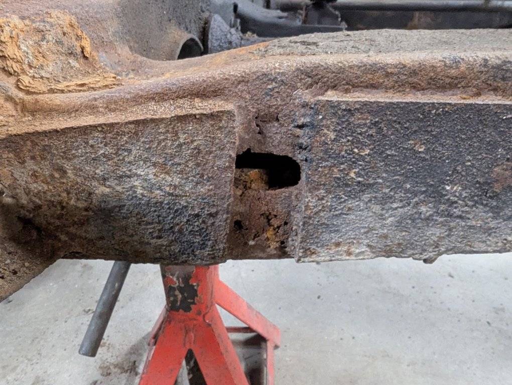

Yea, some clean up and probably welding. But I'd want more blocking support than those 2 jack stands if it was me.
Amusingly those stub support areas are the one part of my car that wasn't ******. I'd do that up right, that's the most important structural part of the car. Those pedestals alone locate the front end of the car.
I'd replace that stub if i were you too. The main box section is supposed to go through the crossmember section and that appears to be cut off entirely on yours. About as much to weld too as the original i took out.

I saved my basket case 880. It can be done. The brackets the stub mounts too on the car looked the same on mine, but cleaned up perfectly fine with a wire brush. Be sure to source proper replacement for the stub bolts, they are unique and the tapered section locate the frame. I had to cut a few as well and replacing them properly was a pain.

I'm strongly considering replacing everything in that area. Like an onion, the more layers I peel back, the worse it gets. I've sourced a mint floor and cowl, so I think it'll be better in the long run to have proper, factory steel in place. I won't make a final call until I pull the interior and check the rest of the floor.
The stub pictured will be scrapped once I cut the engine mounts out. MoPar Man hooked me up with a minty stub frame.

It looked like the only tapered bolts were the ones bolting the stub through the floor? If so, both of those bolts can be saved. I'll also be saving the extra thick washers. The other bolts looked to be fairly ordinary.

Yeah, i had to cut one of the tapered ones. Fun.

I made most of the stuff on my car from scratch, but the pedestal that mounts the stub outriggers is really important. They locate the stub and do the lion's share of loadbearing. To replace them you'll have to be really exact in locating them. I'm lucky they were somehow fine for me so i can't say much other than just rebuild it in place and be really really careful it's both strong and located accurately.

You are correct - there is a difference between USA and Canadian full size Dodge stubs with how the torsion bars work - bar length is different - however, I believe the US/Canadian stubs are interchangeable, but DO NOT take my word for it.
If you're at all worried about it, I would think you could source a Canadian stub - there should be still quite a few excellent stubs available from Saskatchewan that would be direct/correct bolt-on.

Yes, the Canadian cars used Plymouth stubs. The only stumbling block in my way is the stub I sourced is for a '65. Other than the engine mounts, there aren't any major differences.
I believe that engine setback is also 1" different between 65 and 66 stubs. Not widely known...
I haven't confirmed, but visually, they appear to locate it in a different spot. I made a jig to locate the '66 mounts correctly once I remove them from the old stub. Up until a few days ago, I was hoping that was going to be the hardest part of this project. Oh, how I miss the good ol' days.
Yea but the mounts are different between those 2 years so there's no way to compare - is there? The difference (if real) would show up in the trans mount?
Agreed - and while it's been a long time ago, the 66 trans cross member bolts into the 65 stub and vice versa, so not really an insurmountable issue. Also, and this maybe hearsay, but I've heard you can just turn the trans mount around...

They are, the Canadian stubs are just the american Plymouth stubs. I replaced mine with an american '66 Polara stub. Bolted in perfectly, all the body mounts, bumper mounts etc are identical.
