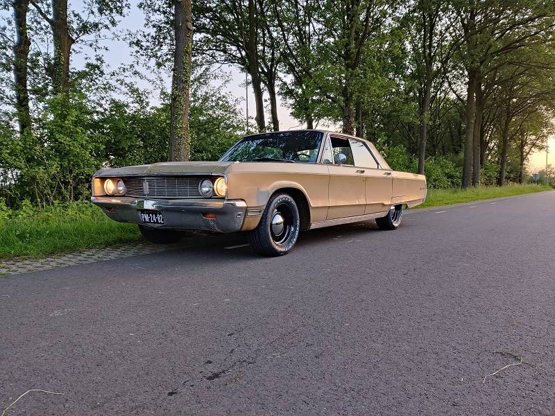

I wanted to be able to drive the Chrysler to the new house, so I've quickly finished a lot of things to get it roadworthy and registered.
It passed inspection/registration with flying colors and I've been driving the Chrysler on nice days since sept 2021 and moved it to it's new home under it's own power.

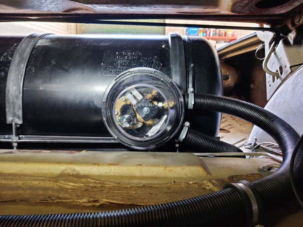

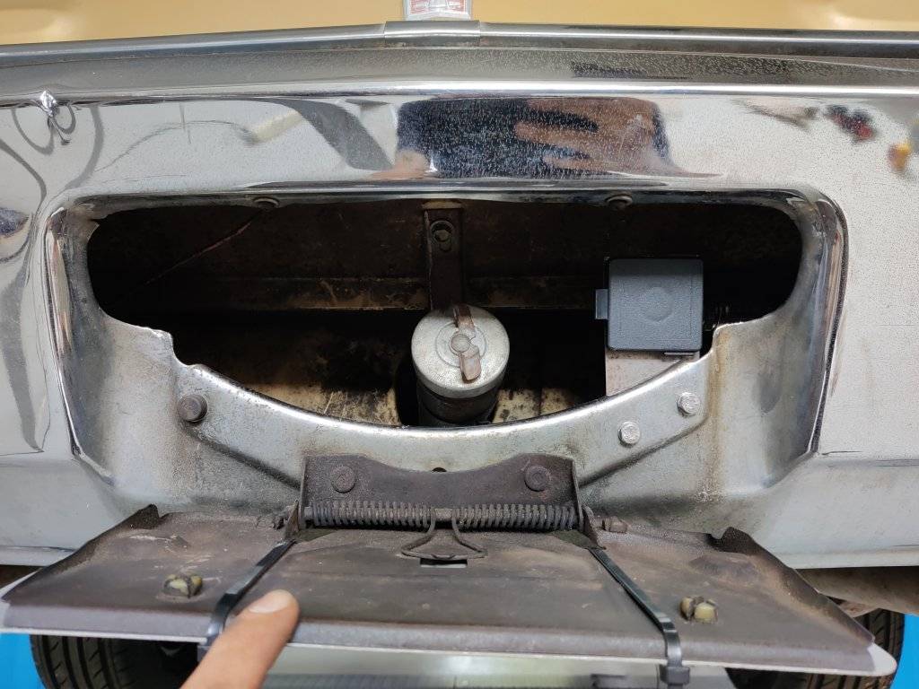

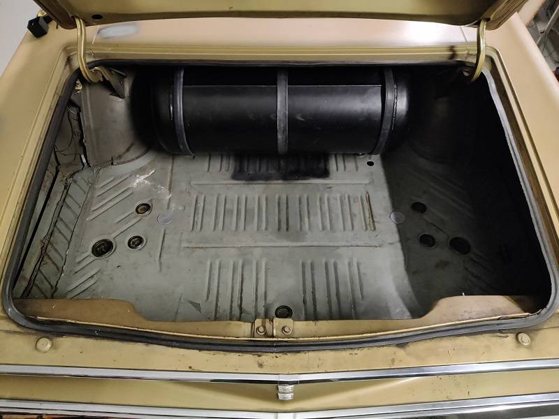

Not a lot changed to the Chrysler in the past couple of years, except that I've installed an LPG system to reduce driving cost significally.
I've noticed that the high gas prices were limiting me in taking the chrysler everywhere on a nice day.
RON98 fuel is around 8.5-9USD per Gallon over here, and LPG is "only" 3USD per Gallon.
Driving the chrysler is even more fun now. The only downside it that the LPG tank takes a lot of room in the boot.
It's a dual fuel system, so I can switch between Gas and LPG when I want.
I can dedicate a post to how the LPG setup in more detail if people are interested.

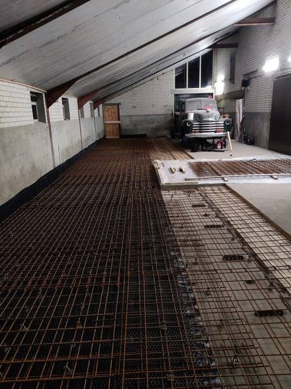

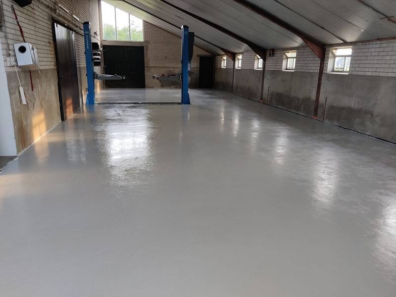

The shed was a cow shed, and we've converted it to our car workshop.
In this picture all steel bars, water bowls, equipment was already removed and prepared for concrete pouring.
The concrete floor already there was only 4" thick, so not thick enough for a lift.
We've removed a 10x13ft slab of concrete, dug it out 10" deep and poured reinforced concrete specifically for the lift.
After the floor was poured it was also coated and we've installed an extra wide 6 tonne (metric) lift.
Plenty strong enough for the chrysler and dads Chevy 3100
The shed is fully equipped by now.
Multiple benches, tools/wires/connectors to make wiring harnesses, tire machines, you name it.
