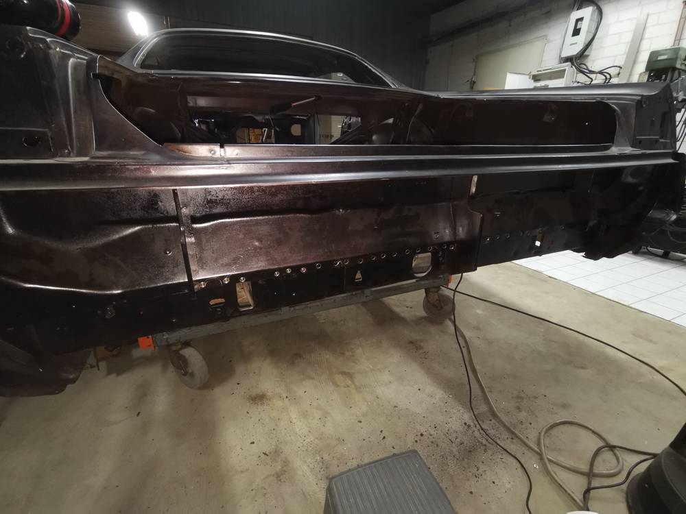

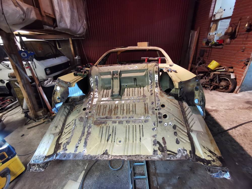

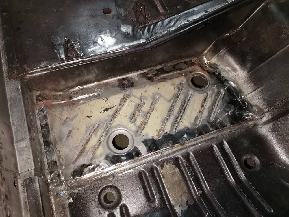

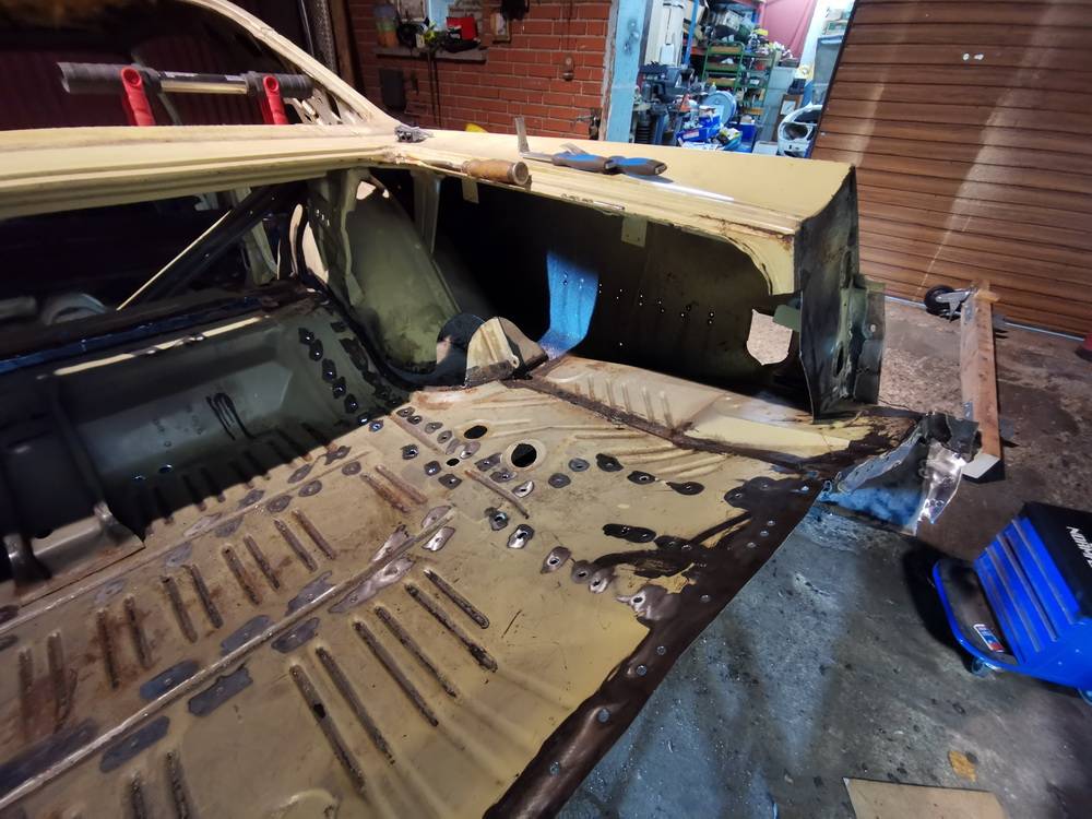

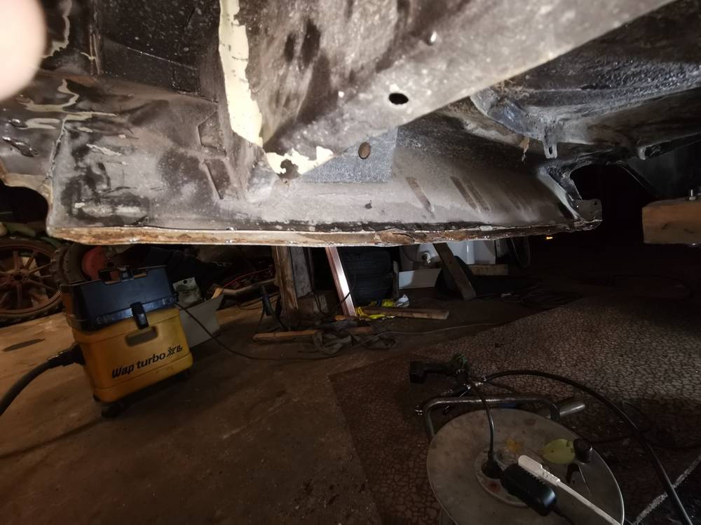

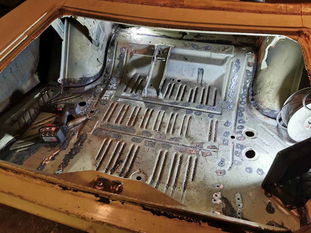

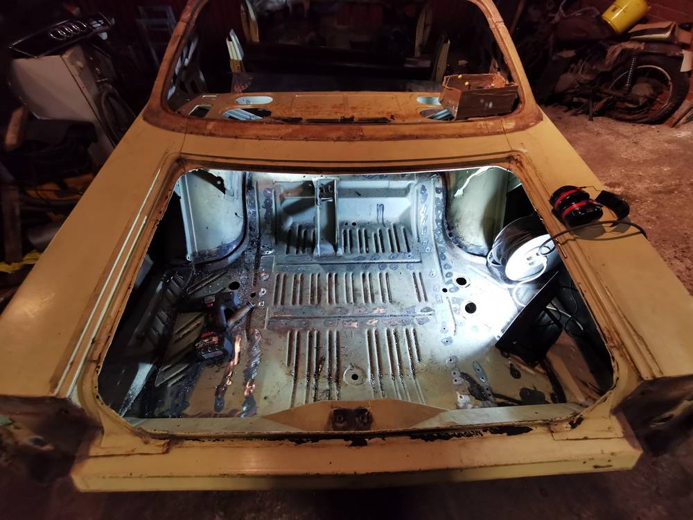

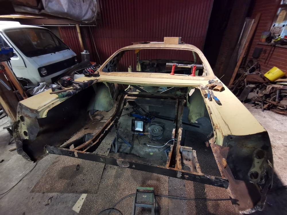

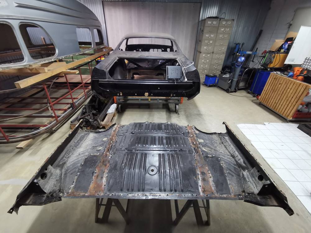

Another weekend of work is over.

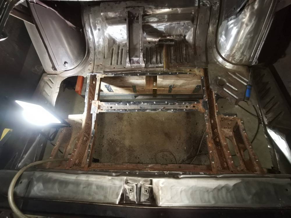

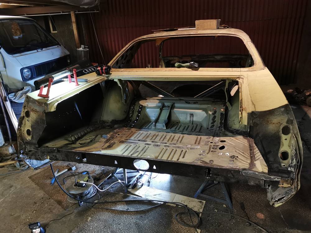

It was laborious but successful. It took me 12 hours to remove the trunk pan with extensions from the car without bigger damages.
View attachment 336138 View attachment 336139 View attachment 336140 View attachment 336141 View attachment 336142 View attachment 336143 View attachment 336144

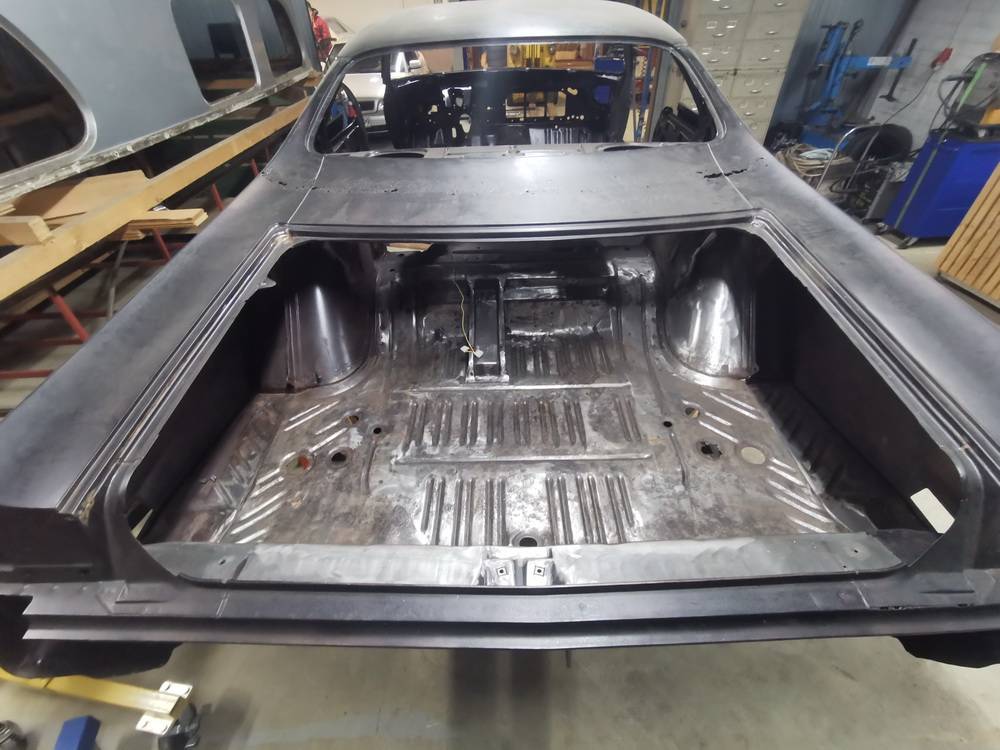

Next is to remove all the unwanted remains of the surrounding panels, clean up the edges and so on and also remove the old trunk pan from my car.

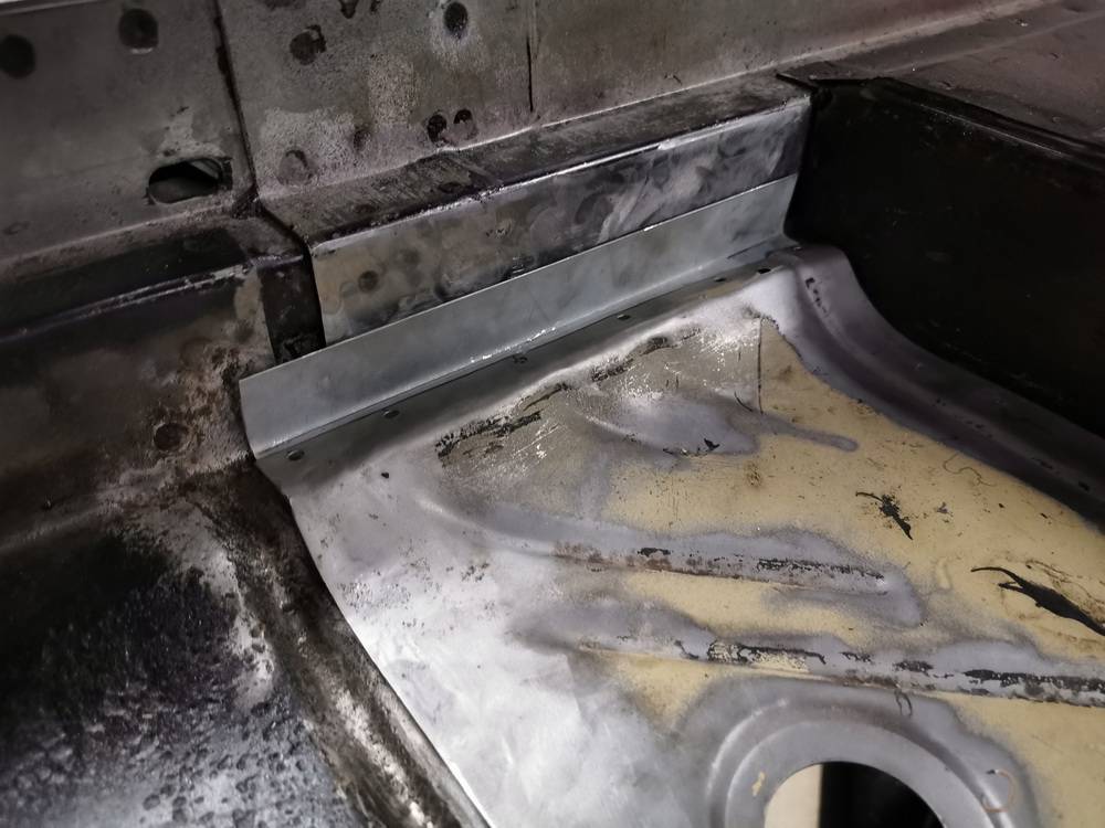

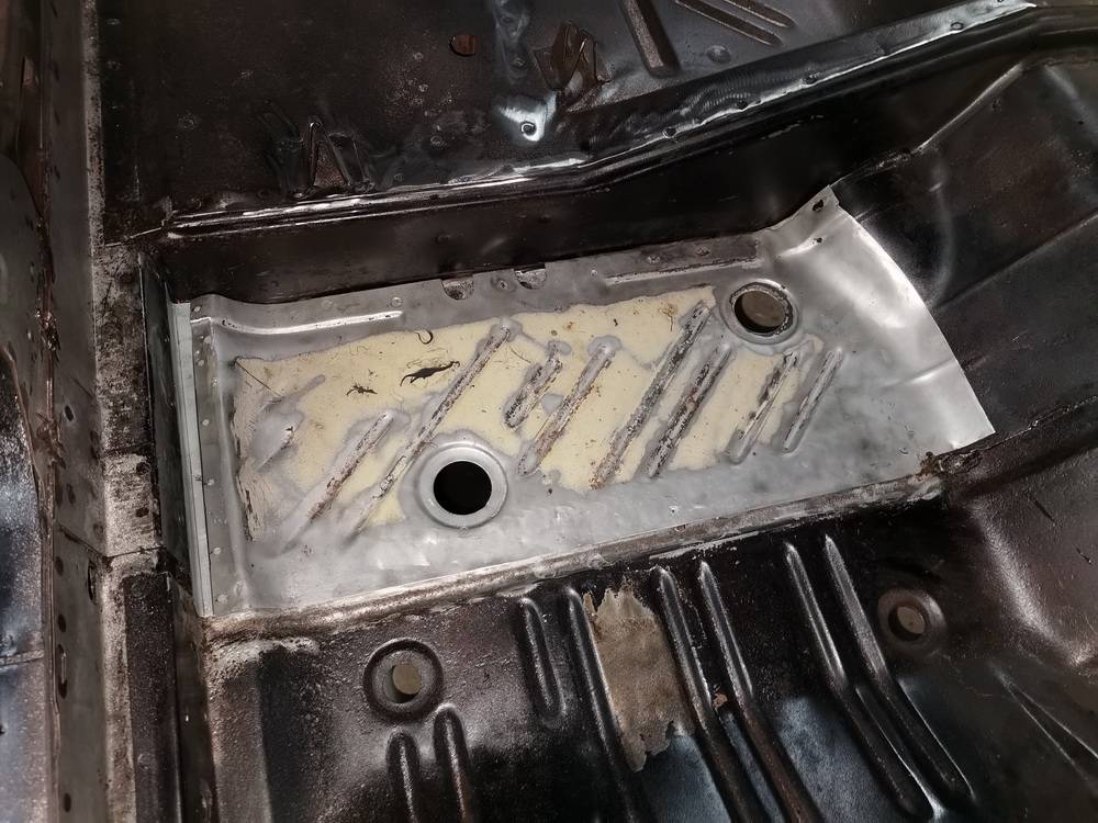

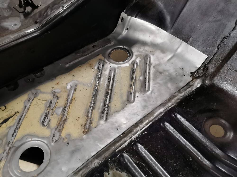

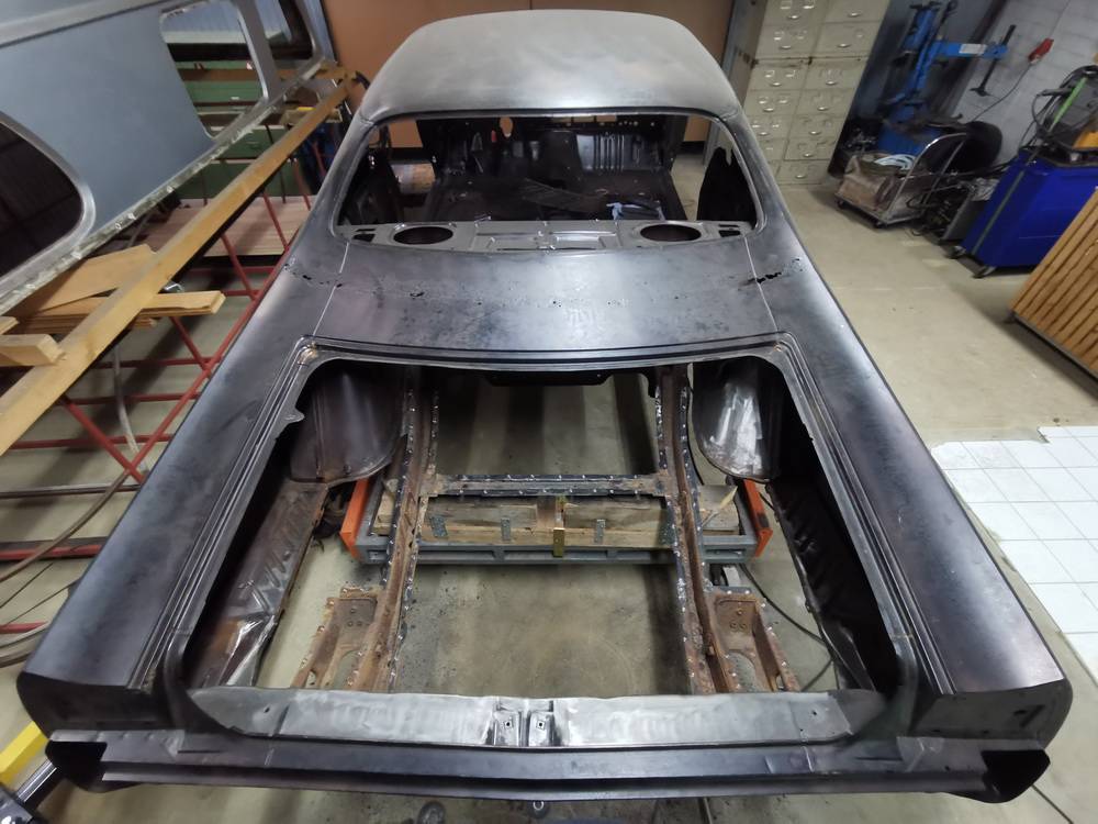

We also fitted the first replacement panel in on the rear right floor pan. Ready to be welded in.
View attachment 336145 View attachment 336146 View attachment 336147
But unfortunately, the weekend was over and I had to drive 3 hours back home.

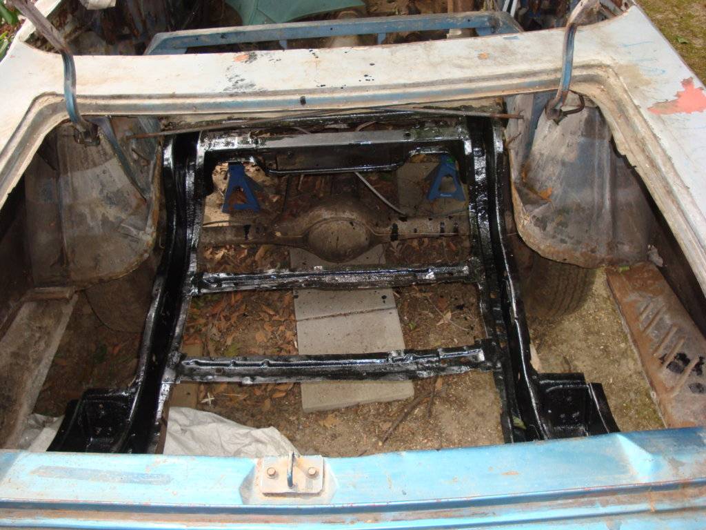

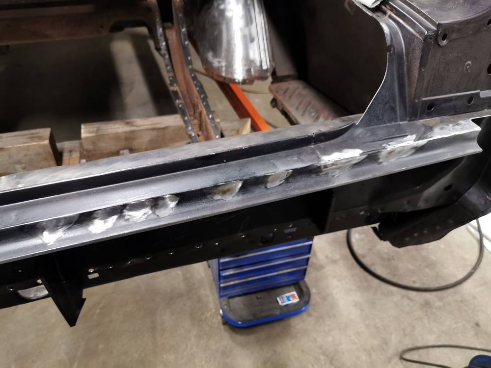

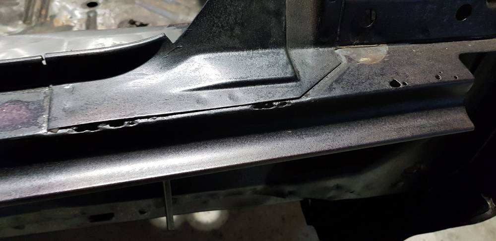

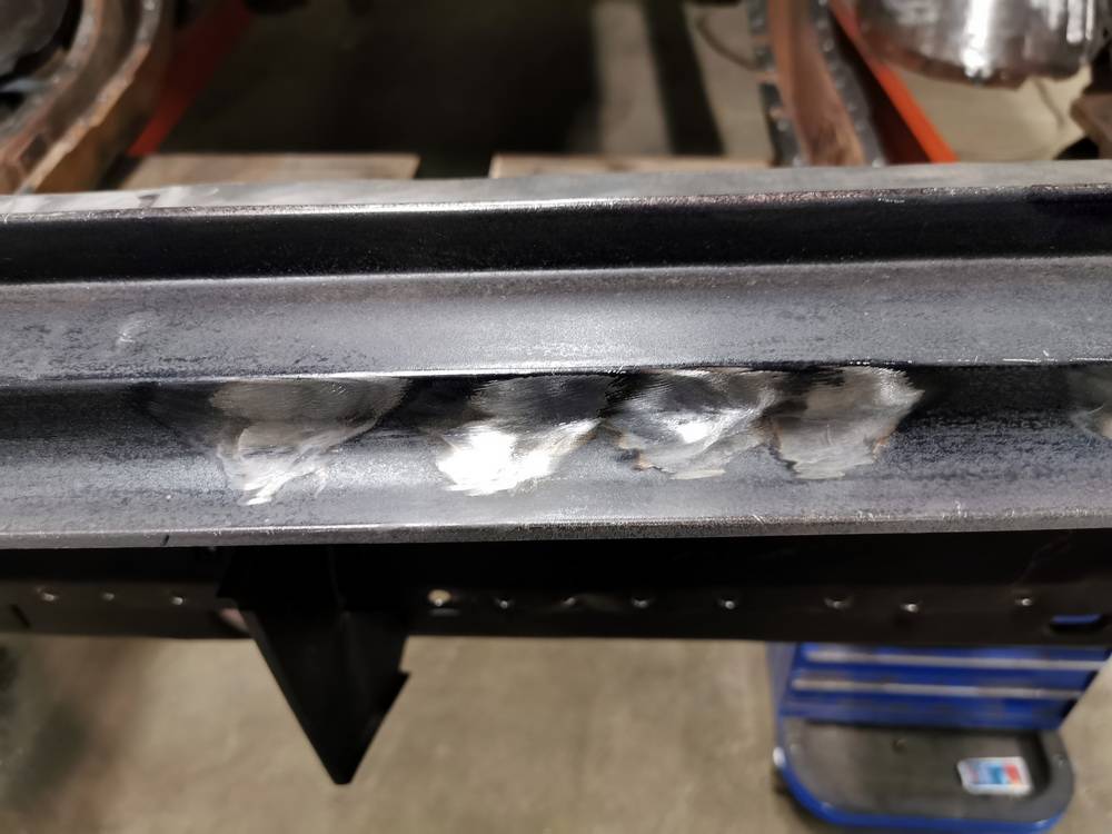

And you welded through two layers of POR15? Or is it other, weldable stuff?I faced the same issue and didn’t want to cut more than I had to, so I made two cuts along the edge of the pan and folded one side. I was able to slip the pan in, unfold it and then weld along factory lines.

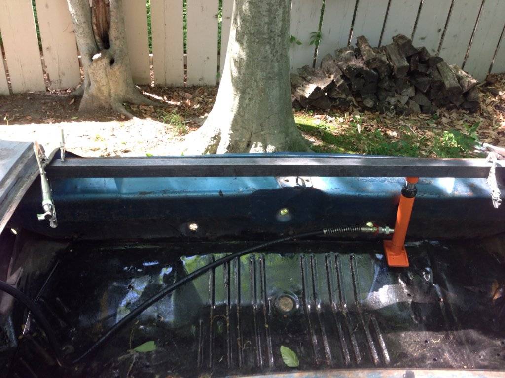

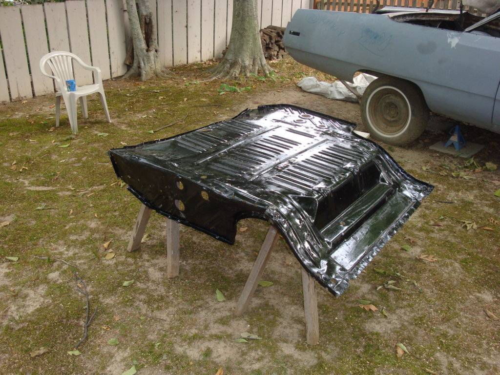

View attachment 344697 View attachment 344698View attachment 344699
The fold is more of a curve. The photo shows it upside down. Once it was in place, it was easy to step on one side and bend it back into shape. As for the welds, I only ground away the small spots to expose metal, the heat from the welder took care of the rest.I'm still not sure what's the better way. I thought about folding it, but I think it's easier to get back to original shape by welding and grinding then by folding and hammering that sheet metal.
I like that press idea! ThanksThe fold is more of a curve. The photo shows it upside down. Once it was in place, it was easy to step on one side and bend it back into shape. As for the welds, I only ground away the small spots to expose metal, the heat from the welder took care of the rest.
It also helped to have a porta-power to hold the metal tight while I welded each spot. I rigged up a piece of angle iron which acted as one end of a vise.

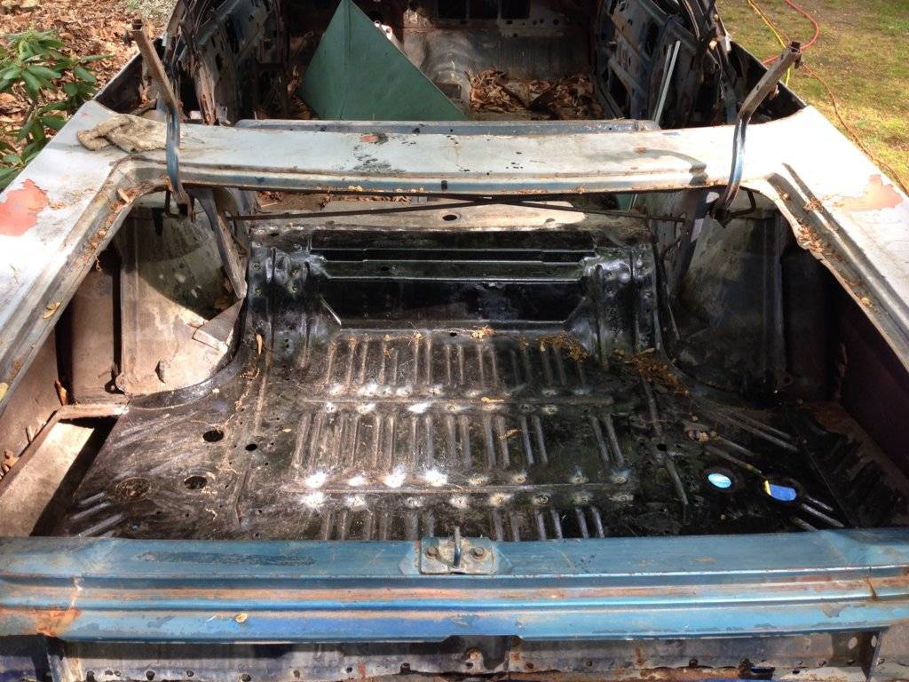

I guess that's one way to get your car into the living room
I guess that's one way to get your car into the living room![]()
I'm guessing he's a single man.The pre owner of my car uses the other way...
I'm guessing he's a single man.![]()
