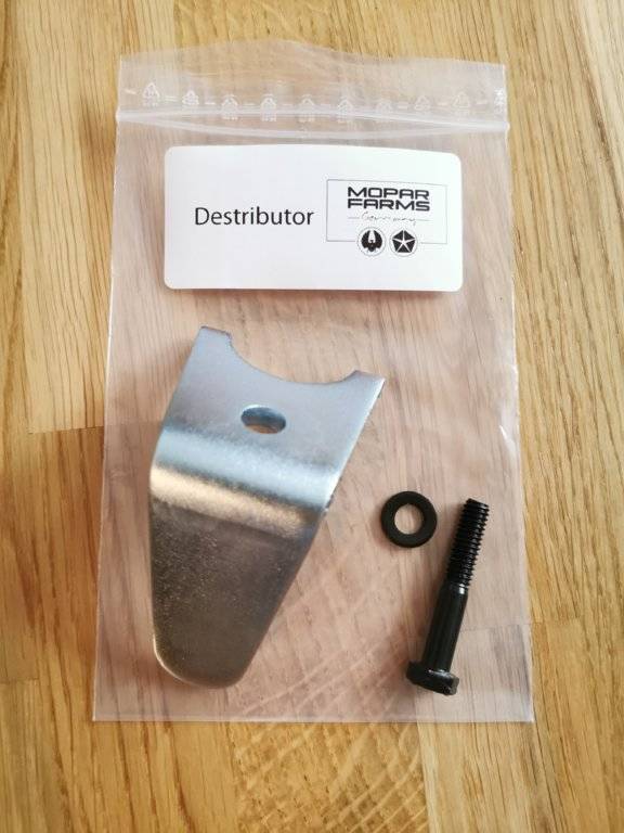

Shouldn't they be in labeled Baggies. :lol:
Like this? ;)

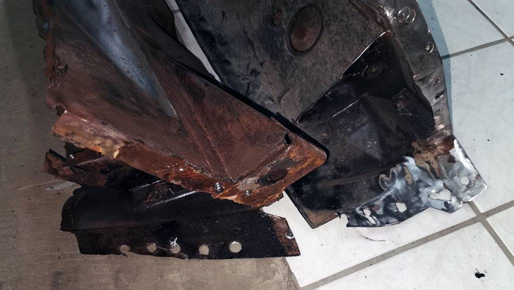

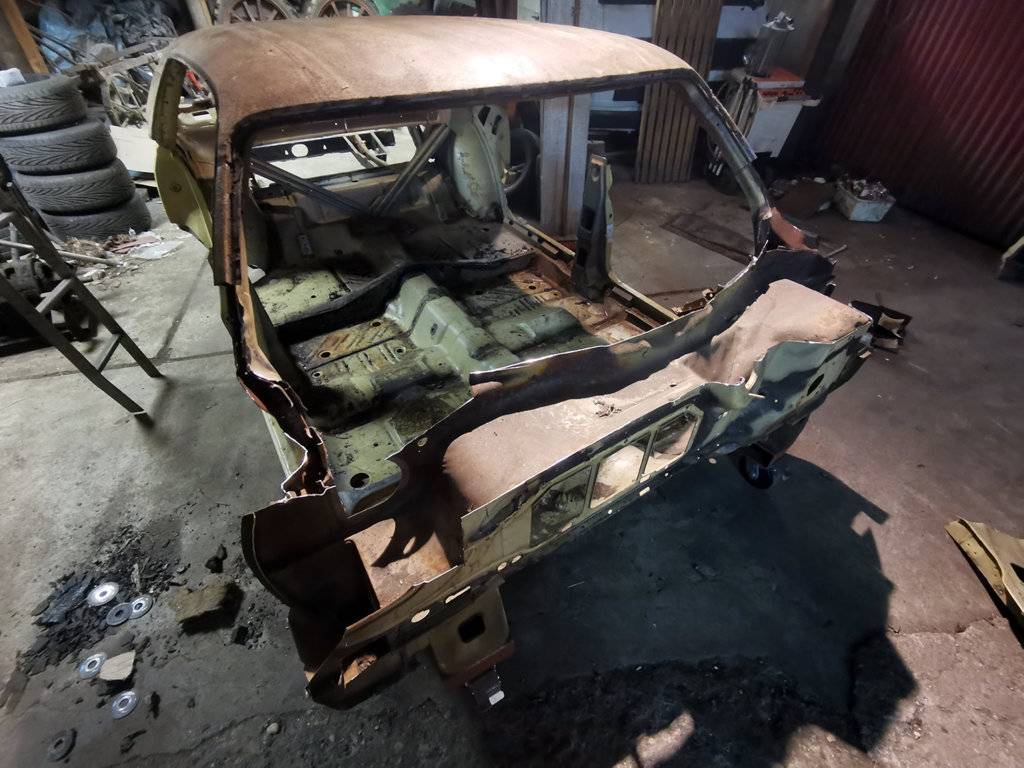

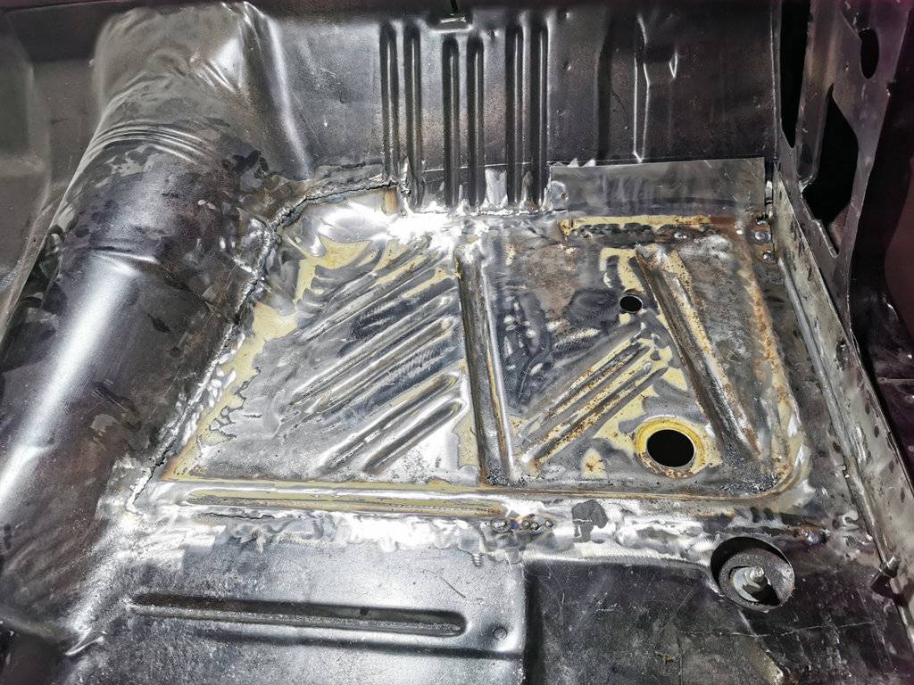

Another weekend full of metal work is over again.

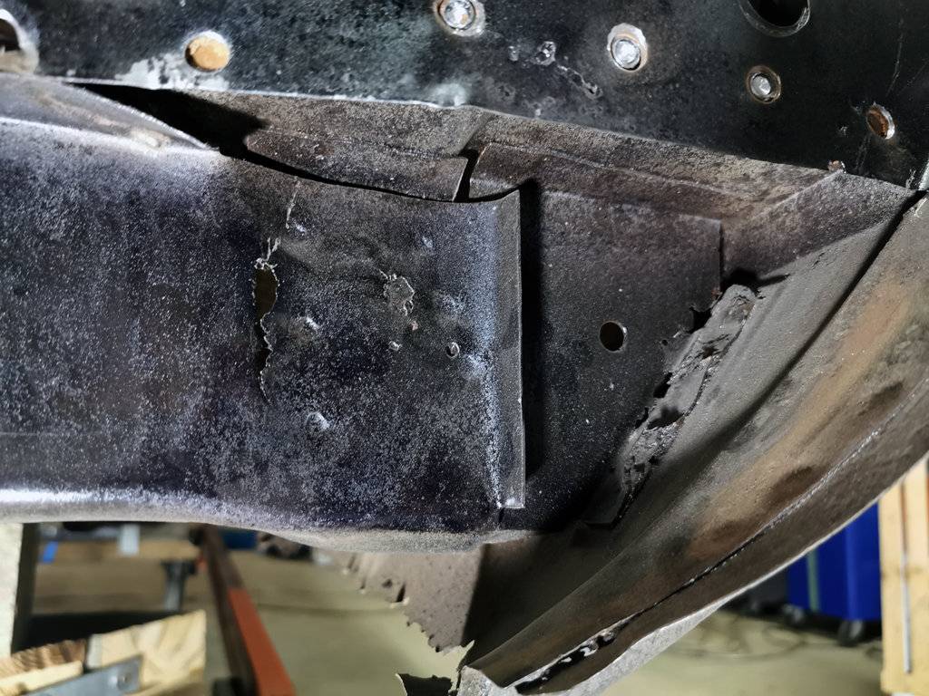

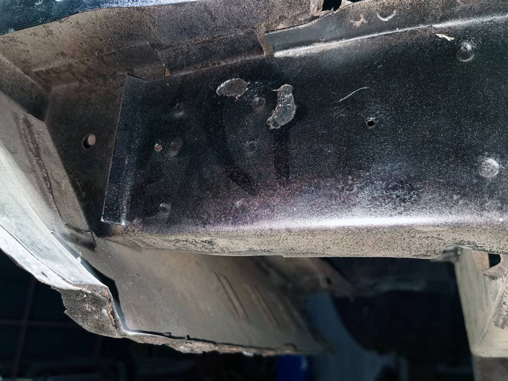

I continued to work on the trunk extensions and their supports under the rear panel.

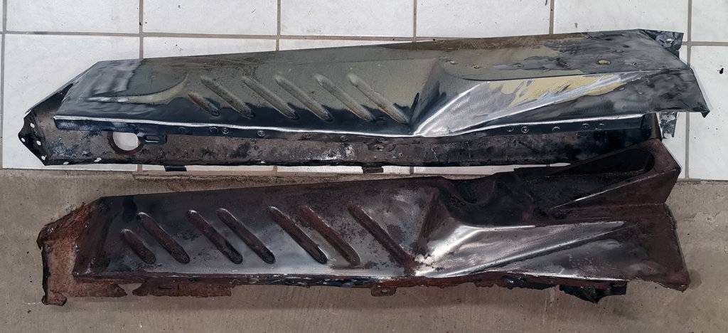

Old '69 extensions vs. new '72 extensions. They are slightly different on top. But I think for good. The old ones had a support (that was not welded to the rear panel) on top, inside the trunk, the new ones have a support box underneath.
And the groove on top of the old ones had no use...
The rear end of the extensions is different as well because the lower quarter panels have a different shape on the '72. But we will adapt that.

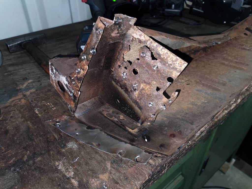

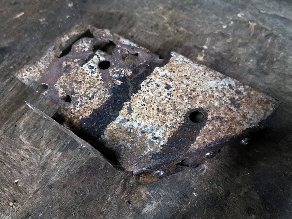

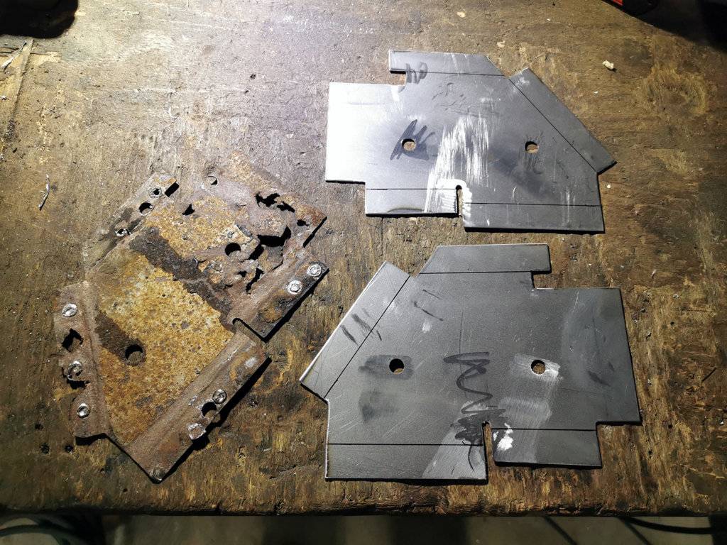

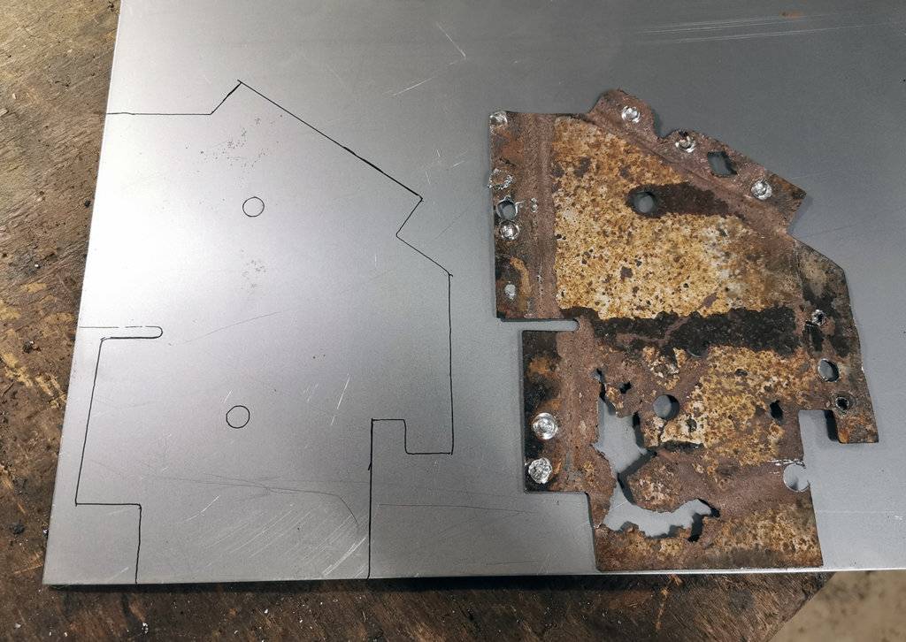

Next were the ends of the rear supports itself. They were not salvageable...

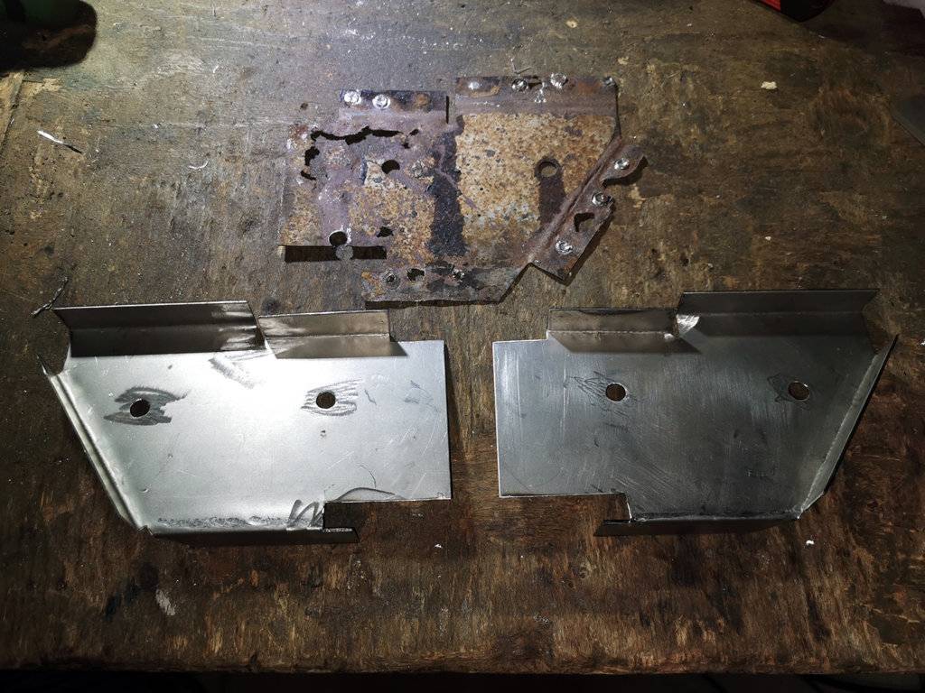

So I made new ones from scratch.
They came out pretty nice for my first self made sheet metal parts I think. :)
