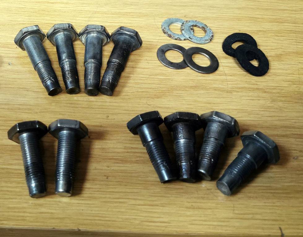

The seat belt bolts look OK to me. The threads are cut shallow on one end and taper up to a full thread. This is so they cut their own thread when threaded into the anchors on the floor.
Term for this is "self-tapping" bolt.
If you do want to replace them, they are available, but pricey. I used Mustang repop bolts in my Barracuda because they were exactly the same, but one third the price.

Indeed, they have very shallow threads. Unfortunately, that's a bad thing when they are rusty as well. Not much thread left on some of them :( I will look into the mustang ones! If they will fit, I would use them. Thanks! :)

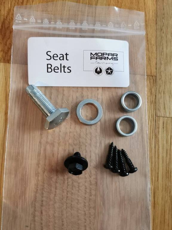

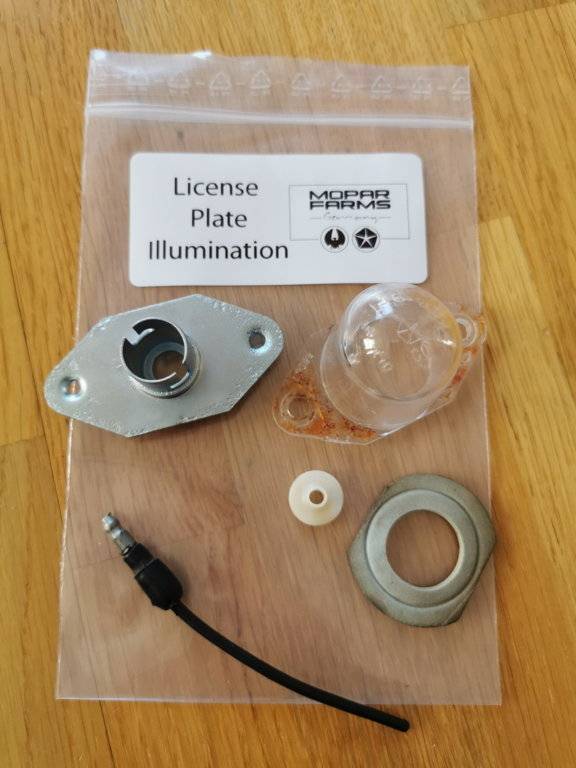

All of your pictures are a great reference. I was just able to identity some of my unknown parts by looking at your bag labels. Which begs the question, why are the labels in English and not German??

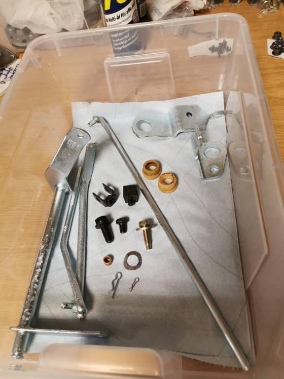

Here are some things I'm missing parts for or looking to replace. Maybe someone can help me out with these?
I'm missing the small spring for the Cruise Control Brake Switch.

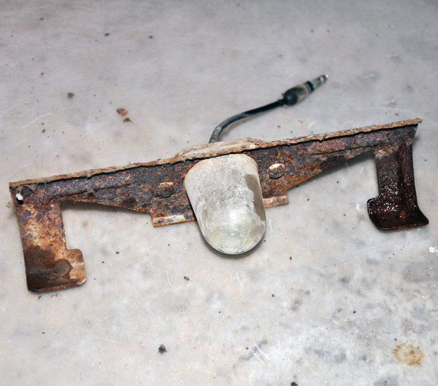

The bracket was too rusted to reuse.

Most of the threads on the Seat Belt Bolts were too ruste to reuse.

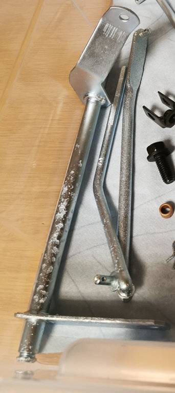

The Shift Linkage has deep pitting on it. It works, but I would prefer to have rust free ones.

I may have a number plate light bracket for you that has no rust at all, let me check my parts stockpile for you. will let you know tomorrow.

So that you are able to identity some of your unknown parts by looking at my bag labels. :p
And, maybe, because that are the names from the FSM. Makes it easier if everything is in the same language.
