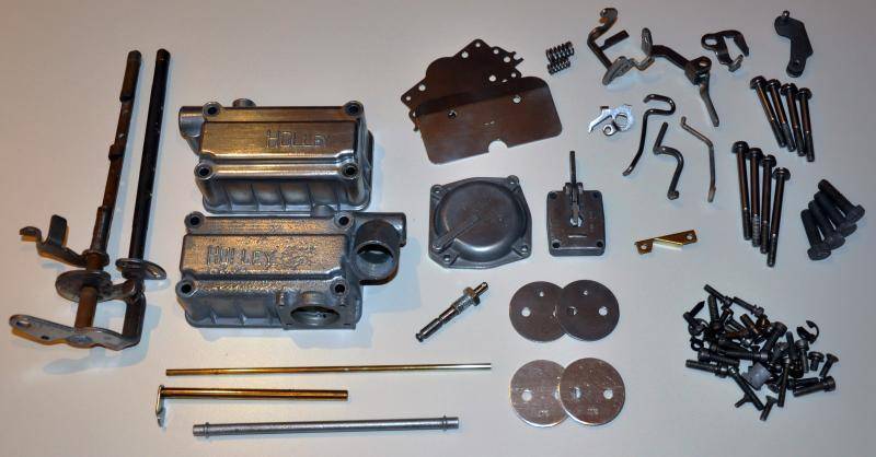

I trust your experience but I have all rebuild parts already, so I'll give it a try! I have cleaned most of the parts already and when I'm done with that, I will put it back together and then we will see.
No reason not to. With all the work you're doing, it's not like rebuilding the carb is a significant increase in the total size of the job.
And by the way, those urine-soaked parts are good candidates for vinegar soaking.
One additional warning, however: vinegar is also used to remove zinc for cleaning before welding. So not only will you be removing any rust, you will be removing any zinc protective coating. That will mean it will rust very quickly again, and if you are going to be a stickler for originality, you will have to figure in re-coating.

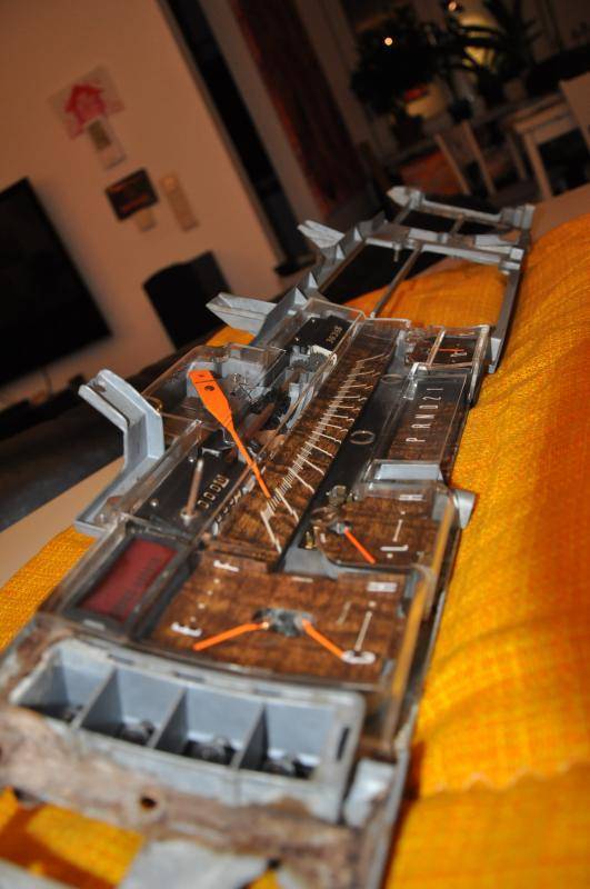

Damn Mice, they've eaten everything... The instrument panel, the vents, hoses... Everything -_- And of course, they pissed and shitet everywhere... That's something I have'nt expected...
My. . . My. . . My. . . The Spring Carlisle meet is in two weeks. I'll keep an eye peeled for a dash board for you.
Correct! I'll will try it. I gonna continue night now with the baseplate ;)
Good to know that vinegar removes zinc as well! But I'm not really one of these originality guys... I have absolutely no problem with painting hidden parts flat black or some thing like this!
Damn, they sure made work on your dash! I'll keep an eye out for potential parts cars for you. It looks like you may need a complete instrument cluster and clock, from the appearance of the parts.
I will try to redo most of the original parts because that's what I like! But for some parts that are too far gone like the clock which fell apart by touching it have to be replaced...

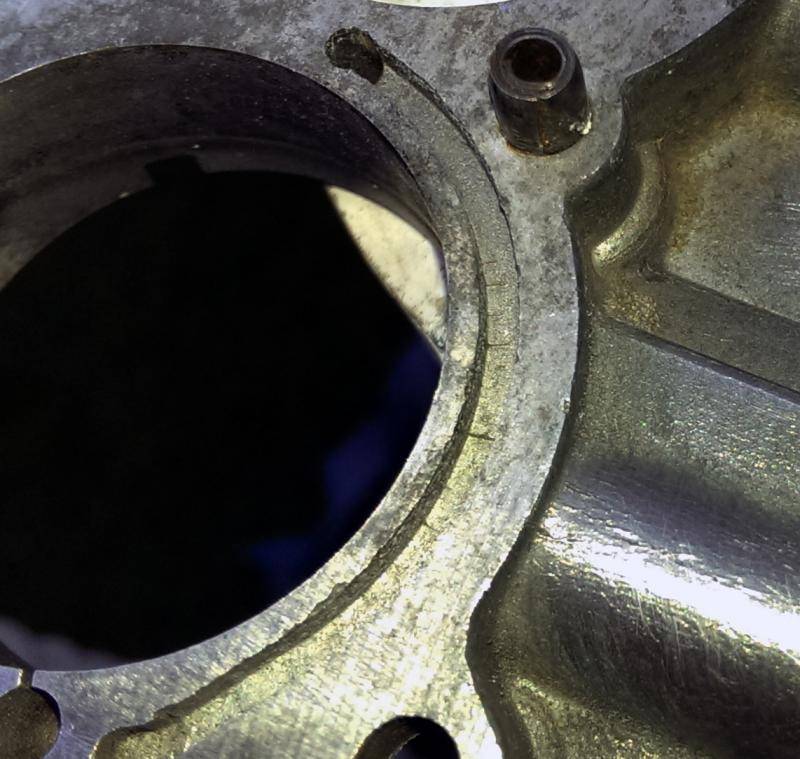

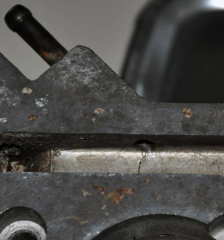

I found a crack in the base plate and inspected it closer and found more cracks... :(
Is this thing shot?
Hair cracks around the tube seat...
...and a few bigger cracks

I started to clean the instrument cluster. Doesn't look that bad in detail.

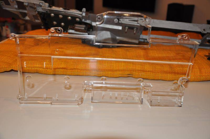

Great work on the dash lens and the carb parts .. I'd still get a kit and put it back together.
As long as those cracks don't allow a vacuum leak no worries
