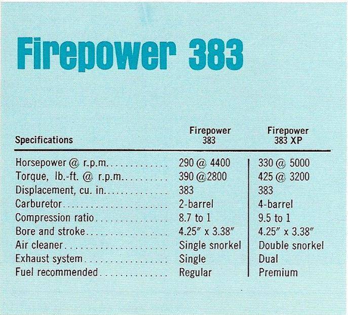

Premium fuel was recommended for 4bbls.

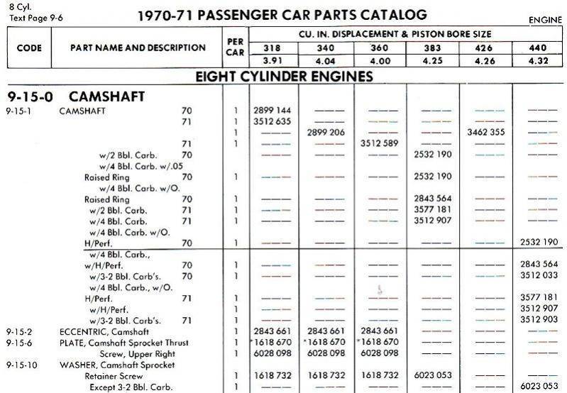

Cam 2532190 was used for 383-2, 383-4 LP and 440-4 LP
Cam 2843564 was for 383-4 HP and 440-4 HP
