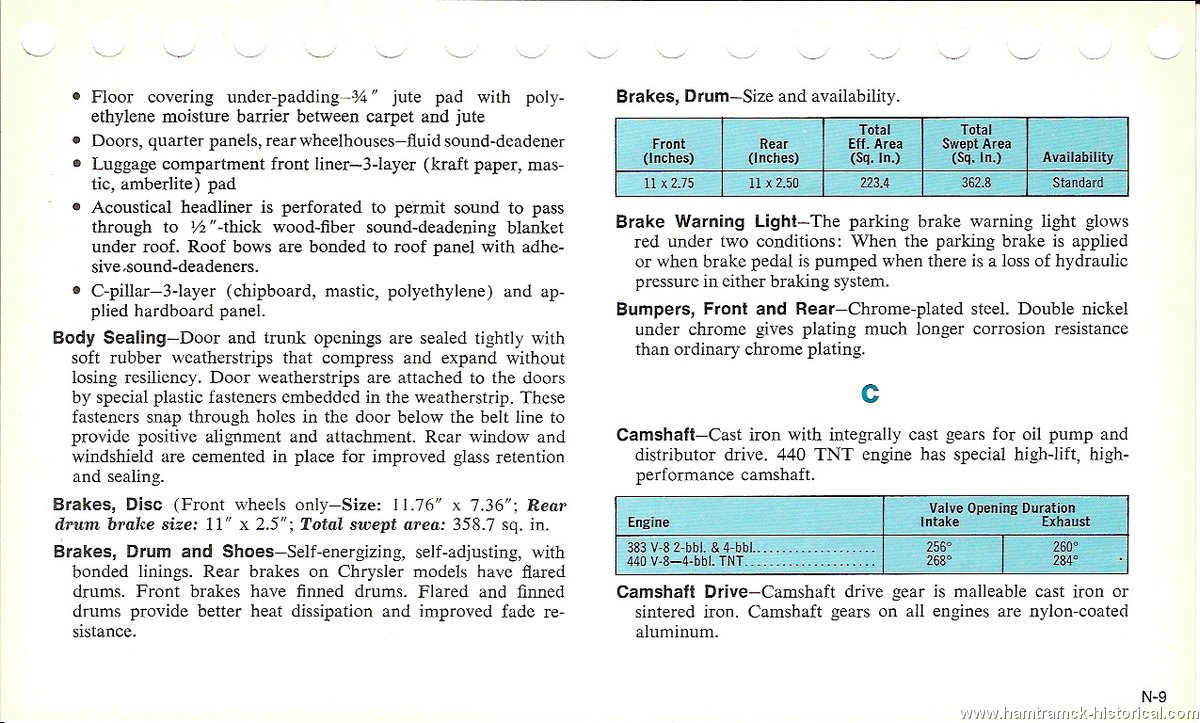

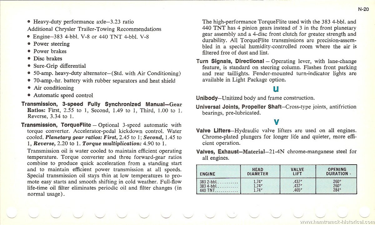

Who said the same cam was used in in the 330 and the 290 horse engines?
Straight from the 1970 Newport data book - 290hp and 330hp specs are the same for heads and cam duration.

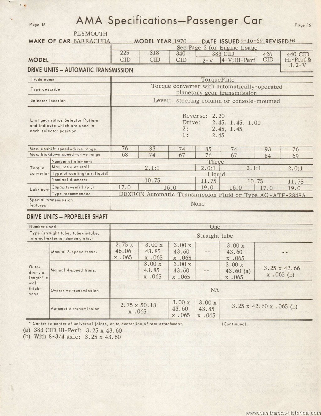

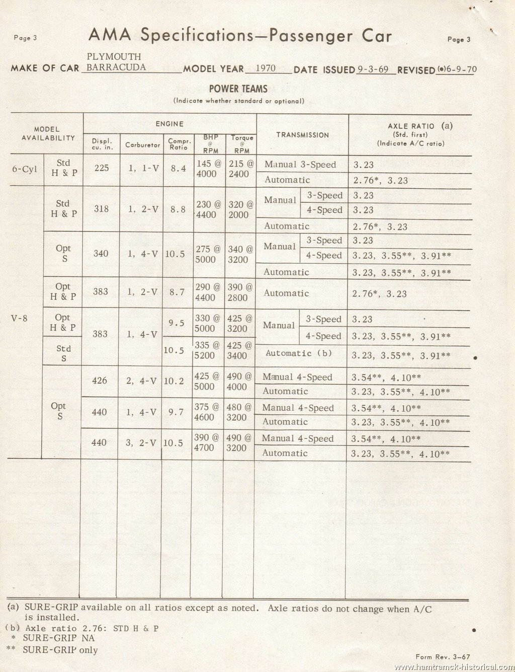

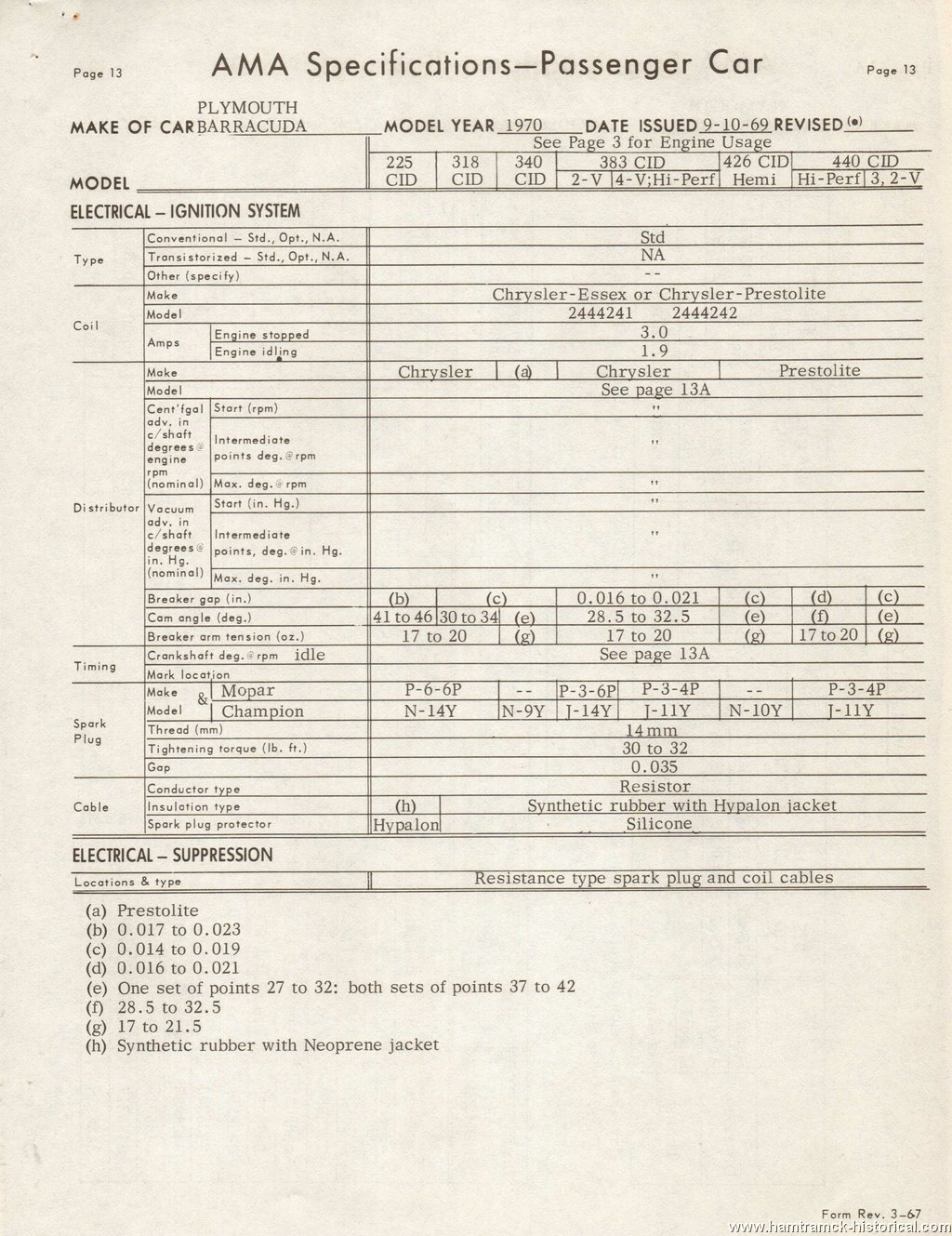

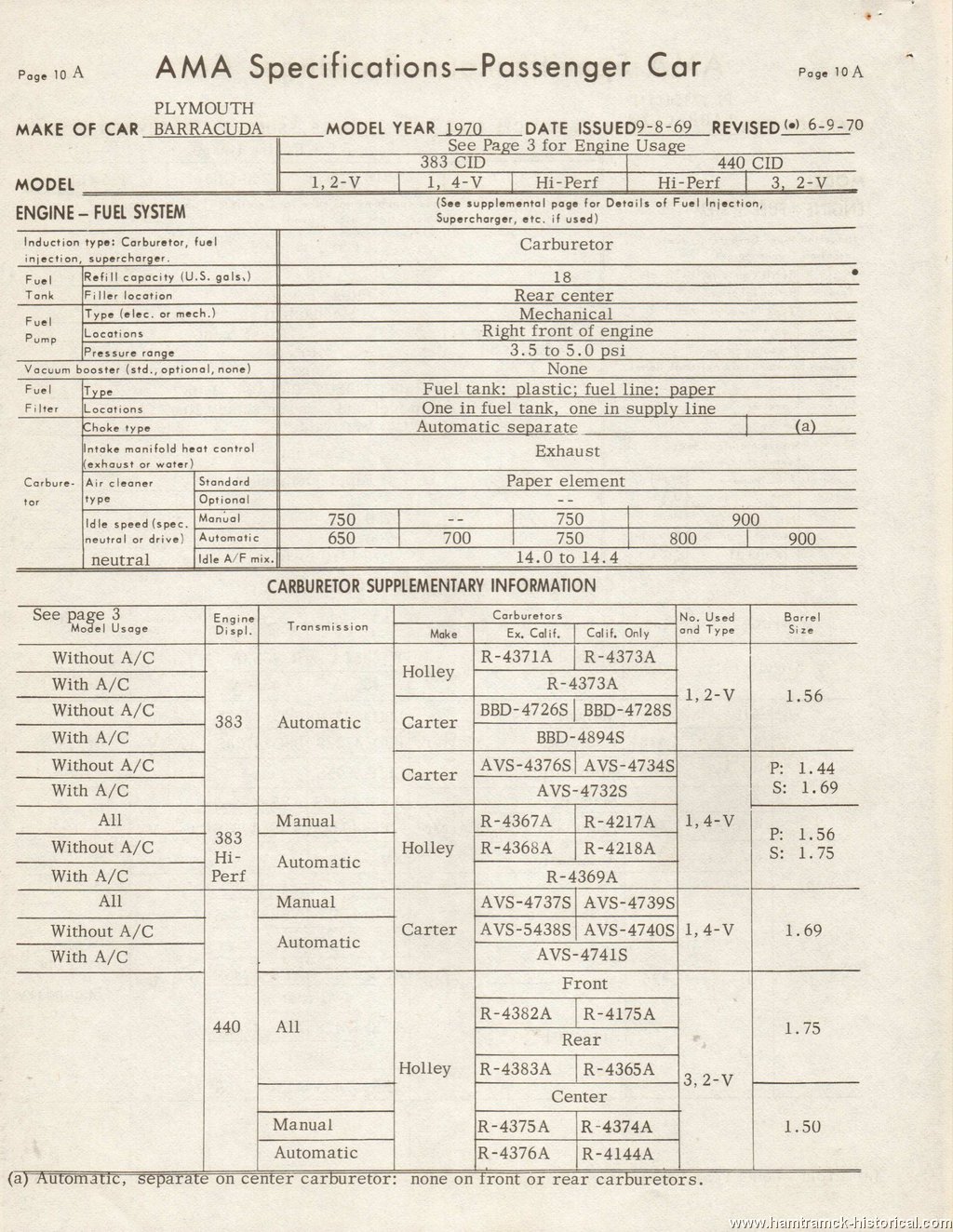

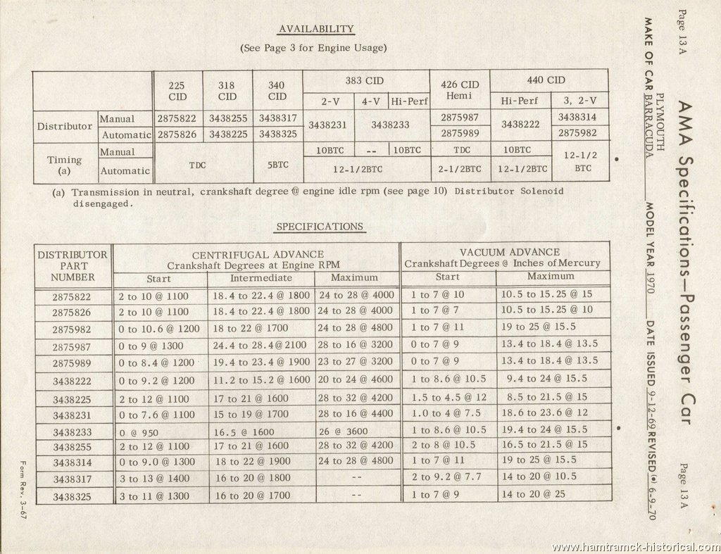

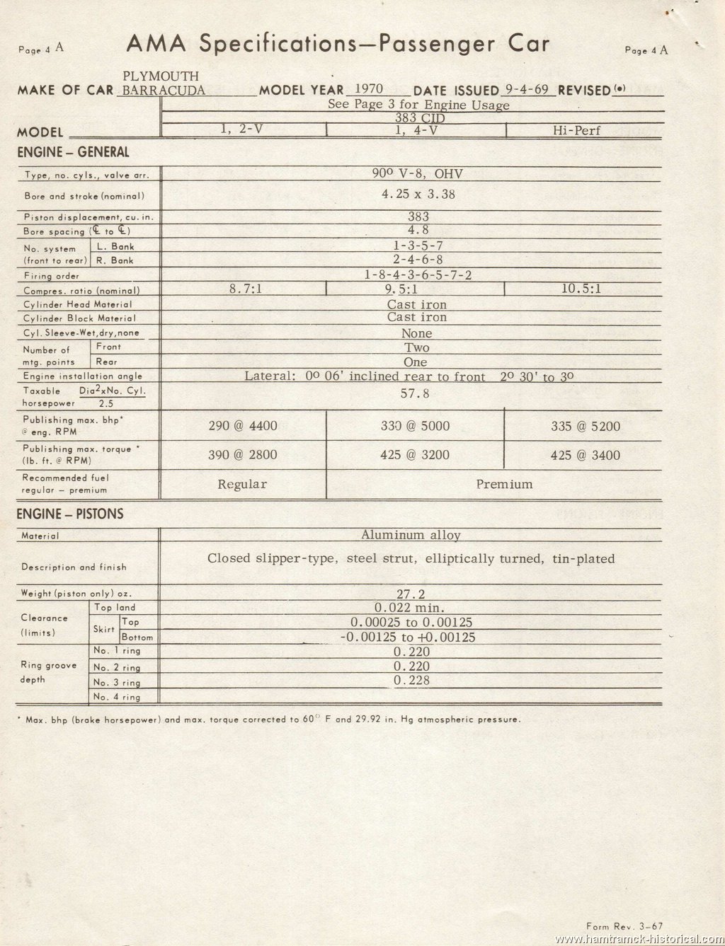

Maybe even more interesting is this in the 1970 Barracuda AMA Specs - 335hp motor has 10.5 compression, but also a 200rpm higher rev. Below are all the engine differences I see on these sheets.
I'll put my head on the chopping block and offer the axe to anybody that wishes it.
I have interpreted from all the official literature this:
In 1970, the year we are focusing on because we are talking about the 1970 Newport Cordoba for sale,
The 383-2 and the 383-4 330 hp. engines used the same cam.
The 383-4 HP 335 hp. engine used a slightly hotter cam from the 440 (which one, I do not know as yet).
The 383-4 HP 335 hp was avail. with and w/o A.C.
The 383-4 HP 335 hp was avail. in B & E bodies only.
Anyone that wants to swing the axe?
