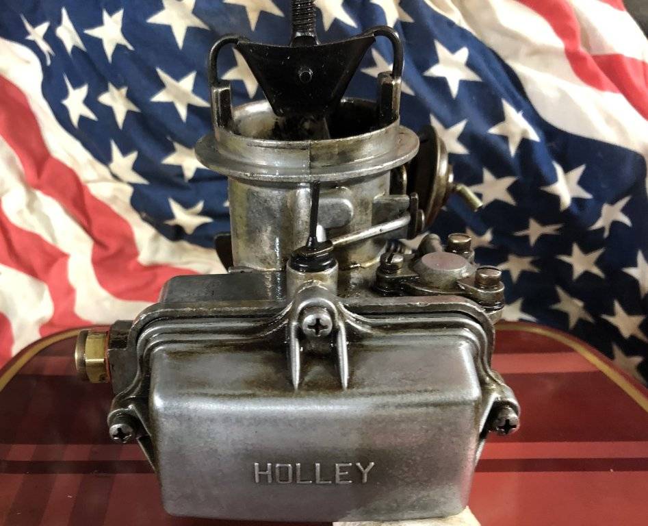

The carb is ready to go!

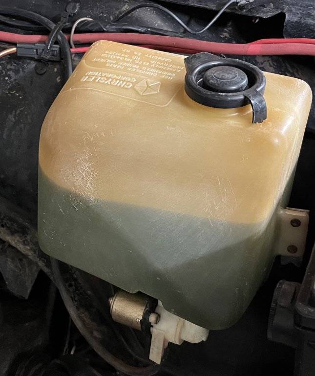

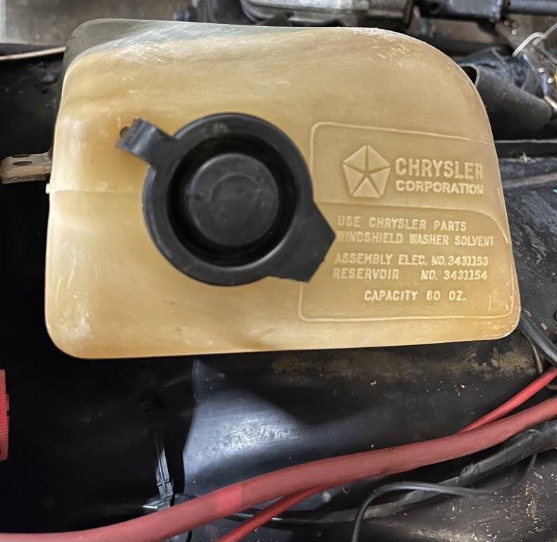

FINALLY!!! Somebody found a decent Washer Bottle.....Nice save on this Fury, too! [one note on the "Care" of the washer bottle; Don't immerse it in hot water and Dawn dishwashing liquid. The plastic will turn from its milky white color to a see-thru clear, and then the bottle will shrink and crack into 20 pieces right before your eyes. I think the hot water is the real the enemy. But, after that happens, it may take several months of therapy to right yourself.]
Good luck on the project! -Not Right
Thanks for the advice! This one still feels pretty tough. Most of them I’ve had are fragile as an egg shell. I cleaned it up with cold soapy water and a Brillo pad today. I also sanded the motor and painted it with some gold paint. I think this is as good as it can be. It’s functional so that’s a plus!

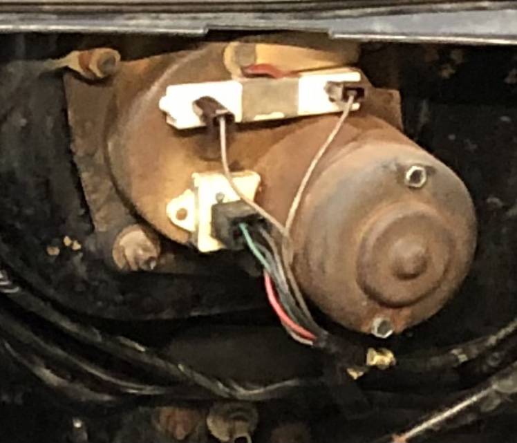

I’m working on it. Gave the wiper motor a little lovin..
Most of this paint had long ago flaked off. What remained came off easily.
I probably only put slightly more effort in painting it as factory did.
Semi gloss was used with no primer after scuffing it with 320 grit.
