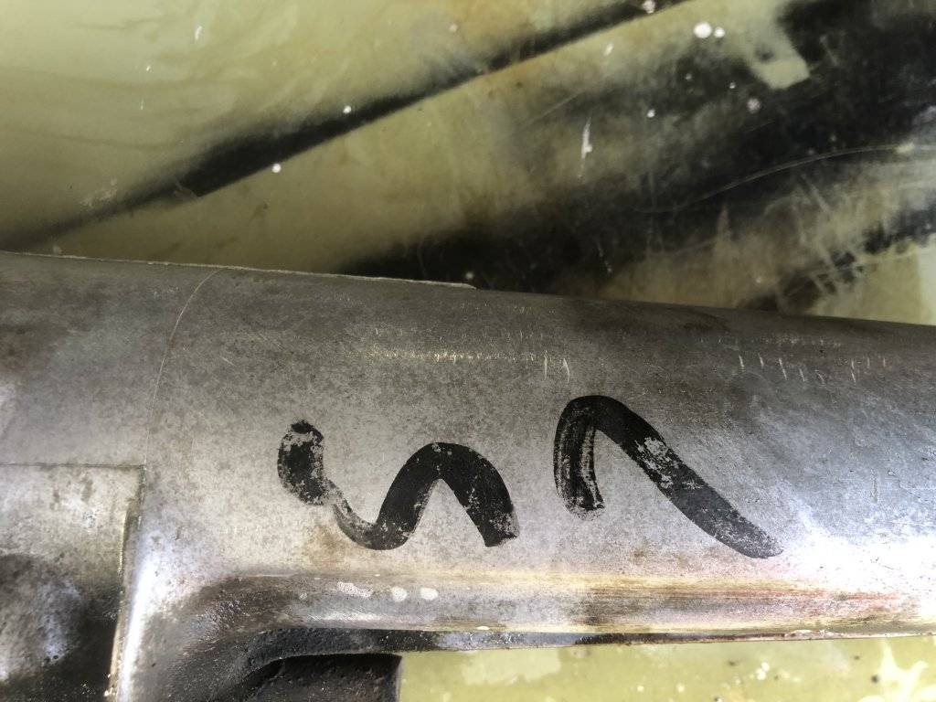

I’m going to install the engine and transmission together. I noticed some factory markings that the meaning of I don’t know, not that it matters.
I believe when the engine was painted at the factory the bell housing was already bolted to it and they got overspray on it. I duplicated that effect the best I could.
Did you purchase the stamps and put the 169 back on the trans?
And reapply the hand painted 57 on it?
Those marks are all the rage with the e body crowd.

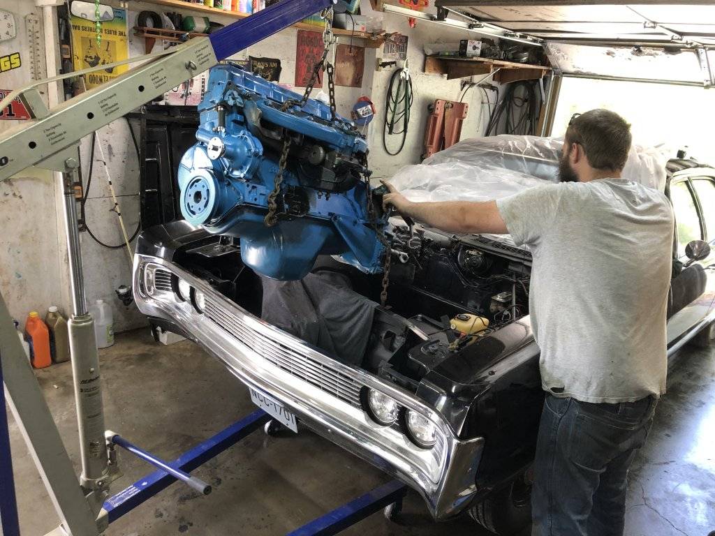

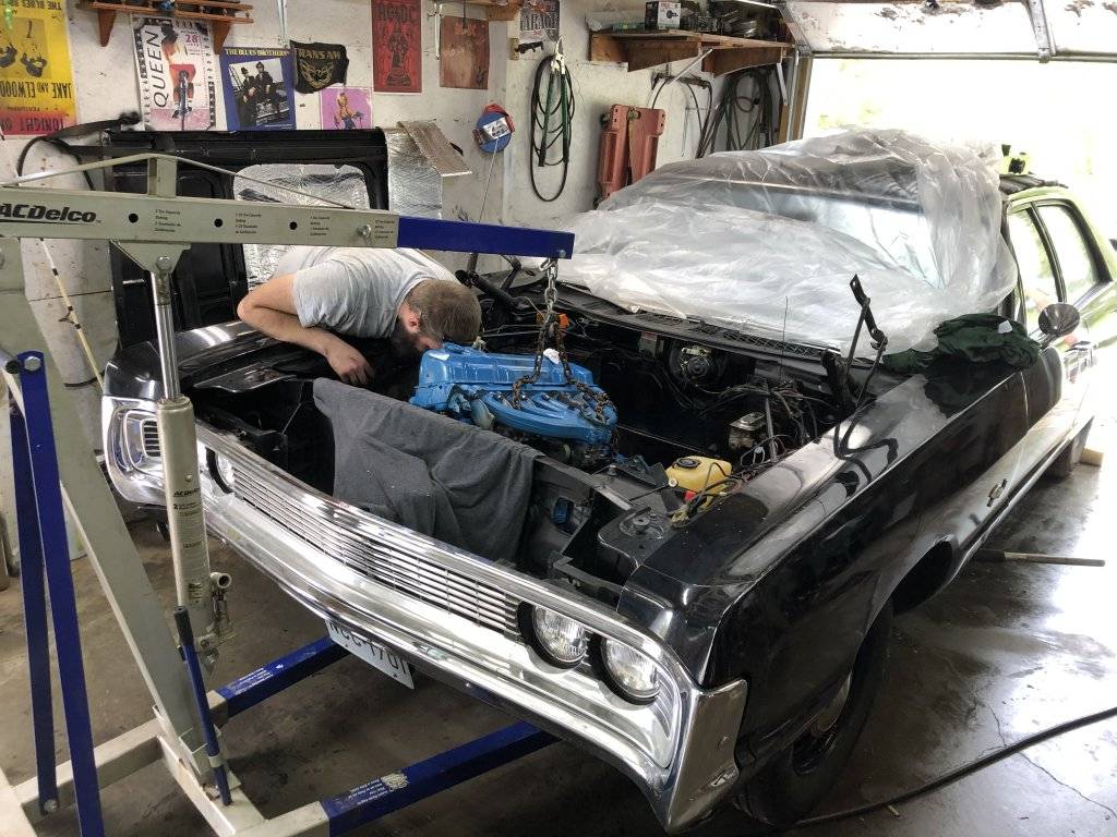

For some reason this engine looks more intimidating to install than a V8. Nonetheless, we’re getting ready to put it in place.
You may get the impression that my son is doing the work while I take pictures. Wrong! I’m also supervising!
That kid is good. I’m doing QC and safety too.

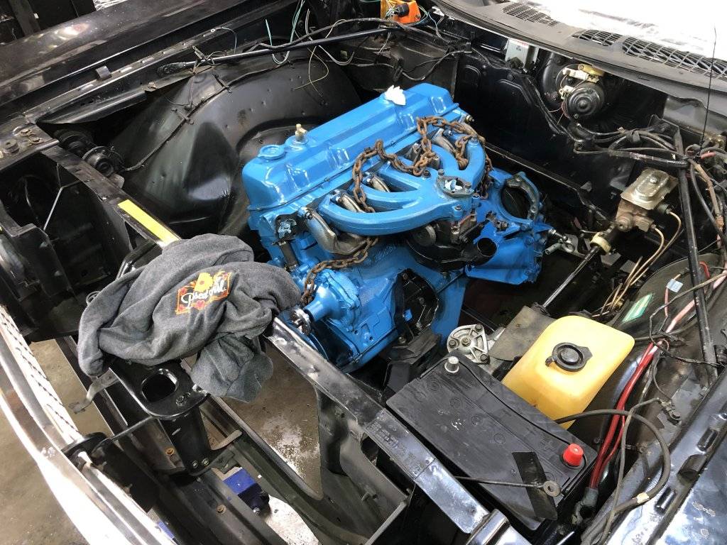

Far as we got tonight. Everything underneath is done. Mocked a few things up, cranked it over till we got oil pressure and called it a day. Back on it tomorrow. Don’t worry I’ll be adding the fuel filter before start up,

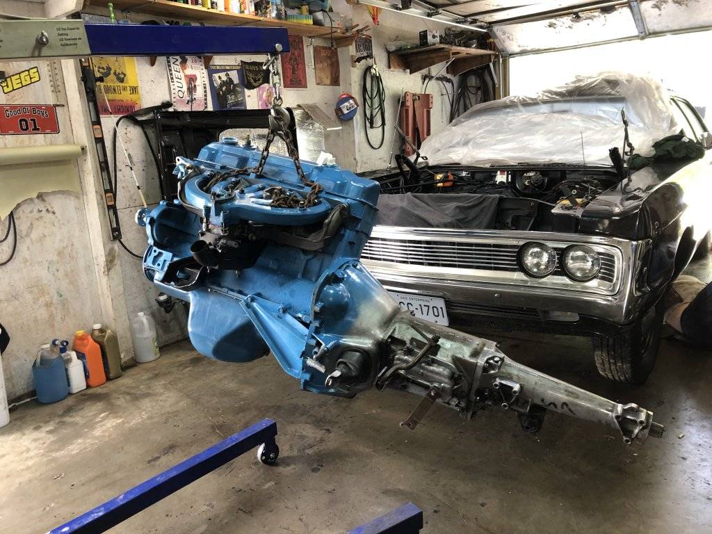

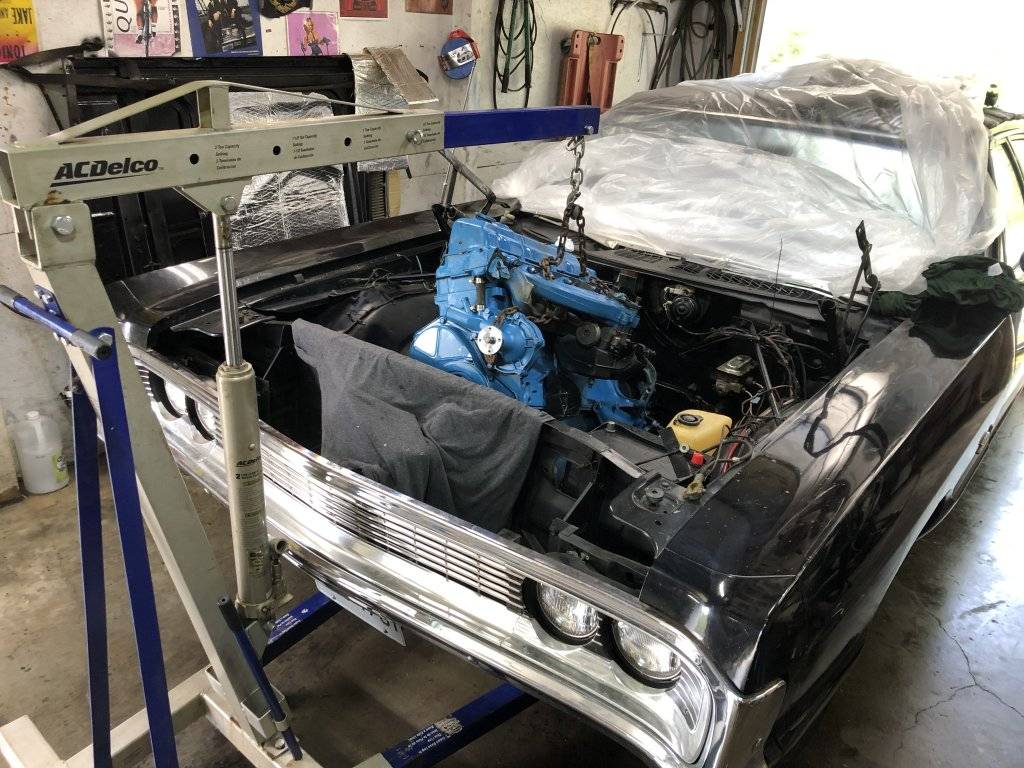

Looks like it sort of dangles on a slant but not quite enough, thus you had to slant the car so that they could mate just right...?
Excellent.
It’s a little tricky.. the length is the bigger problem. But after it’s in enough to set down , the drivers side mount hits first, then it hinges over to the passenger side. Would have been easier without the transmission but I didn’t want to wrestle it on from underneath. It wasn’t bad, actually.

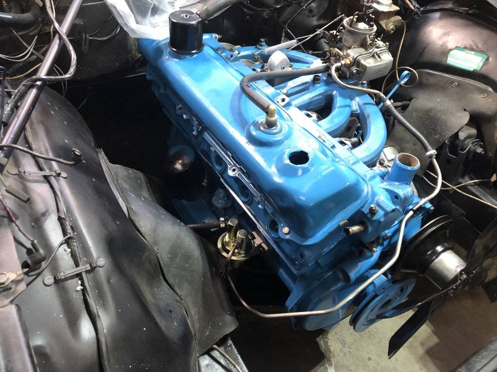

It. Is. ALIVE!

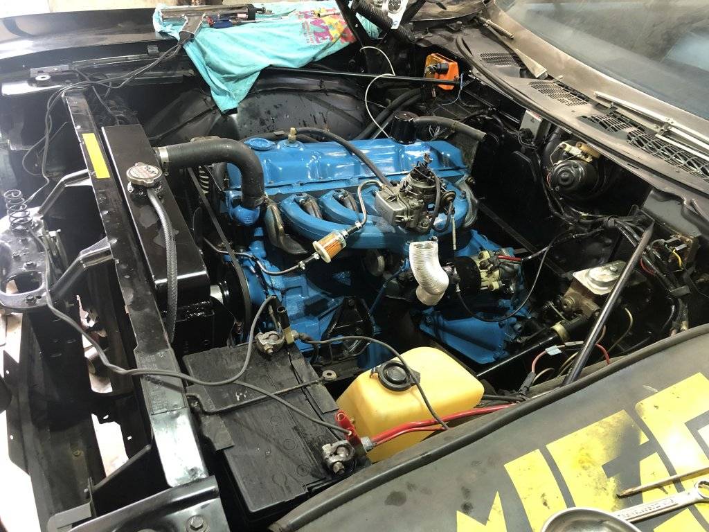

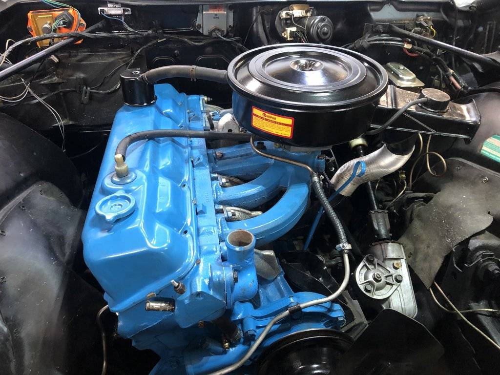

Started right up with no issues. I’ve run it at 2k RPM for about 5 minutes, let the thermostat open, idled it down and adjusted the timing and carb. I’m letting it cool down and taking myself a break. Later I’m going to change the oil and finish breaking it in.
It sounds great. Starts really easy. Has a throaty exhaust note.
I’m using the plugs and wires that were on it when I dragged it in. The wires are factory and so stiff they are like pre-formed. One of them a mouse has chewed on so I taped it up. Ive got some ordered for it.

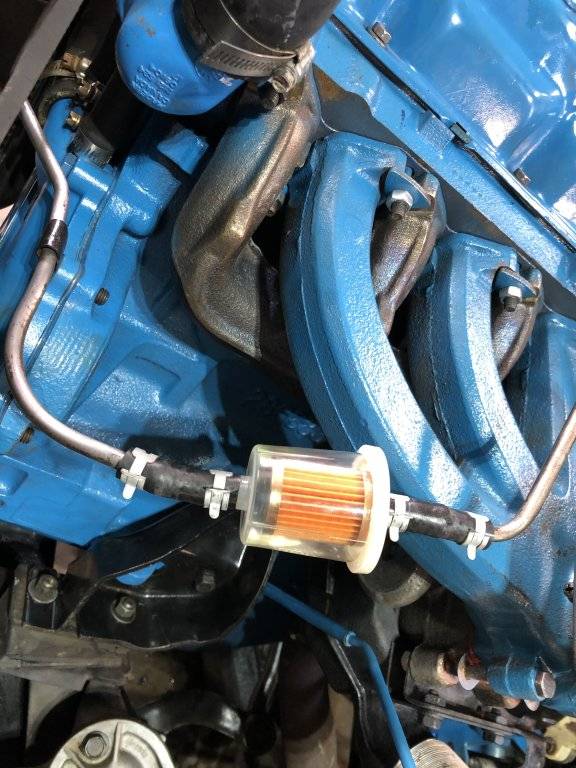

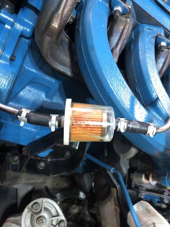

Uhm.. don't you have that fuel filter on backwards?
Lawd have mercy! Thanks! The fuel system is all new so I got lucky. My dumb *** was more concerned about having the clamps all facing the same way! Fixed it.
