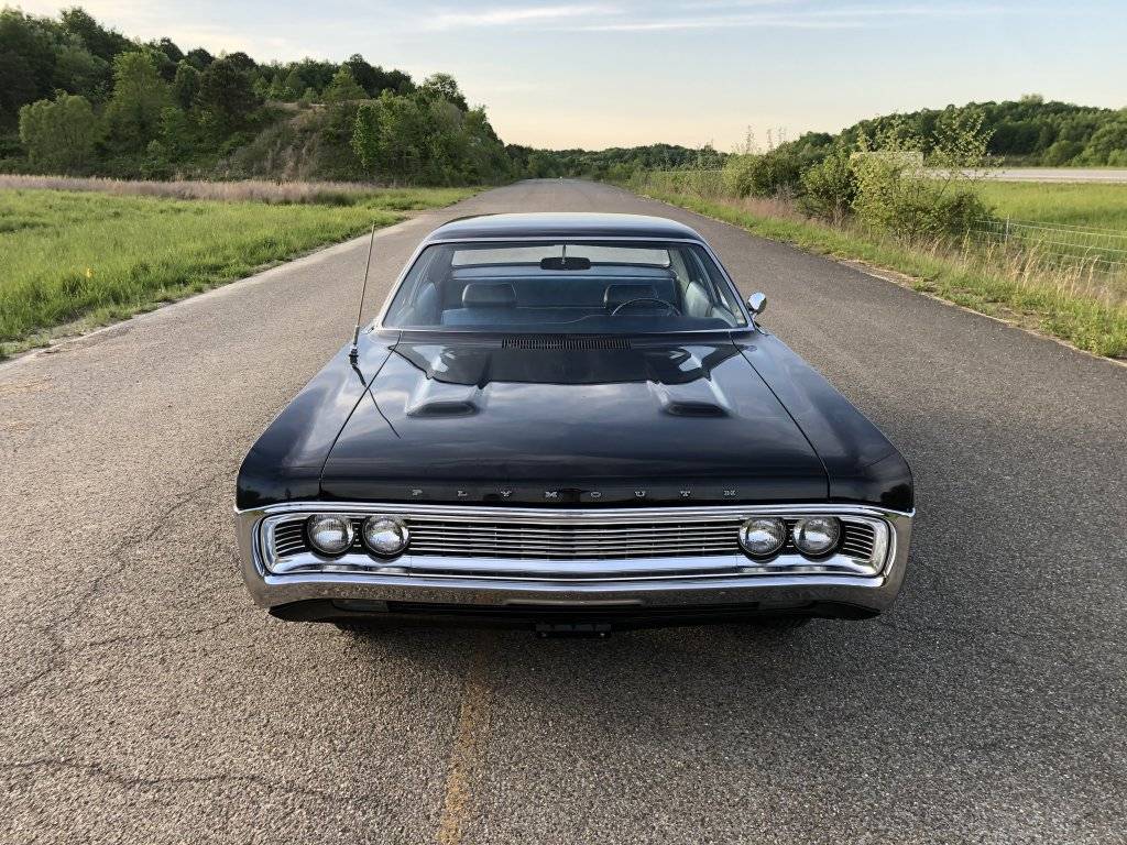

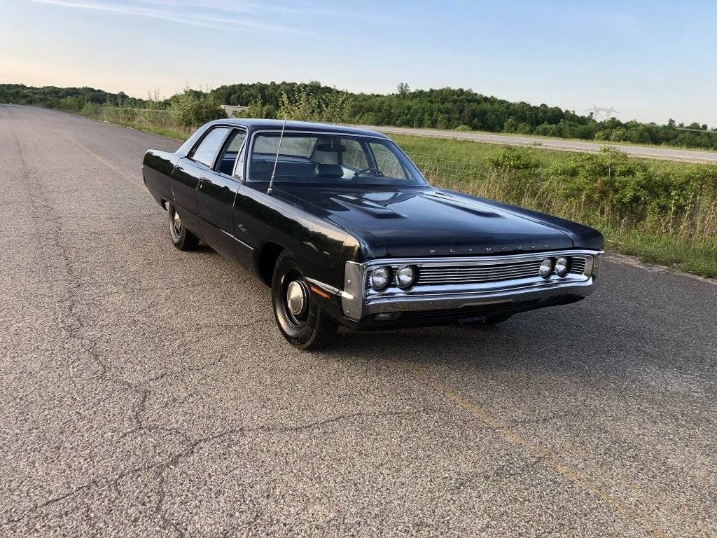

I have to say, smooth is the word that best describes this car. It’s so quiet and it just floats down the road. Has the smell and feel of an original.
The brakes need to settle in and be re-adjusted and I need to get used to the clutch. Other than that I’m very happy with how it performs.

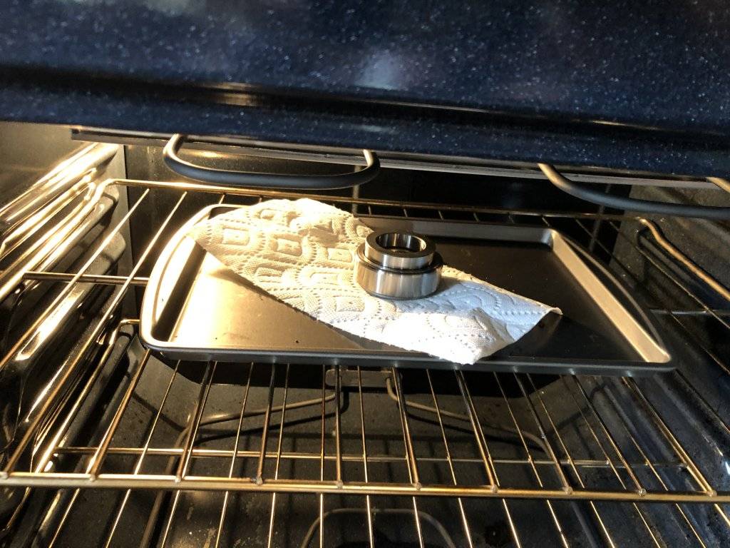

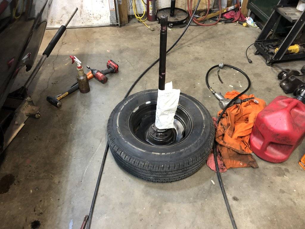

Slight pause in fun having to replace the axle bearings…I split the old stuff to remove them.
Then I bolted the axle to the wheel, put an ice pack on it and heated the bearing in the oven. The right size aluminum pipe and some love taps drove them home.
