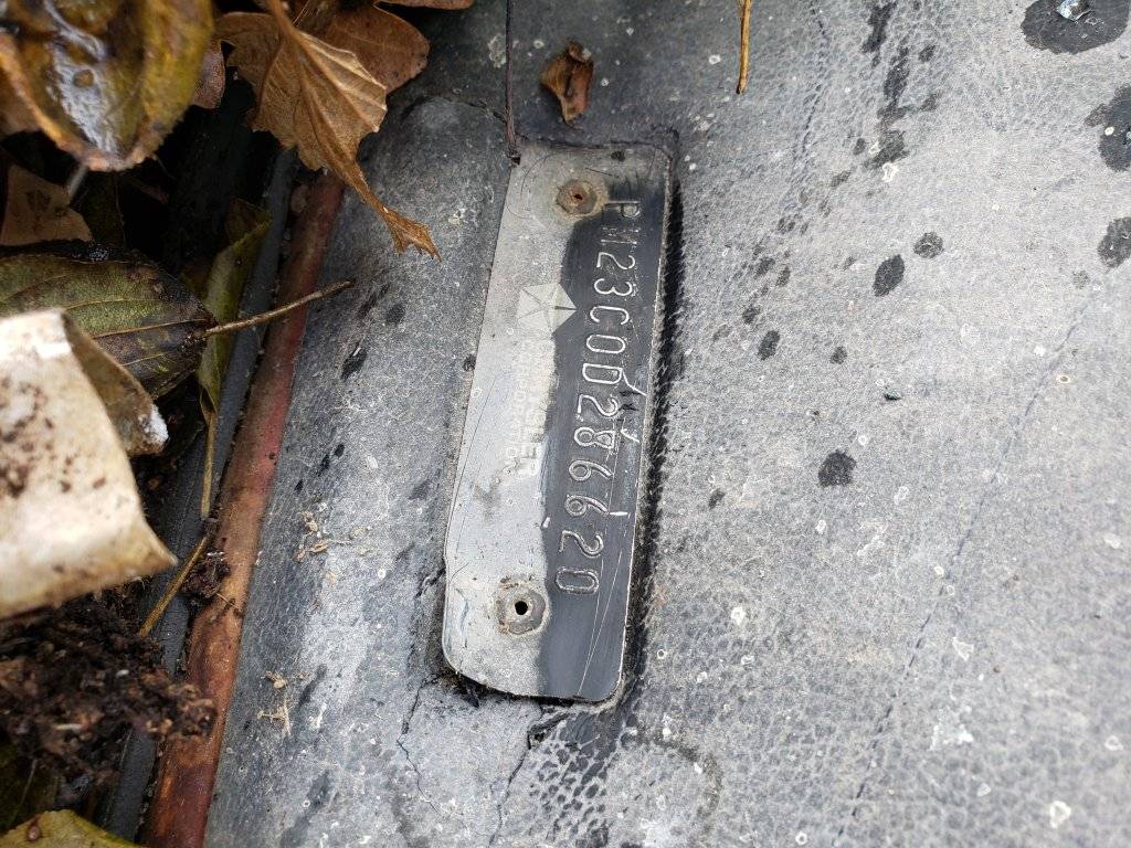

Not sure, look for a F21 or F72 on the broadcast sheet,
Alan
Lol,Messing around with that broadcast sheet is why I haven’t got the engine out or the brakes working yet! Well, that and I’m fat and lazy. I did find out it has an open 3.55 gear though!

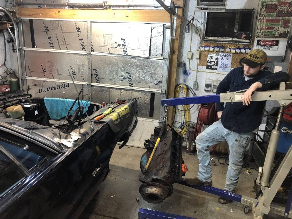

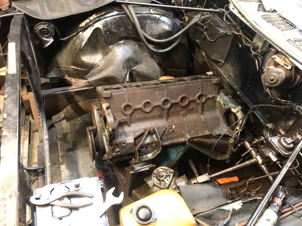

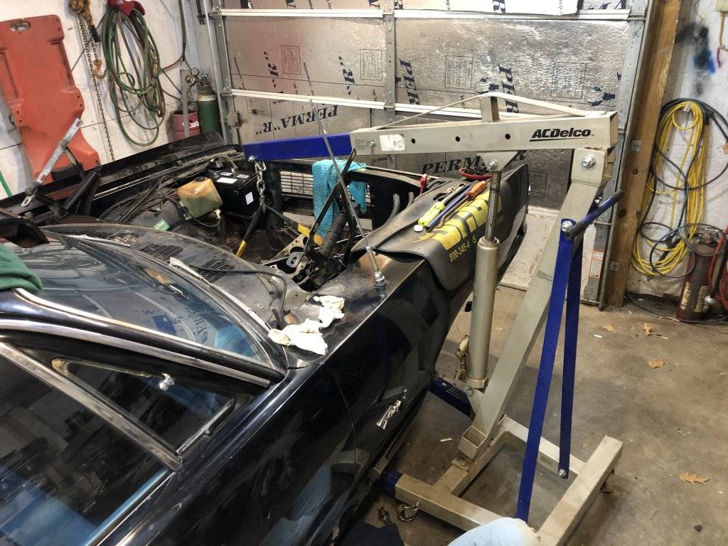

Because the car is in my small garage backwards, we took the engine out from the side. We had to take the wheel off to maneuver the hoist around. We got it out that way maybe easier than taking it out the front like we usually do.

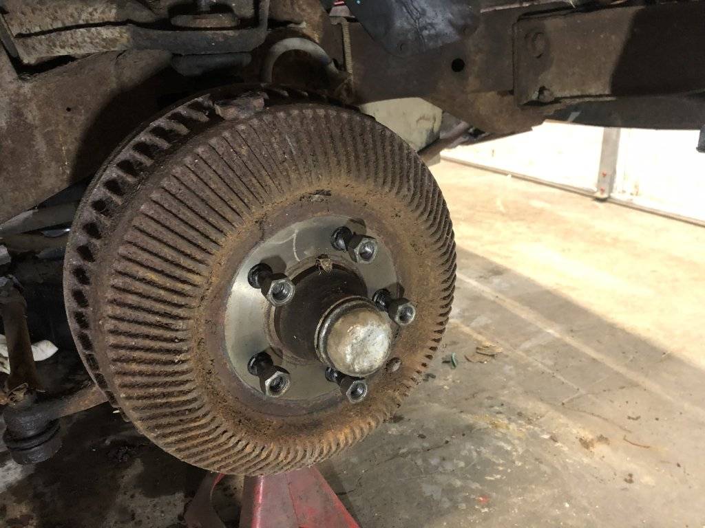

That brake drum looks pretty good,, from the outside anyway.

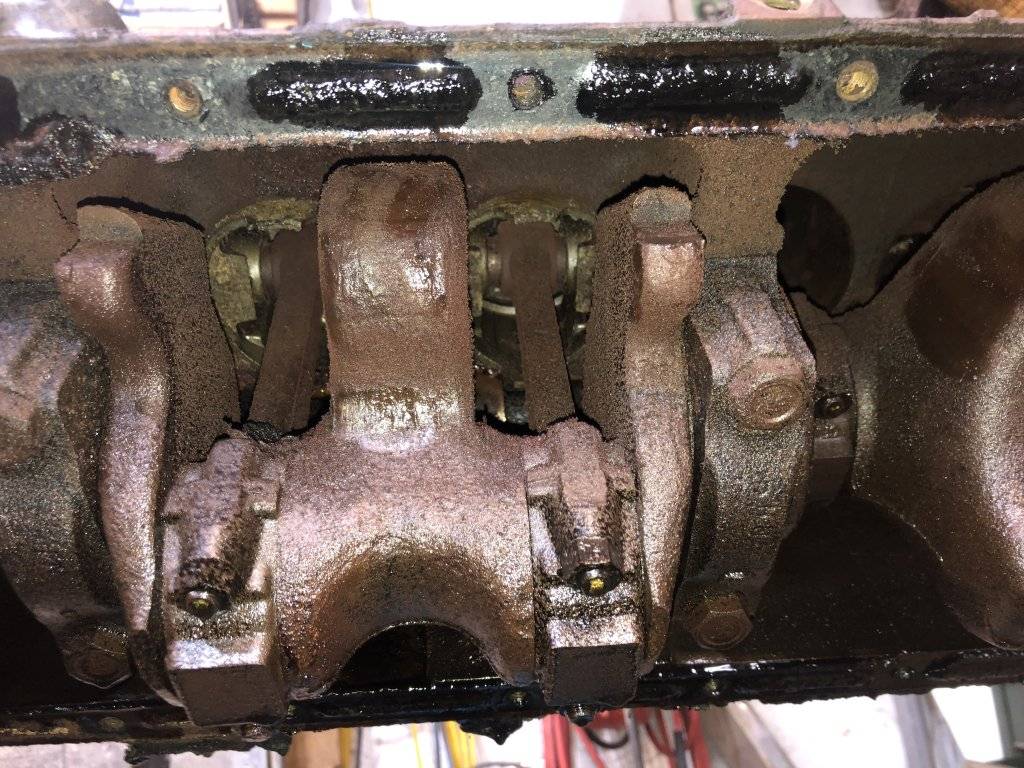

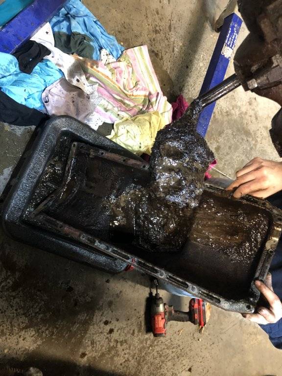

Look at this mess right here! So much sludge in the oil pan it wouldn’t even drip a drop out of the drain plug. And that’s with 2 quarts of kerosene poured in the crankcase 2 days ago.
Have you guys ever seen such? I myself can’t fathom what happened to this car for it to be like this. Overheated? Sabotaged? Somebody put ?? in the crankcase?
It’s going to the machine shop in the morning. Hopefully it can be salvaged but I’m not counting on it.
"Yeah I was tired of having to change my oil filter all the time so I just made a bypass for it, works great! Also, it kept leaking so threw in a couple jugs of stop leak or whatever"
Is that paraffin (wax)? If so, maybe old Pennzoil…
It’s like lumpy cake batter.I had put a quart or two of kerosene in the crankcase 2 days prior so hard telling what it looked like before that. I’ve never seen such crap! I’ve got feelers out for another engine but I’m having this one checked out.
I hope the original numbers block is worthy of saving.
I know, it's just a slanty, but it would still be great to keep the original!
Does the motor have the correct vin stamp on it that match's the car?
It’s not on the deck, if that’s where it should be.
Perhaps the owner was one of those people who say, "This thing will take care of itself," and never do an oil change. I had a buddy in High School whose dad said such a thing. He had two inoperable cars in front of his house.

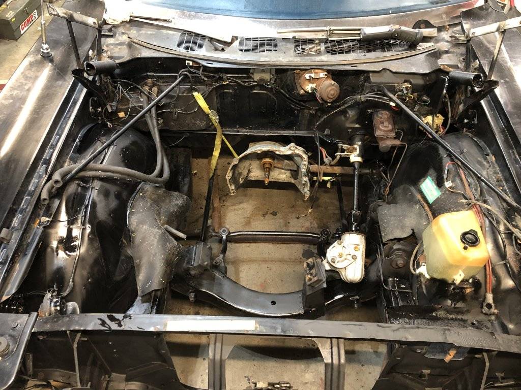

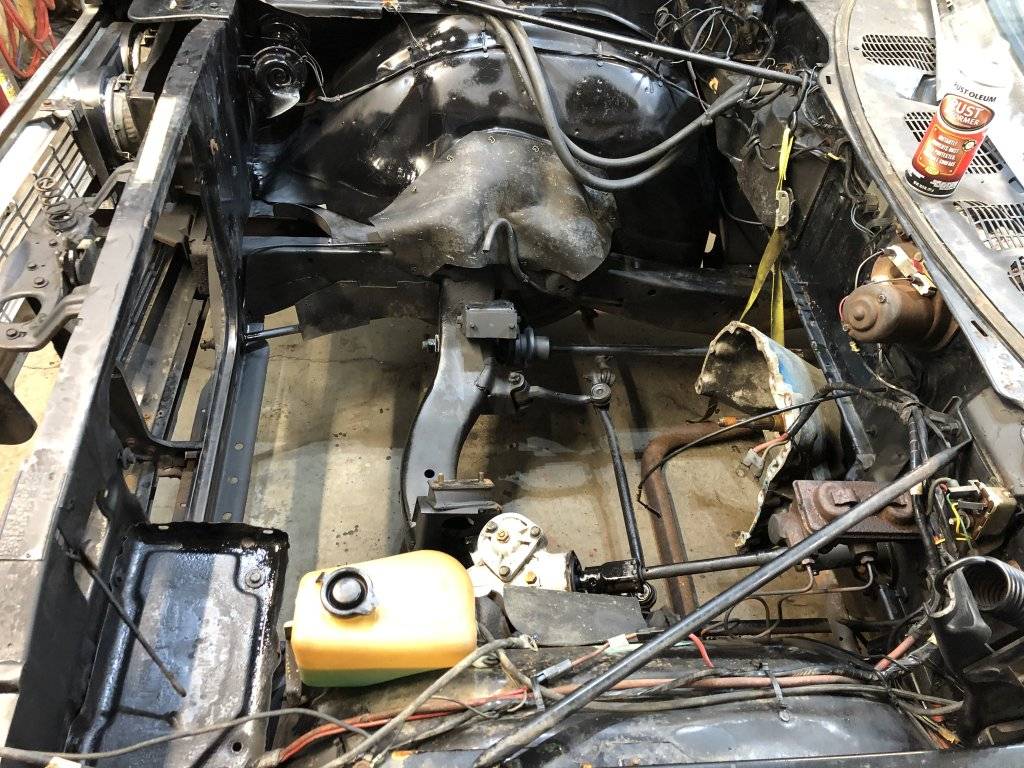

Update: after removing the engine , I did a little cleanup on the under hood area and am getting ready to tackle the brakes.

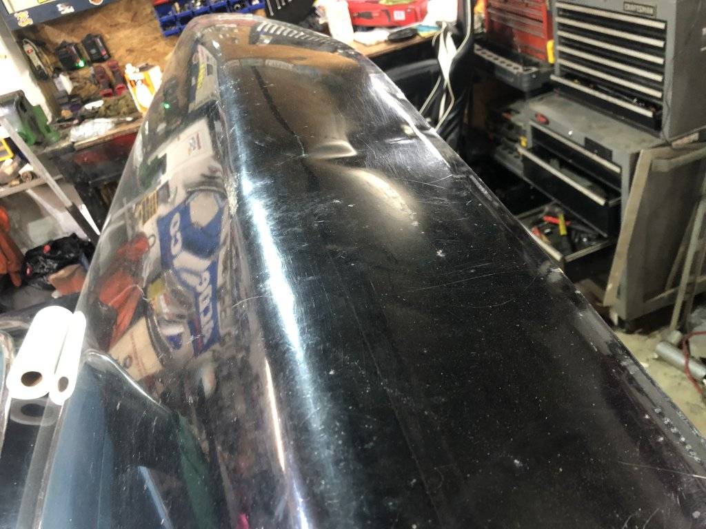

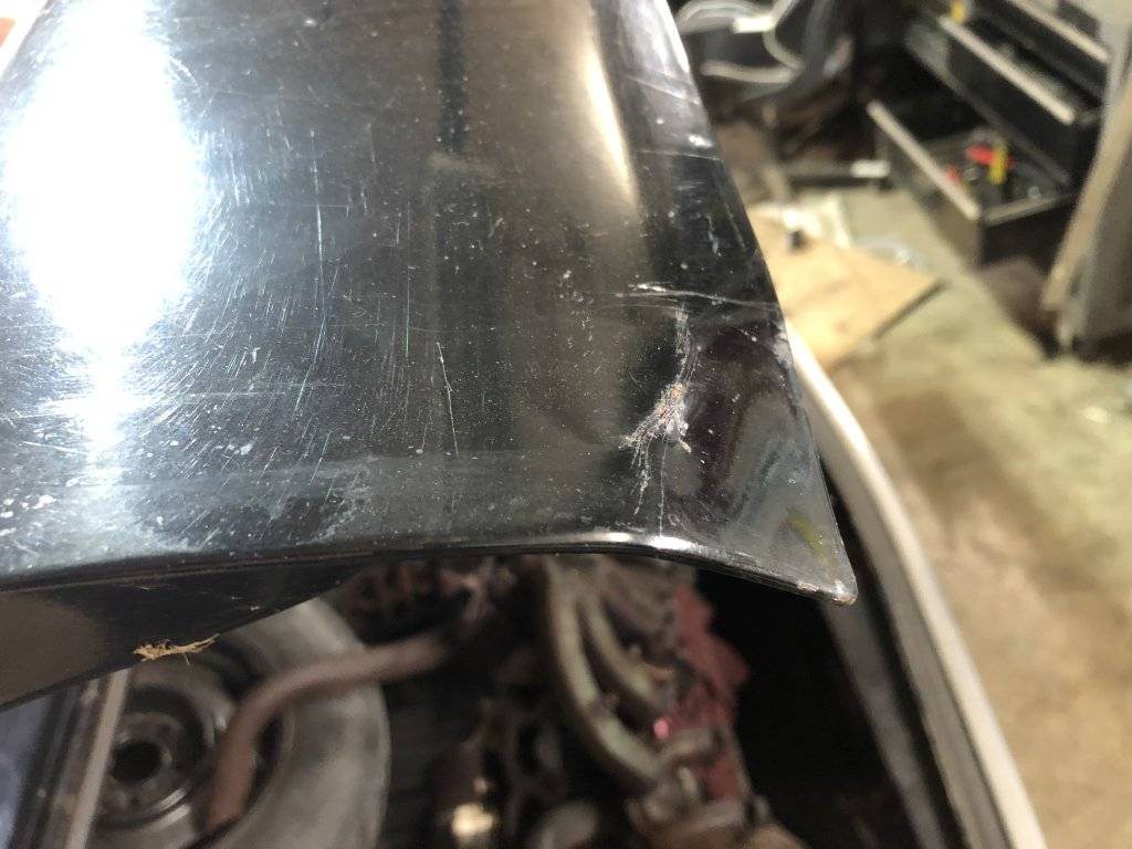

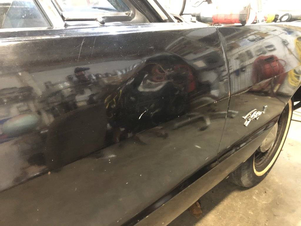

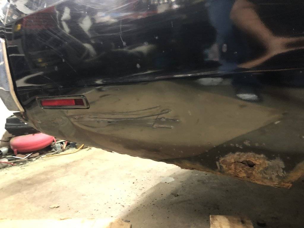

I’m getting close to pulling the engine. Maybe tomorrow. I took some pics of the aforementioned dents, hard to make out in the pics, to me anyway.
