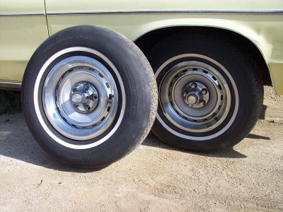

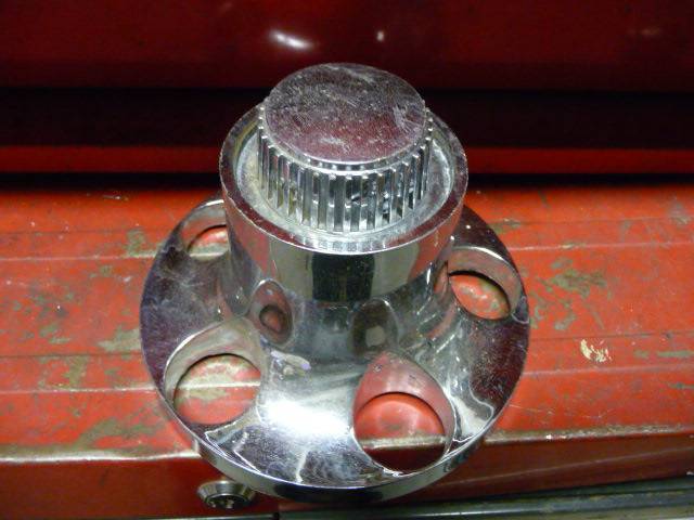

Motor Wheel was the manufacturer of the center caps pictured by Stan above and they were supplied to AMC but not production Chrysler Corp vehicles. I suspect they did supply Chrysler with some AMC type for the pre-production vehicles used in their photo shoots for the 1970 Chrysler dealer brochures and other material. Production vehicles used the slightly different center caps pictured by Mr C. Motor Wheel also sold the AMC center caps in the aftermarket but replaced the AMC red circular metal decal with one that said "Motor Wheel". I have sets of both the AMC and Motor Wheel versions. Just to see how close they would come to the production Chrysler center cap, I removed the red metal ring from one of those aftermarket type and put them on a road wheel to see just how close it would look side by side as shown in the photo below. The difference is pretty obvious up close, but the unsuspecting might not notice from a distance.
A man on a galloping horse probably wouldn't notice. I would wager there is 15 active members that would pick up on it

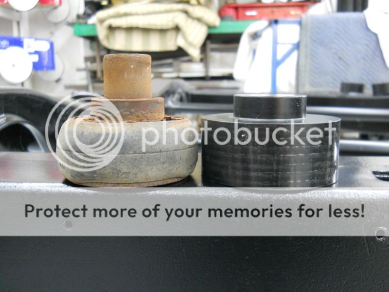

Critter, have you figured out your hockey puck dilemma? I did that one time on an old GMC chassis swap along with some quickie body mount transplants, mostly because I was out of time to track down a better solution and needed the thing on the road (moving to FL, required PA inspection) They are not really the same material and I had serious doubts they would last more than a season or two. It did let me level the cab and "look" right, but it certainly wasn't right. I am sure Paul has a solution in mind.
actually he asked me last night to source some out...sooooo where can l find body bushings for a C body?
Every comment I have ever read tells me they are a DIY project ranging from using actual hockey pucks ( you have plenty up there, eh? ) to machining your own from HDPE.
One member, years ago, measured them and posted the dimensions but damn if I can find it now. Sorry.
I vote against hockey pucks, I don't think HDPE would stiffen it up too much and would be less likely to crack and fall apart with age. But I have no engineering background and not enough hockey puck background to give a full assessment... if NOS doesn't miraculously appear. I would float the idea past Paul, he is the guy doing the work... and I never think its wise to piss off the chef before the meal.
