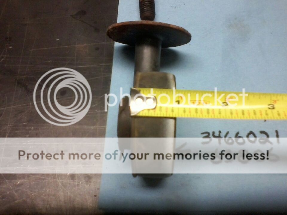

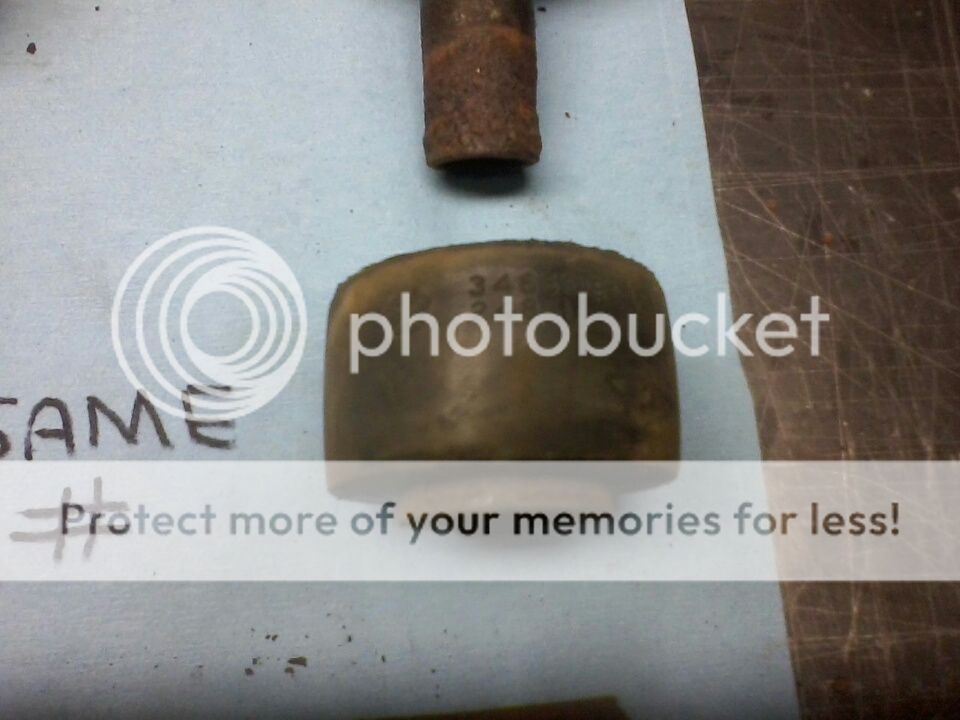

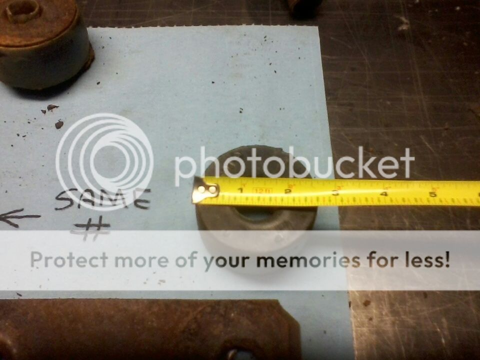

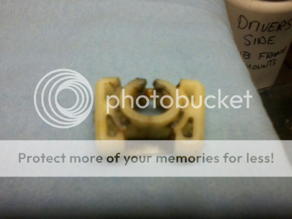

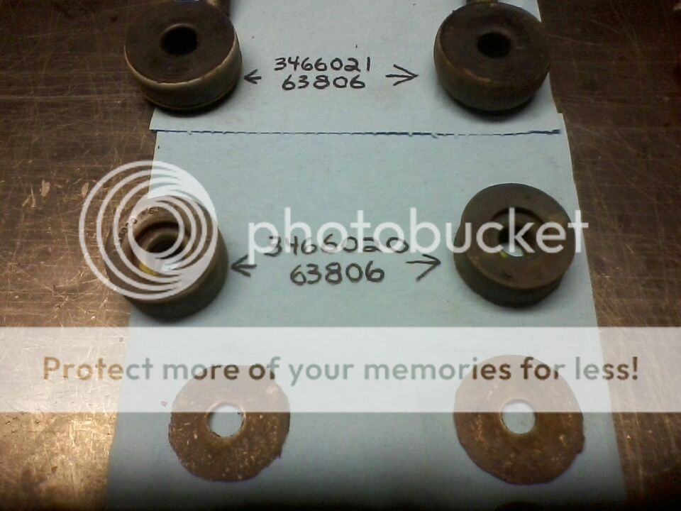

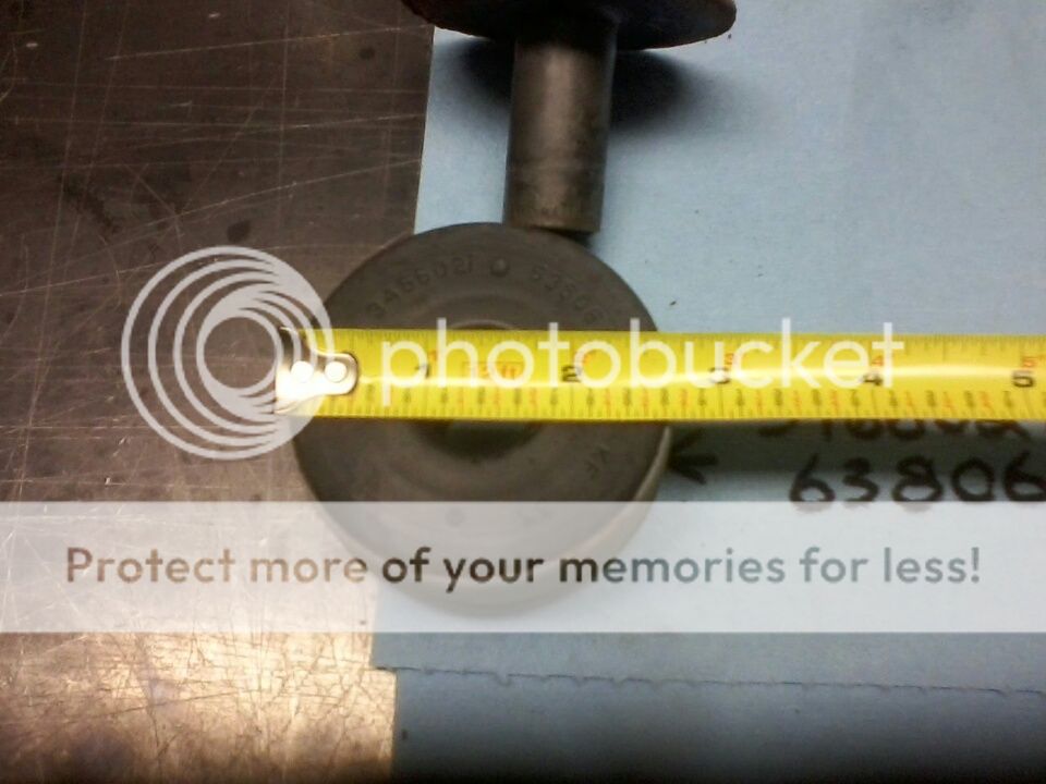

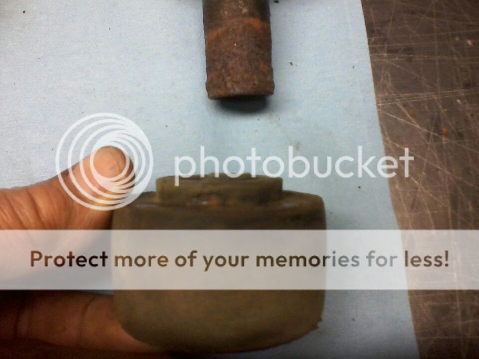

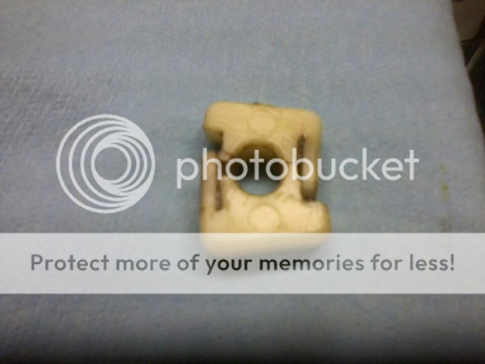

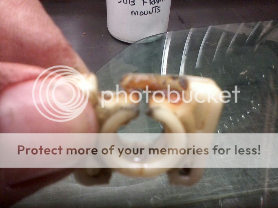

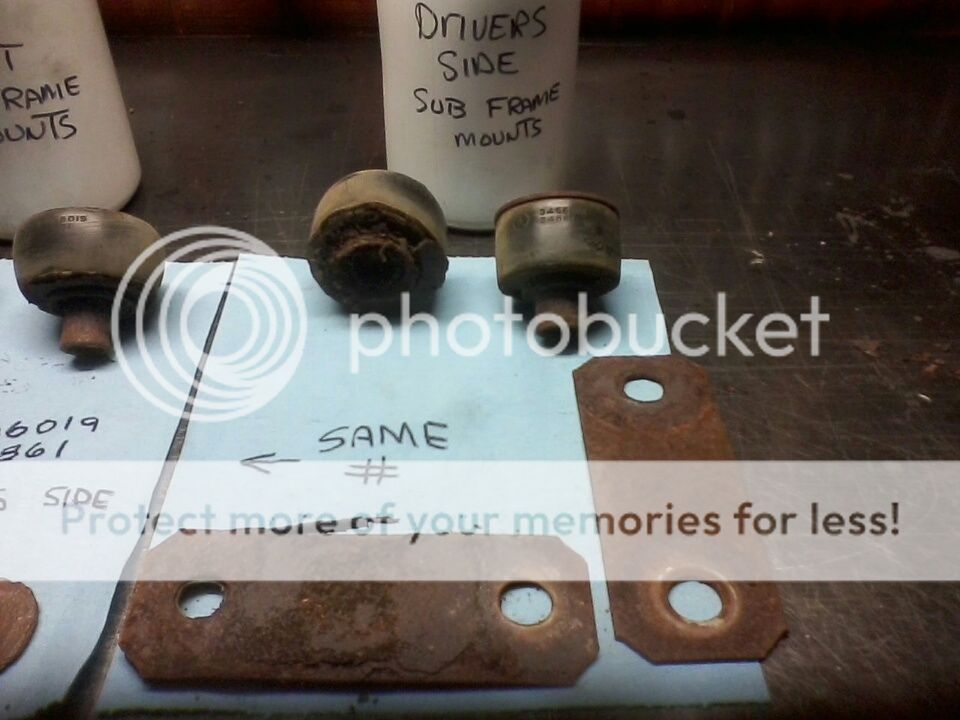

actually he asked me last night to source some out...sooooo where can l find body bushings for a C body?
Have you tried sources like Energy suspension? I know they make muscle car stuff...perhaps some B Body bushings will work on a C.
not haveing much luck here re the bushings...A..dont know what they look like...anyone have any bushing pics for 71 fury?
thanx....may come down to paul shooting me some pics and measurements and either making or trying to match something up
Love the progress pic's, hope you find something that will match up for body bushings
I think it would be worthwhile taking measurements of all the bushes you have on your car then calling PST and discussing with them what sort of kit they could assemble for you out of their parts bin to give you what you need. They have a range of different bushes that I am sure could be made to work. If they are able to come up with a complete package that works with what they already have available then they could sell that as a kit for all 71-73 C-body owners.
that kit may be only ticket but like the idea about calling pst...it kills me that lm not able to be hands on with the car right now
just thinkin...may be good idea to just round up all the bushings and send to pst to match up...calls to make monday am...

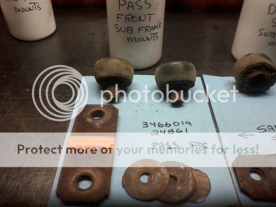

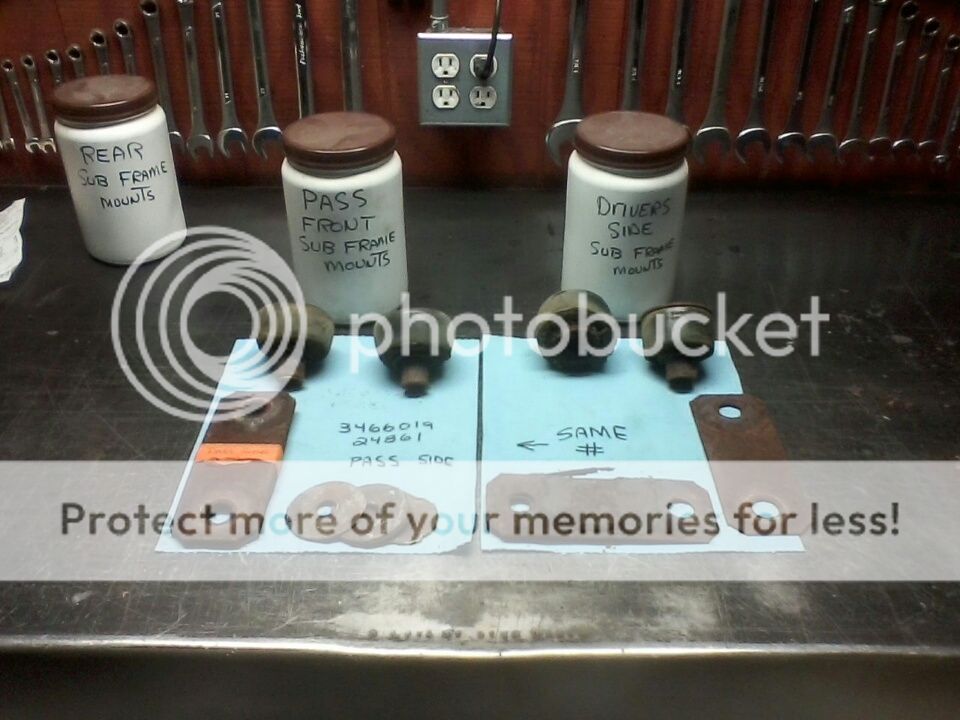

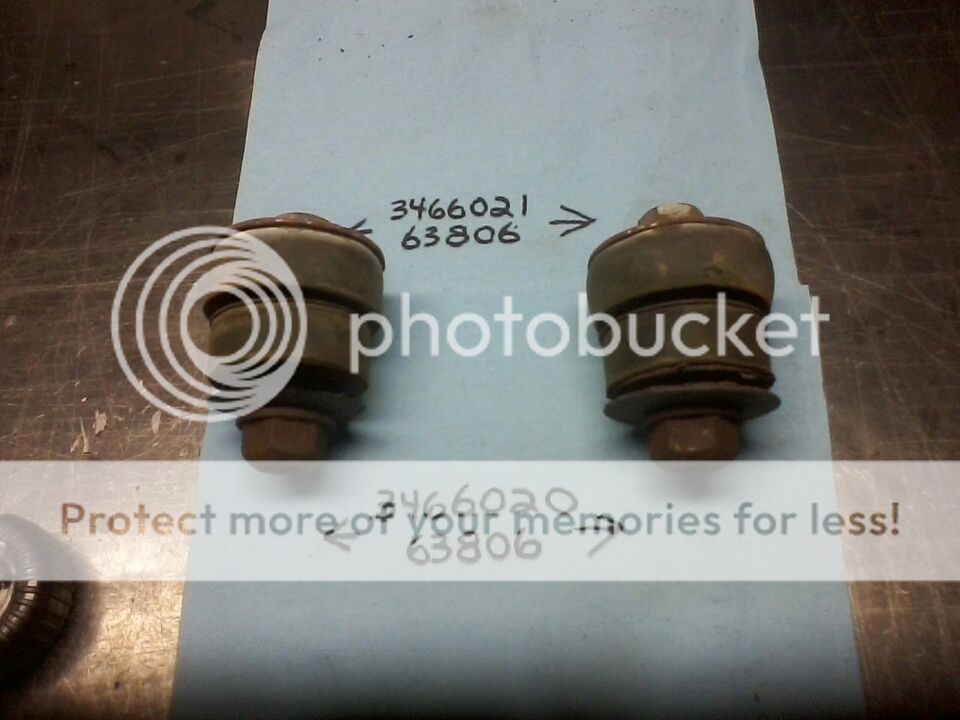

been busy huntin bushins and decided to step it up a tad......

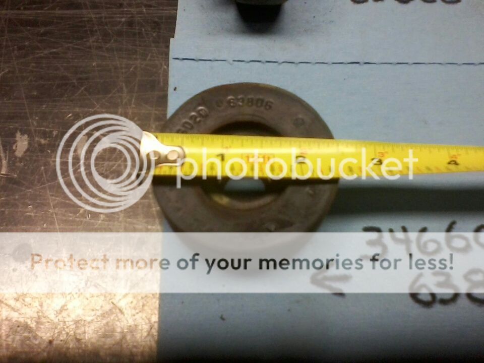

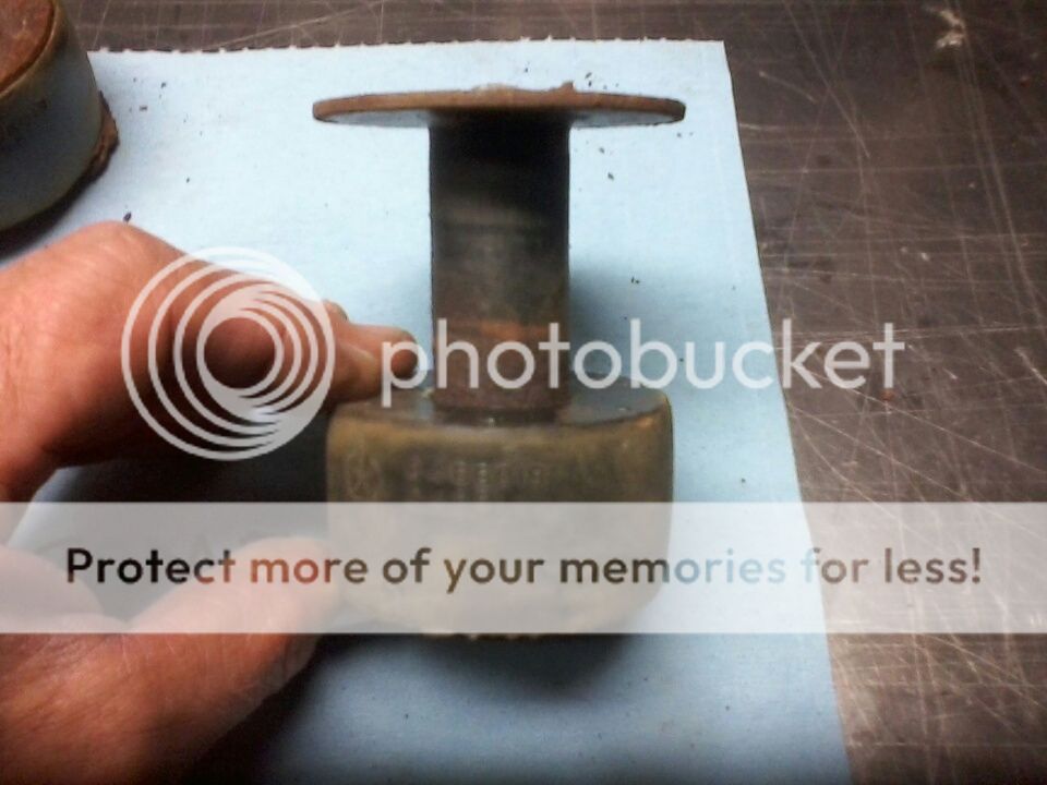

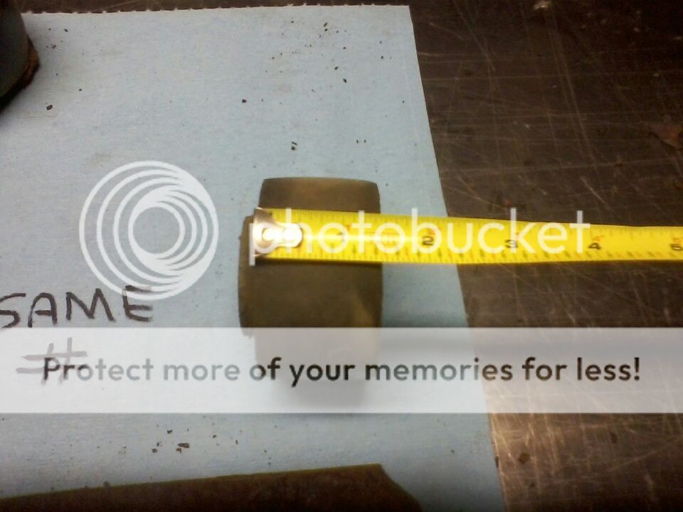

Instead of sending the bushings to us, can you send me some basic dimensional specs of the mounts and what I will do is a preliminary search of the mounts that we have to see if there is something that matches or is close that can be modified slightly. Please send specs and photos to the following email jfrom@p-s-t.com

....so am gona go this route and see what we can match up for our C bodys......if l can put a kit together will ensure l record part numbers then those of us with C bodys will finally have a body bushing kit and a place to get it from...least thats the end result lm huntin and it looks like PST is willing to see what it can do for us....
Good work Derek. If you get successful, I would be right behind you in an effort to get some as well for a bunch of my cars. All my stub frames will be restored like yours and those old bushings are pretty wasted.
