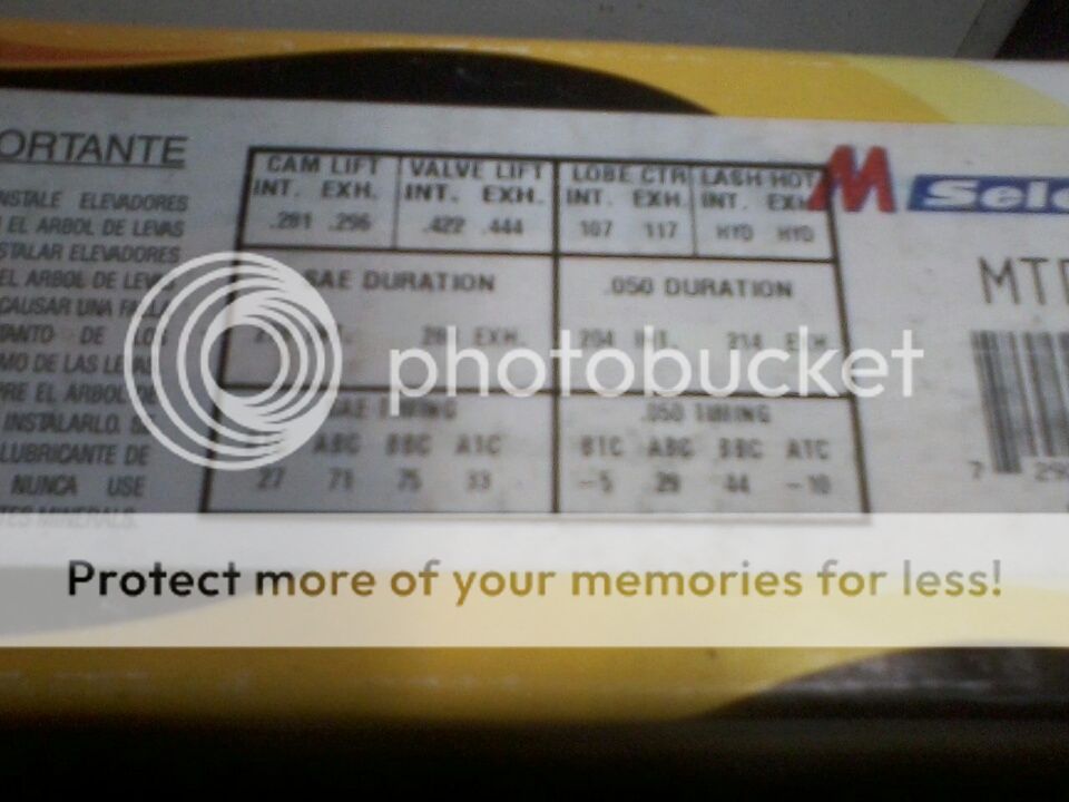

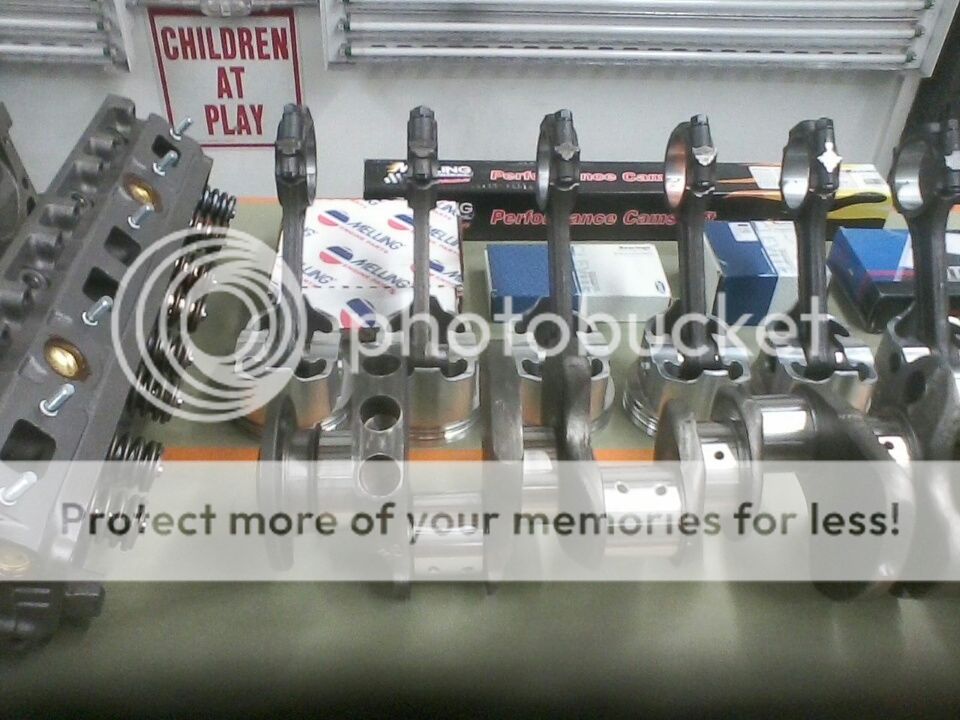

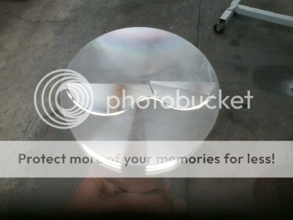

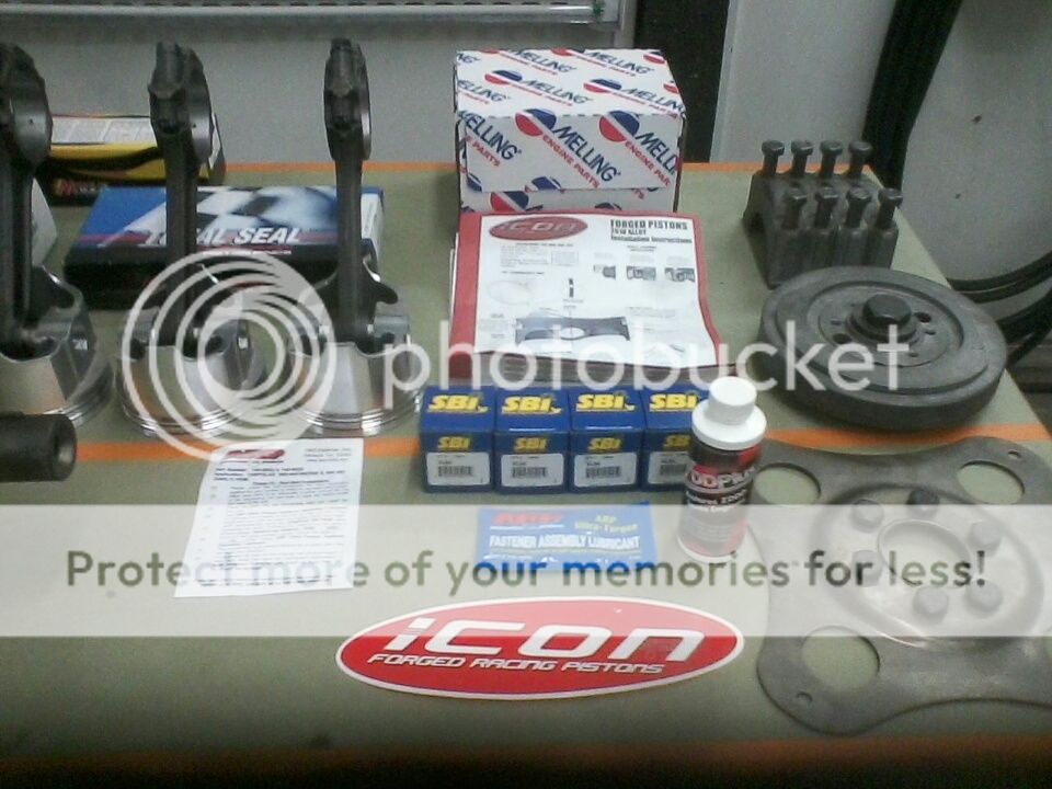

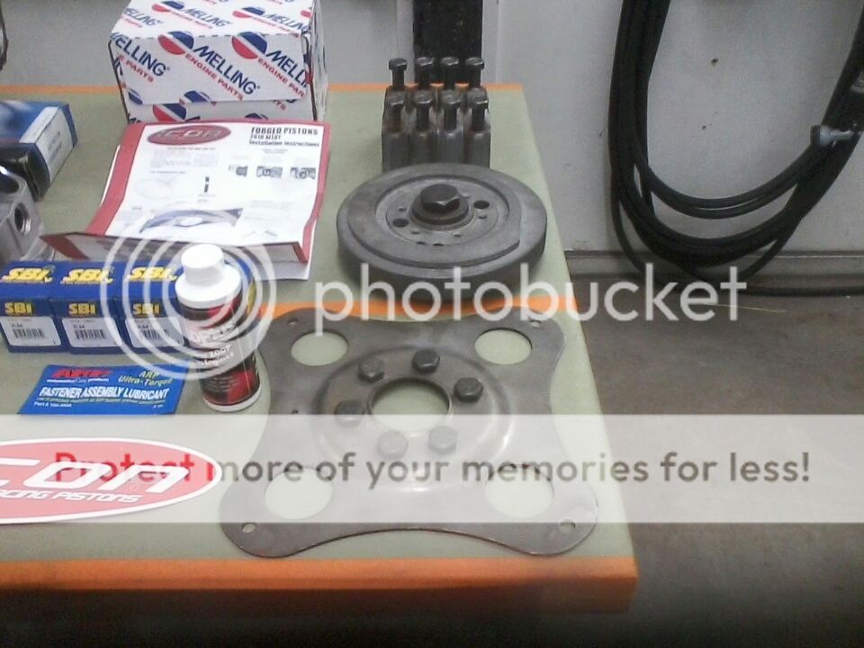

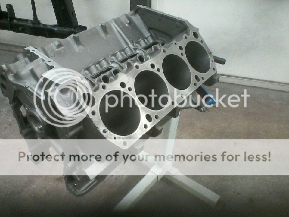

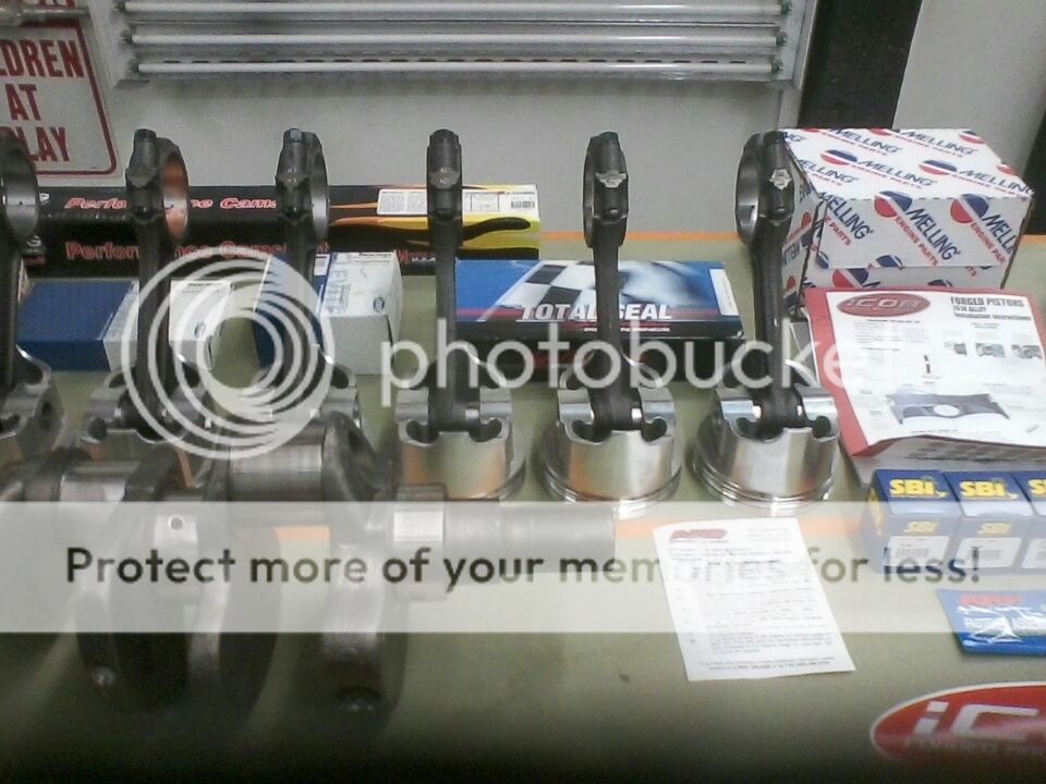

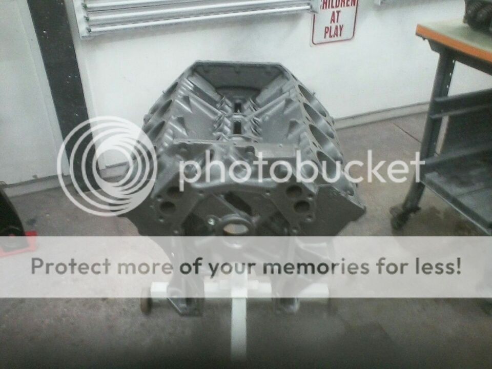

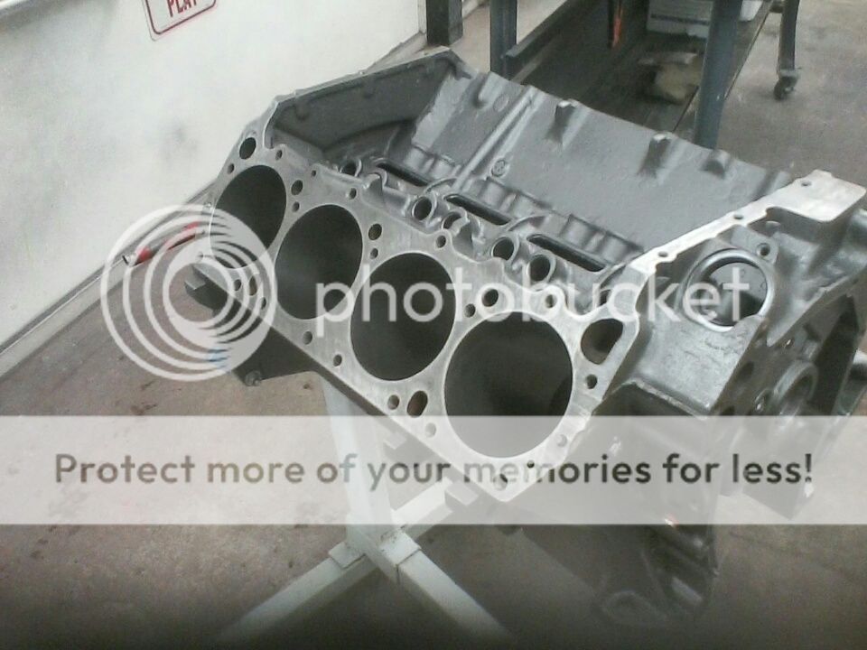

Not sure if you already mentioned it but what are you doing with the engine?

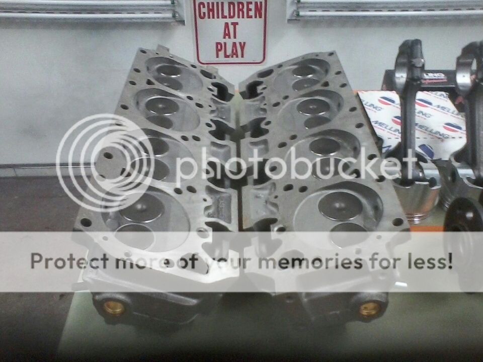

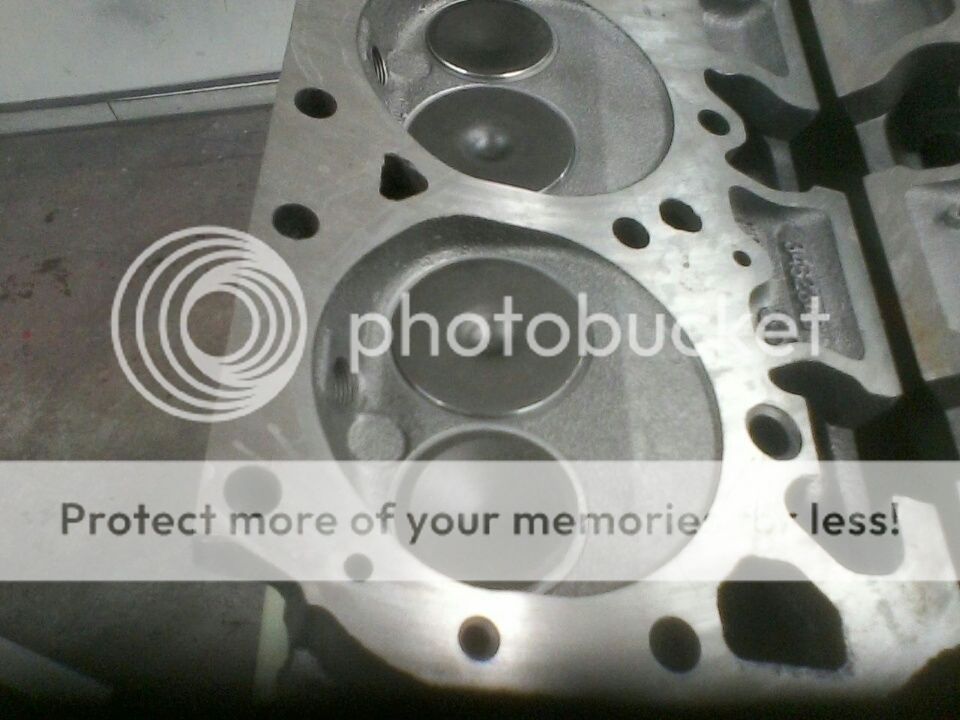

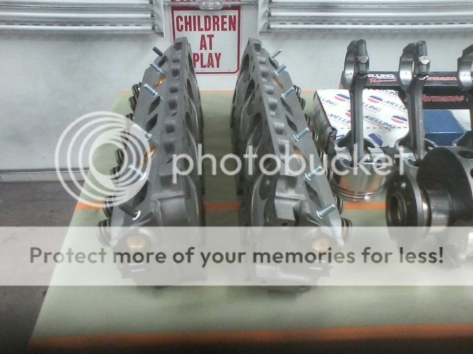

Whats the number on those heads?
engine will stay close to stock for reliability...CR will be just over 10-1+ with .40 over...asked about cam...belive is a stage 2 melling...belive the same cam is in Bills and Garrys 440s and thier both happy...couldnt find to much on the net about them but Pauls machinest recomends and Paul trusts him so not gona micro manage stuff....did that once and ended up replaceing a rear end..up here its not cheap :O( so l let the pros do what they do best and leave them the heck alone...l excpect no less when lm working
Heads....no clue but engines orriginal to the car and Nos matching so am asuming heads are original to the block..in any case will get pics of Nos

Now that's interesting, 346 heads on a 370 horse engine. I now know what to expect when I have a closer look at my own engine too, thanks for all the pics my friend.
