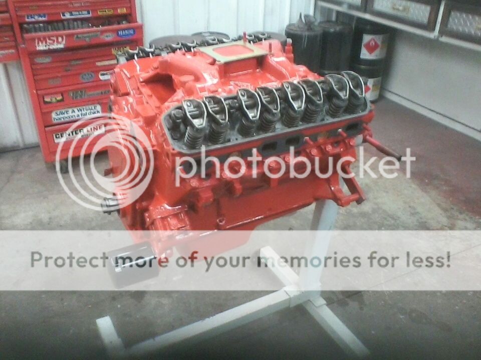

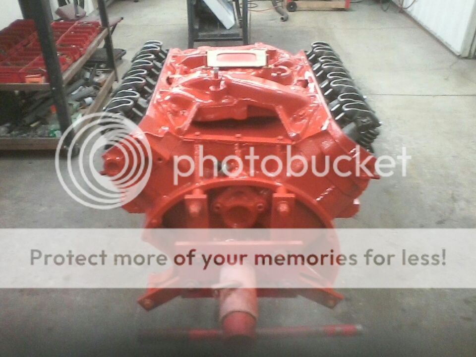

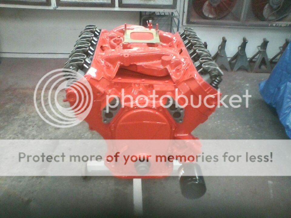

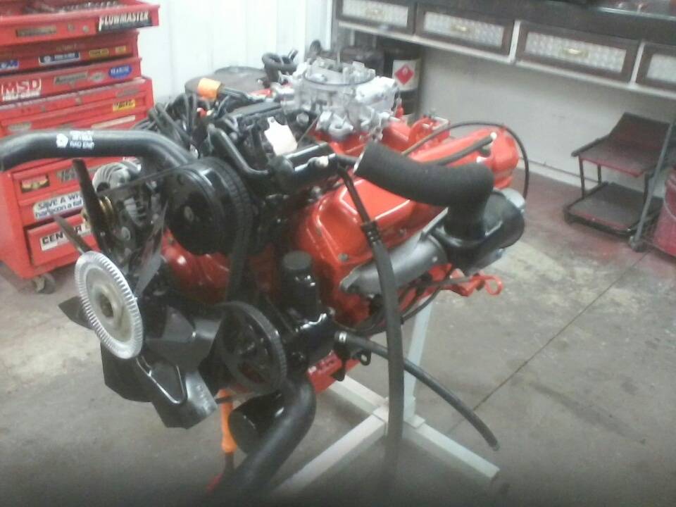

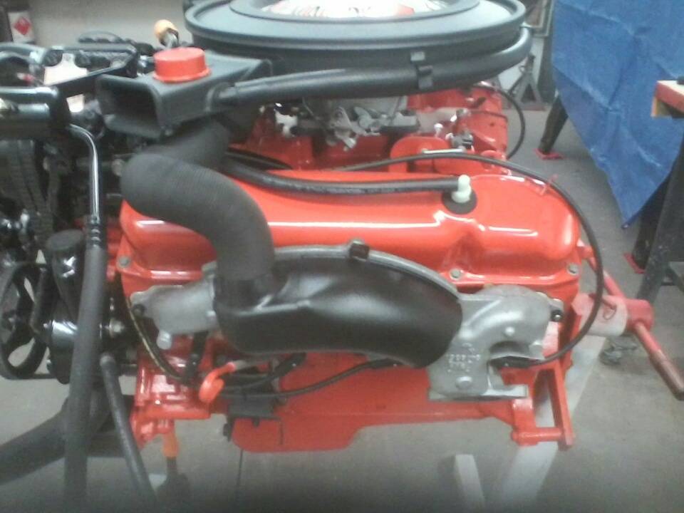

1971 Plymouth Sport Fury GT Brogham & U code Super Comando
Way to go. Keep us posted on the progress with pics. That Fury model was part of the Rapid Transit campaign. Go fast in comfort.

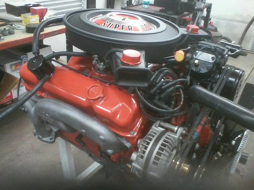

Now that's interesting, 346 heads on a 370 horse engine. I now know what to expect when I have a closer look at my own engine too, thanks for all the pics my friend.
Hada go school myself after your post....
EXHAUST MANIFOLD INFO FOR THE ILL INFORMED.....l've read it twice...

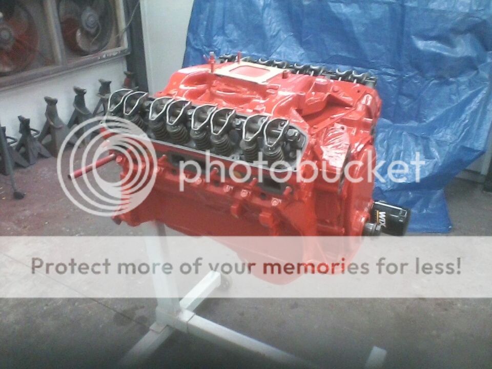

Probably the one Paul painted mine. My engine was born blue or turquoise but Paul figured it need show off! Great read on the history of heads. Turns out my decision to stay with 906 heads was a good one.
k...where was l...ah ya...love Pauls work...
Wow! And holy crap! Think. How bad your gonna feel bring g that up to running temperature

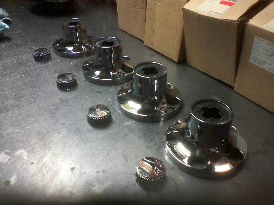

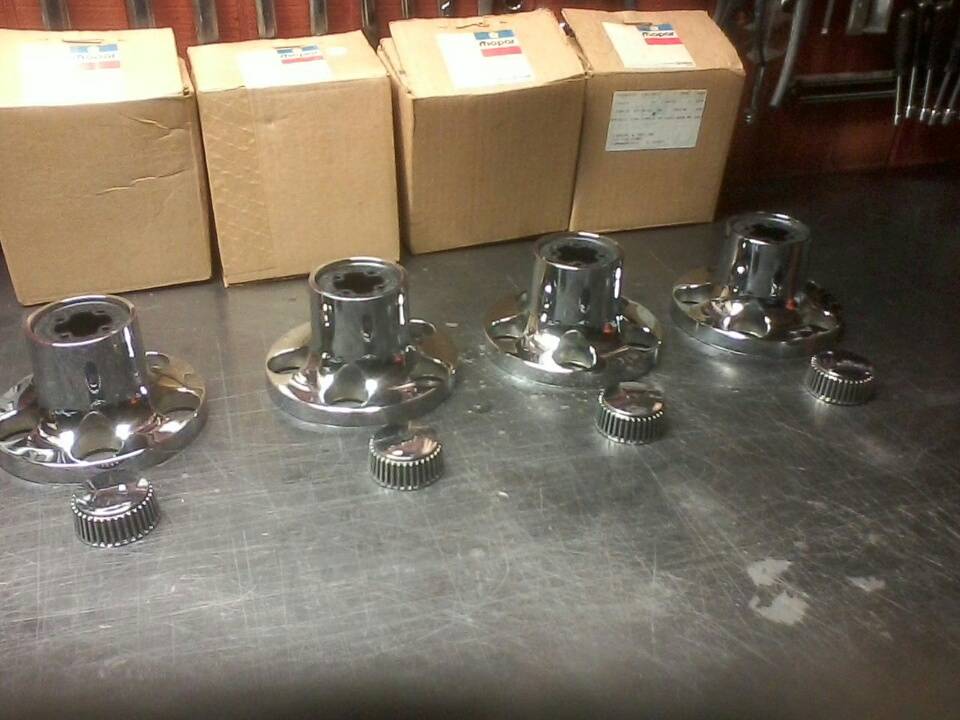

Absolutely beautiful. And when it's done, you get to drive a brand new Sport Fury GT off the lot...
belive so...they were on ebay...everyone hesitated...l didnt
I didnt hesitate, I just couldnt pull that monetary trigger at that moment which is why I posted them. I just picked up another set of NOS domes from a dealer on Monday. I find it interesting so many years went by and I couldnt find a set. Now in the last several years I had access to seven sets. To date I have only located two sets of NOS trim rings
